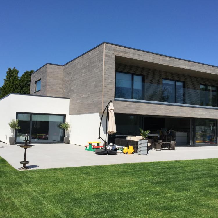

The super sharp lines of @Trw144 roof line (See here:
has prompted me to make a design detail decision about the flat roof on my dormers.

Looking back, @Trw144's roof seems to have a detail all the way round all the edges, and it may even have a small upstand (perhaps only 25mm) between the edge and the flat surface of the roof (?). And I think it may rely on a mini-fall on the roof going to wherever he wants the water to go to avoid any runoff. Perhaps the fall alone will do it. Is there a hidden drainpipe somewhere?

My flat roof has a fall in it, and surrounding it all is a parapet that is probably 600mm high at its highest point. The cladding profile should be installed so that any water runs back in to the flat roof, and out through one of the internal gutter outlets, rather than down the outside. I had one area where it was running down the render slightly and I solved this by putting a thick bead of silicone on the top of the parapet so the water could nt track to the front and drip down, but instead ran back internally.

Yes, my gutters are behind the cladding and run internally down through the walls - I have 4 or 5 from memory. I ll try and find some section drawings - they are readily available as I have changed computer/server/company.
