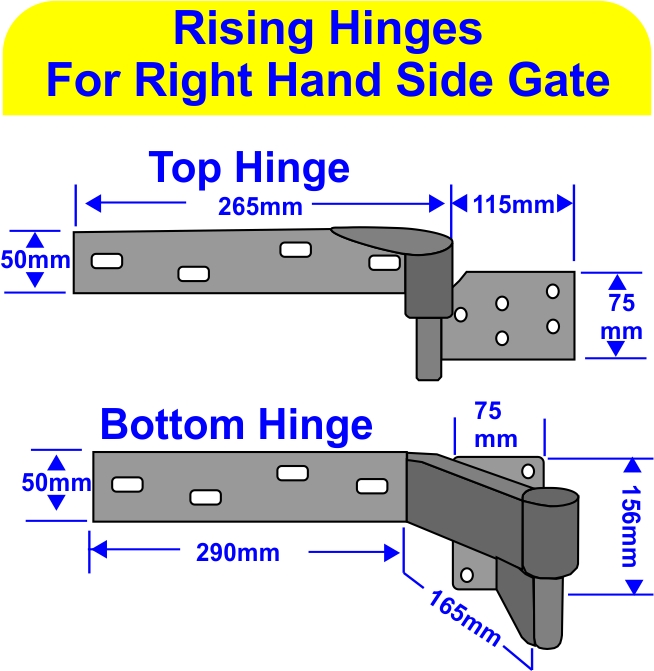

Jeremy Harris Posted June 21, 2017 Share Posted June 21, 2017 The trouble with threads like this is two fold. Firstly it started me thinking about adding gates to our entrance, secondly I ended up spending hours researching the cunning hinge systems that are around that allow a gate to open upwards on a sloping drive. I've even "wasted" a couple of hours drawing up options in AutoCad to see what sort of geometry might work. The offset lower hinge point system looks easy to fabricate, and looks like it'll integrate with an off-the-shelf opener OK. Much as I'd love to make an opener, the safety issues are just too great, especially as the units don't seem to be that expensive to buy. It's a pity that the way the fences run either side of the current gate posts won't allow a sliding gate, as that would probably look neater. It's also a pity that the big gate posts we put in are too close to the road to take gates, I'll need to put two more in a few feet further up the drive to hang gates from. That has the advantage of leaving the area to the side of the gates, where we've made a stone hardstanding for the bins to be collected, outside the gates. I just need to work out how to fit a small personnel gate for the postman, or shift the mailbox down closer to the lane. Link to comment Share on other sites More sharing options...
MarkH Posted June 22, 2017 Share Posted June 22, 2017 10 hours ago, JSHarris said: I ended up spending hours researching the cunning hinge systems that are around that allow a gate to open upwards on a sloping drive. Could you post links to any interesting/good ones? Solutions to this I have devised are very Wallace and Grommet. Link to comment Share on other sites More sharing options...
PeterW Posted June 22, 2017 Share Posted June 22, 2017 6 minutes ago, MarkH said: Could you post links to any interesting/good ones? Solutions to this I have devised are very Wallace and Grommet. What is needed is the offset and crank from the post. Pretty good example here. Search for rising hinges Link to comment Share on other sites More sharing options...
Jeremy Harris Posted June 22, 2017 Share Posted June 22, 2017 I've found a few on YouTube that illustrate the principle of the offset bottom hinge. This video shows how it works quite well: Link to comment Share on other sites More sharing options...

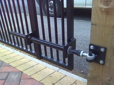

Onoff Posted June 22, 2017 Share Posted June 22, 2017 This thieved off the mig welding forum. Done by welderpaul there: "Didnt bother making the rising hinges as a cranked set - they were too unweildy and would have hit the fence on the left hand side of the gates which was close to the post.Instead: two tubes which slide inside each other. One welded to the gate on two 80 x 15 plates. Other has a normal adjustable hinge pin welded to the end and a large washer welded on on site as a stop. Wheel attached to the bottom of each gate. as the gate opens and rises up, the tubes slide out and the bottom of the gate rises still staying upright. Hinge 'eye' drilled over large so it doesnt bind on the hinge pin.Works a treat.These gates were painted rather than powdercoated - still a decent finish on them!The gates rose 450mm over a 2000mm length" 1 Link to comment Share on other sites More sharing options...
