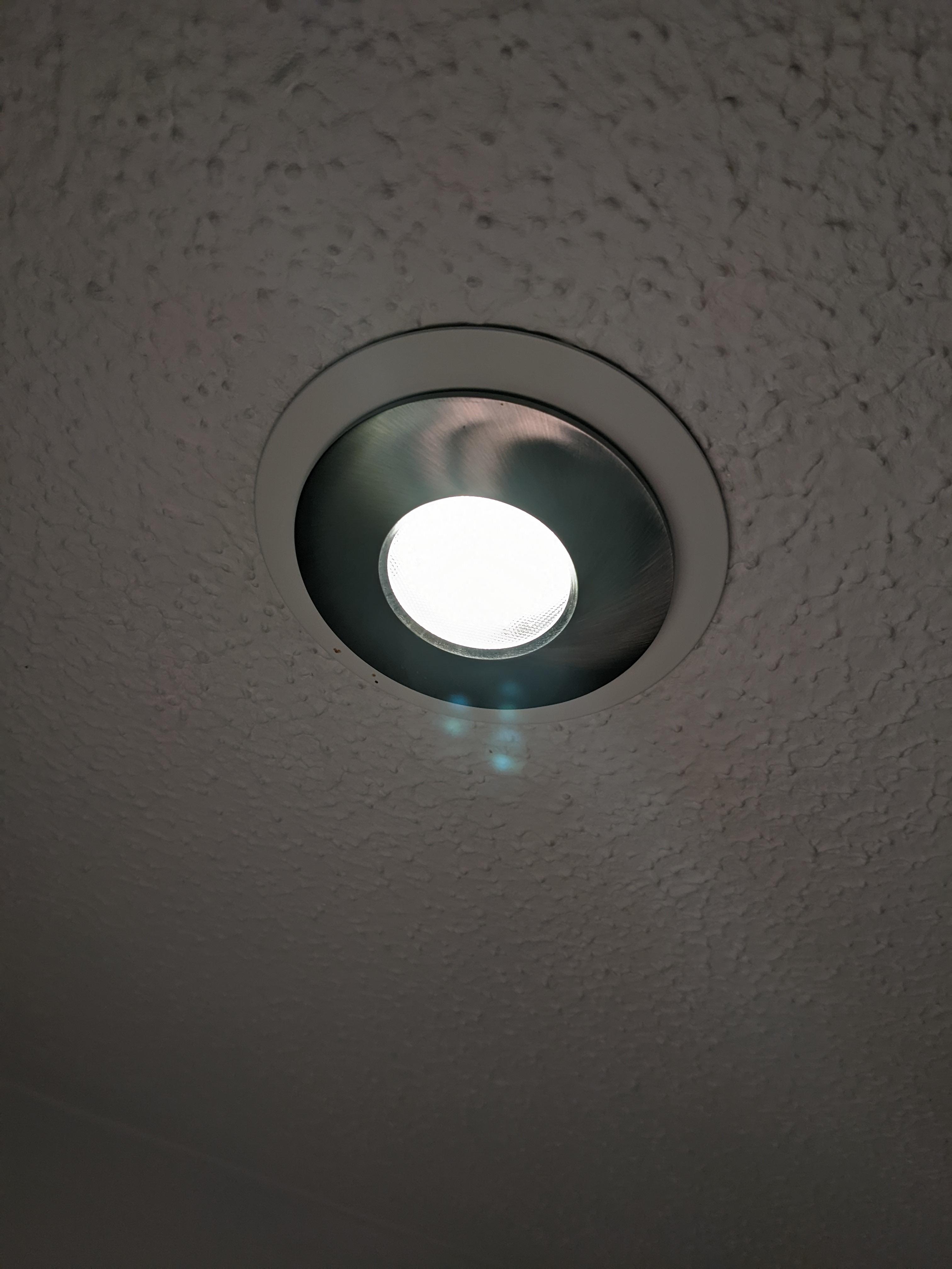

Can anyone tell me how to replace the bulbs in these ceiling lights?
Each bulb contains 3 small bulbs/leds inside. There doesn't appear to be a twist off on the silver surround or anything holding the bulb in place.
Thanks in advance

Looks like you need to pull the fitting out of the ceiling, spring clips will be holding it in. I suspect you won’t be able to change any of the individual lighting elements, you’ll probably have to bin it and get a new one and good luck finding one that matches…

Ok, this has started flickering quite badly. They were fitted at least 5 years ago before we bought the house and I've never had to change a bulb in them before.

Try twisting the silver bit and see it it unclips leaving the white bit still in the ceiling
It doesn't untwist but the whole silver bit does pull out of the ceiling. It's a 4000K CW 38 degree beam dimmable light. It looks like it's an integrated unit so you can't replace the bulbs and you have to replace the entire lamp instead.  Nice :(

Sadly a lot of light fittings recently are throw away items.  Care to post a picture?

I haven't taken it out of the ceiling yet. Sadly there are 5 more of these in our kitchen and having a non-matching one won't be acceptable with the mrs.

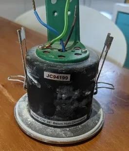

Looks like it's probably one of these. IP65 rated but it's in a kitchen.  I might have to get an electrician to change it to a standard GU10 so we can change the bulb in the future.
That one does look like a GU10, are you SURE the front does not unscrew, note some unscrew clockwise which seems "wrong"

The light has a bulb which 3 individual halagon bulbs in. I'd prefer cool white LEDs that are more energy efficient and which we can change the bulbs in ourselves.

If they are typical G9 halogen lamps, you can get LED replacements, but a lot of the LED ones are largerthan the halogen lamps.

They are JC94302 with integrated LEDs. Electrician has quoted me £352 to change the 6 lights to Starlite TD-M551 GU10s.  This works out at £50 per light including fitting plus £24 for bulbs plus VAT.
