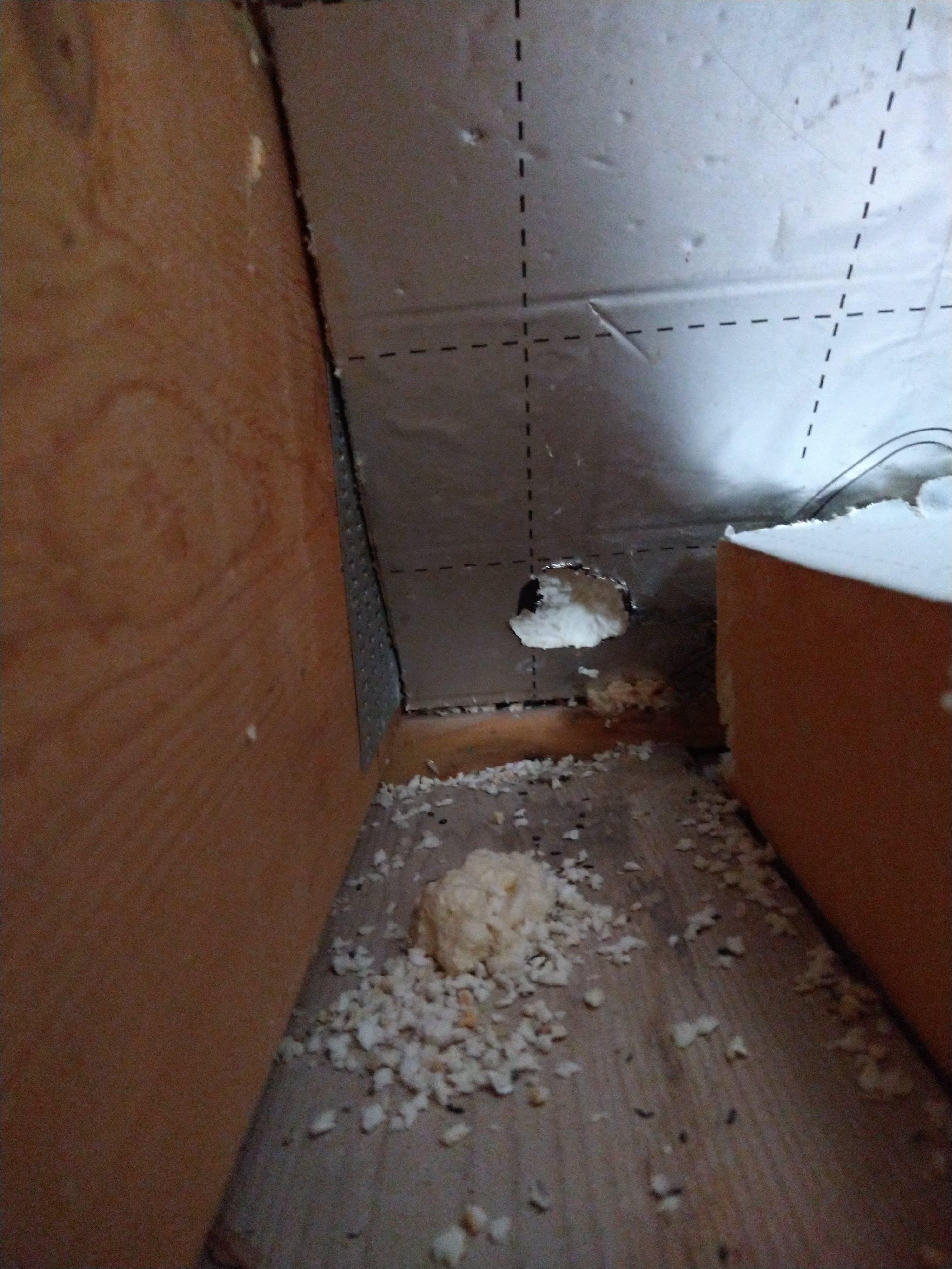

Radian Posted October 1, 2022 Posted October 1, 2022 About 30mm by the looks of this hole: I just cut out a plasterboard panel to access the eaves of our garage extension upstairs room to establish a cable run for our solar PV installation next week. Good to see the builder didn't tape the PIR to the wall plate and rafters 🙄 Nor did they extend the PIR between the bottom chord and the timber that closes the top of the intermediate cavity wall below. Anyway, a mouse has been running around in the floor space and has had a go at making an exit tunnel to the soffit. He shouldn't have given up - he only had another 120mm to go 😂 1
ProDave Posted October 1, 2022 Posted October 1, 2022 Airtight house builders will tell you a "satisfactory" air test, is when after 5 years, not a single mouse has found a hole big enough to enter and get into the house.
Nickfromwales Posted October 1, 2022 Posted October 1, 2022 All you have to do is imagine yourself as the mouse. Where Mickey can invade, rodent barrier. Simples. You can keep the little blighters out, but it requires effort an attention to detail. Same ethos for airtightness, where you study where a ‘molecule of air’ would travel to infiltrate your airtightness measures. It’s enough to make you lose a day just thinking about it, but try explaining this to a builder and he will have you certified. “They” just don’t get it…. I do try educating, but it’s a bloody uphill struggle. 2
Triassic Posted October 2, 2022 Posted October 2, 2022 Don't forget flying things trying to eat their way in. Had a wasps nest under the eaves this year. They buggered off recently, so went up to pull the nest out and block the hole up, to find they’er chewed through the exterior timber frame membrane and the OSB. 1
Radian Posted October 2, 2022 Author Posted October 2, 2022 I think it got in the floor before the building work was finished (found a few droppings when putting in some pipework) but there are a few places I can think of where PIR will be the only barrier and as it's now been demonstrated to me that they can nibble through it, I don't think I stand a chance of keeping them out now. Not now they know how cosy it is in the interstitial regions.

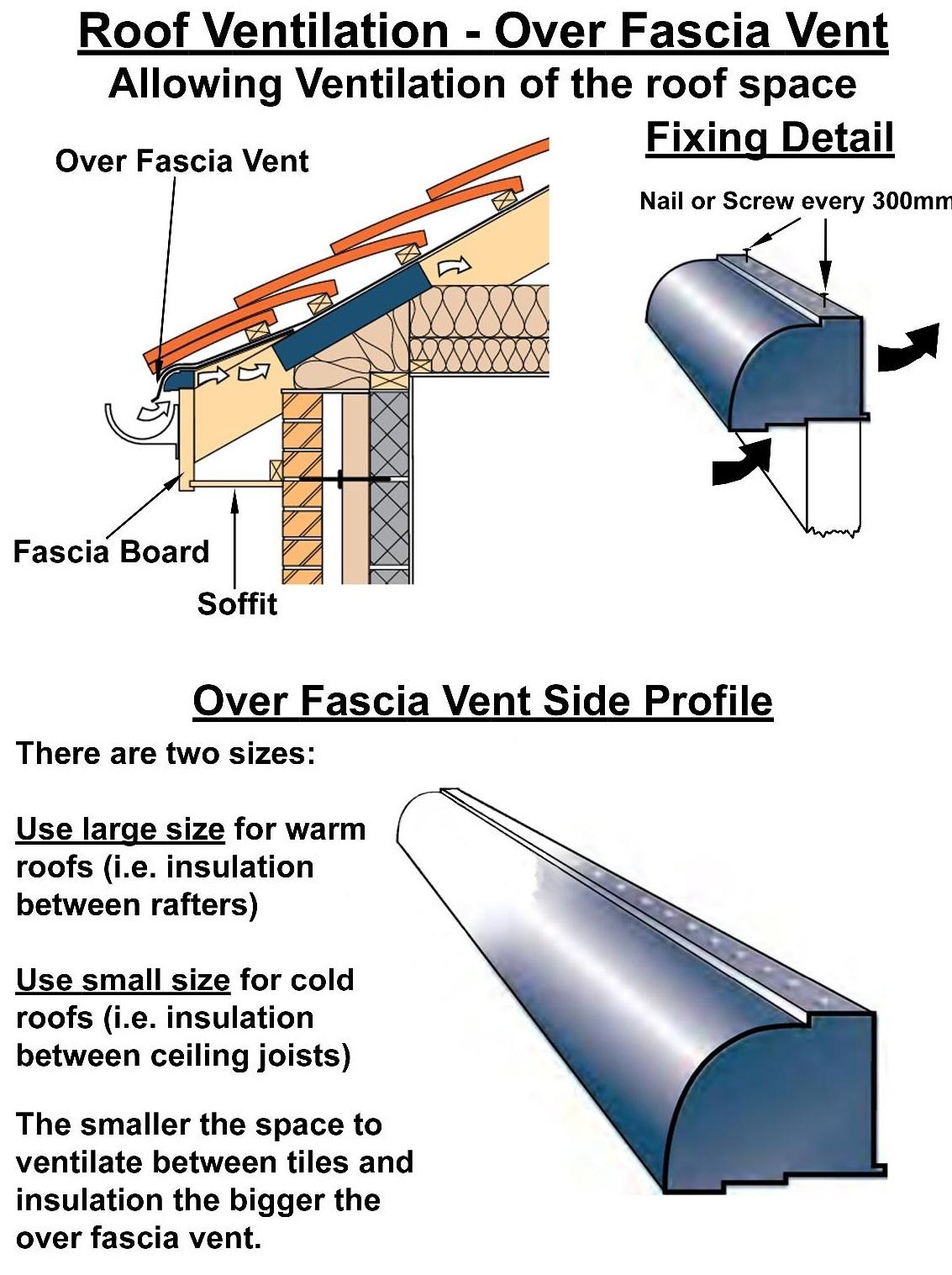

Radian Posted October 2, 2022 Author Posted October 2, 2022 On 02/10/2022 at 08:23, ProDave said: That is why I am so glad we chose a warm roof this time and why I thoroughly recommend a warm roof vs a cold roof. No need to provide mouse sized ventilation openings. Expand There are some discrete eaves vents that sit on top of the fascia, we have those to ventilate our house (cold) roofs. These have a fine-pitched insect grille that no mouse would get through. But I was just wondering about this wonkeedonkee description of them here : Use larger ones for warm roofs? What are they talking about? Our new garage extension has a cold roof but a breathable membrane so the 50mm air gap between the insulation and membrane apparently makes it unnecessary to have any additional vent openings. The foil backed plasterboard inside is meant to control vapor getting to the insulation layer but will be full of holes for electrical stuff. Next stop for the vapor; the the un-taped insulation. On the bright side, at least the vapor has an exit route, on its way past the cold outside air that's replacing it 😭
