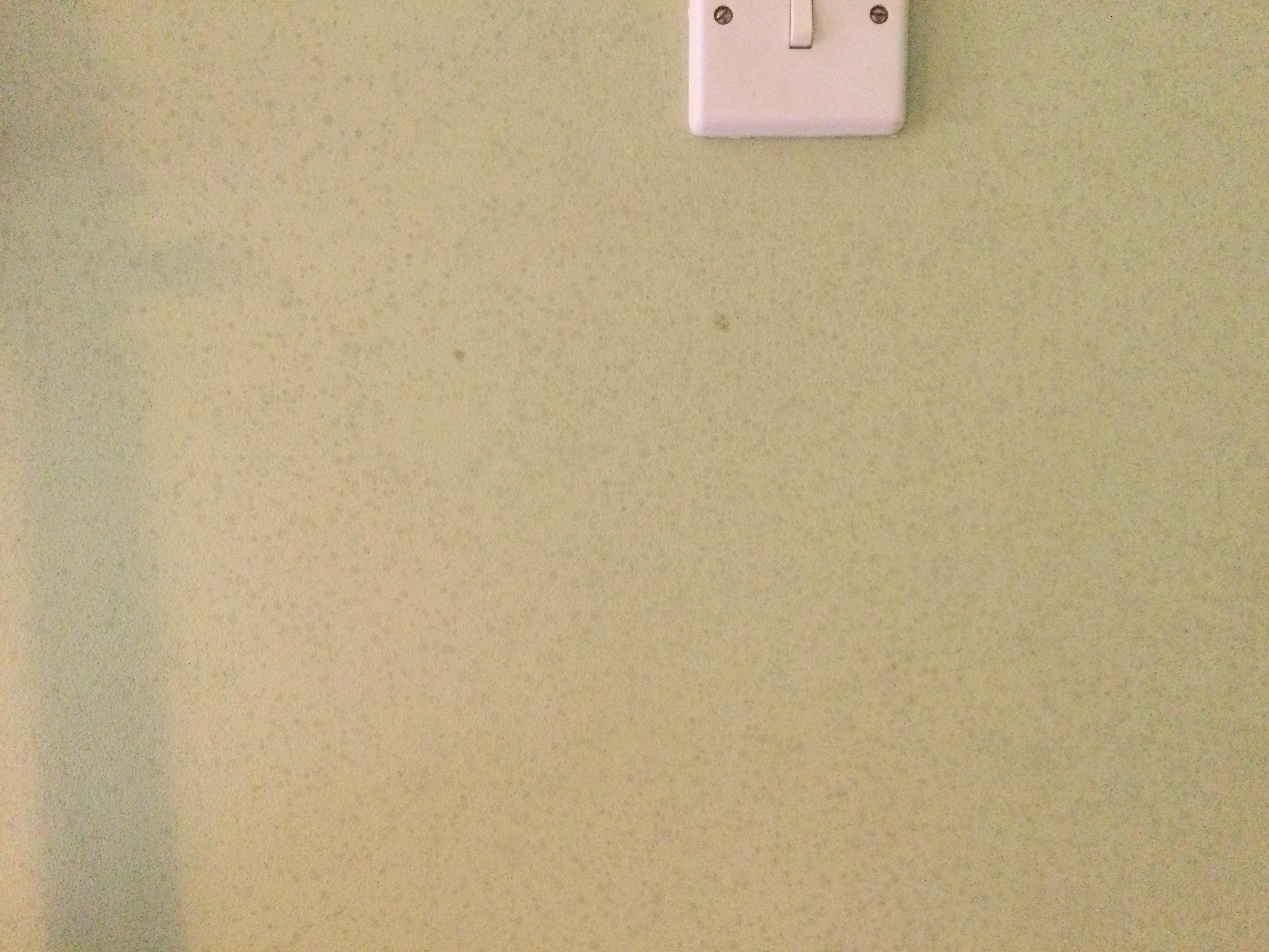

Off topic but just to show an eg of just one typical aspect of this 'thing' here I talk about. This room renovated 3 years ago, insulation board put under this very wall example here, suggested by folks on here. This wall has 50mm of insulation total within it's depth. Not huge no, but something.
This pic is my nearest kitchen wall to where I sit alot here on the iPad next to a lovely view out me window. The area of this wall  (RHS of window).. the middle 'head level' third of it then.. is covered with this uniform mould. The wall third above is clear. The third below is clear. The wall left of the window & all other wall areas of kitchen: clear. Breath combined with the 'thing' --is-- the cause. You dont have one inch of wall like this. Nowhere you've known or visited, has a wall like this.
I've never known -anything- like it, I've never seen anything like it anywhere I've ever been in/ lived in/ visited, here, abroad, in my entire life. Something*... something... is reacting with my breath ( & the heavy innitial breathing pain in my chest undoubtedly links to it too)... which hits a wall, & causes this mould. This is the '*thing' I talk about affecting your breath. The doors' panes saturation cannot be caused by my breath, as it's so much, & occurs when Im away. But a combination of factors causes this massive, unusually-so, moisture-affected different wall areas have -only- one common denominator: the air: the atmosphere: the microclimate here.

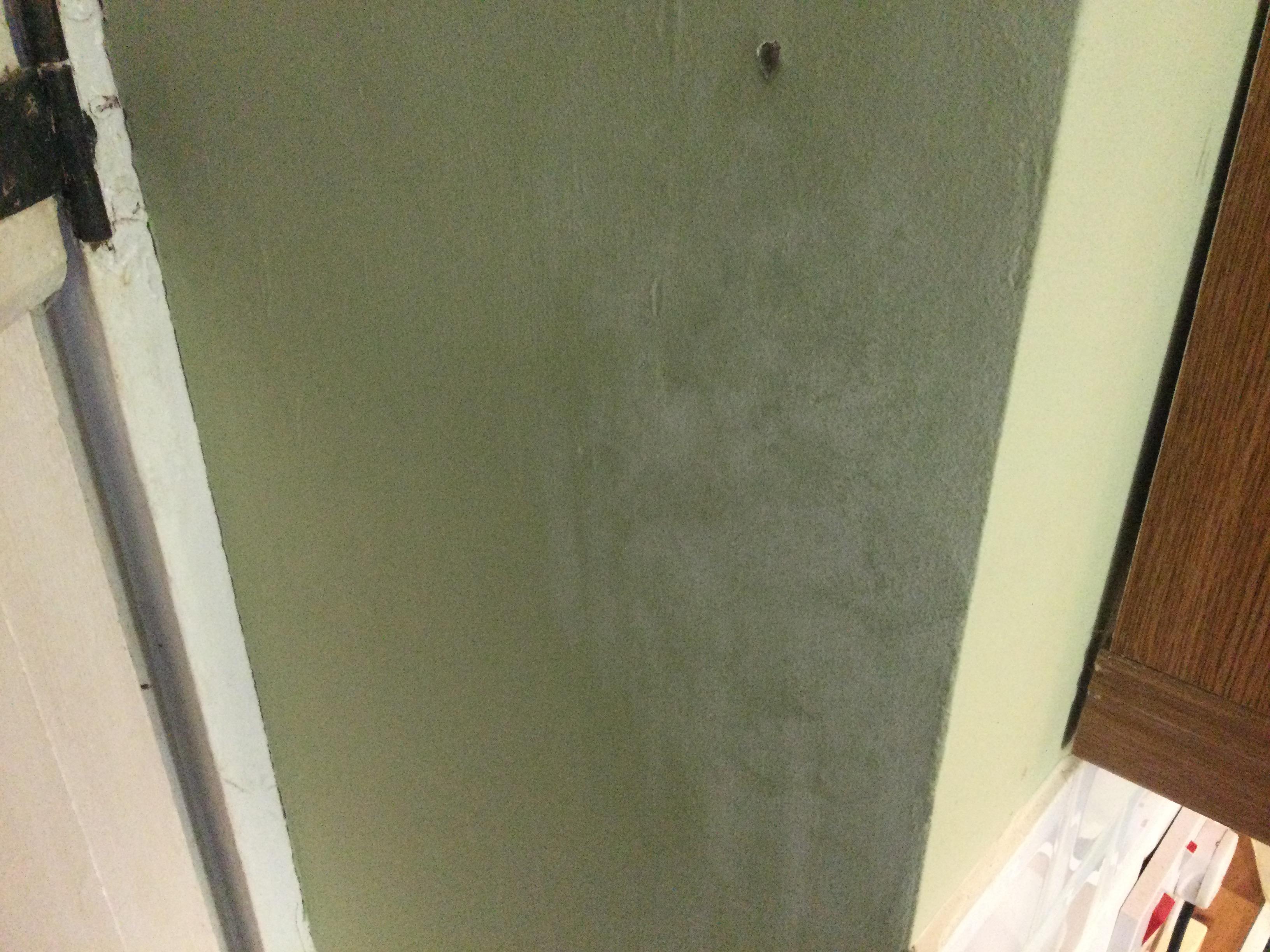

And here is another, small very localised yet different patch of some entirely different form of mould: this is formed where my hats touch up against the side wall hanging from a peg on the kitchen door, when it's opened (alot of the time). Very unusual goings on.
Its extremely difficult to remove too. It is an addition to the newish painted room, it's not a rubbing away of the paint. It is some form of whitish mould, definitely ( as Ive removed it twice in 3 years by scrubbing damn hard.. but it just reappears within months). Never known anything like it. It's just cursed with this moisture issue here.
