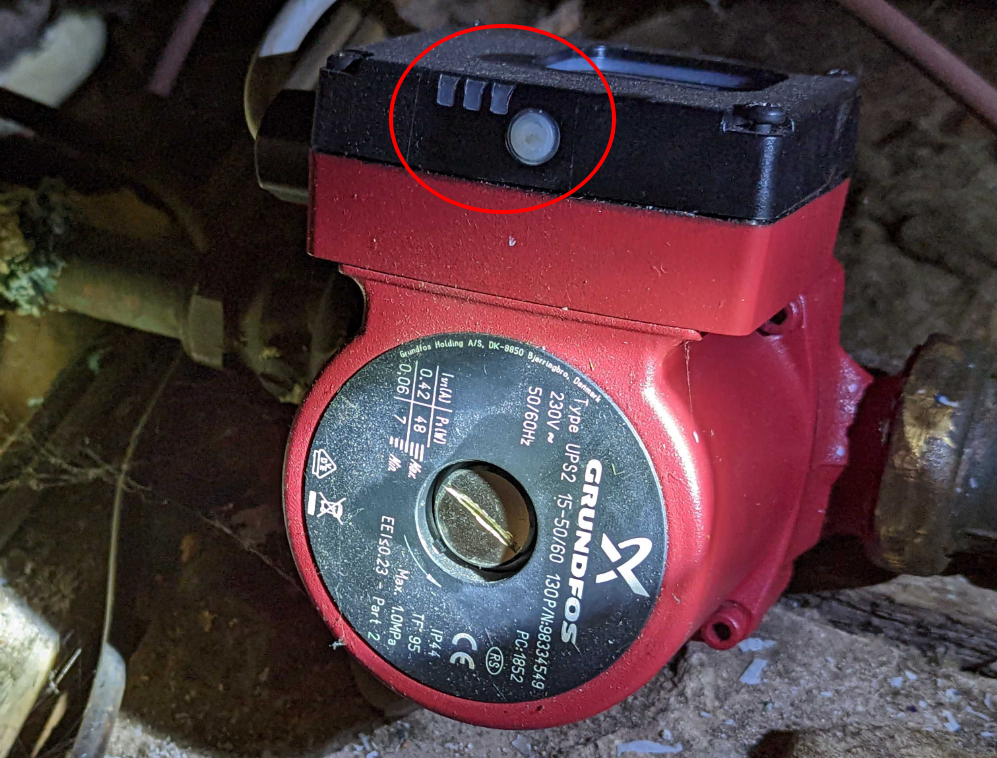

DannyG Posted September 19, 2022 Share Posted September 19, 2022 Hi all As the colder weather has hit and the heating has come on a couple of times, I've noticed a couple of the furthest radiators are not heating up very well. I went to turn up the pump speed but noticed the selector button isn't working at all (no lights are even on). The pump is obviously working though as we're getting heat to the rest of the rads, which is odd. Any idea as to to why this might be? Link to comment Share on other sites More sharing options...

Marvin Posted September 19, 2022 Share Posted September 19, 2022 1 hour ago, DannyG said: Hi all As the colder weather has hit and the heating has come on a couple of times, I've noticed a couple of the furthest radiators are not heating up very well. I went to turn up the pump speed but noticed the selector button isn't working at all (no lights are even on). The pump is obviously working though as we're getting heat to the rest of the rads, which is odd. Any idea as to to why this might be? Remove centre cap with flat screwdriver observe if inside is going round. Link to comment Share on other sites More sharing options...
Marvin Posted September 19, 2022 Share Posted September 19, 2022 (edited) Hi @ dannyg A little water will come out. If its spinning put the cap back in. Pump working. If you get a lot of bubbles from the hole then air in pump. Next thing to check would be the set up you have re port valves and then messing with rads. What's your result? Edited September 19, 2022 by Marvin Clarification Link to comment Share on other sites More sharing options...

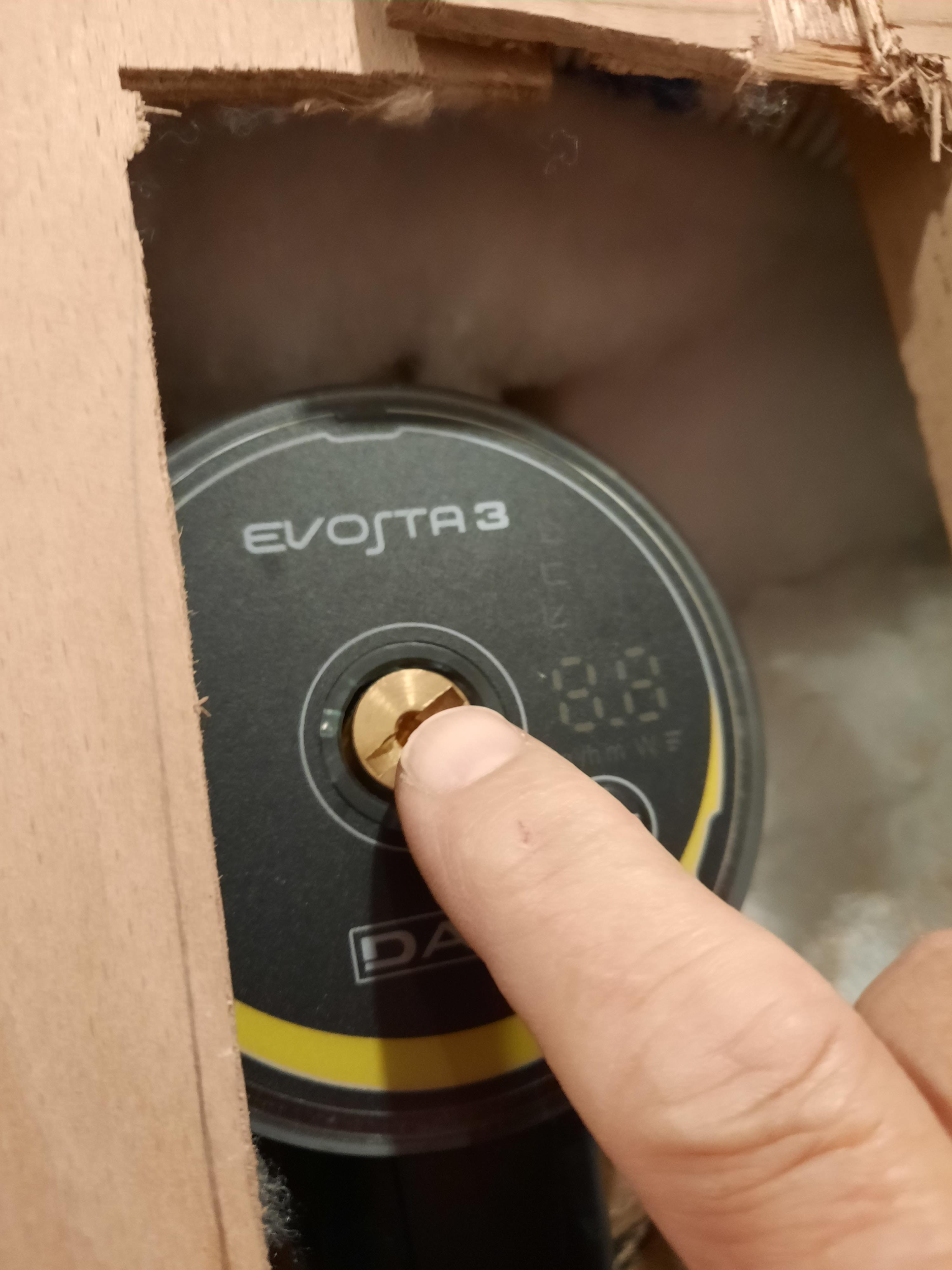

DannyG Posted September 20, 2022 Author Share Posted September 20, 2022 On further investigation it looks like the pump is not working at all and perhaps never has. I'm perplexed at how the whole house apart from two radiators have been getting heat for the last few winters! New pump incoming. Link to comment Share on other sites More sharing options...

ProDave Posted September 20, 2022 Share Posted September 20, 2022 1 hour ago, DannyG said: On further investigation it looks like the pump is not working at all and perhaps never has. I'm perplexed at how the whole house apart from two radiators have been getting heat for the last few winters! New pump incoming. Before ordering a new pump and booking the plumber, check that electrical power is reaching the pump. It might be an electrical problem. Link to comment Share on other sites More sharing options...
DannyG Posted September 21, 2022 Author Share Posted September 21, 2022 @ProDave Yep it had power, that was the first thing I checked. New pump now fitted and all rads heating up nicely. Link to comment Share on other sites More sharing options...
