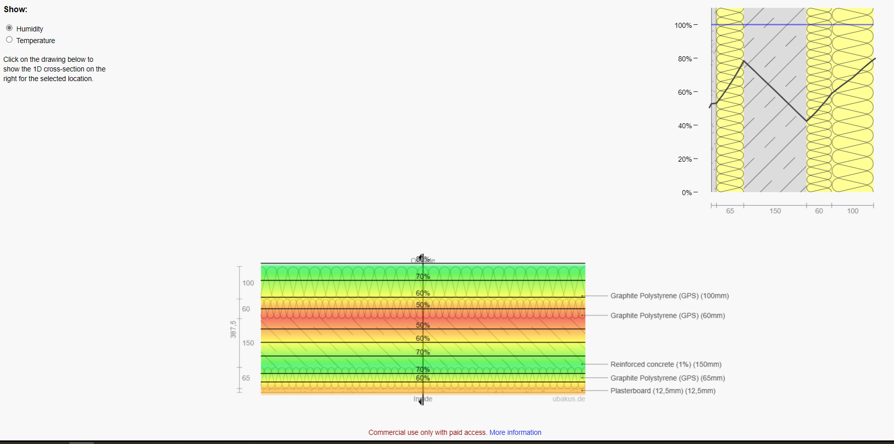

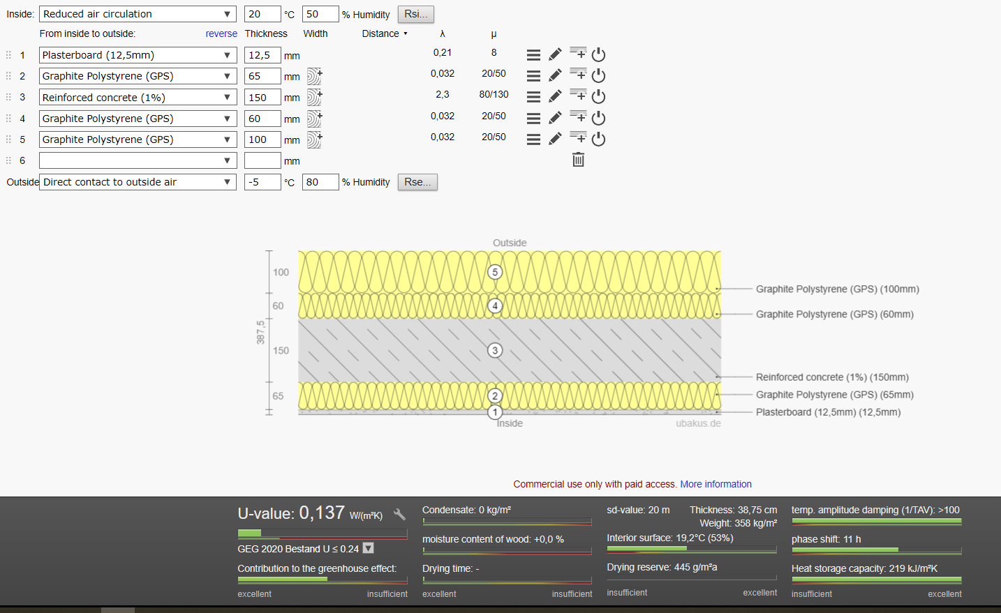

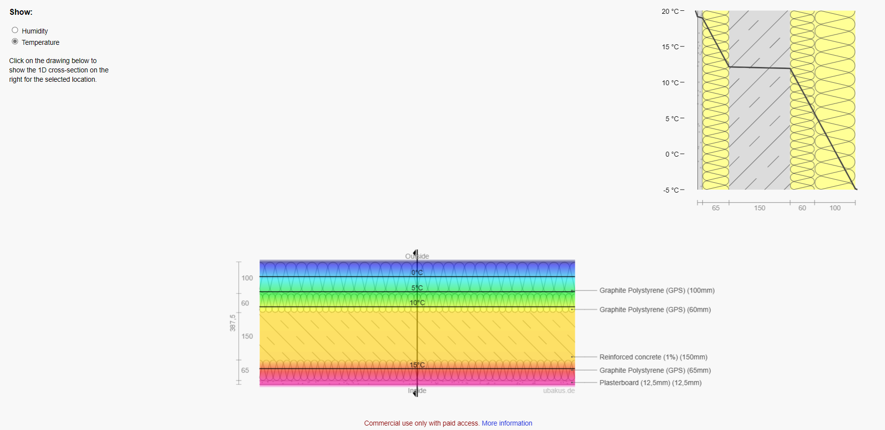

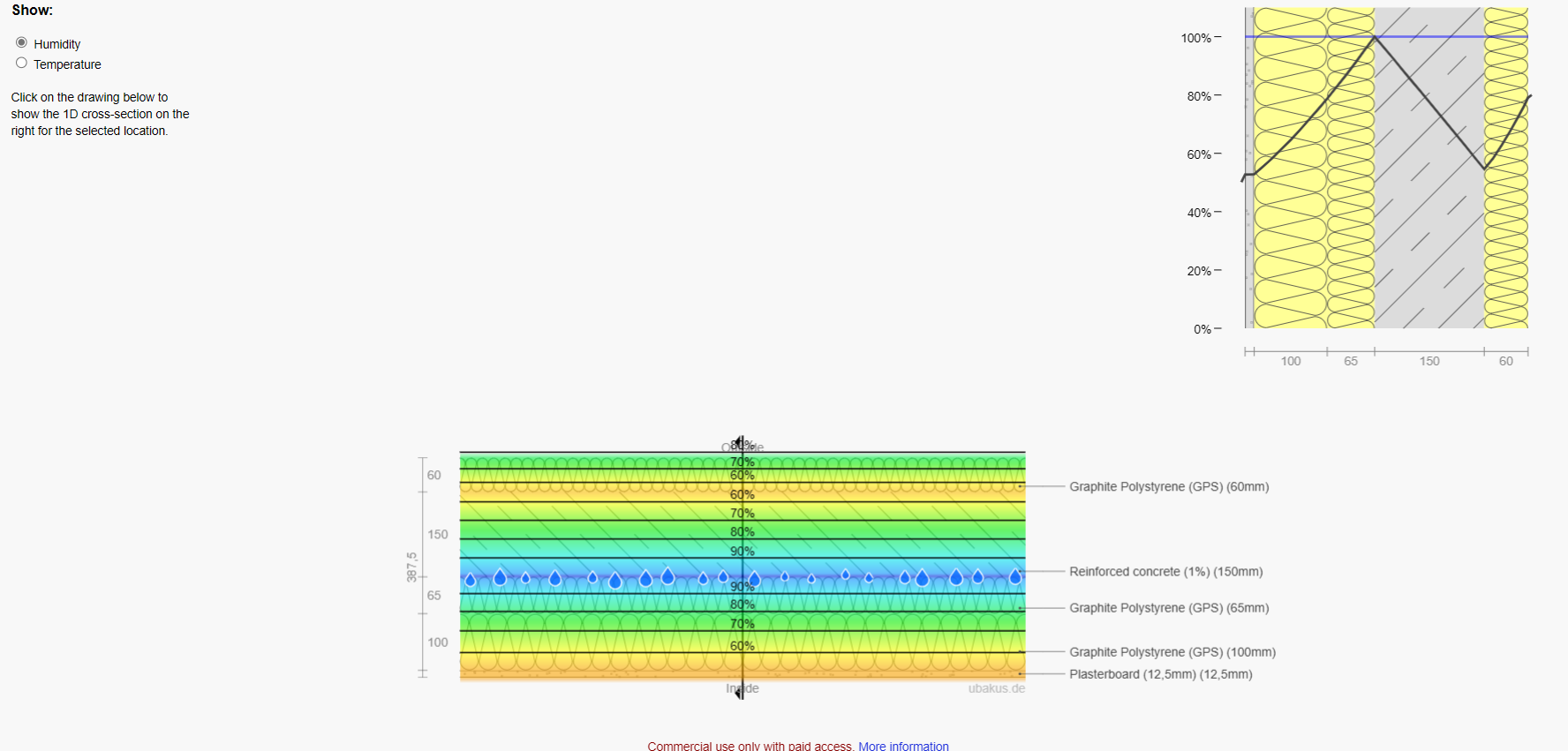

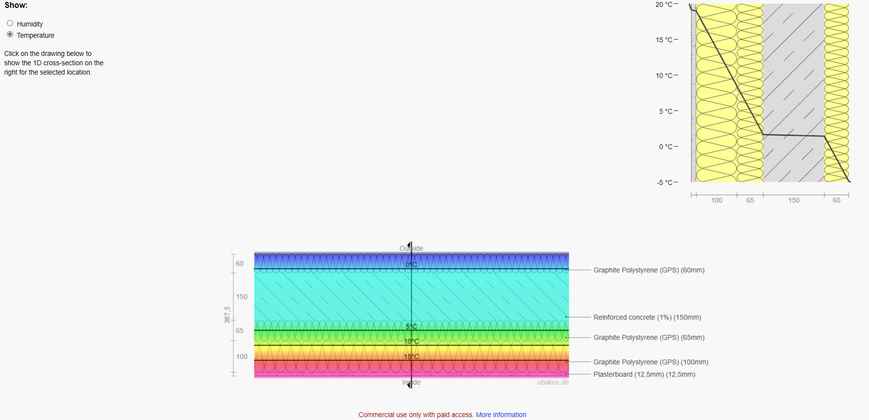

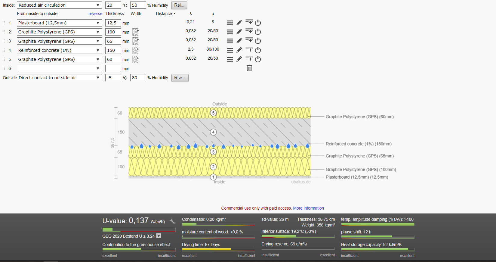

Jenki Posted February 5, 2023 Share Posted February 5, 2023 Resurrecting this question with a specific build. I'm building with ICF poly steel blocks. the blocks as standard are 65mm EPS 150 concrete and 65mm EPS. to improve the U value I will be attaching Extra insulation. the question is should this be internal or external. I'm leaning towards IWI for the following reasons: The build will be cold roof, so if I go internal I save around 25SqM insulation on the gables The external cladding will be more secure as the battens are fixed through a thinner section of EPS I can insulate before any internal walls are built, and thus making airtight is easier. I can still screw the plasterboard through the IWI & into the metal webs of the ICF Property heated with UFH We are in the Highlands - so do not have to worry (just hope) about external temperatures getting too hot. The above goes against a lot of the recommendations above, but as its new build some of the reasons can be worked around? Would appreciate any thoughts TIA Link to comment Share on other sites More sharing options...
Iceverge Posted February 5, 2023 Share Posted February 5, 2023 There's your two options. I made a 5mm mistake with one side of the ICF but it won't make much difference. My guess is that extra external insulation will be better for thermal bridging of internal walls and windows etc as with the extra internal insulation the concrete will be below 5 deg on cold days. Given ICF isn't the cheapest have you considered masonry build as you're going to use extra insulation anyway? You'll use more concrete if you opt for the internal option of extra ICF insulation. 1 1 Link to comment Share on other sites More sharing options...
Jenki Posted February 6, 2023 Share Posted February 6, 2023 @Iceverge. Thanks for the effort in the answer above. the above out weighs my Pro's.. I didn't have the ability to model the core temp, and this was a concern. Thanks again... The decision to move to ICF was made with a few factors, the major one being that our location dictates difficulty and cost getting materials to site. with ICF, its one delivery and no extras for the house structure. When getting costs together - £400 / £800 for delivery of bulk items was common or use someone more local and pay a massive premium. getting EPS around Inverness is difficult as nobody stocks it. the reason - "you cant use that up here its too cold." Another factor is the inherent Airtightness. We regularly see 20 /30 MPH winds throughout the year, and the solid feel of concrete appeals. I wanted to stick build on site, but when I was doing my costings the ICF route was not too more expensive when you add in the insulation varieties, membrane and tapes and deliveries. MY ICF blocks and extra insulation is 9.5K, 2K of rebar and 6K of concrete including slab. for 90Sq M. Lastly I'm too slow to lay blocks, and my budget doesn't have external labour, so it has to be in my skill set. Link to comment Share on other sites More sharing options...
