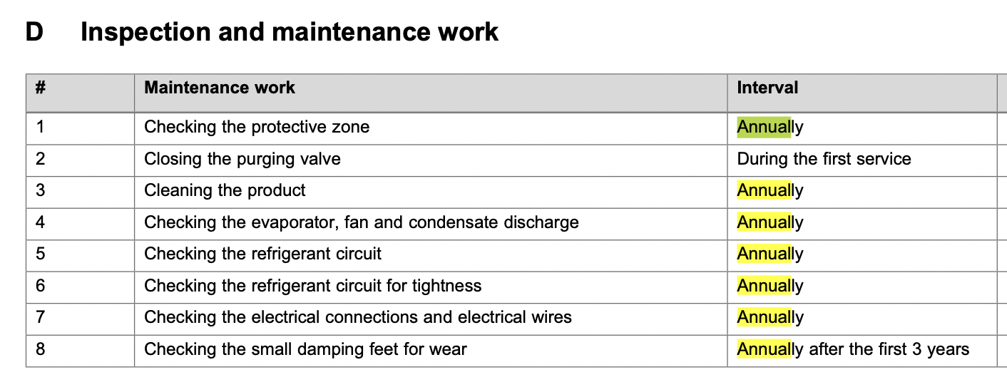

Dreadnaught Posted September 14, 2022 Share Posted September 14, 2022 Here's the list for my ASHP (not installed yet): Link to comment Share on other sites More sharing options...
