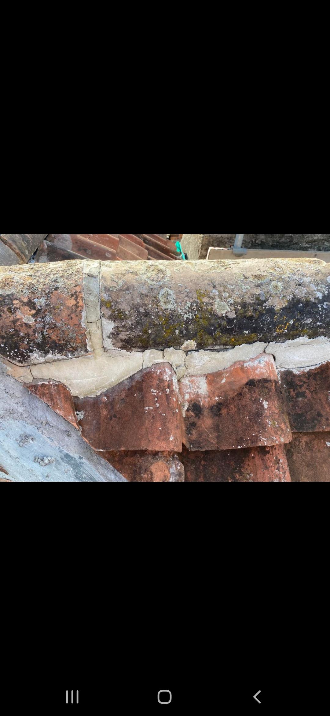

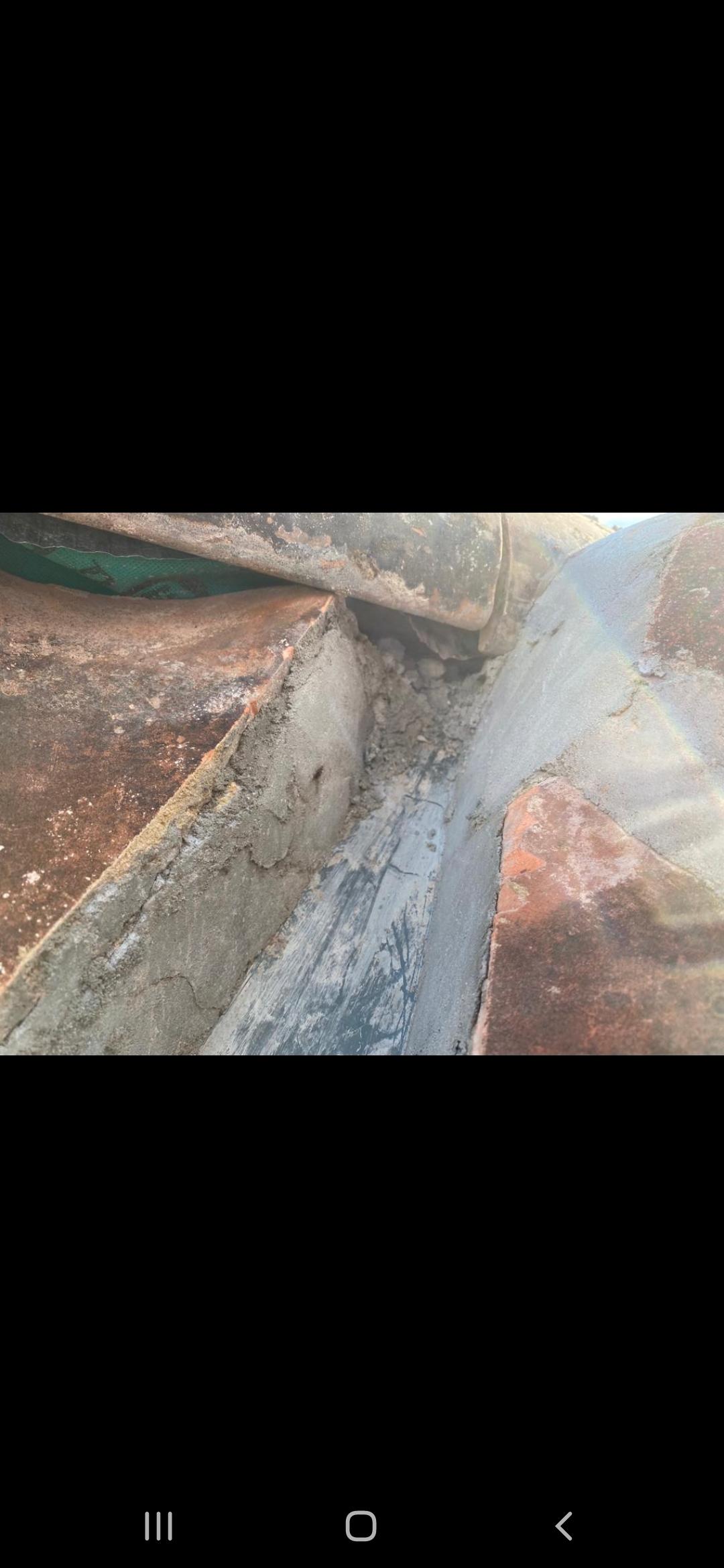

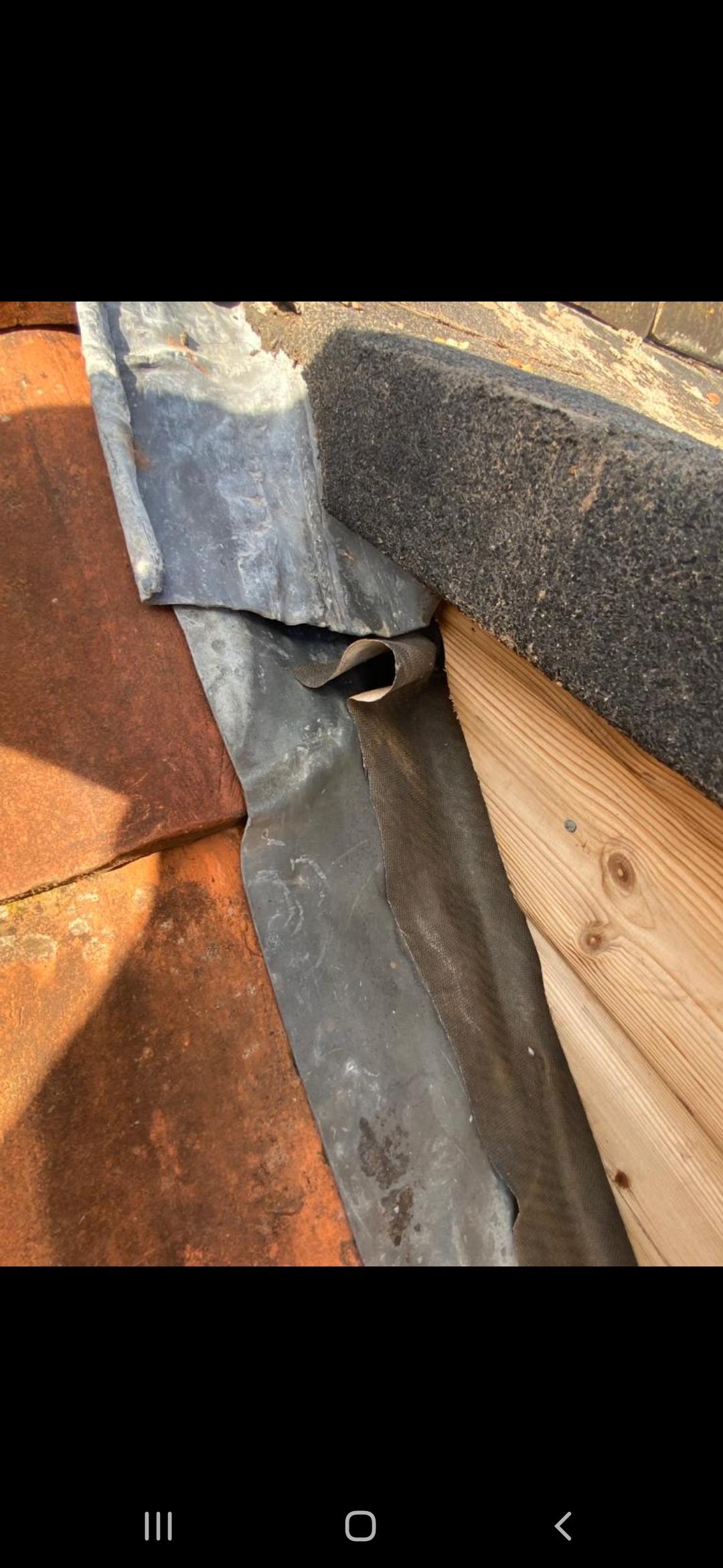

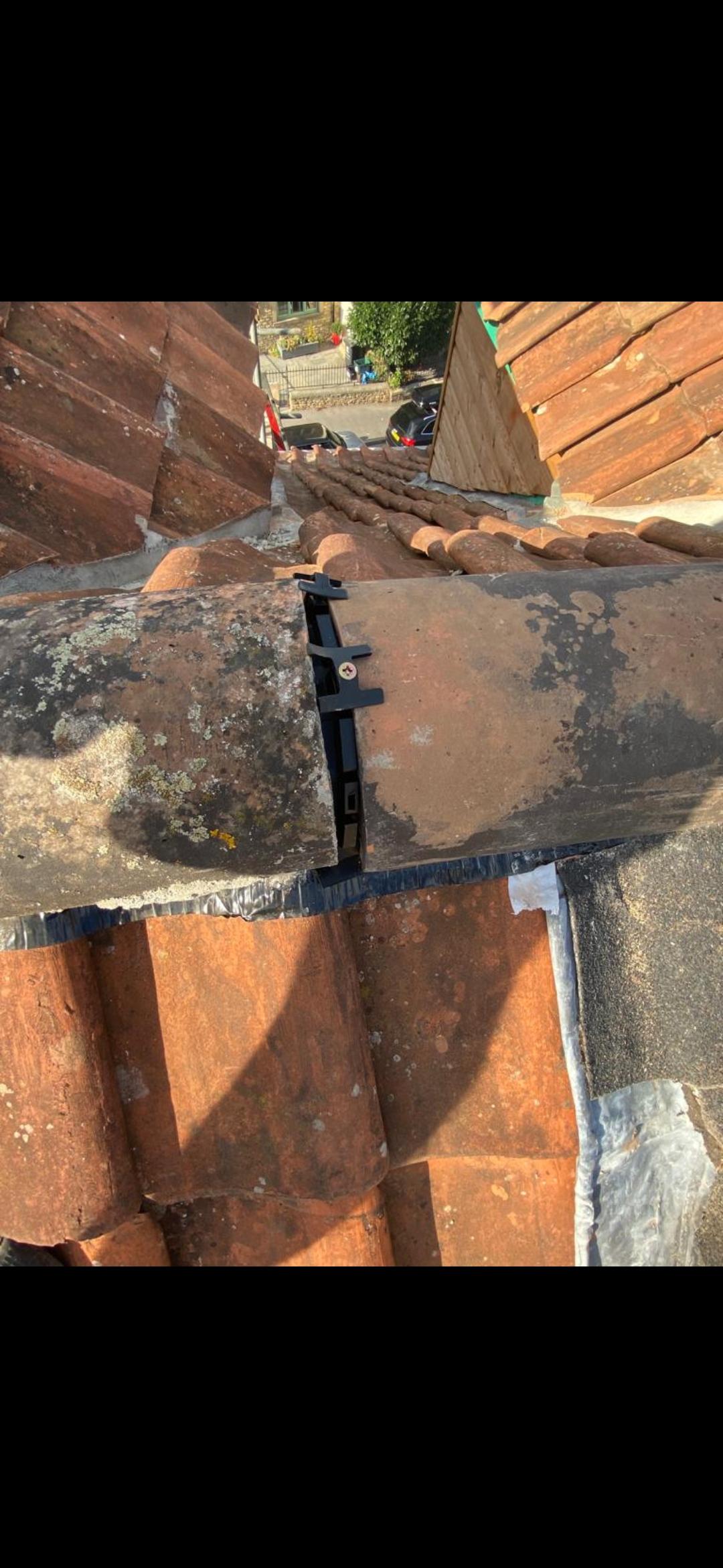

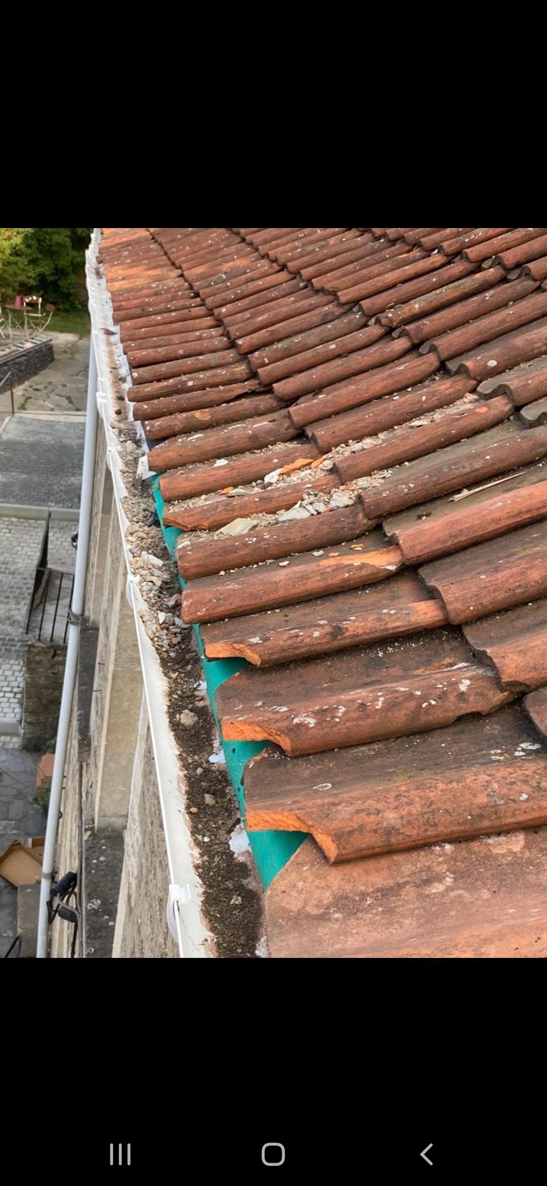

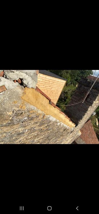

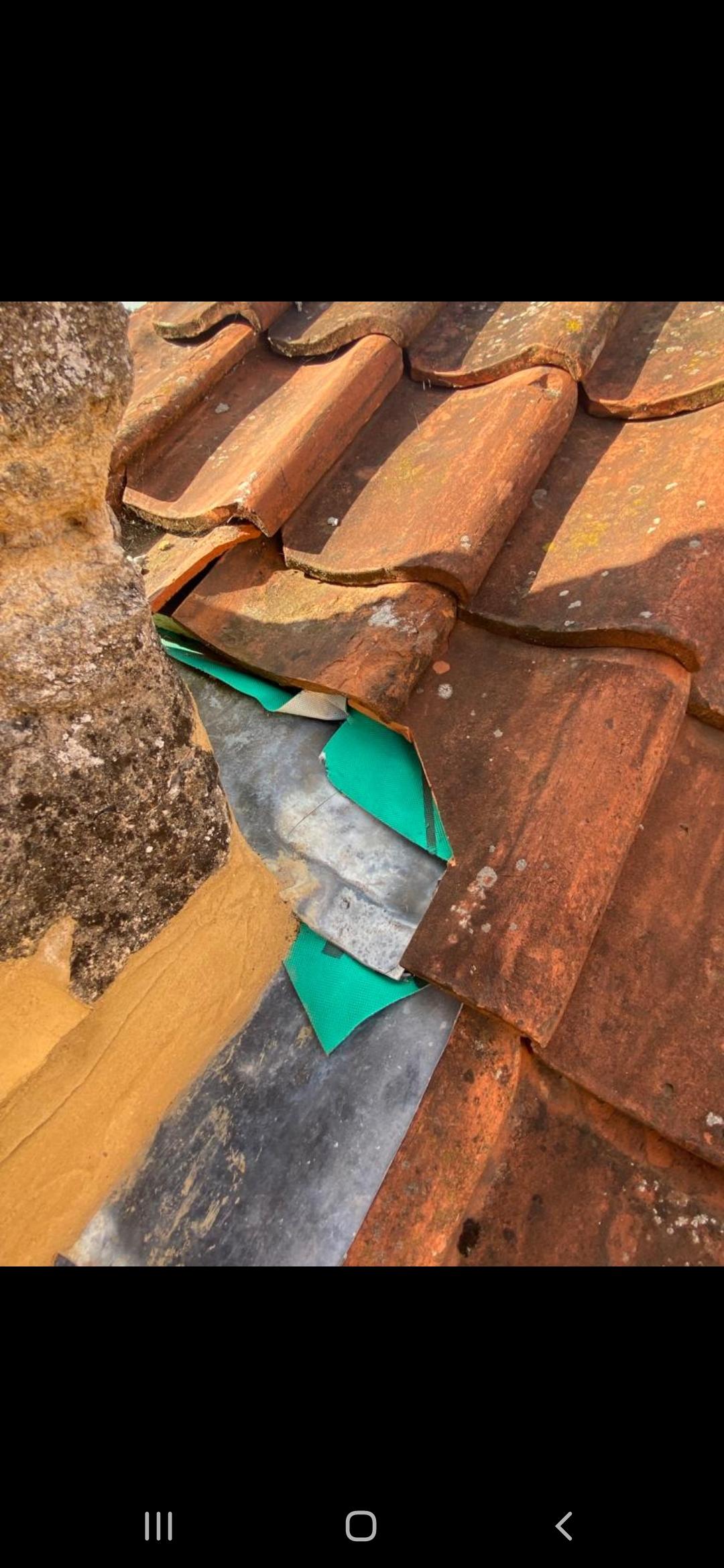

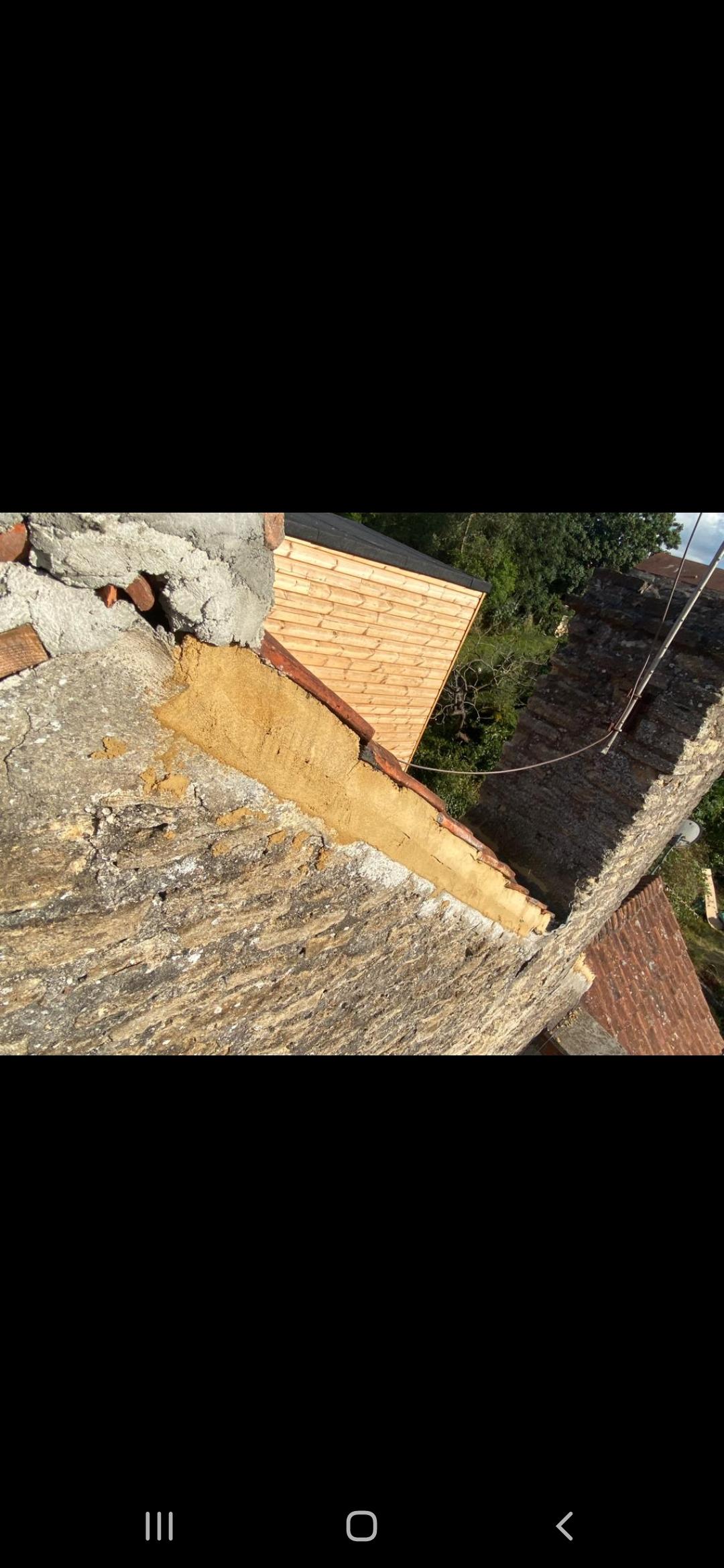

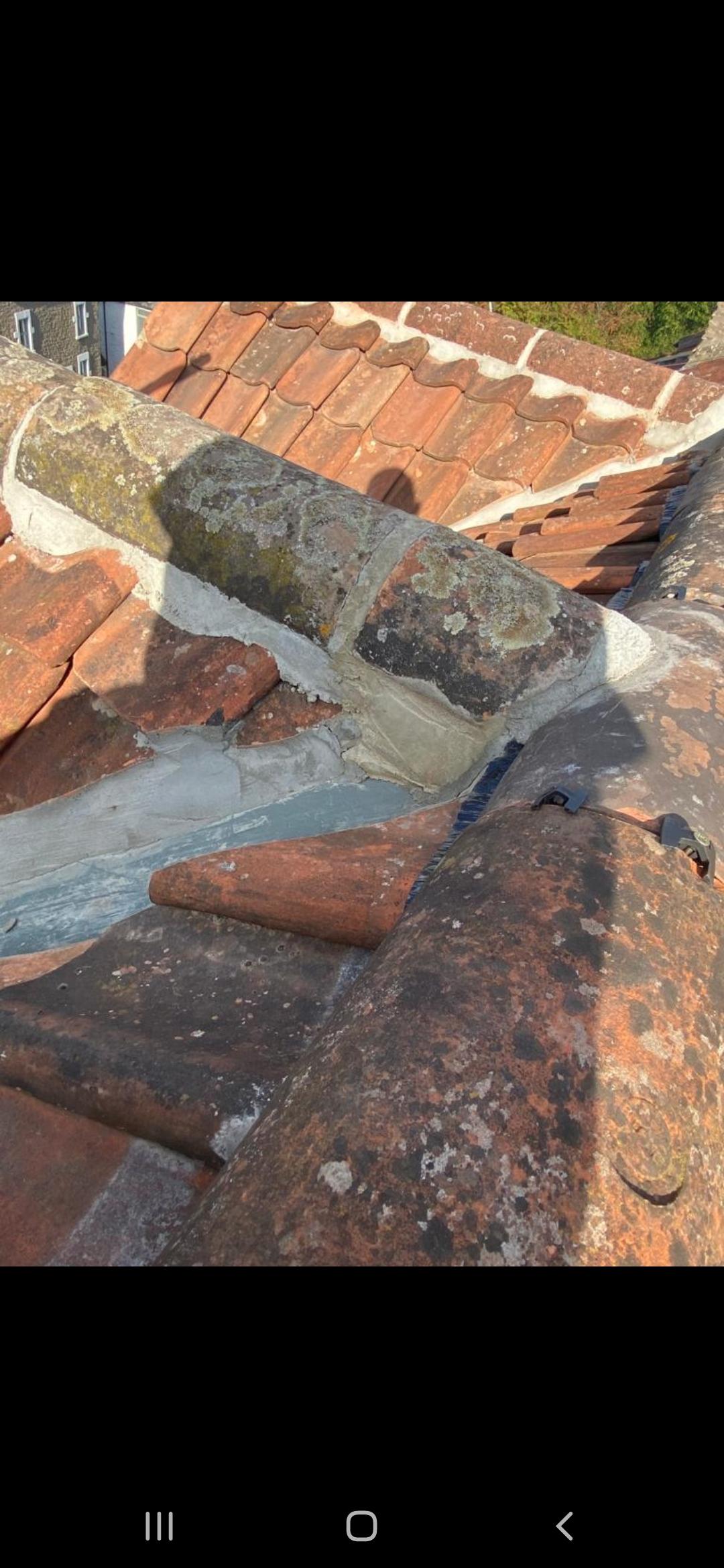

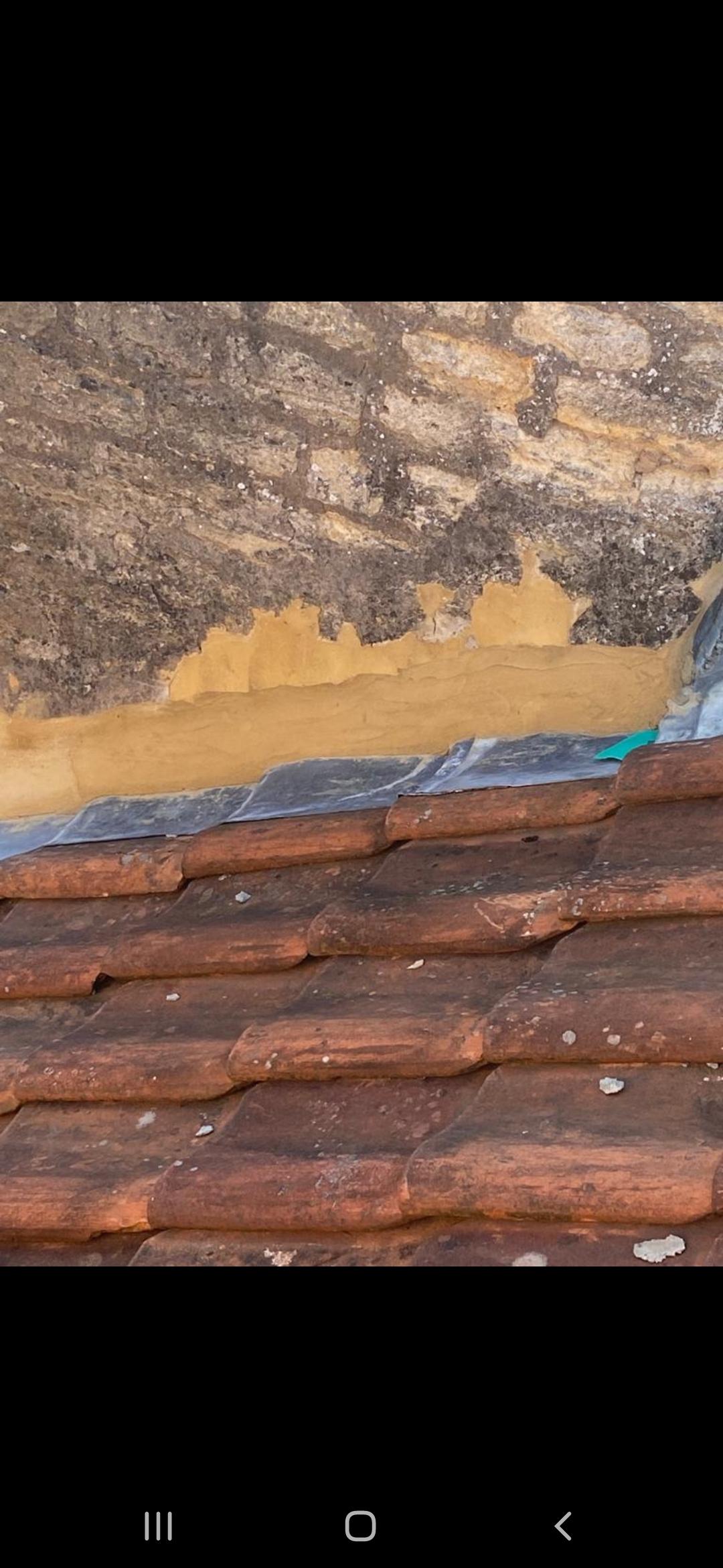

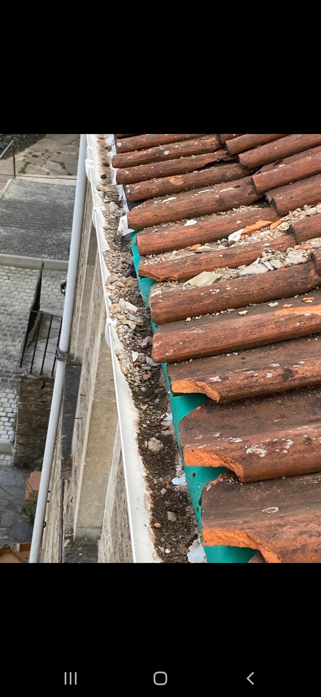

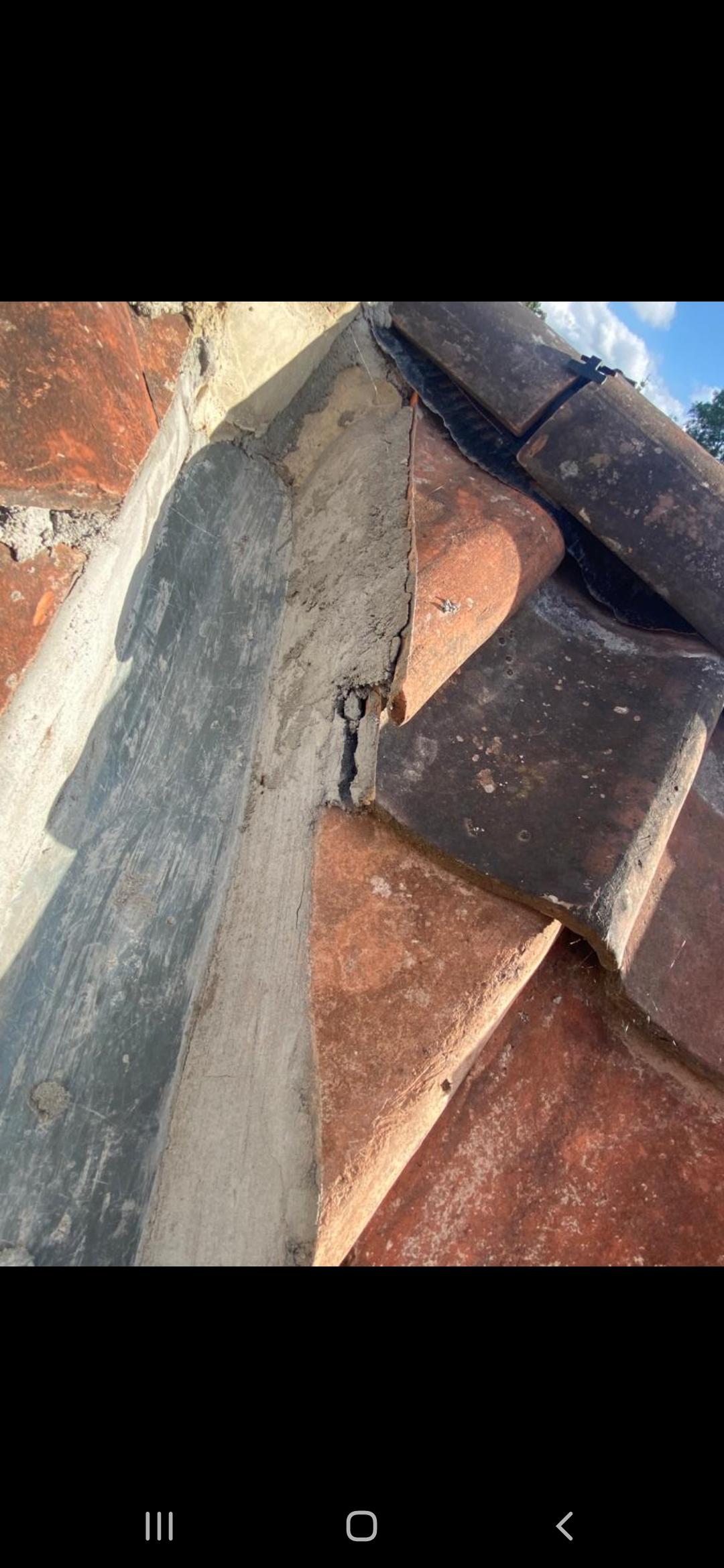

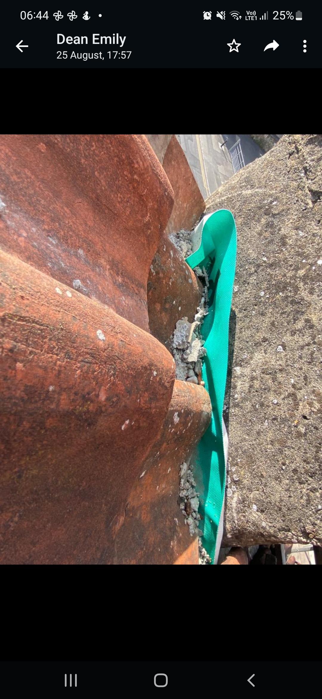

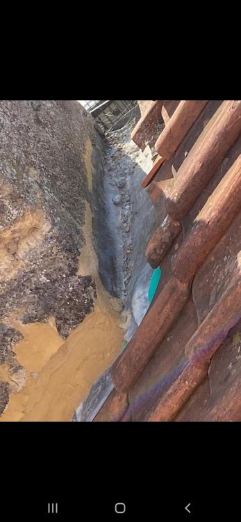

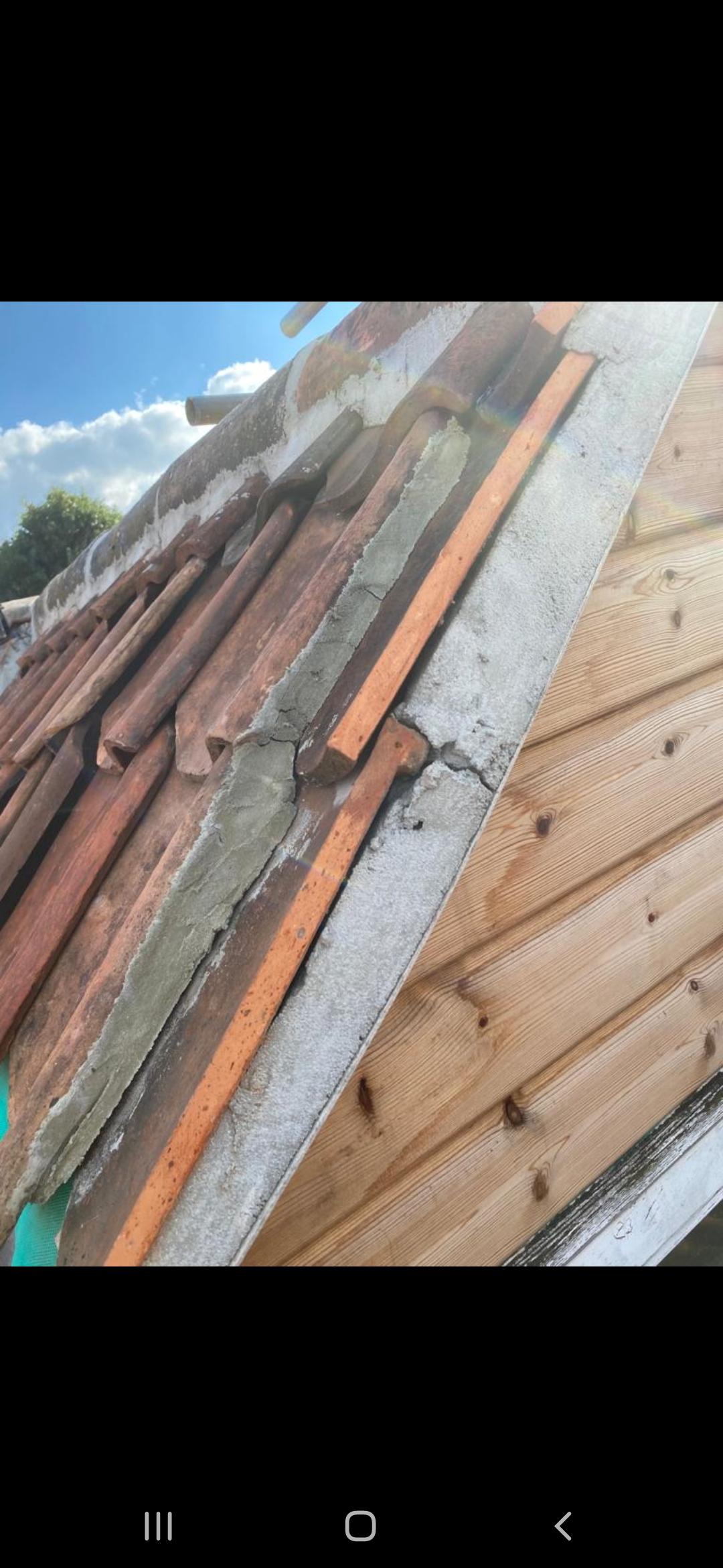

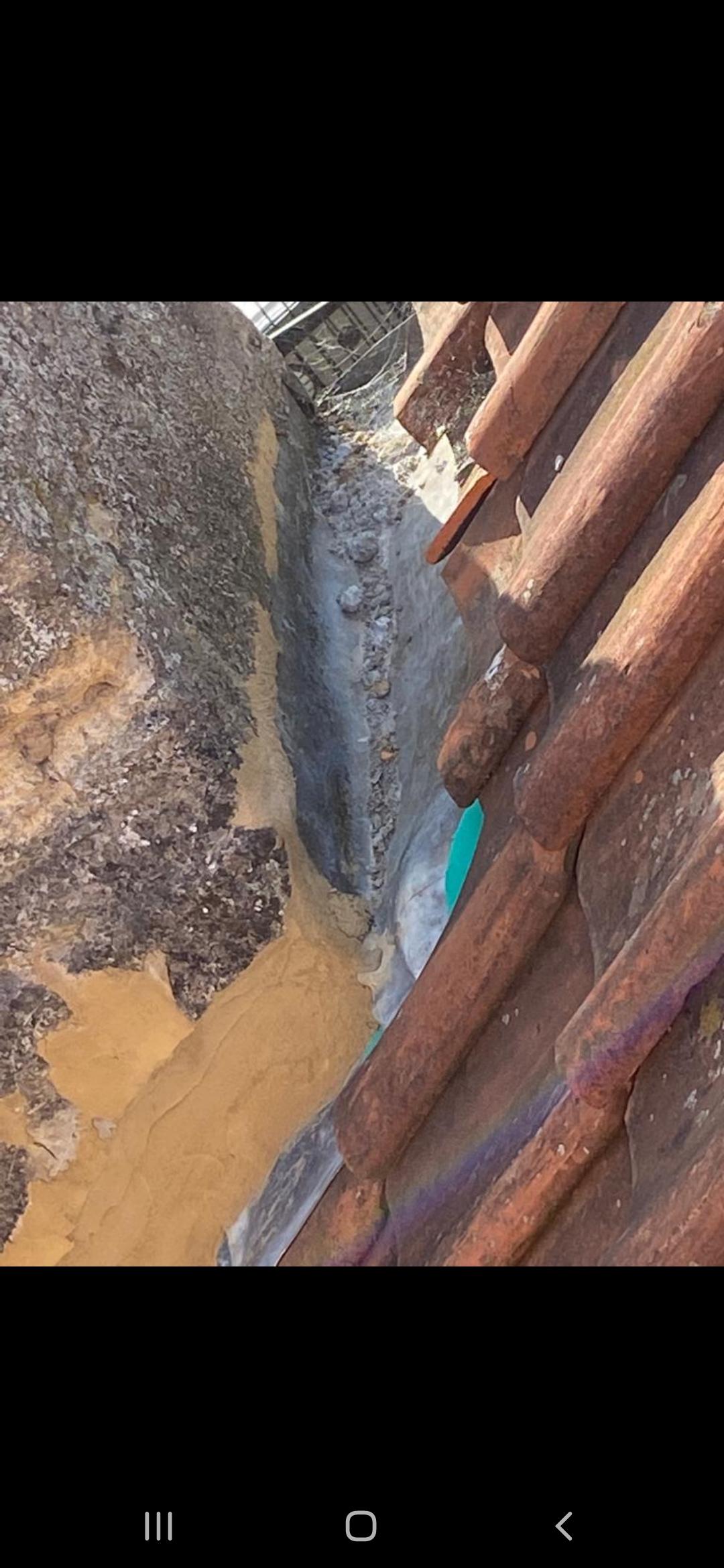

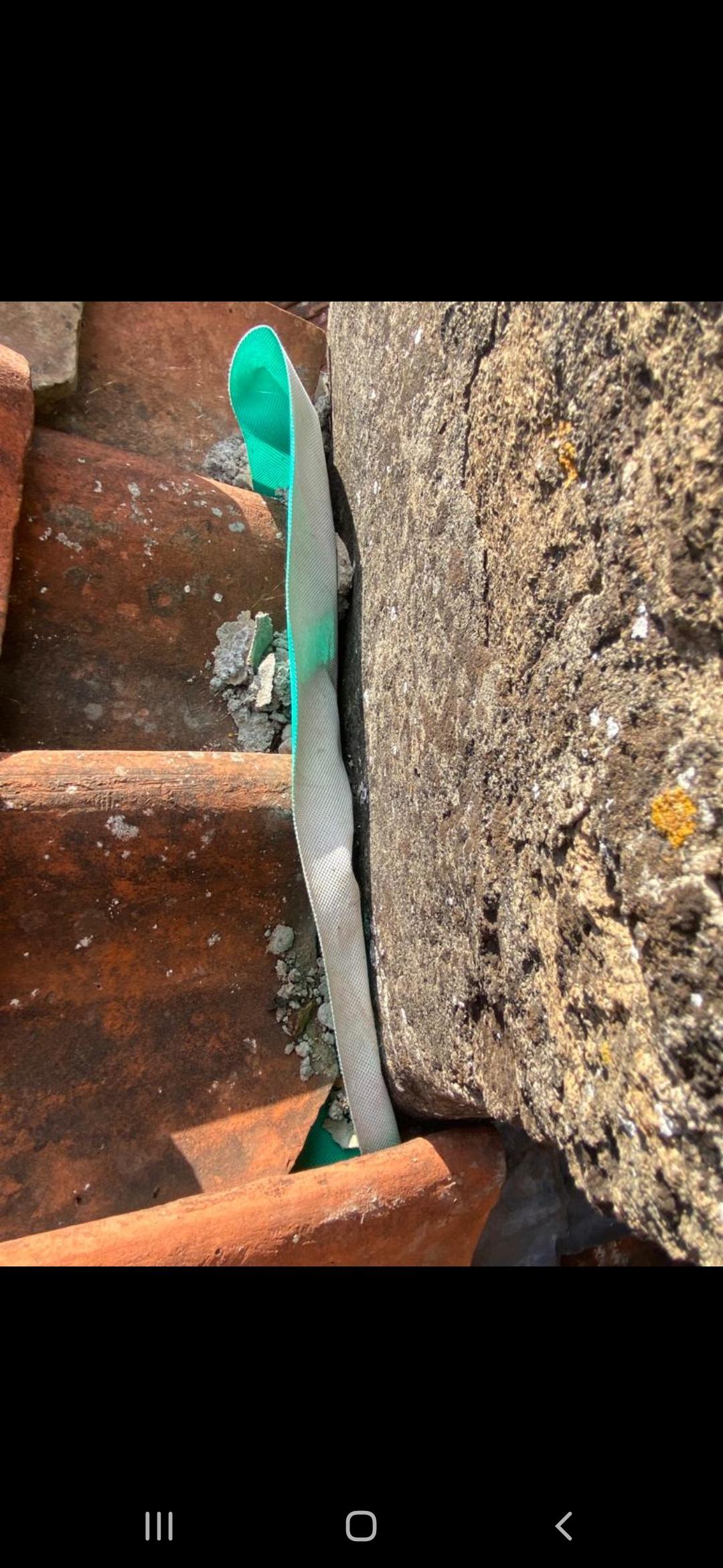

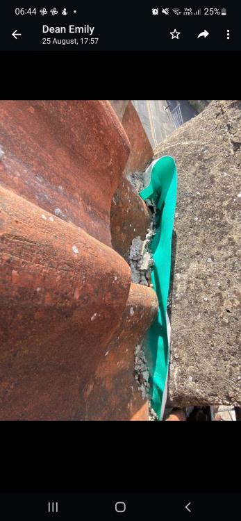

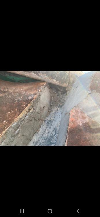

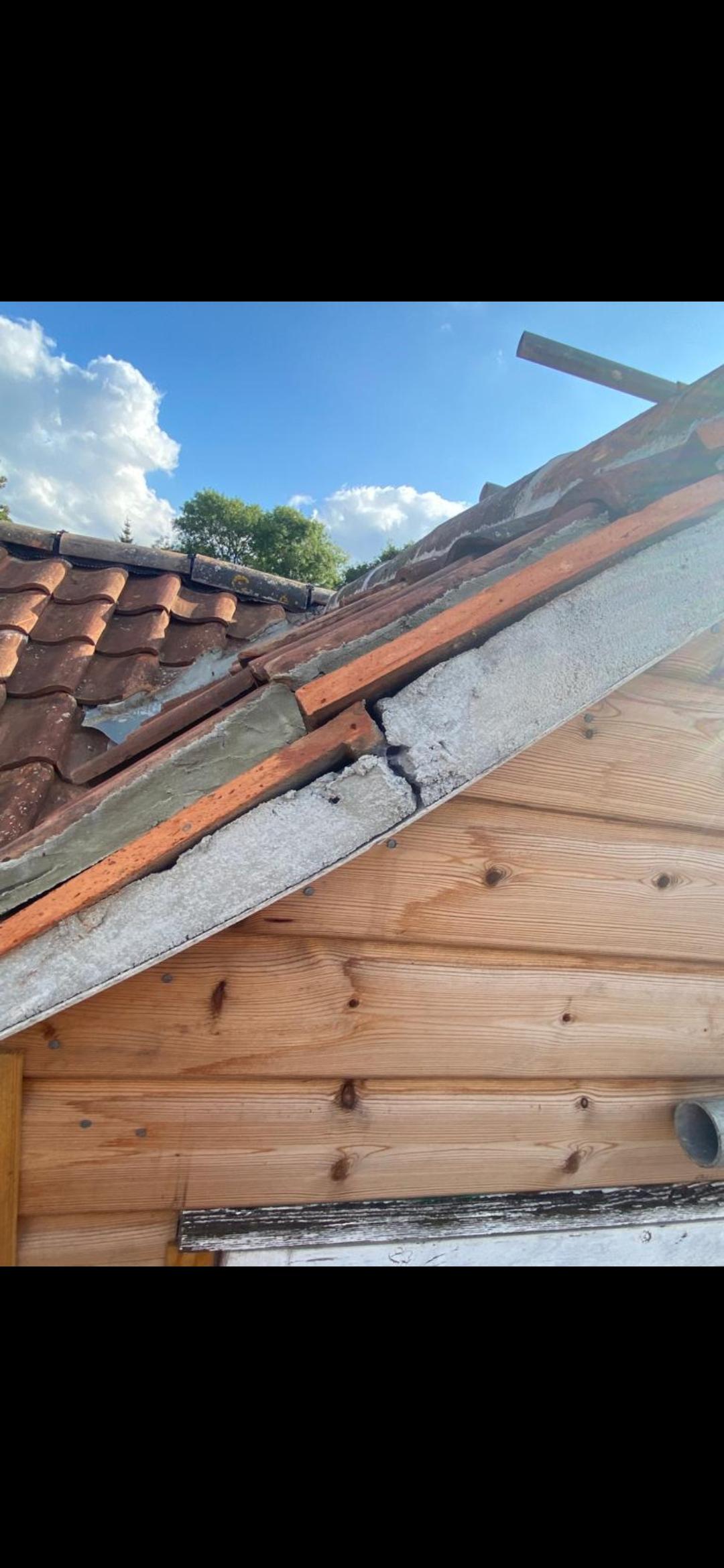

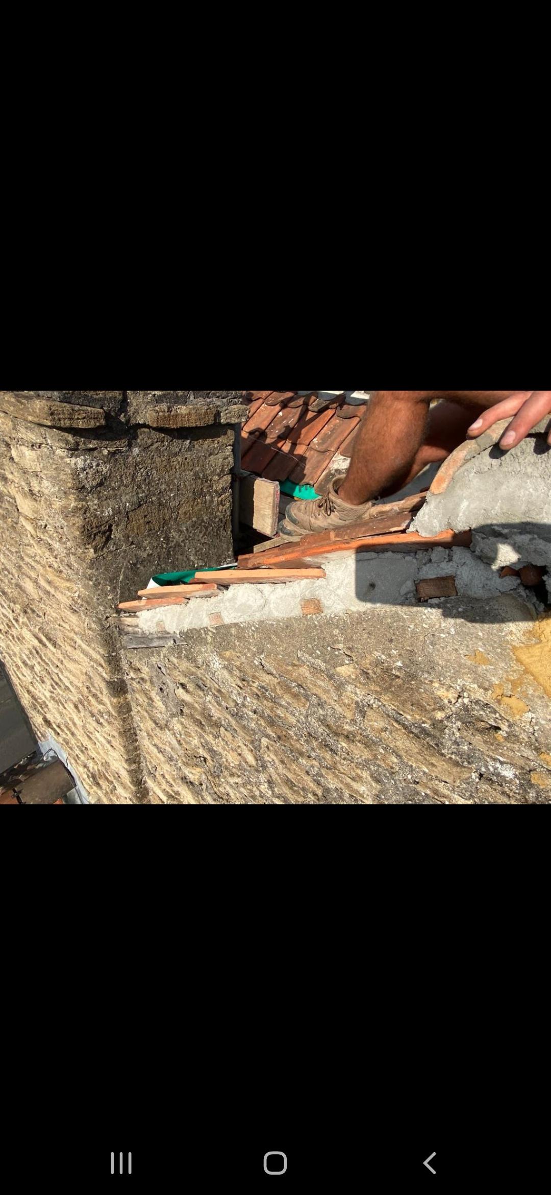

Nrm5190 Posted August 31, 2022 Posted August 31, 2022 Unfortunately my old man has had some cowboys in to refelt and batten his roof, as well as a few other minor repairs, he now wants a Velux installed and the new roofer was absolutely shocked at the previous workmanship, take a look for yourselves... I've got a tonne more pictures, but it exceeded the file size. At a bit of a loss as what to do next to be honest, so sorry if this is the wrong place to post this but I just need some validation that it's so bad I can laugh instead of cry. 2

Nrm5190 Posted August 31, 2022 Author Posted August 31, 2022 2 hours ago, ToughButterCup said: This post makes grim viewing and reading. Its the sort of thing that brings the sector into (further) disrepute. It also underlines the importance of doing thorough Due Diligence. But, if you're old, living on your own ...... arggghhhh. Are the guys who did this known locally ? I really hope they haven't been paid ............ Known locally yes, my Dad basically just let them crack on with the job without getting a quote. They took £18,000 off him for this... I told them its shit and they've been out twice to 'fix' it, and now finally have admitted its a terrible job and they'll do anything to make it right. Naturally I've lost all confidence in their ability to do so. I'm actually concerned about letting them have another bash at it, but I genuinely don't think it could get much worse.

Carrerahill Posted August 31, 2022 Posted August 31, 2022 4 hours ago, Nrm5190 said: Unfortunately my old man has had some cowboys in to refelt and batten his roof, as well as a few other minor repairs, he now wants a Velux installed and the new roofer was absolutely shocked at the previous workmanship, take a look for yourselves... I've got a tonne more pictures, but it exceeded the file size. At a bit of a loss as what to do next to be honest, so sorry if this is the wrong place to post this but I just need some validation that it's so bad I can laugh instead of cry. What a mess, the sad thing is that I have seen really bad DIYers make a better job than these total pond-dwellers. It looks like they really don't know anything about roofing at all.
Nrm5190 Posted August 31, 2022 Author Posted August 31, 2022 Just now, Carrerahill said: What a mess, the sad thing is that I have seen really bad DIYers make a better job than these total pond-dwellers. It looks like they really don't know anything about roofing at all. I genuinely could've done a better job myself, the 'cladding' they used on the dormer rear and front is untreated pine, they didn't put any beading around the windows at first, was a 2 inch gap exposed to all the elements
