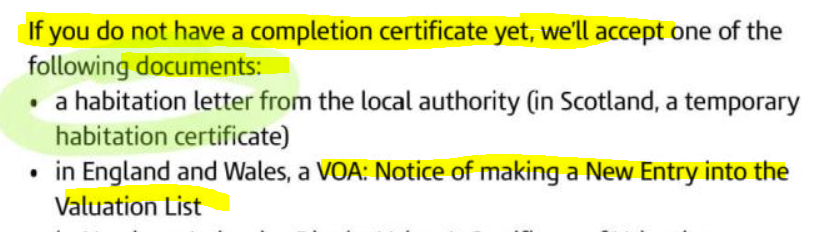

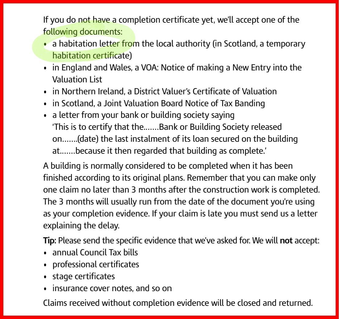

ToughButterCup Posted September 2, 2022 Share Posted September 2, 2022 On 31/08/2022 at 09:31, jack said: ... The notes say that something along the lines of the completion certificate being the usual document that will be relied upon, but that the applicant may choose to rely on another document such as a valuation listing confirmation or a letter from their bank confirming that a final stage payment has been made. The three months runs from the date of the chosen document. ... Correct, @jack But the LPA Valuation Officer may also initiate that process by visiting the site and declaring that (you) are substantially inhabiting the site, and therefore that Officer can choose to initiate the process of declaring your property as ready for inclusion on the Valuation List. So to refine your sentence above a little ... but that both the applicant or the Local Valuation Officer may choose (to initiate the process) .... meaning the Habitation Letter from the Local Authority as below (Abstracted from VAT FORM 431NB page 7 ) The line that the LPA Valuation Officer took (with us) was that her judgment on the matter was the key issue : were we 'substantially' living in our new house - or not? In our case she initiated the process. And what does 'substantially' mean? Her answer - water supply, electricity supply, kitchen in, sleeping overnight. The (HMRC VAT Form 431NB ) notes above merely hint that the LPA may choose tell the Valuation Office. The initiation of that process is hidden. Thats the danger for self-builders. Hence the importance of continuing to secure your site until well after completion : thieves, or inquisitive children aren't so much the problem - its snooping Valuation Officers wandering around on-site without permission that could well hit you right in the bank balance. Like most of us, I'd become fed-up of the build looking like a building site after a few years - so I took the HERAS down: there are no dangerous areas of the site anymore. Our build is right next to a minor road. Easy off-road parking deliberately provided for visitors' safety. Arguably another self-build rooky error. I would recommend everyone to examine the reading list given by @jack above as a bit of quiet fire-side reading this autumn. Think hard before removing the HERAS from your site. Link to comment Share on other sites More sharing options...
jack Posted September 2, 2022 Share Posted September 2, 2022 42 minutes ago, ToughButterCup said: Correct, @jack But the LPA Valuation Officer may also initiate that process by visiting the site and declaring that (you) are substantially inhabiting the site, and therefore that Officer can choose to initiate the process of declaring your property as ready for inclusion on the Valuation List. So to refine your sentence above a little ... but that both the applicant or the Local Valuation Officer may choose (to initiate the process) .... meaning the Habitation Letter from the Local Authority as below (Abstracted from VAT FORM 431NB page 7 ) The line that the LPA Valuation Officer took (with us) was that her judgment on the matter was the key issue : were we 'substantially' living in our new house - or not? In our case she initiated the process. And what does 'substantially' mean? Her answer - water supply, electricity supply, kitchen in, sleeping overnight. The (HMRC VAT Form 431NB ) notes above merely hint that the LPA may choose tell the Valuation Office. The initiation of that process is hidden. Not sure I agree with this characterisation of the situation. At best, HMRC's current practice (which is repeatedly rejected in several of the tribunal cases above) is to use entry onto the valuation list as prima facie evidence of completion. However, the notes themselves do not even hint that mere entry is enough. They say: "we'll accept one of the following documents" does not mean "we'll go and look up a database after you rely on the completion certificate". In plain English, it means if the applicant chooses to rely on a different document, the applicant can supply a copy of that document, and the three months runs from then. I take your general point though, and it's not a bad worst-case position to start from. If HMRC is willing to use the VOA date in this way (i.e., without you electing to rely upon it), then there is a real risk the valuation officer is in practice the one controlling the date HMRC will start with when deciding whether you've applied in time. It may be that you'll win on appeal, but there are no guarantees, and even if you win, appeals are highly stressful and time-consuming. Link to comment Share on other sites More sharing options...
