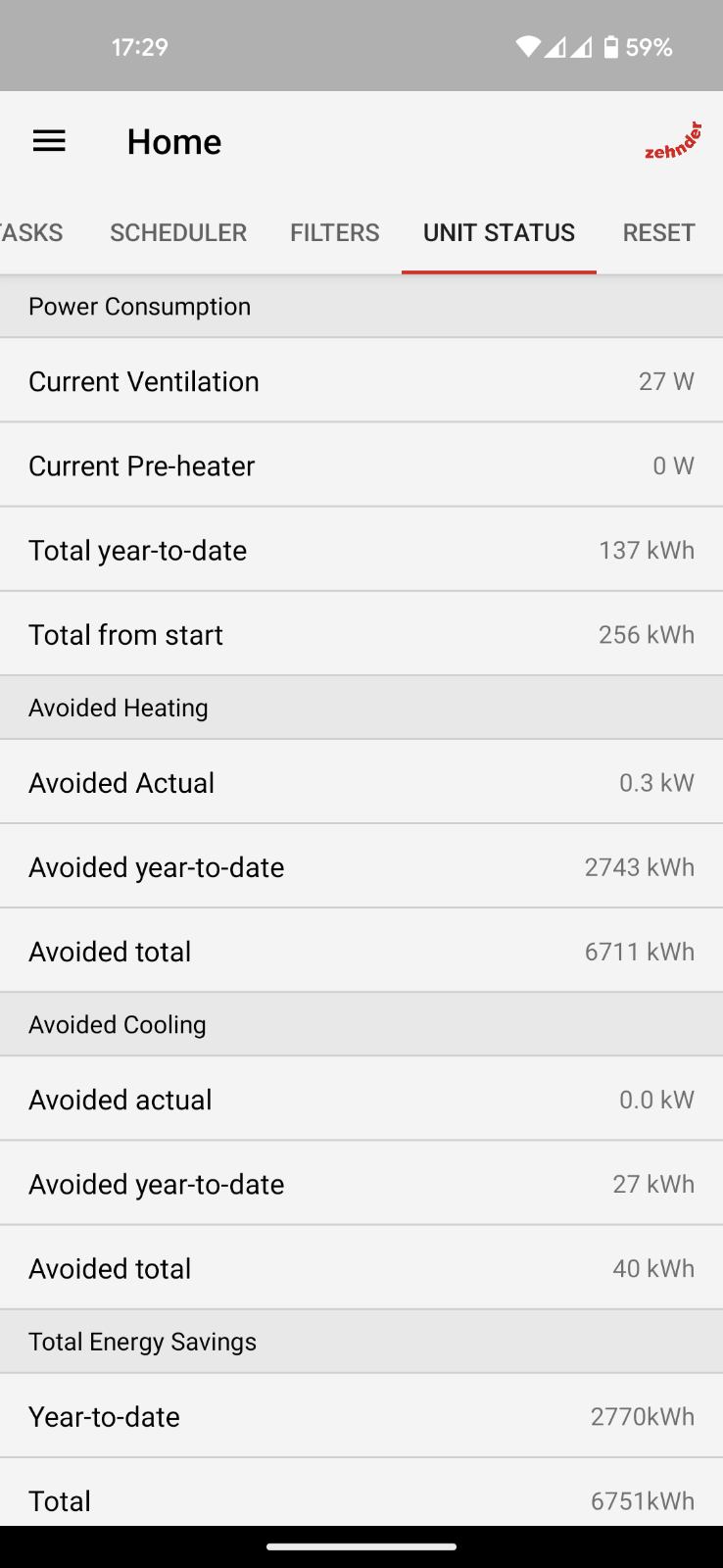

Yes, we did PHPP and obtain PHI retrofit (Enerphit) certification. The houses 50Pa rated airtightness is 0.6 ACH.
Our MVHR supplies about 0.35 ACH. (Based on the MVHR app, that states 150m3/h flow rate right now, on a building of 440m3 volume)

In terms of expectations: the design flow rate was 140m2/h and the measure actual flow rate is 150m3/h once everything was balanced out, so it's pretty close to expectations.
But what I think what you'll find a lot more interesting is the MVHR app's claim it has saved 6.75 MWh of heat/cooling energy since install Nov 2020.
Quite impressive. What unit is that for? What are you heating with, gas, heat pump or other? If gas it seems like it would on average be saving you £20 per month at 7p per kw/h?
