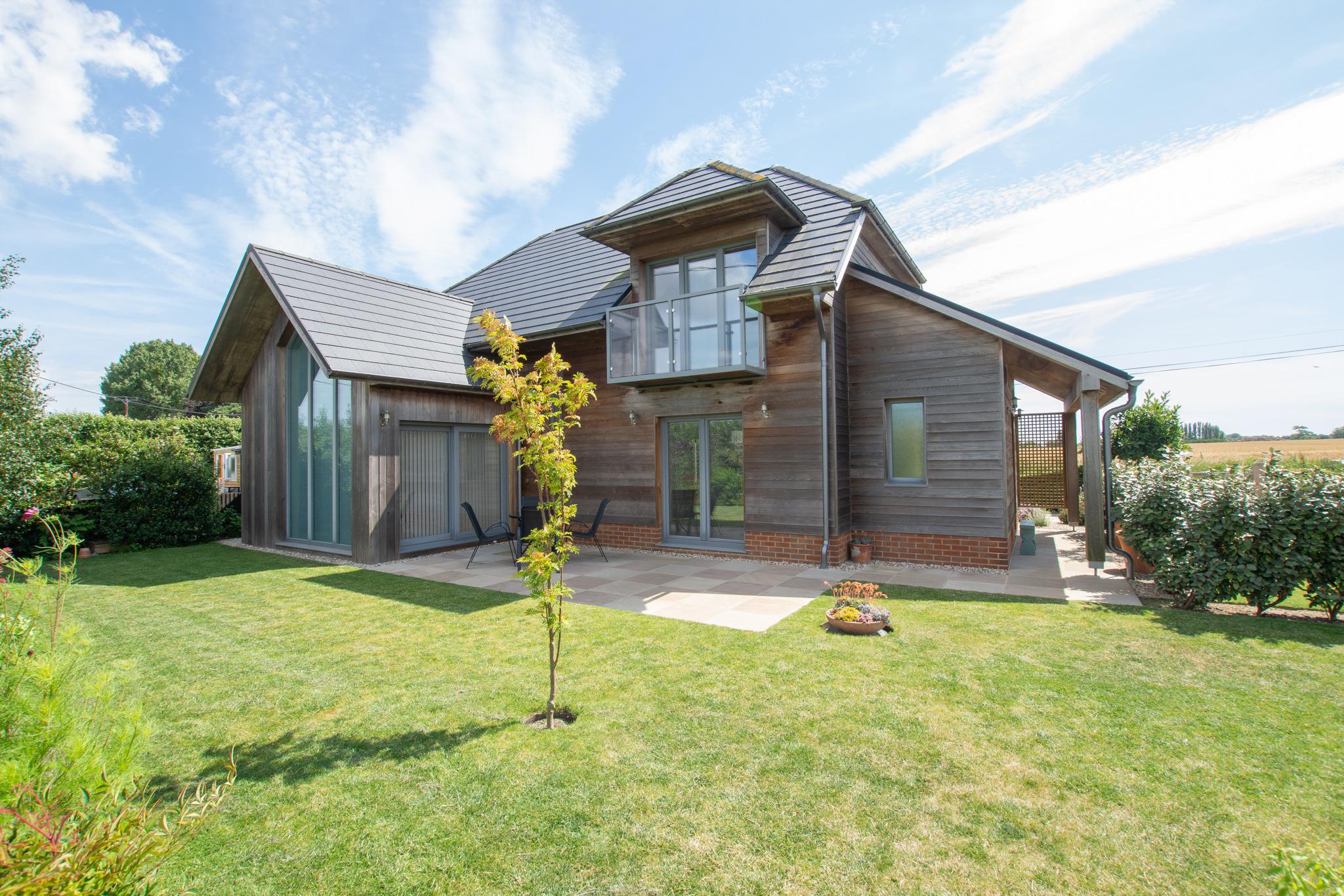

JohnMo Posted August 21, 2022 Posted August 21, 2022 I would rather work with, with being the important word, an architect I have a good relationship with.  Teach yourself about thermal bridging, insulation continuity etc, same for airtightness principles. Formally review the architect drawings to ensure you have what you want, get him to change what's required. Be an active client, explain this to the architect from the outset, as most client are passive. Nothing is approved until it's approved by you. That's how I did my design. It may not suit you, if that's the case go to the architect you don't know, but with passivhaus design experience.  Remember - Form factor is important, basically the closer the building is to cube the more efficient the insulation becomes. Our house is as far from a cube as you can get, if we insulated a cube to the same standard as we have, it would need no heating. But a cube building on our site would be wrong and look out of place. So we have heating.

Gone West Posted August 21, 2022 Posted August 21, 2022 7 hours ago, WisteriaMews said: Would welcome the thoughts of those that have successfully built a low energy / Passive House before. We designed and built our own house to PH standards and didn't use an architect and I did the PHPP modelling. We were members of the AECB at the time and spoke to local architects about the build and had large numbers of AECB members visiting our site. From what we found out, there was little understanding of what PH really meant and the only certified PH architect visitor didn't fill me with confidence. I must add this was twelve years ago and things may have improved. I certainly wouldn't bother with employing an architect unless they were PH certified. It's important to model the design using the PHPP as you are then able to vary different aspects of the construction to find out where changes can be made to improve overall performance. By using this method we were able to build the house without having a conventional heating system and to design the internal layout to suit our requirements. Â 2
