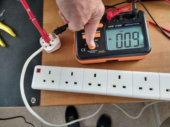

I think I may have found the problem though. One thing that seemed odd was the coincidence between an MCB trip one day and two apparently random RCCB trips subsequent to that and I think I now understand the link. When I unplugged all the equipment in the workshop I had in fact left a 6-way extension lead in one outlet. Just now I was removing and testing each USB equipped outlet in turn when I found the one hosting the empty 6-way extension was the leaky one... It wasn't the USB outlet, it was the empty 6-way block!

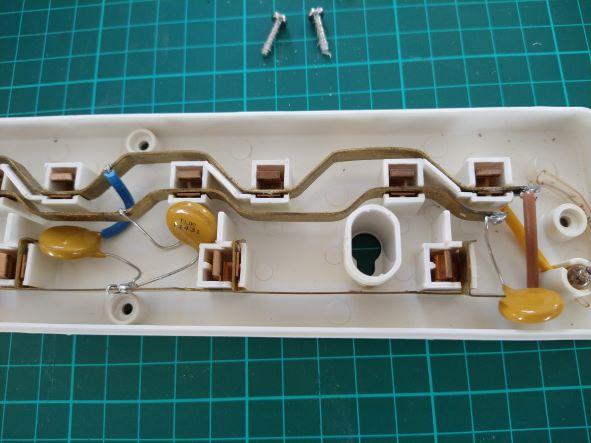

That was a surprise, and the reason soon became clear on opening it up...
It was an old 'surge protection' block. With a very helpful pair of MOV's between L->E and N->E and a third between L->N
MOV's degrade when they absorb voltage spikes so the apparent coincidence with the MCB tripping could be explained by them becoming leakier after taking a back EMF hit the day before.
There is one slight oddity in that when the RCCB tripped first thing this morning, the 6-way extension was isolated from Live via a smart socket that was switched off at the time. But N would still have been connected and the MOV between N->E and could still present a current imbalance that might trip the RCCB.

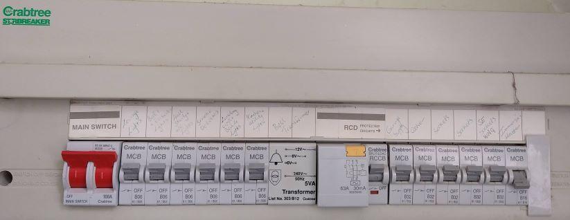

Do you have RCCB's? I would suggest you do not and that you have an RCD - if it was an RCCB then it would add another slight level of complexity to your fault, so for the avoidance of doubt, what do you have?
It's an old plastic fantastic single RCCB breaker unit:
