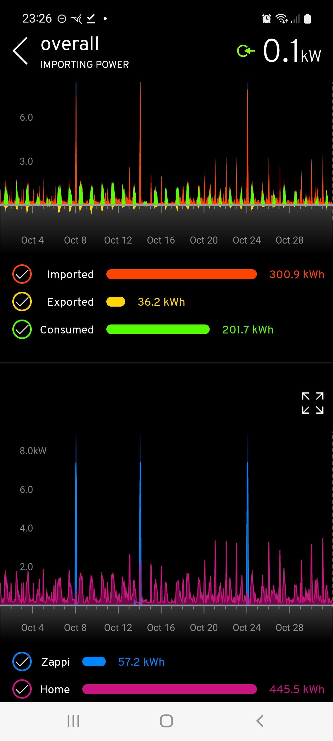

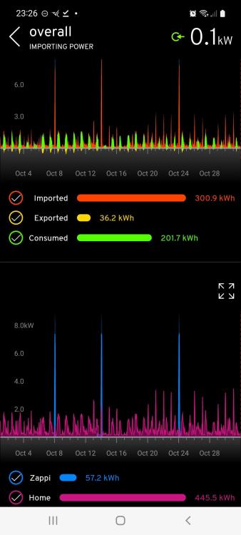

NSS Posted October 31, 2022 Author Share Posted October 31, 2022 Just completed our first full calendar month since the Zappi was installed and one of the major bonuses for me is the rather excellent reporting in the app. The following image is fairly self-explanatory but feel free to ask if anything is unclear. 4 Link to comment Share on other sites More sharing options...
NSS Posted November 1, 2022 Author Share Posted November 1, 2022 To add a bit more info for anyone interested, the graph shows we used 57.2 kWh charging the Mini in October, and we used a further 6.6 kWh at the end of September (checking the Zappi was working). All of this was delivered in the cheap 7.5p rate so charging has so far cost about £4.80 and mileage covered for that input is 223 miles (say 2.15p/mile). This compares very favourably to the circa 30p/mile for my Macan 😳 Since the last charge we've covered a further 77 miles and remaining range is shown as 44 miles so comfortably over 100-mile usable range which is fine for the intended use. Oh, and no it's not a JCW but is still fun to drive - for short periods at least 🤣 1 Link to comment Share on other sites More sharing options...
