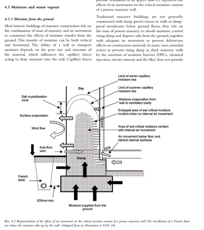

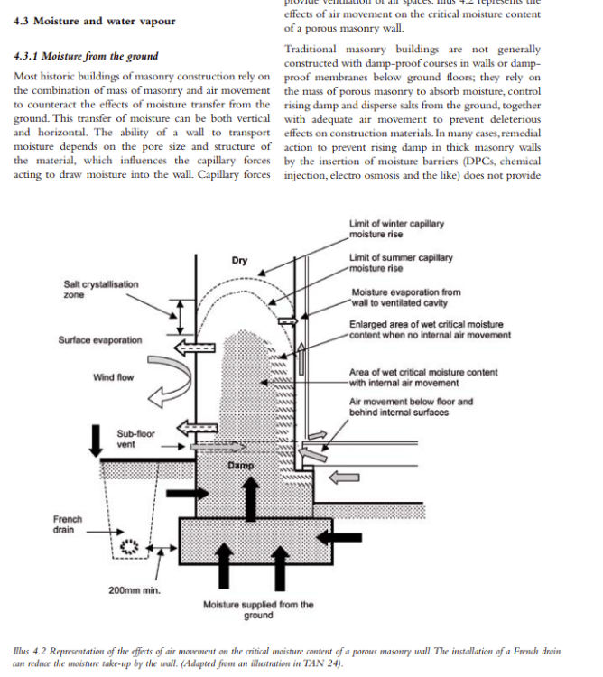

saveasteading Posted August 17, 2022 Share Posted August 17, 2022 See page 43 among others. https://www.gov.scot/binaries/content/documents/govscot/publications/advice-and-guidance/2020/02/guide-for-practitioners-6-conversion-of-traditional-buildings/documents/guide-for-practitioners-6-conversion-of-traditional-buildings---part-one/guide-for-practitioners-6-conversion-of-traditional-buildings---part-1/guide-for-practitioners-6-conversion-of-traditional-buildings---part-1/govscot%3Adocument/Conversion%2Bof%2Btraditional%2Bbuildings%2BPart%2B1%2B.pdf Link to comment Share on other sites More sharing options...
Bemak Posted August 17, 2022 Author Share Posted August 17, 2022 42 minutes ago, Roger440 said: But are the walls damp at floor level? If they are, thats not going to get better if you insulate externally. If they are completely dry, then maybe. The walls are in surprisingly good shape at floor level. I had to replace a washing machine in the kitchen recently and when I pulled out the old one, the wall behind was perfectly dry - and this is in an area where the ground level is at its highest above the floor level. The main location for dampness at ground floor is in a bedroom on that eastern gable shown in the first image. There used to be a fireplace in that room by all accounts but there's no trace of it now - so I would wonder how it was closed up. 23 minutes ago, saveasteading said: The stonework is probably difficult to make attractive, being small rocks. it was definitely never meant to be exposed! 23 minutes ago, saveasteading said: As a priority, lower the ground so that there is no rising damp, and any rain splashes are below the floor level. definitely - i will mark up a plan shortly to show how I intend to manage the perimeter. 25 minutes ago, saveasteading said: Also deal with any other issues like chimneys and leaking gutters. Yep - I'm thinking it makes sense to reroof now when there will be scaffolding in place anyway for the works to the walls. Will completely replace the rainwater goods as well. 26 minutes ago, saveasteading said: Then over-clad but with a rain-screen that will keep the rain off but allow the wall to breathe. (Over-cladding creates a thickness, standing out from the all. this can be a problem at the eaves, as the gutters need to be moved out, involving roof extension.. Therefore I expect this has to be quite thin.) OR patch up the cement screed again and see how the wall behaves in a loved building. I don't think over-cladding with a rain-screen is the solution here given how well the majority of the wall is holding up. I was tempted to patch it up as you also suggest but the idea of insulating externally is starting to make more sense to me particularly as it consolidates the external envelope, improves the u-value, and in doing so moves the dew point closer to the outside. Link to comment Share on other sites More sharing options...
Bemak Posted August 17, 2022 Author Share Posted August 17, 2022 27 minutes ago, saveasteading said: See page 43 among others. https://www.gov.scot/binaries/content/documents/govscot/publications/advice-and-guidance/2020/02/guide-for-practitioners-6-conversion-of-traditional-buildings/documents/guide-for-practitioners-6-conversion-of-traditional-buildings---part-one/guide-for-practitioners-6-conversion-of-traditional-buildings---part-1/guide-for-practitioners-6-conversion-of-traditional-buildings---part-1/govscot%3Adocument/Conversion%2Bof%2Btraditional%2Bbuildings%2BPart%2B1%2B.pdf Thanks for sending this through. I've come across a few scottish based publications like this on here and they're all excellent. Didn't wainscoting come about for the very purpose of covering up the lower sections of walls that would get damp? Link to comment Share on other sites More sharing options...
