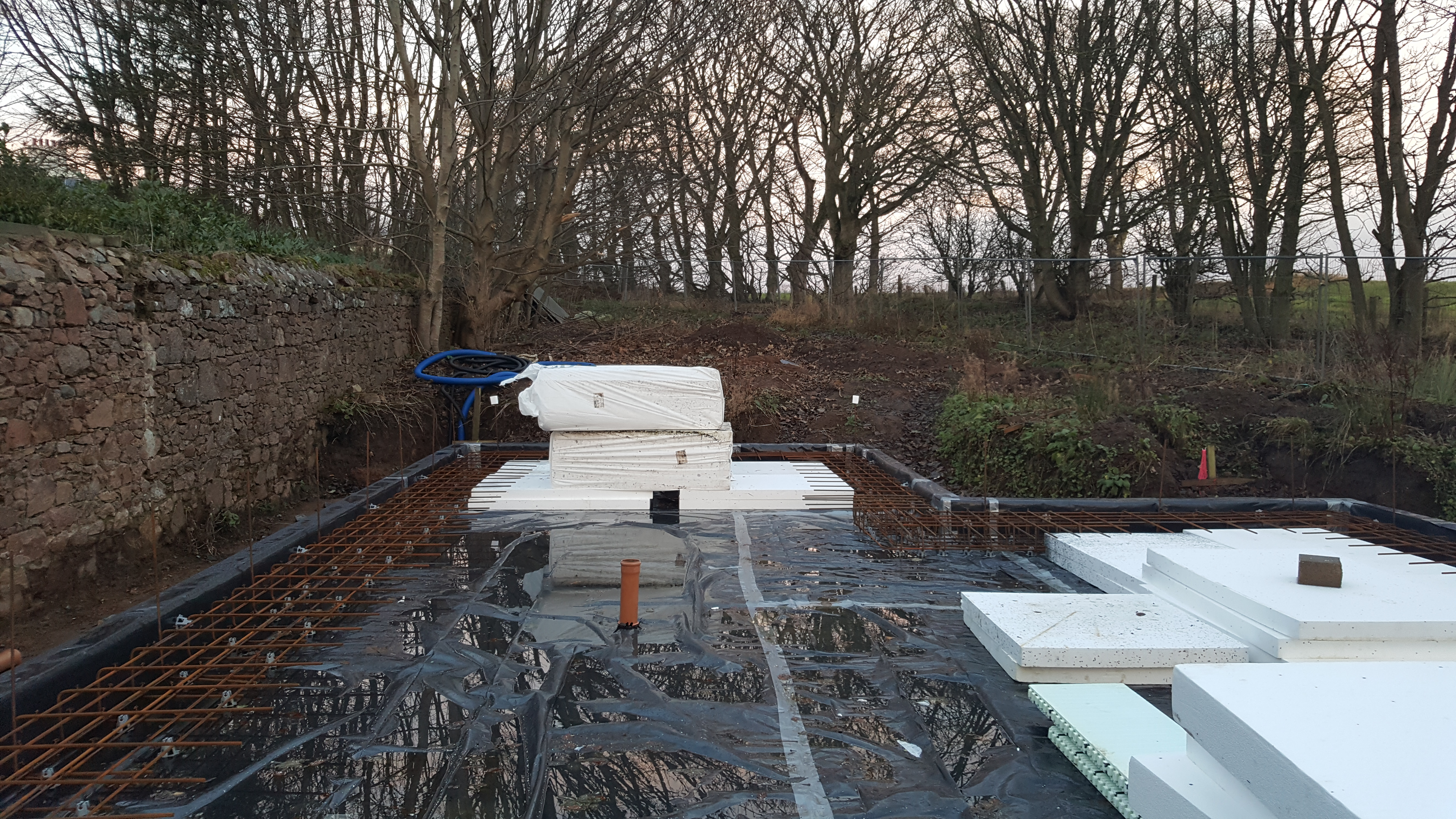

Vijay Posted June 9, 2017 Share Posted June 9, 2017 Morning guys, Having a little issue with finding a concrete supplier who will give me the exact spec I require, which is: DESIGNATED CONCRETE to external walls Designation: RC32/40. Fibres: Not required. Aggregates: - Size (maximum): 10 mm. - Coarse recycled aggregates: RCA permitted. - Additional aggregate requirements: Rounded coarse aggregate. Special requirements for cement/ combinations: CEM 1 Consistency: S2 slump range with an ideal slump to around 80mm Chloride class: Normal. Admixtures: Waterproofing admixture below d.p.c. to wall system manufacturer's approval or a high cement concrete to BS8007 with minimum cement content of 325kg/cu.m and water cement ratio of 0.5. Just looking for some help with what things mean. Firstly, the RC32/40 - is that the strength of the concrete? From other posts, I believe the R stands for reinforced as it will have rebar in it? I've been assured that having a minimum cement content of 325kg pcm and water cement ratio of 0.5 will give me a waterproof concrete without the stupid expense of waterprrof additive, but has anyone come across this before as I'm a little worried about that? Vijay Link to comment Share on other sites More sharing options...

PeterW Posted June 9, 2017 Share Posted June 9, 2017 10mm is pump grade - anything bigger and the pump guy may hate you.... sanded and extra cement to make it flow. And I've never heard of concrete being certified waterproof without an additive. Small price to pay it is wrong ... Link to comment Share on other sites More sharing options...
Vijay Posted June 9, 2017 Author Share Posted June 9, 2017 22 minutes ago, PeterW said: 10mm is pump grade - anything bigger and the pump guy may hate you.... sanded and extra cement to make it flow. And I've never heard of concrete being certified waterproof without an additive. Small price to pay it is wrong ... Is that 100% right? The only reason I ask is the concrete supplier who was originally gonna supply my foundation concrete who knew it was gonna be pumped, has said he cannot do the ICF mix as he doesn't supply concrete with 10mm aggregate. Small price to pay - is that said with a touch of sarcasm???? Link to comment Share on other sites More sharing options...

jamiehamy Posted June 9, 2017 Share Posted June 9, 2017 The 'R' doesn't mean it will have rebar - as long as you give the prescribed spec, they will worry about how to make it up. Interested in the water proof concrete part tho - why is this needed? If it's below DPC there is no reason for it that I'm aware of but would be interested to know if there is a specific reason?. Link to comment Share on other sites More sharing options...
Alexphd1 Posted June 9, 2017 Share Posted June 9, 2017 Yep. Nudara icf. Learned on job from rebar to concrete it was a real learning curve. Made a few mistakes but will be doing a eps passive slab and icf again on second build so pretty happy with build up to now. Was meant type c35 concrete not r35. I think waterproof additive to concrete is more for used for basements constructed with icf but biggest problem I see with this is the concrete sealing around the plastic ties but that is a other topic. I am a bit wary of your 80mm sump, who has spec'd that? How high are you pouring? Link to comment Share on other sites More sharing options...
Vijay Posted June 9, 2017 Author Share Posted June 9, 2017 38 minutes ago, jamiehamy said: The 'R' doesn't mean it will have rebar - as long as you give the prescribed spec, they will worry about how to make it up. Interested in the water proof concrete part tho - why is this needed? If it's below DPC there is no reason for it that I'm aware of but would be interested to know if there is a specific reason?. Yeah, it's for up to DPC. Link to comment Share on other sites More sharing options...
Vijay Posted June 9, 2017 Author Share Posted June 9, 2017 30 minutes ago, Alexphd1 said: Yep. Nudara icf. Learned on job from rebar to concrete it was a real learning curve. Made a few mistakes but will be doing a eps passive slab and icf again on second build so pretty happy with build up to now. Was meant type c35 concrete not r35. I think waterproof additive to concrete is more for used for basements constructed with icf but biggest problem I see with this is the concrete sealing around the plastic ties but that is a other topic. I am a bit wary of your 80mm sump, who has spec'd that? How high are you pouring? 80mm slump was quoted by Polarwall. Height will be up to and including gables but obviously separated at each floor Link to comment Share on other sites More sharing options...

Vijay Posted June 10, 2017 Author Share Posted June 10, 2017 But we need need some sort of damp proofing to stop rising damp even with ICF don't we? Obviously I wouldn't want to pay for the crazy price of a waterproof additive and was told that just having a minimum cement content of 325kg pcm and water cement ratio of 0.5 will give me a waterproof concrete. Link to comment Share on other sites More sharing options...
Alexphd1 Posted June 10, 2017 Share Posted June 10, 2017 A dpm (damp proof membrane) . Our was laid on the first 100mm of eps slab then the extra 200mm eps layer on top. Link to comment Share on other sites More sharing options...
Vijay Posted June 10, 2017 Author Share Posted June 10, 2017 But did you build your ICF off your concrete slab? I've got B&B floor and strip foundations. I still use a DPM but have to stop rising damp in the concrete core of the ICF http://www.polarwall.co.uk/pdf/PWD014.pdf Link to comment Share on other sites More sharing options...
