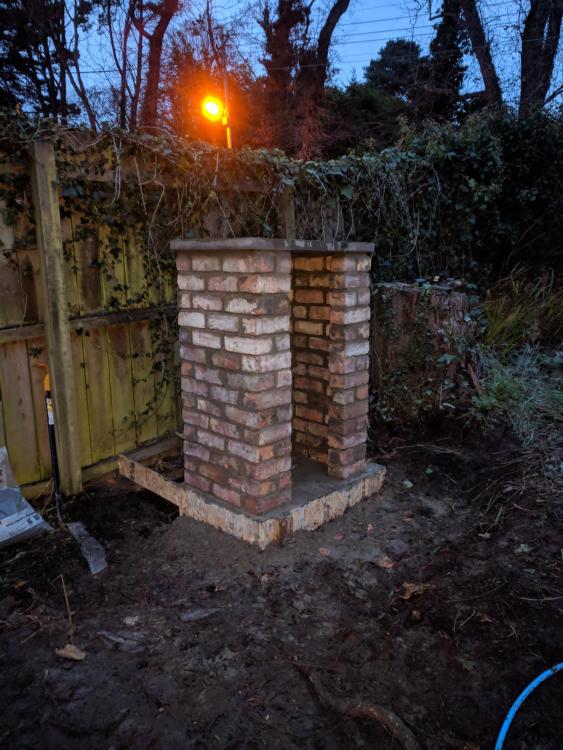

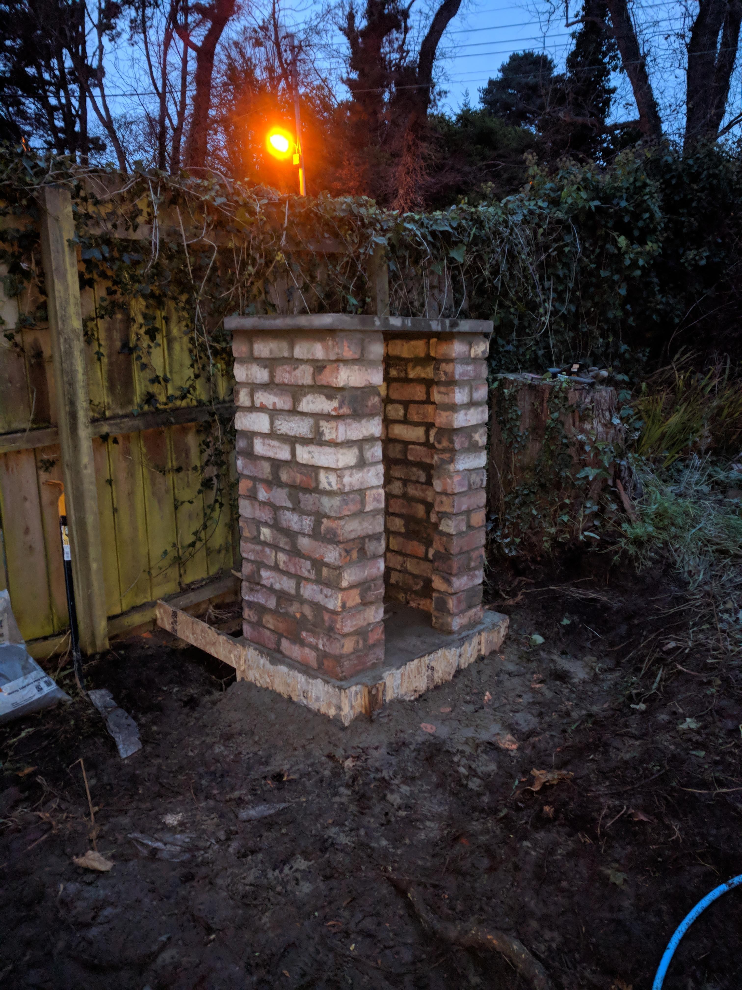

Conor Posted August 15, 2022 Posted August 15, 2022 Then you'll need a kiosk to the DNOs specification and room for a full sized back board. You can buy prefab GRP boxes that are the right size. I built mine. 2

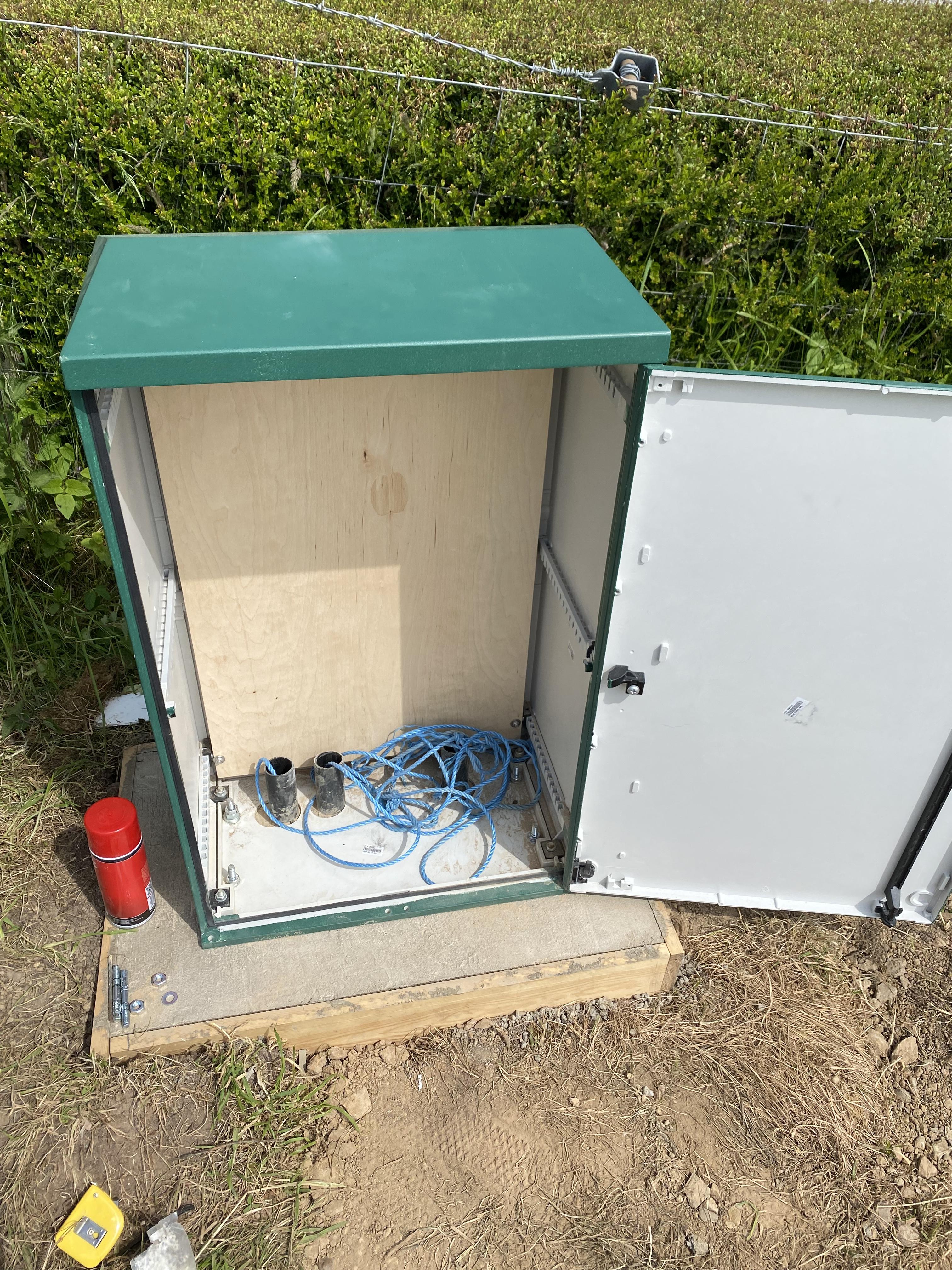

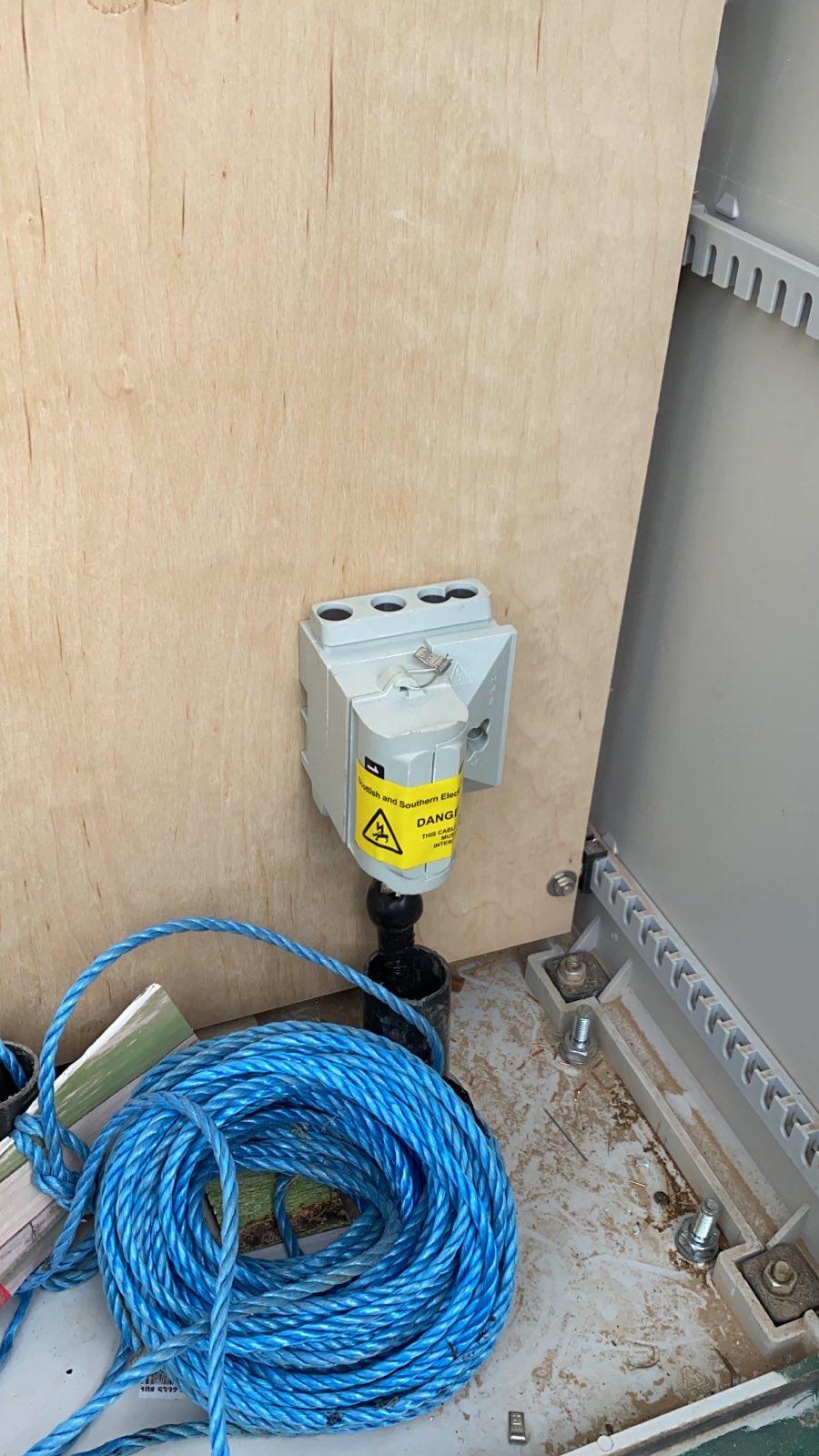

Kelvin Posted August 15, 2022 Posted August 15, 2022 I’ve seen folk use standard meter boxes screwed to a post for temporary supplies. There’s nothing stopping you making this a permanent supply point though and then running SWA to your house. It’s what I’ve done mounted inside a GRP kiosk. 1

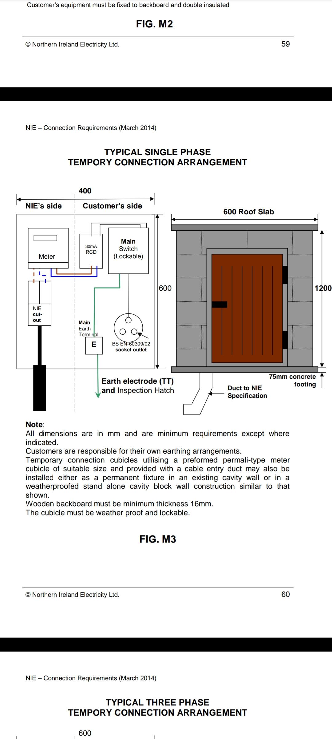

Mr Punter Posted August 15, 2022 Posted August 15, 2022 57 minutes ago, Conor said: Then you'll need a kiosk to the DNOs specification and room for a full sized back board. You can buy prefab GRP boxes that are the right size. +1 get the spec from your DNO. You can sometimes deviate a little as the guys doing the connection are not jobsworths. Our DNO spec called for a concrete base but we did wall mounted as the ground had a fair amount to make up and we need to route further cables in future. The days of mounting a meter box on a couple of 2 x 2s are over. 1

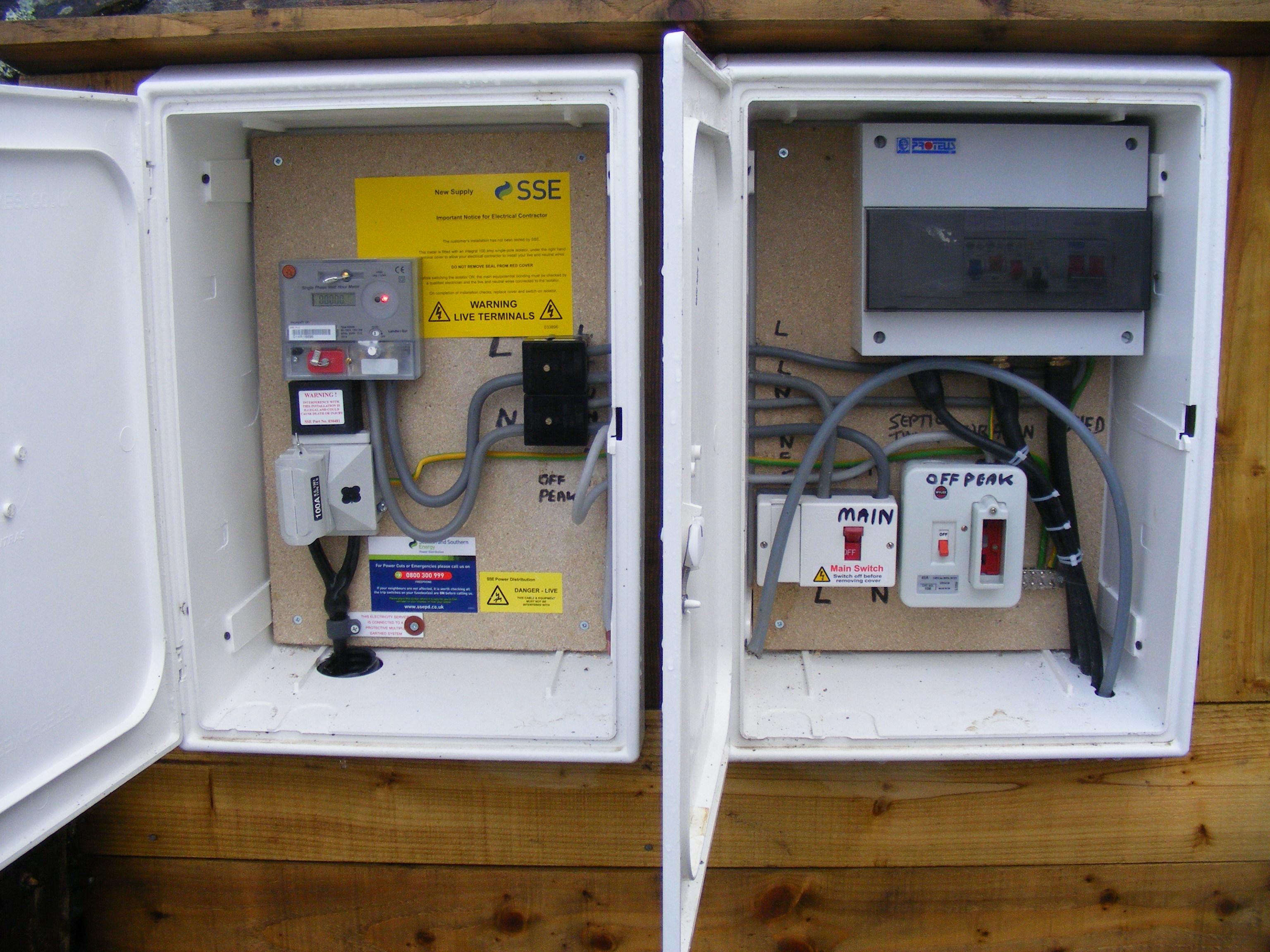

ProDave Posted February 10, 2023 Posted February 10, 2023 I used 2 standard flush meter boxes some posts and timber cladding. This is now our permanenet supply, no point paying to move it. It is close to our parking area so will be easy to add car charging point(s) from there when the need arises.
