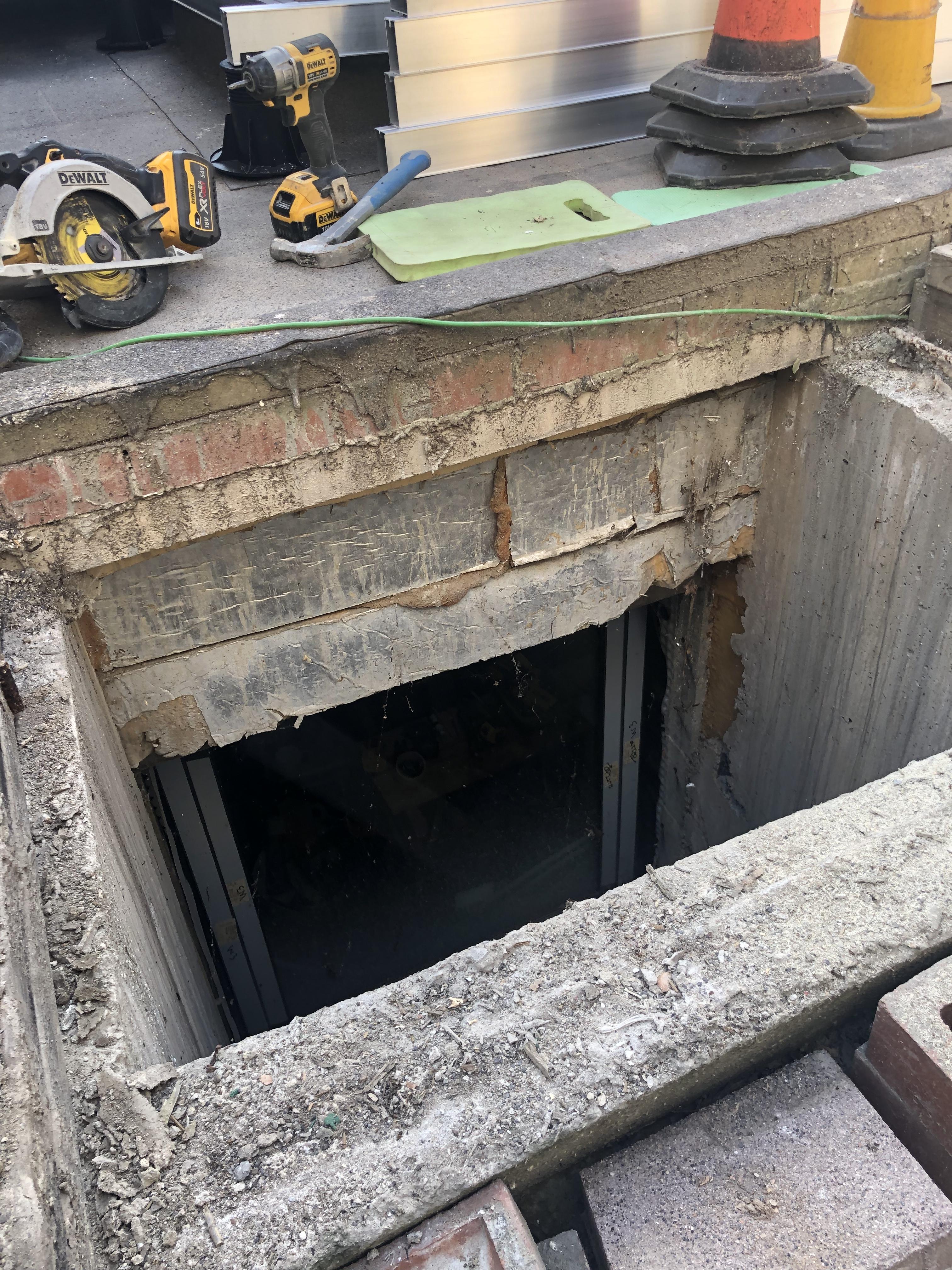

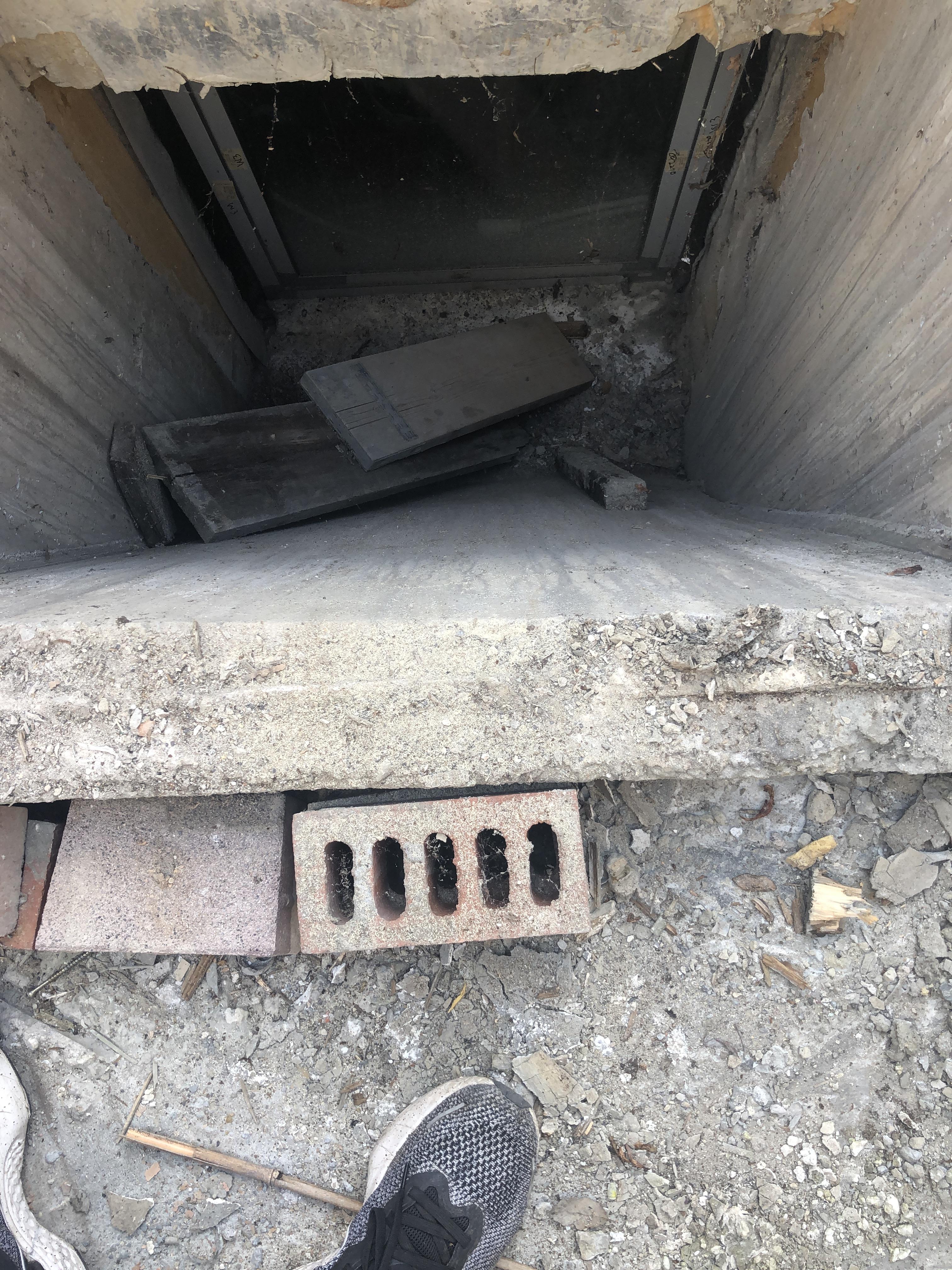

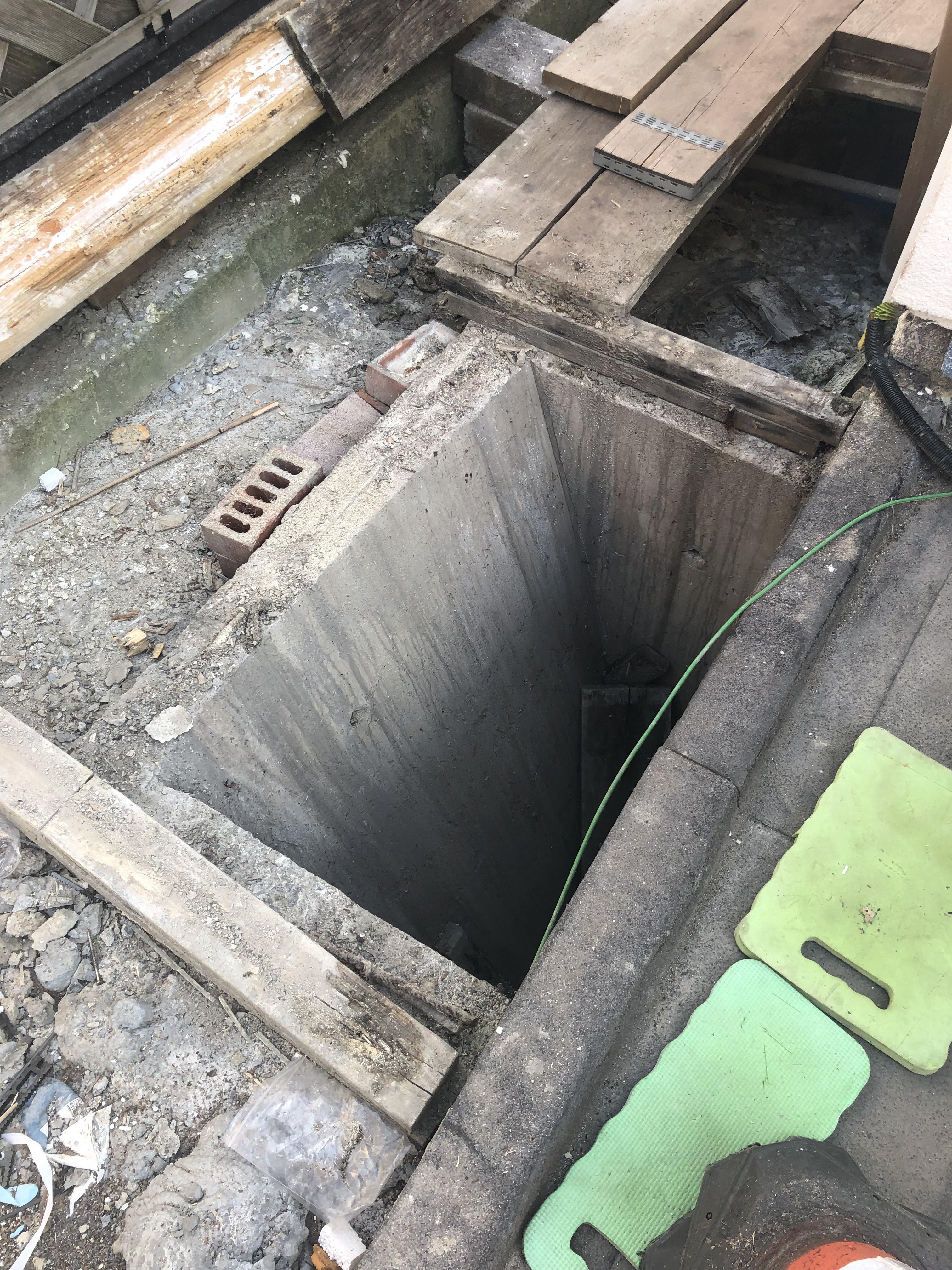

Pocster Posted August 9, 2022 Posted August 9, 2022 For my many sins it’s finally time to come back and address this light well . Let’s get the laughter out the way - yes it will have walk on glazing . As you can see it’s concrete with some PIR at the top . The concrete shuttering warped during the pour so it’s not level ( 2nd one is much worse - but that’s a problem for another day ) . How best to line / prepare - possibly for tiling . Roofers batten vertically ( to get over the bow ) then tile backer board ??

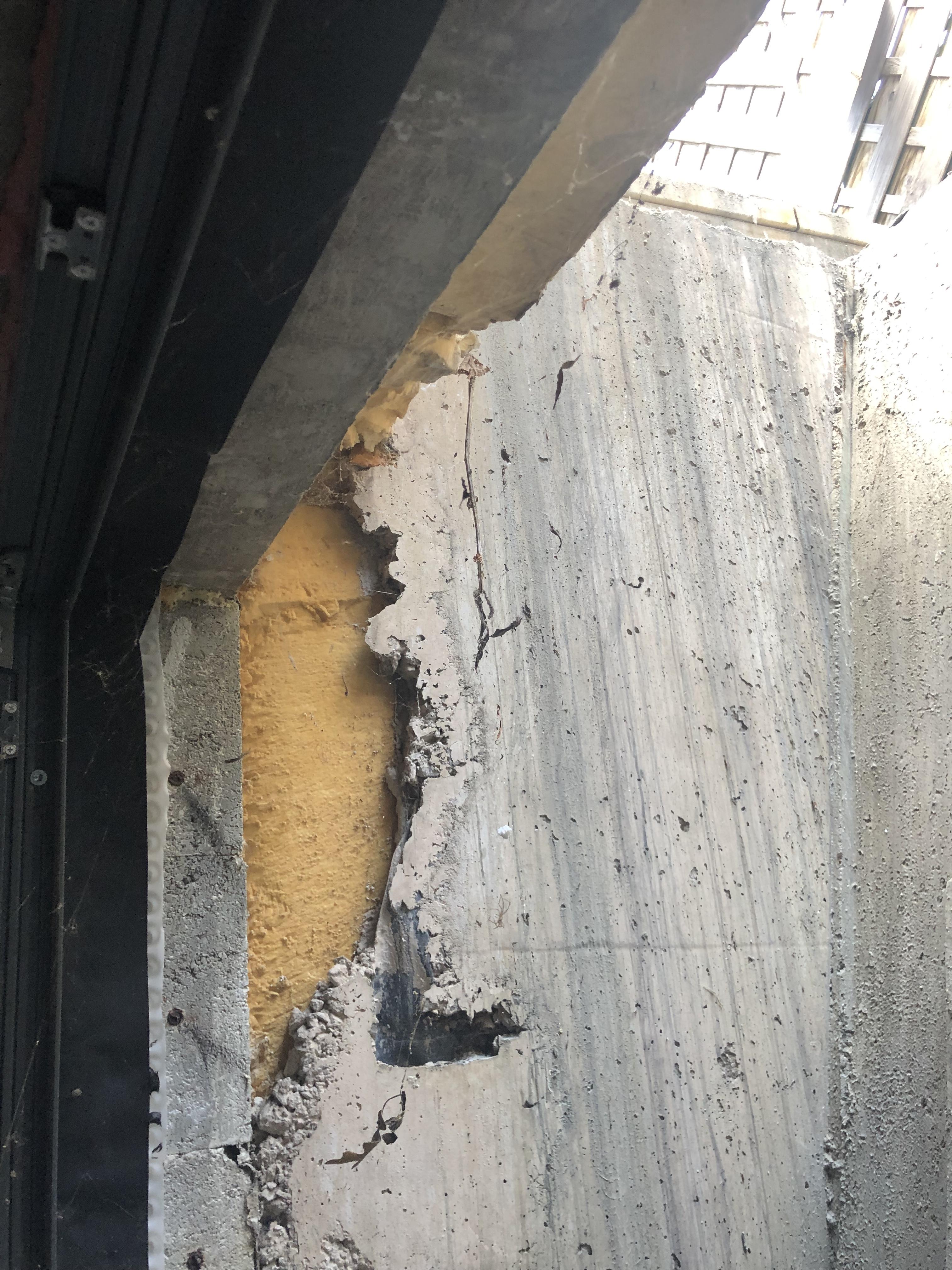

Pocster Posted August 9, 2022 Author Posted August 9, 2022 The walk on glazing ( giggles ) upstand probably timber . Goes up past the flat roof . How best to waterproof the upstand ?
Mr Punter Posted August 9, 2022 Posted August 9, 2022 Rendered and painted? Maybe some render board for the reveals.

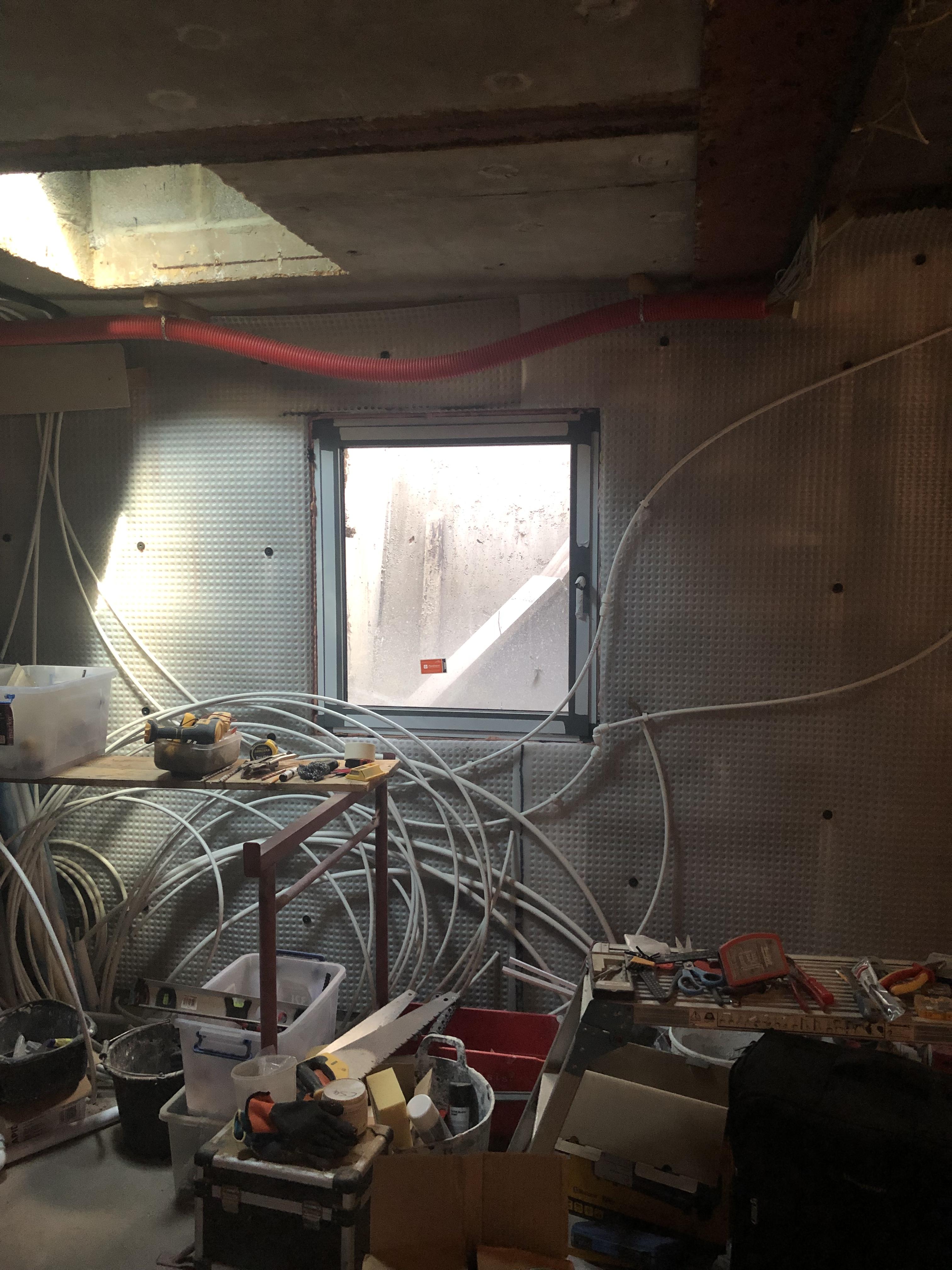

Pocster Posted August 9, 2022 Author Posted August 9, 2022 1 hour ago, PeterW said: Does it not need insulating ..?? No . The light well is outside the building . That window you can see is triple glazed . Council wanted it like this . So the light well isn’t even fixed to the main house . 1
Pocster Posted August 9, 2022 Author Posted August 9, 2022 39 minutes ago, Mr Punter said: Rendered and painted? Maybe some render board for the reveals. No chance of getting a guy in to render it - so need something I can do .
Mr Punter Posted August 9, 2022 Posted August 9, 2022 OK so just backerboard the sides and tile the lot. No piss coloured grout though! 1

Pocster Posted August 11, 2022 Author Posted August 11, 2022 Best method to water proof the upstand ? Epdm ?
Pocster Posted August 11, 2022 Author Posted August 11, 2022 (edited) Gorilla do a waterproof coat and seal . liquid rubber . This sounds much easier to use ….. ???? https://www.sealantsandtoolsdirect.co.uk/everbuild-aquaseal-liquid-roof-membrane-coating-21kg-grey-aqliqrfgy21?language=en-gb¤cy=GBP&gclid=CjwKCAjw0dKXBhBPEiwA2bmObYa4ga9qgfDzqUIoEc6TNVy_tN6TICK6WK0cxuL0oEfAfXIOmClmxBoCZSAQAvD_BwE expensive - but literally just paint timber / concrete upstands with this ?? Edited August 11, 2022 by pocster
Simplysimon Posted August 11, 2022 Posted August 11, 2022 5 hours ago, pocster said: Gorilla do a waterproof coat and seal . liquid rubber . This sounds much easier to use ….. ???? https://www.sealantsandtoolsdirect.co.uk/everbuild-aquaseal-liquid-roof-membrane-coating-21kg-grey-aqliqrfgy21?language=en-gb¤cy=GBP&gclid=CjwKCAjw0dKXBhBPEiwA2bmObYa4ga9qgfDzqUIoEc6TNVy_tN6TICK6WK0cxuL0oEfAfXIOmClmxBoCZSAQAvD_BwE expensive - but literally just paint timber / concrete upstands with this ?? doesn't say how long it will last, epdm will give you a good few years
Pocster Posted August 11, 2022 Author Posted August 11, 2022 2 minutes ago, Simplysimon said: doesn't say how long it will last, epdm will give you a good few years Yes but that requires some competency. Painting shit any mung can do …
Simplysimon Posted August 11, 2022 Posted August 11, 2022 1 minute ago, pocster said: Yes but that requires some competency. Painting shit any mung can do … epdm is easy, look at a couple of videos for internal and external corners and general flat roofs here and just becaue it says rubber in the webpage, don't get hot and bothered
Pocster Posted August 11, 2022 Author Posted August 11, 2022 3 minutes ago, Simplysimon said: epdm is easy, look at a couple of videos for internal and external corners and general flat roofs here and just becaue it says rubber in the webpage, don't get hot and bothered Painting is easier !
Simplysimon Posted August 11, 2022 Posted August 11, 2022 1 minute ago, pocster said: Painting is easier ! yup, but easier isn't always the same as better
Pocster Posted August 11, 2022 Author Posted August 11, 2022 3 minutes ago, Simplysimon said: yup, but easier isn't always the same as better Yeah it is . Name one thing that’s easier but isn’t better ( careful ! )
Simplysimon Posted August 11, 2022 Posted August 11, 2022 Just now, pocster said: Yeah it is . Name one thing that’s easier but isn’t better ( careful ! ) nail gun versus hammer
