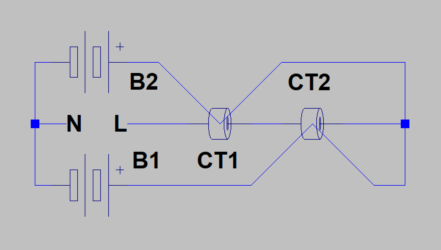

SteamyTea Posted July 31, 2022 Share Posted July 31, 2022 Have we seen a wiring diagram of all the bits yet. Does it really matter if the PW takes from the SE, as long are fully charged during the cheap time windows i.e. 4 night hours or a good PV day. It is the average price you pay for the kWh overall that is important, not which way the electrons and ions move about. Have you added up all your import bills and divided it by your total usage? Link to comment Share on other sites More sharing options...
Pocster Posted July 31, 2022 Author Share Posted July 31, 2022 6 minutes ago, SteamyTea said: Have we seen a wiring diagram of all the bits yet. Does it really matter if the PW takes from the SE, as long are fully charged during the cheap time windows i.e. 4 night hours or a good PV day. It is the average price you pay for the kWh overall that is important, not which way the electrons and ions move about. Have you added up all your import bills and divided it by your total usage? Yes it matters . I only have 4 hours . That’s the total time a depleted PW needs to charge . If one takes from the other - you are simply shifting the load not charging simultaneously ( so do not fill both batteries and equally charge/ discharge cycle reduces battery life span ) . Import bill this month is zero 😁 Link to comment Share on other sites More sharing options...
Radian Posted July 31, 2022 Share Posted July 31, 2022 It seems simple enough. Both battery systems would obviously like to do 'the right thing' (for normal single battery installations) and deliver any load your house imposes in preference to imports from the grid, whenever they are able to. To cooperate in the way you require, both must be able to be told not to do so in your off-peak window. If you cannot instruct them to obey this then there will always be a competition between them. 1 Link to comment Share on other sites More sharing options...

Radian Posted July 31, 2022 Share Posted July 31, 2022 7 minutes ago, SteamyTea said: I don't think they charge sequentially though, the electrons may go on a seemingly tortured route, but I suspect at night, both get charged up. As there's no communication between them both will just 'fill up' until they decide they've had enough. The Telsa seems to be the one with most unpredictable behaviour in this respect. However, once 'full' they will return to supplying the house loads - of which one load may be a battery still charging. Hence a window must be defined in which no generation takes place. But this means some import for the house's base load must be tolerated. Link to comment Share on other sites More sharing options...
Radian Posted July 31, 2022 Share Posted July 31, 2022 If you could cancel the load imposed by each battery system when charging from the other's CT (by routing their live wires in the opposite direction to the main incomer) then they will both only respond to the other house loads. But when current goes the other way, when generating, my head explodes. I mean, I haven't figured out what would happen yet! 2 Link to comment Share on other sites More sharing options...
Pocster Posted July 31, 2022 Author Share Posted July 31, 2022 4 minutes ago, Radian said: If you could cancel the load imposed by each battery system when charging from the other's CT (by routing their live wires in the opposite direction to the main incomer) then they will both only respond to the other house loads. But when current goes the other way, when generating, my head explodes. I mean, I haven't figured out what would happen yet! Lol ! Bit of a head f isn’t it ! imagine the fun I have when SE says there’s 6kw of solar at 5am ! PW says house load at 4kwh when it isn’t . PW says PV at 3kwh when there’s no solar because it’s draining the SE . The list goes on 😁 Link to comment Share on other sites More sharing options...

Radian Posted July 31, 2022 Share Posted July 31, 2022 It seems OK, it's entirely symmetrical - the power delivered by the battery systems will be hidden to each other so they should always just 'see' their own imports/exports and everything else bar the other battery system. I think. 1 Link to comment Share on other sites More sharing options...

Radian Posted July 31, 2022 Share Posted July 31, 2022 (edited) 30 minutes ago, SteamyTea said: Yes, but I am not sure if that is an actual net loss (other that battery inefficiencies). No, it's an unnecessary drain on the other battery. We want both to charge from the grid, not each other. Here's a schematic of what I think might work: Obviously the symbol for the batteries is a bit wrong for AC but it gives the idea. CT1 is owned by B1 and C2 by B2. Whatever current flows to or from Live by either battery is hidden from the other. Am I being silly or is it as simple as this? Edited July 31, 2022 by Radian 1 Link to comment Share on other sites More sharing options...
