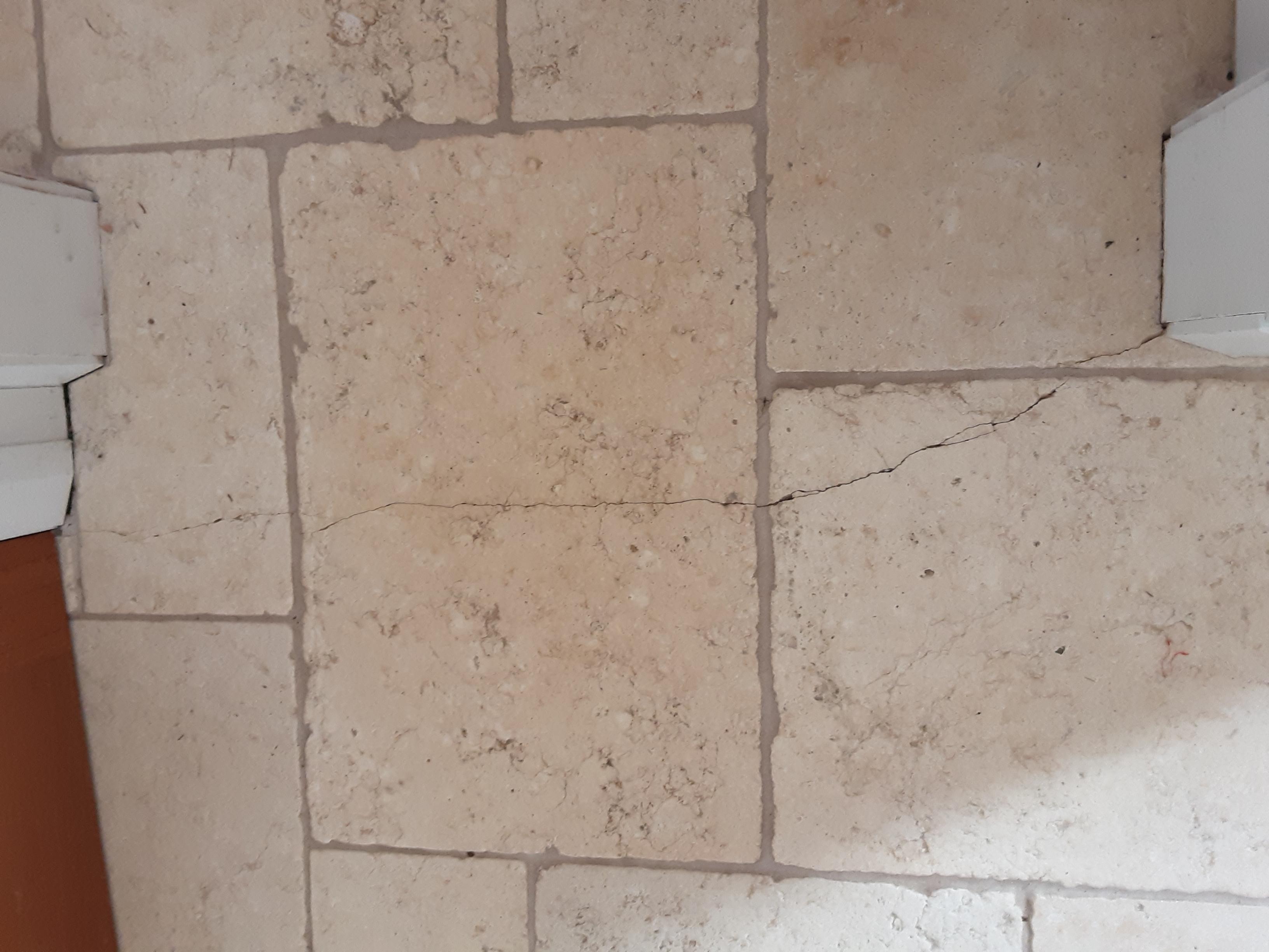

Temp Posted July 25, 2022 Posted July 25, 2022 Does the screed and will the stone run through doorways? Without an expansion gap this can happen..
ashthekid Posted July 28, 2022 Author Posted July 28, 2022 (edited) Yes I have quite a few doorways it runs through. There is one long run of about 40meters. But that crack wasn’t caused by not dry enough screed was it? Edited July 28, 2022 by ashthekid
