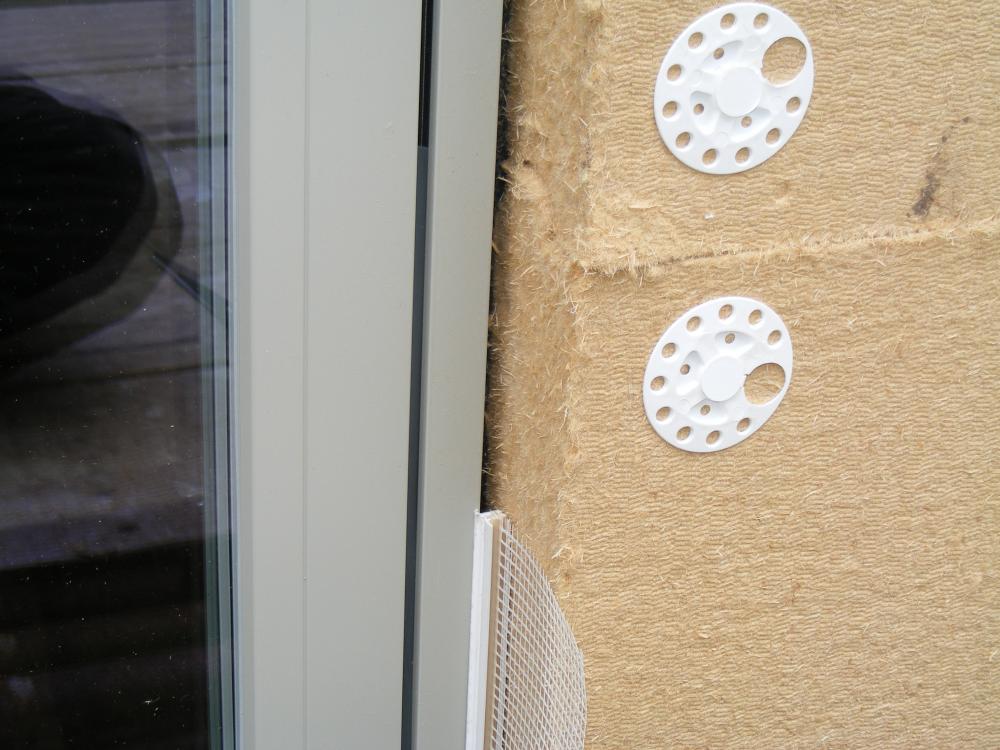

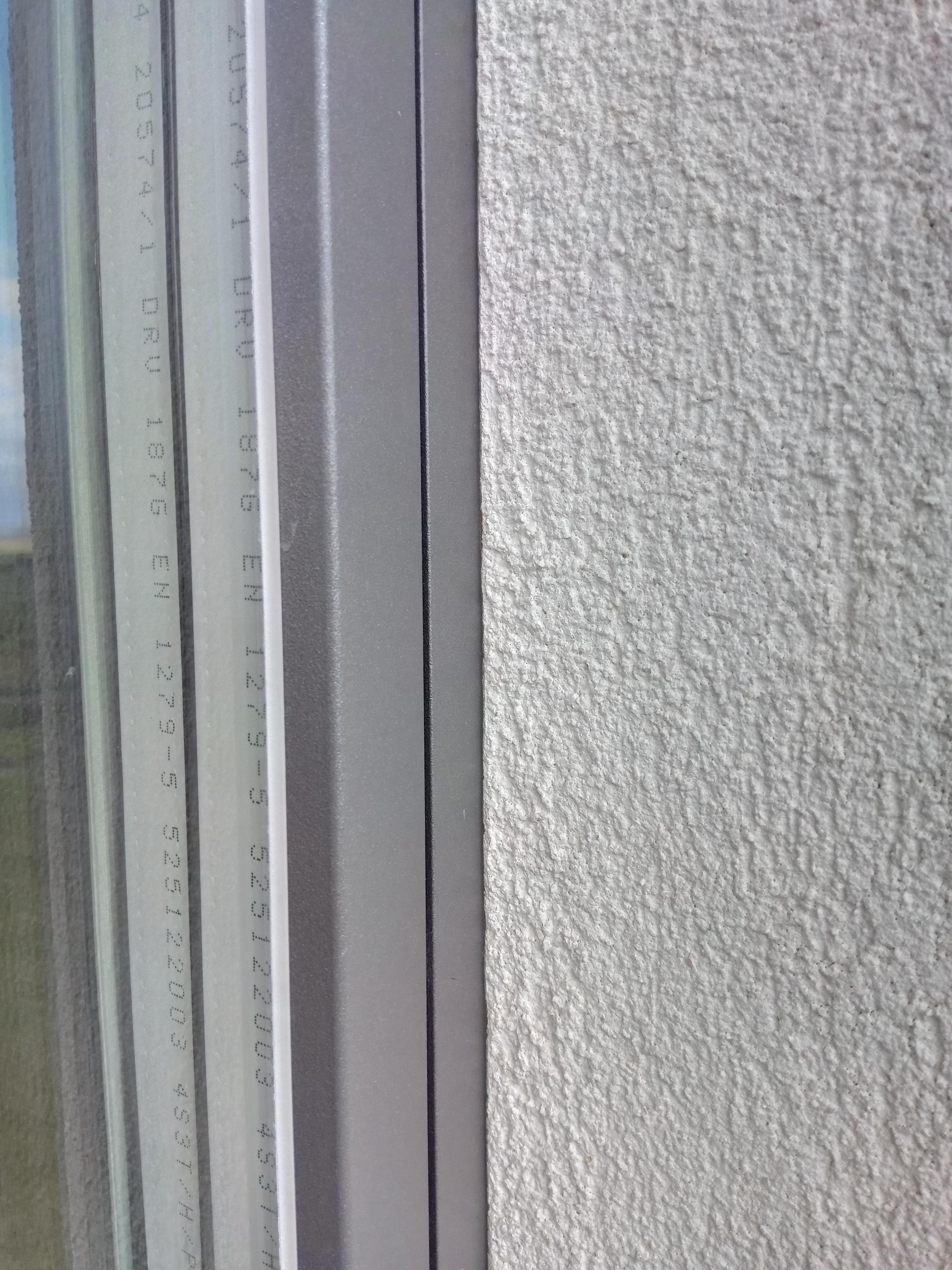

ProDave Posted July 23, 2022 Share Posted July 23, 2022 I broke every rule in the book. This was discussed at length with the renderer. The basic principle is you do not want render or anything else filling the gap at the side and even worse if render or similar does go down the gap, it could then bridge the gap between the aluminium and the timber. So by fitting a render bead, then rendering up to that bead, you have not breached the gap and it can drain to the bottom. This is not official advice, but the Rationel rep did visit afterwards and did not bat an eyelid or tell me it was wrong. Link to comment Share on other sites More sharing options...
cbk Posted July 24, 2022 Author Share Posted July 24, 2022 (edited) 8 hours ago, Simplysimon said: btw, is that 5mm each edge or 2.5mm clearance a side? I think it is 5mm for each edge but as supplier has gone bust I can't be sure. Will find out when the fitter starts to install. ✌ Thanks ProDave. Pics look a neat solution and I can see how this avoids the problem. WIll discuss with the renderer to make sure they follow the advice and I make sure they don't use any silicone either. I also have some timber clad walls which can easily follow the same principle. One wall is clad in stone slips which are about 15mm thick and will be pointed up with sand and cement. Will need to find a bead deep enough to cope with the depth. Edited July 24, 2022 by cbk typo Link to comment Share on other sites More sharing options...

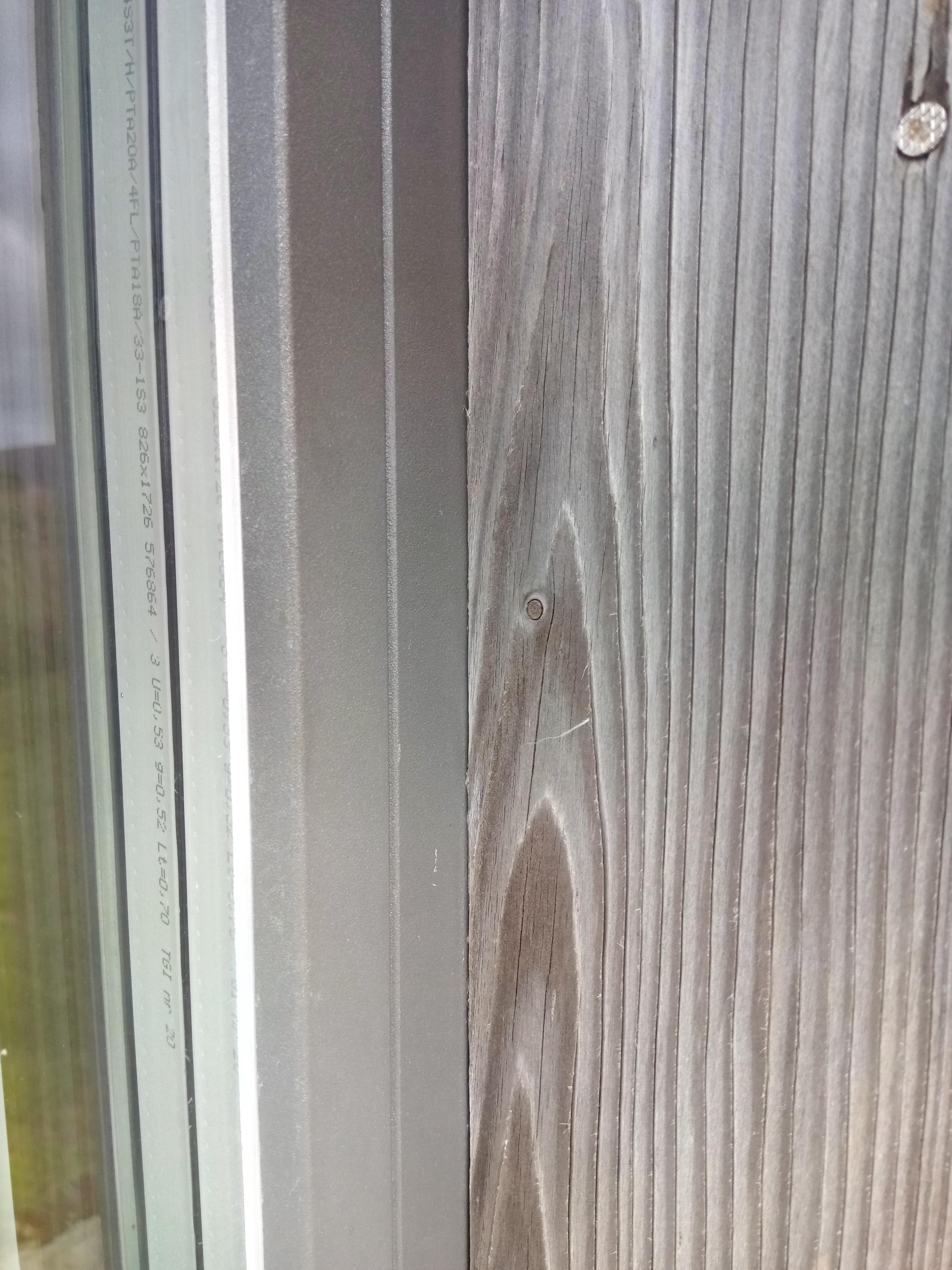

Stones Posted July 25, 2022 Share Posted July 25, 2022 We have an ICF built house with Rational Auraplus aluclad windows. Windows weather sealed to structural timber frame in ICF wall, in our case using a sealant but could as easily have been compriband. Render reveals: Plastic stop bead hard up against alu cladding. Timber reveal: Timber hard up to alu cladding. This ensures drainage channels behind alu cladding are clear and any water drains away. Weatherseal hidden and protected from elements. Link to comment Share on other sites More sharing options...
