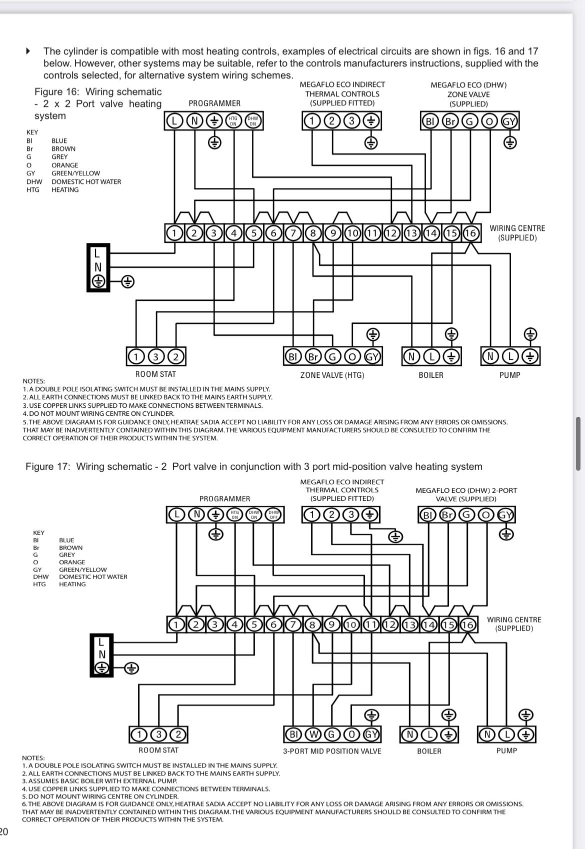

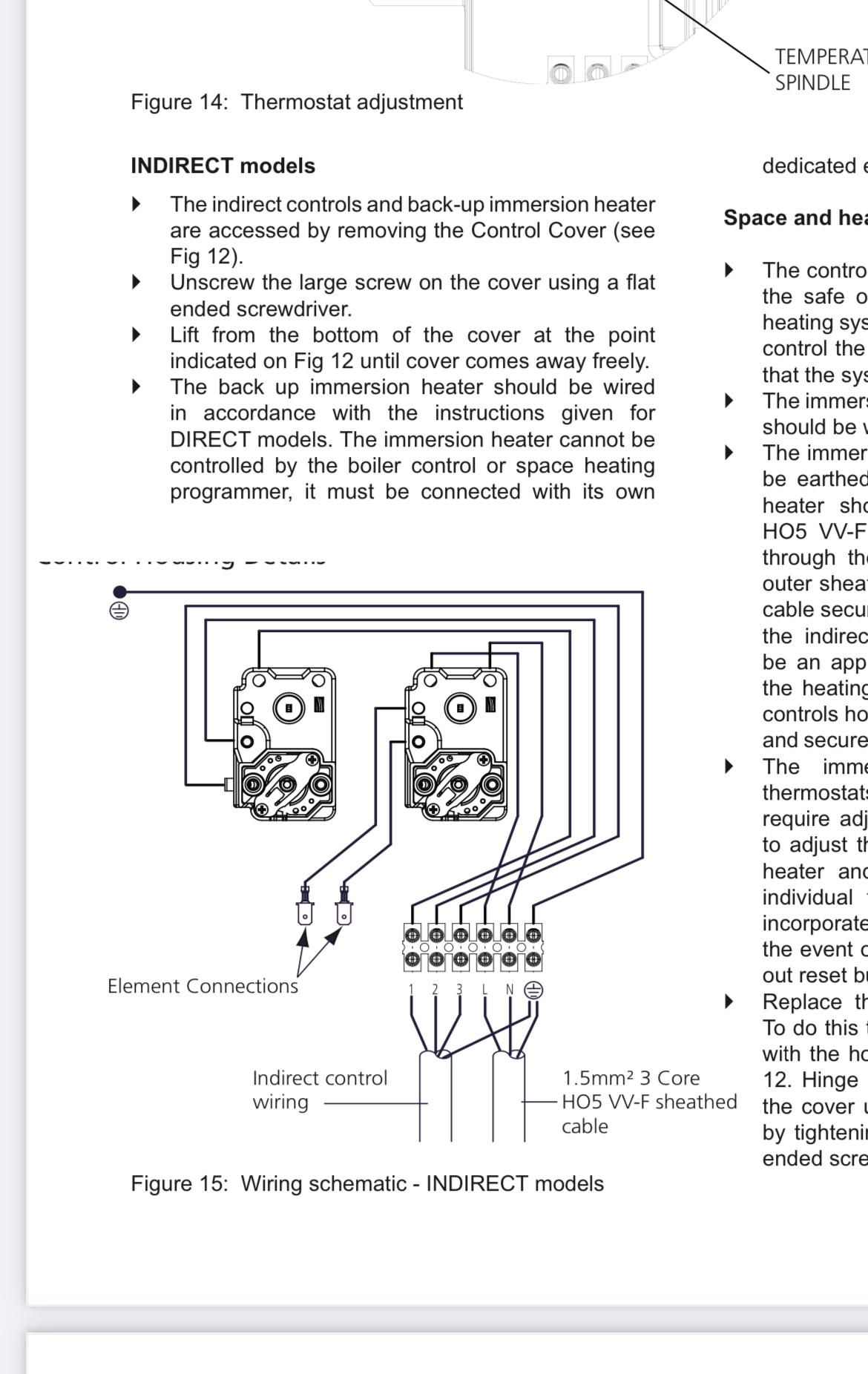

PeterW Posted July 23, 2022 Posted July 23, 2022 20 hours ago, Barryscotland said: Wunda hub has three channels an each operates one of the valves. Hot water, towel rails, ufh manifold Right so looking at this pic he has a pair of wires heading into the Megaflo control panel (the lower one) and that should be wired as per page 19 of the installation manual. But from there, the wires marked 1-2-3 should go to the wiring centre and the zone valve controller for the cylinder as per wiring on page 19/20 of the manual If he has followed this correctly then the supplied zone valve (that has a micro switch in it) will trigger the boiler to fire when it’s needed using the live switched terminal 16. If the boiler needs a NV connection then it’s a bit more complicated but it’s all done with the valves. Tank temp / cutout is then driven by the correct thermostats on the tank ..! All of this is in the installation manual if he read it …. 1
