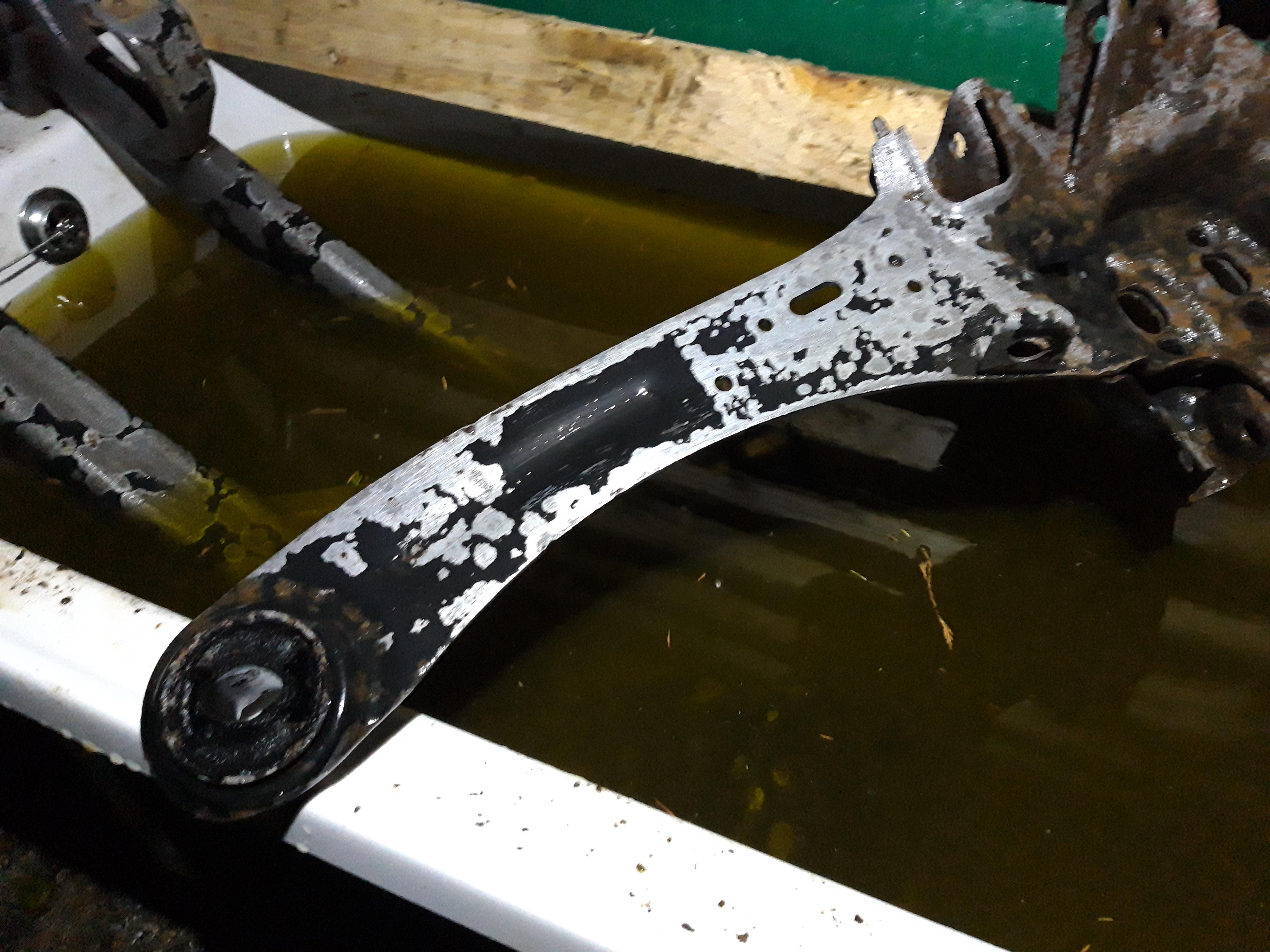

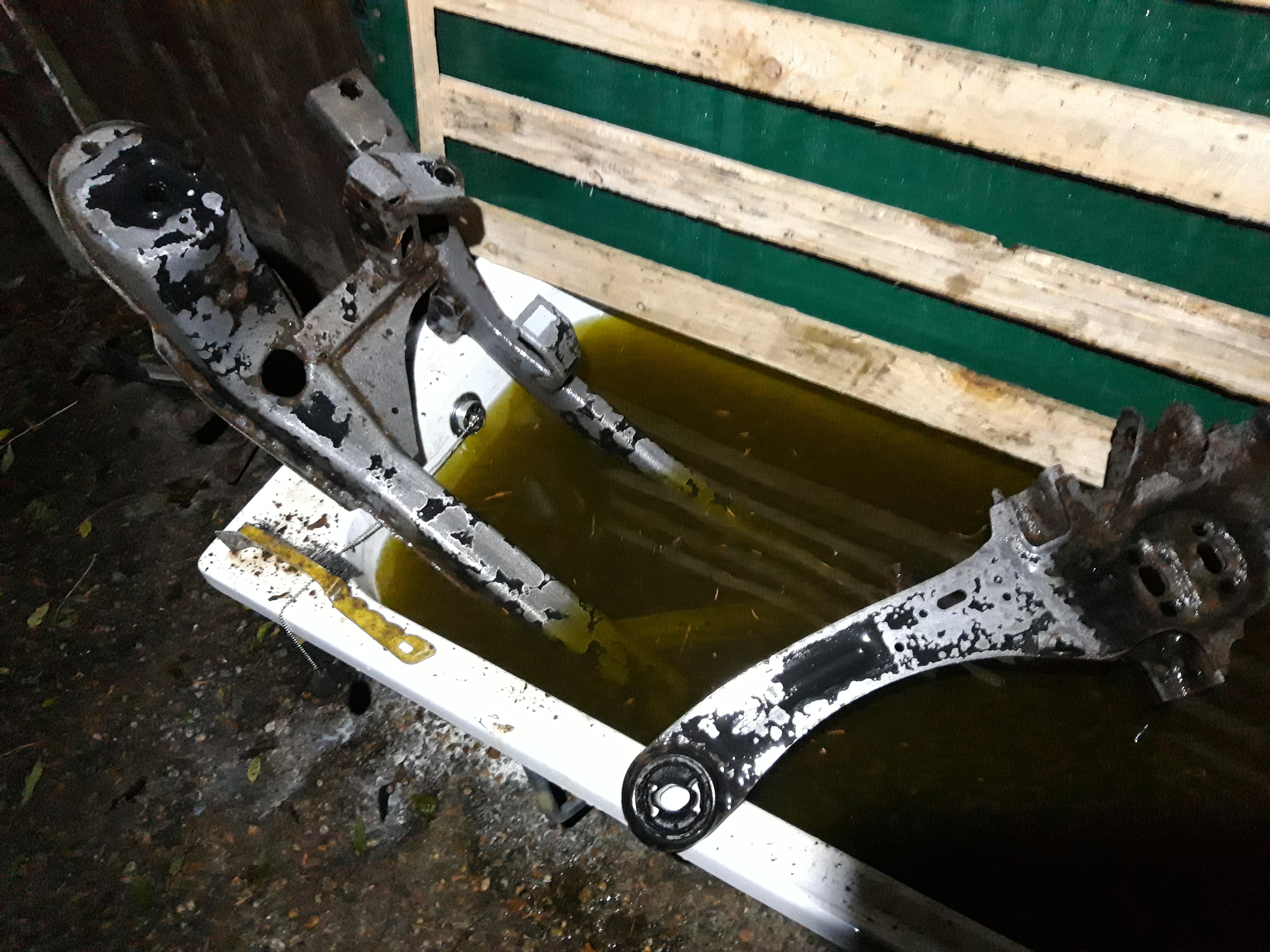

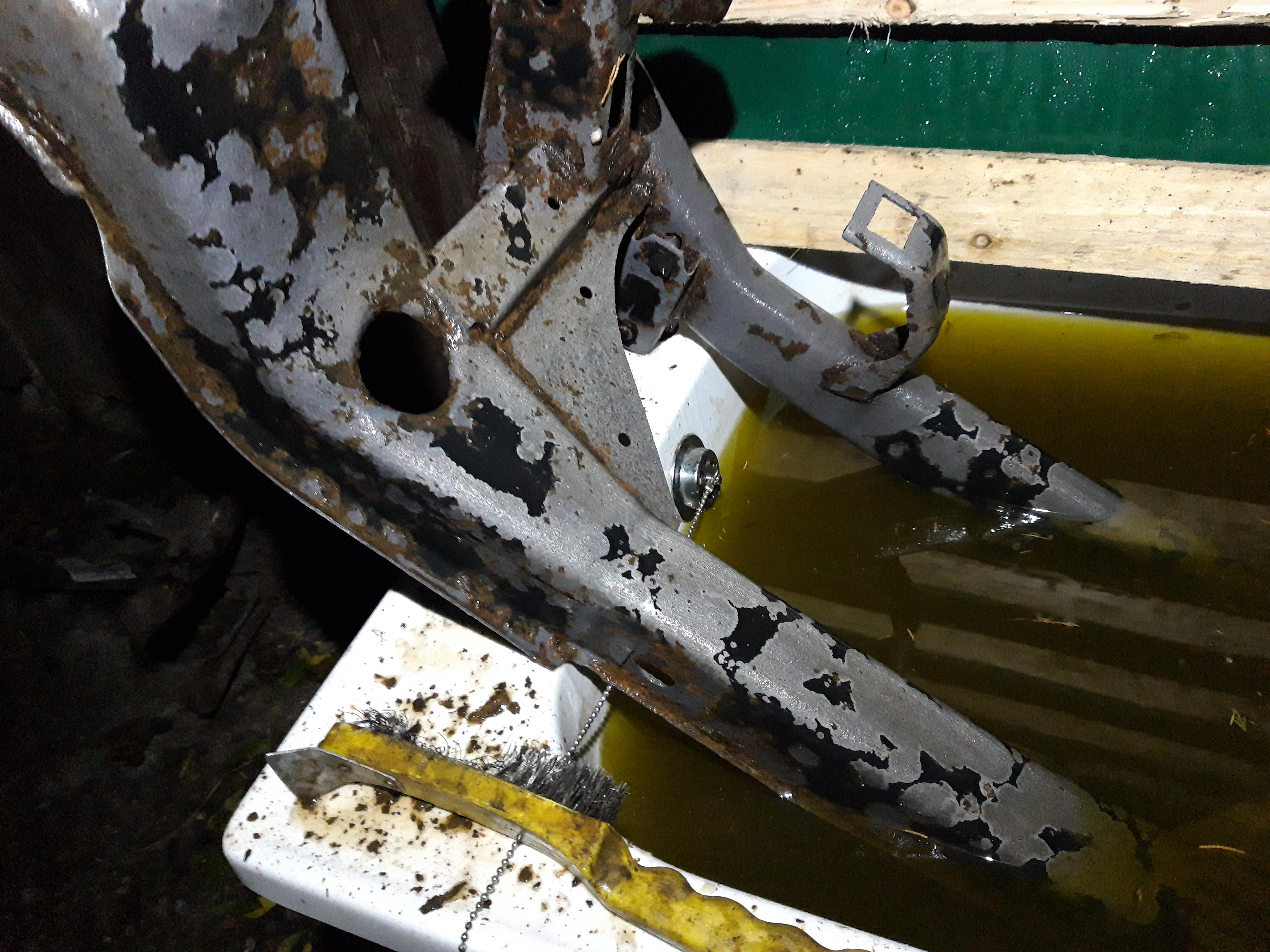

Onoff Posted November 13, 2019 Author Posted November 13, 2019 Going to re title the thread "rust removal" as it's getting away from electrolysis now. It's cold out there, frost on the car one morning but I'm really pleased with the results so far for minimal effort of 9kg of citric acid in a bath full of water! No heating etc since the initial 3 hot buckets. I will take the jet wash to it one night to hopefully deal with any stubborn paint:

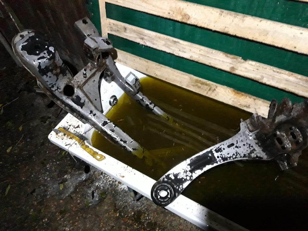

Onoff Posted November 16, 2019 Author Posted November 16, 2019 (edited) That really works well! The caliper was interesting. I took it out of the bath along with the cross member and trailing arm and jet washed the lot. Wire brushed some of the more stubborn rusty areas too. Took the caliper only indoors and washed it in the sink under hot water with a drop of Fairy whilst I freed the sliders off. It flash rusted so quickly afterwards. This is it flash rusted. 5 mins before it was clean steel. All back in the bath now. Edited November 16, 2019 by Onoff

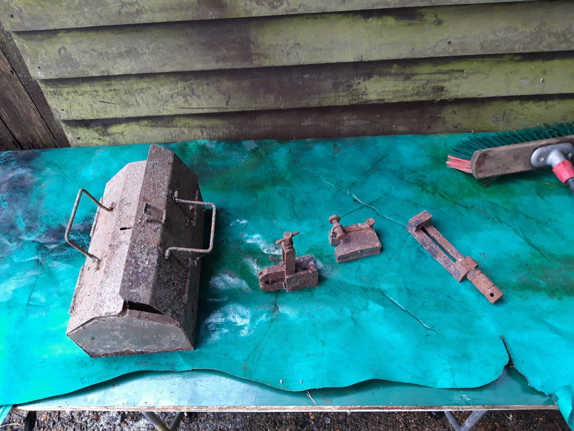

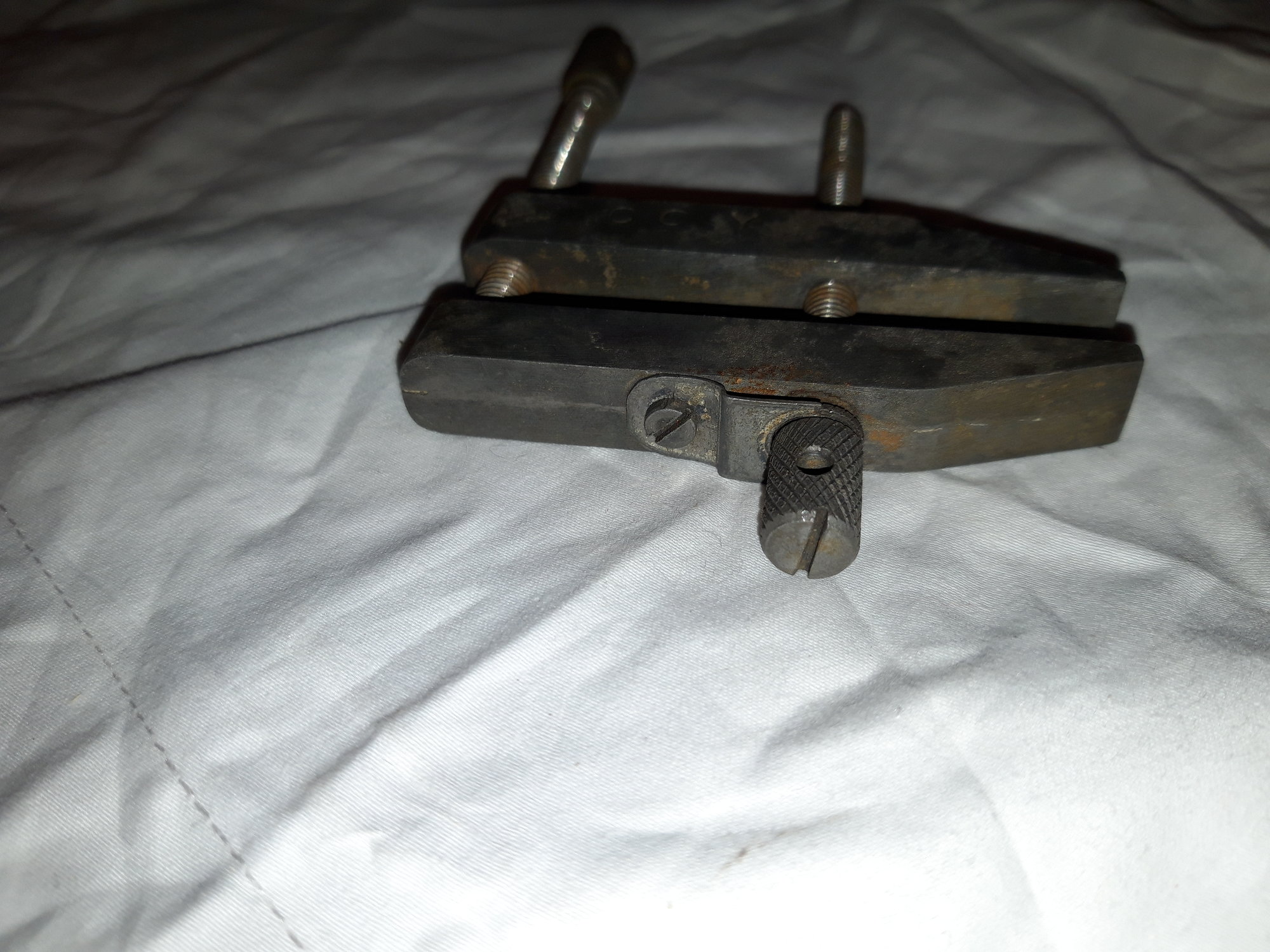

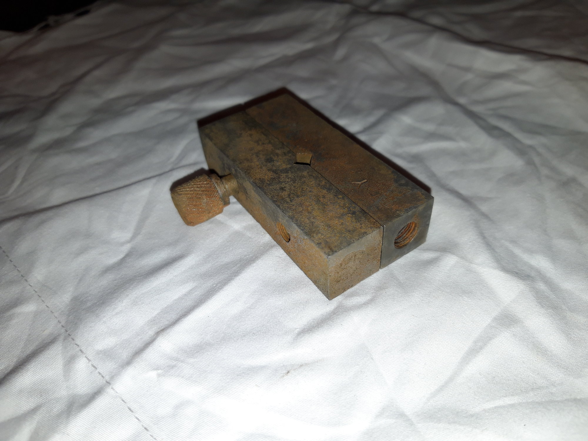

Onoff Posted November 16, 2019 Author Posted November 16, 2019 Been searching for years for one of the vices, the knurling tool and surface gauge I made circa 1983. Well I found them...in a seized barn box I also made right down to the hinges. Time hasn't been kind!All in the citric acid bath now. Fingers crossed.

Onoff Posted November 17, 2019 Author Posted November 17, 2019 19 minutes ago, daiking said: Lol, we should have a barn box thread. bit late to get mine out of the shed though I remember one of the other apprentices got his measurements wrong by 100mm when doing his tool box. Of course he had to make the lids longer in turn. He had the last laugh as only he could fit a full size hacksaw in. On another note the knurling tool is looking salvageable: Hoping to clean up the old leather working tools and flog to some yuppie with more money than sense to compliment their AGA! ?

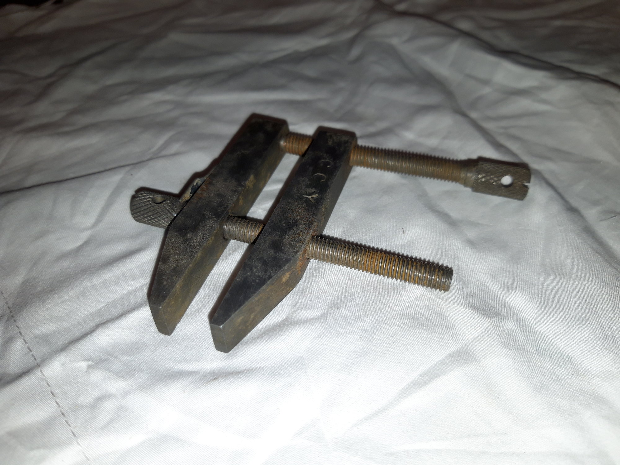

Onoff Posted November 18, 2019 Author Posted November 18, 2019 14 minutes ago, dpmiller said: Reminds me of my time studying in Edinburgh- the course had a segment in the Jewel & Esk College, the result of which was -yes- a barn door toolbox, and a meaty big tap wrench with knurled handles... Very basic tap wrench. Must have been made pretty early on, like straight after the perfect 2" cube / drill drift. Still looking for one knurled screw and a handle! I still use it's bigger brother to this day, will dig it out. (A bit more complicated to make that one). A bit later on I made this: This little clamp. Always liked it but never used it since I made it tbh: I've even got my tray work somewhere and the bending tool I made for that though I did that years after the mechanical stuff above.

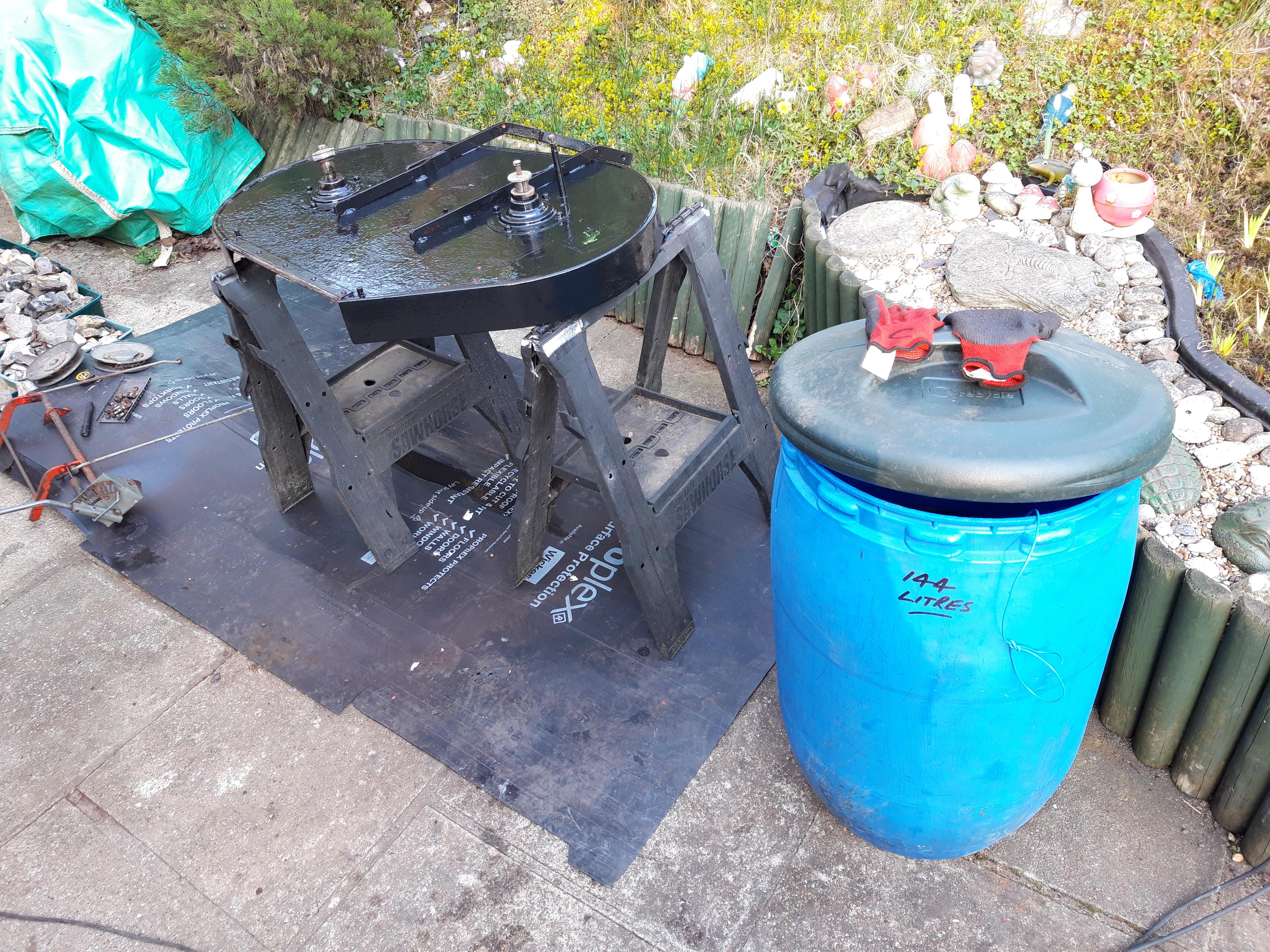

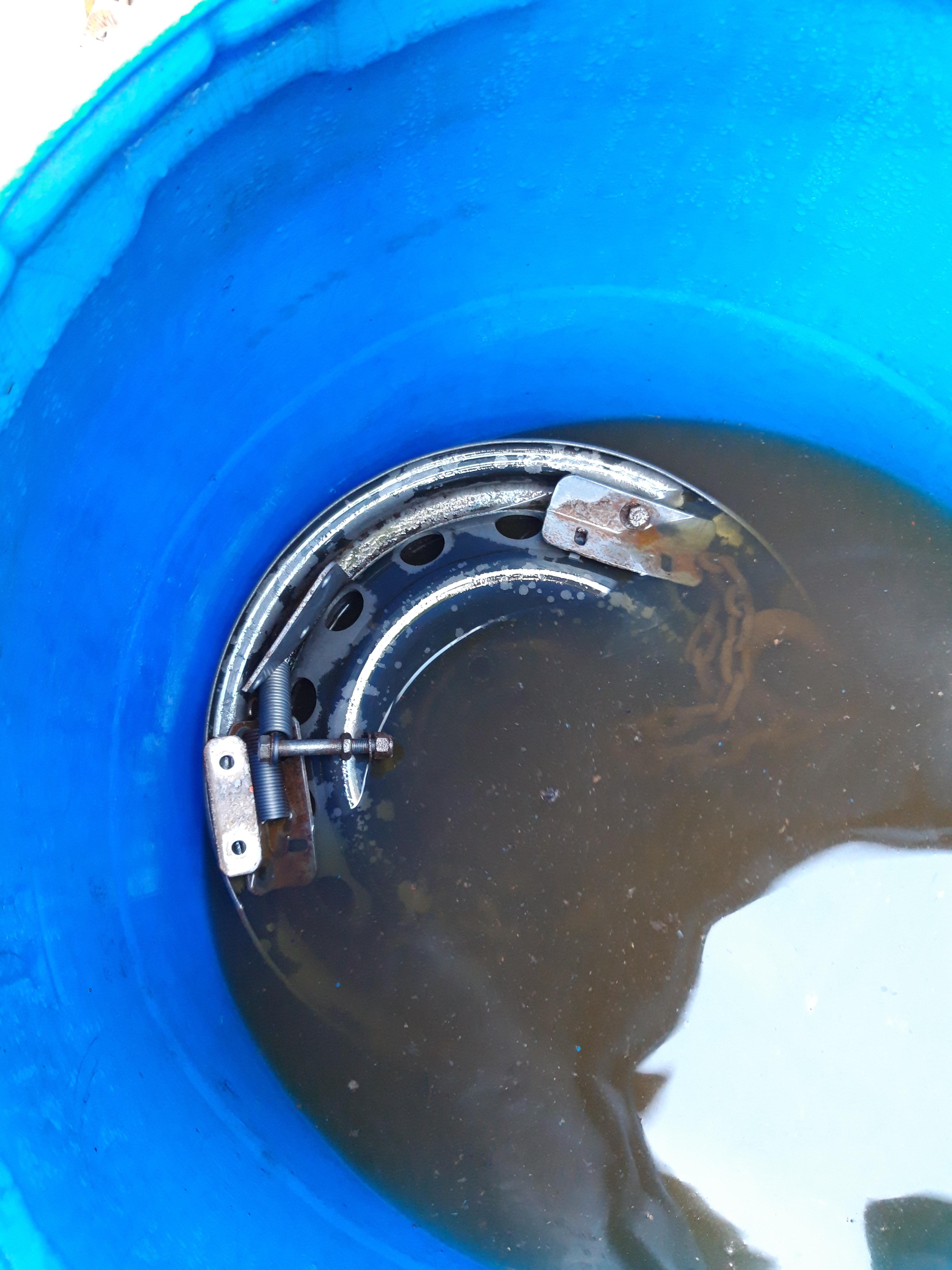

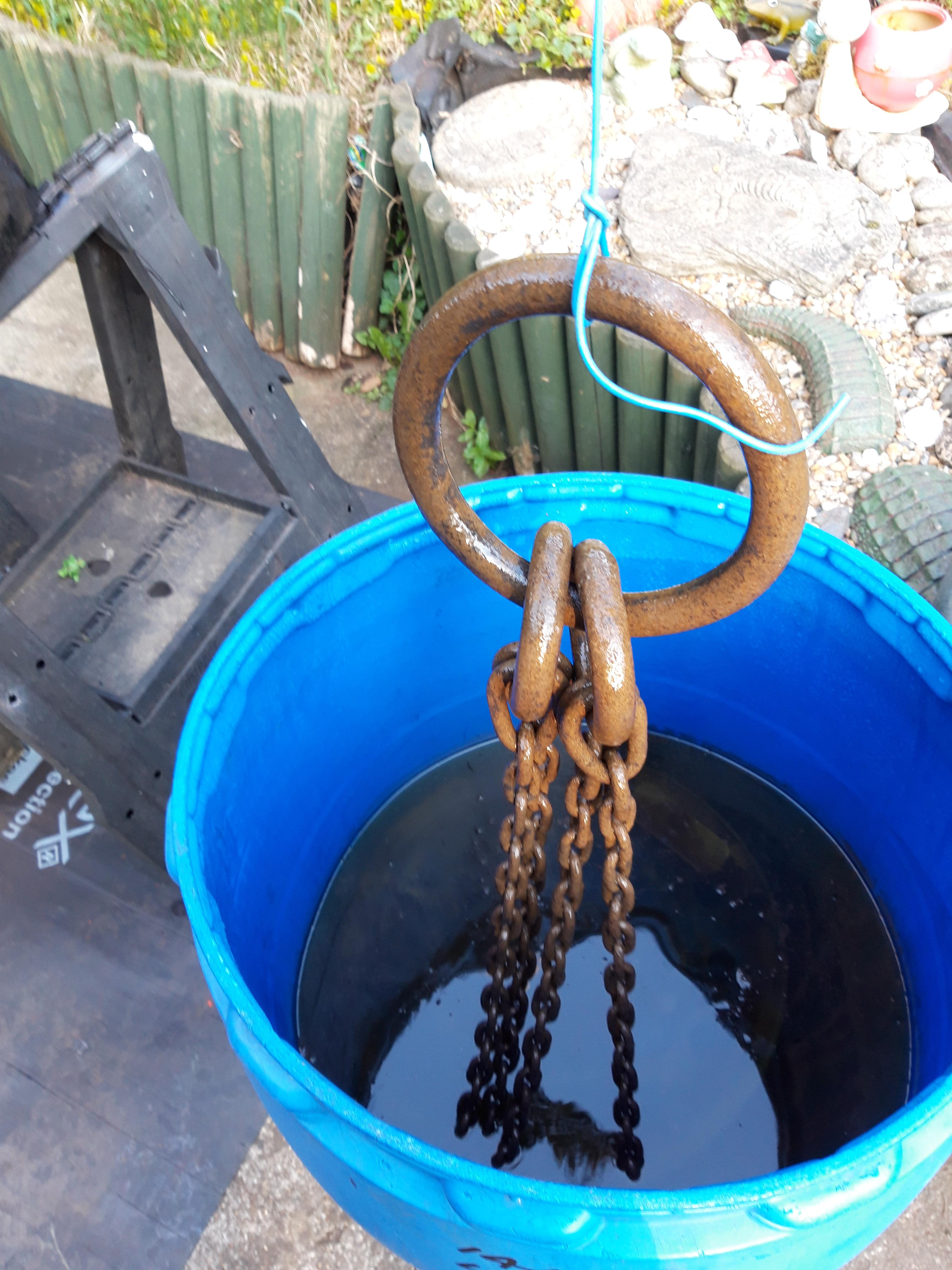

Onoff Posted April 12, 2020 Author Posted April 12, 2020 Thought I'd have another bash with citric acid. Need to do a couple of spare steel wheels for the wife's Pug, some lawnmower deck parts and some old lifting chains for the BiL. (I started off doing the wheels with electrolysis a while back. It wouldn't get paint off, I tried sand blasting...then gave up. This time they'll just get a coat of Lidl Baufix black metal paint and be done with it). 144L blue barrel. 72L of hot water and 10kg of citric acid powder. Did think about painting the barrel black to absorb more heat from this lovely sunshine.
