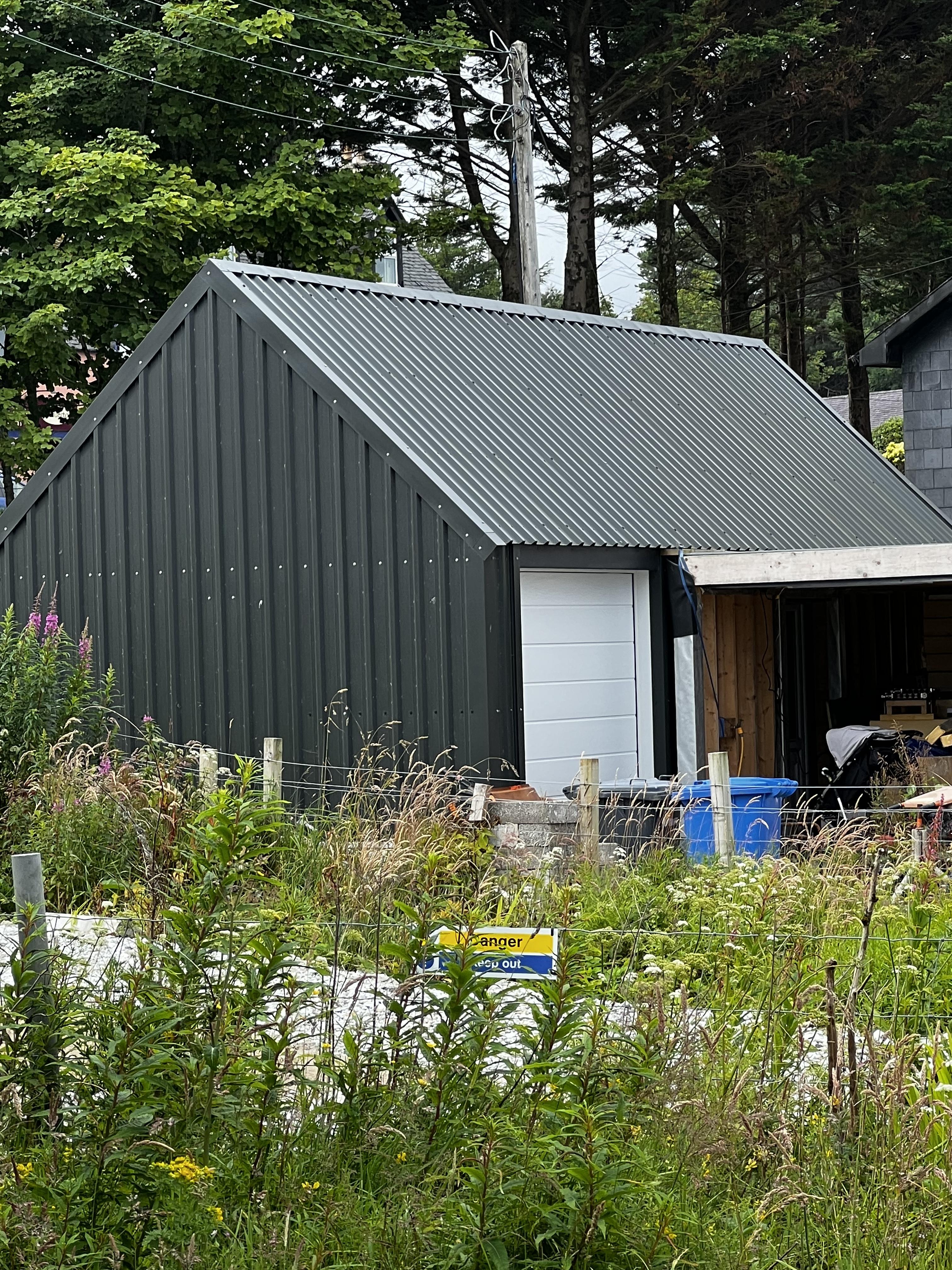

Kelvin Posted July 19, 2022 Share Posted July 19, 2022 Our planning proposal includes a largish garage/workshop/music room which is 10.5m by 6m. The original plan was to build it is a smaller version of our longhouse house in a timber kit. Prior to costs going mental it was affordable but it is the obvious place to do a bit of cost engineering. We were in the Western Isles at the weekend and saw loads of metal storage/garage outbuildings. It the first time I’ve had a good chance to look at them and we really like them. They look very agricultural which will fit in with the farms around us. I’m expecting a quote back from Catnic for their Matrix metal SIP system. It might well be as dear as the timber kit route. Any other suggestions? This is the look we are going for. Link to comment Share on other sites More sharing options...

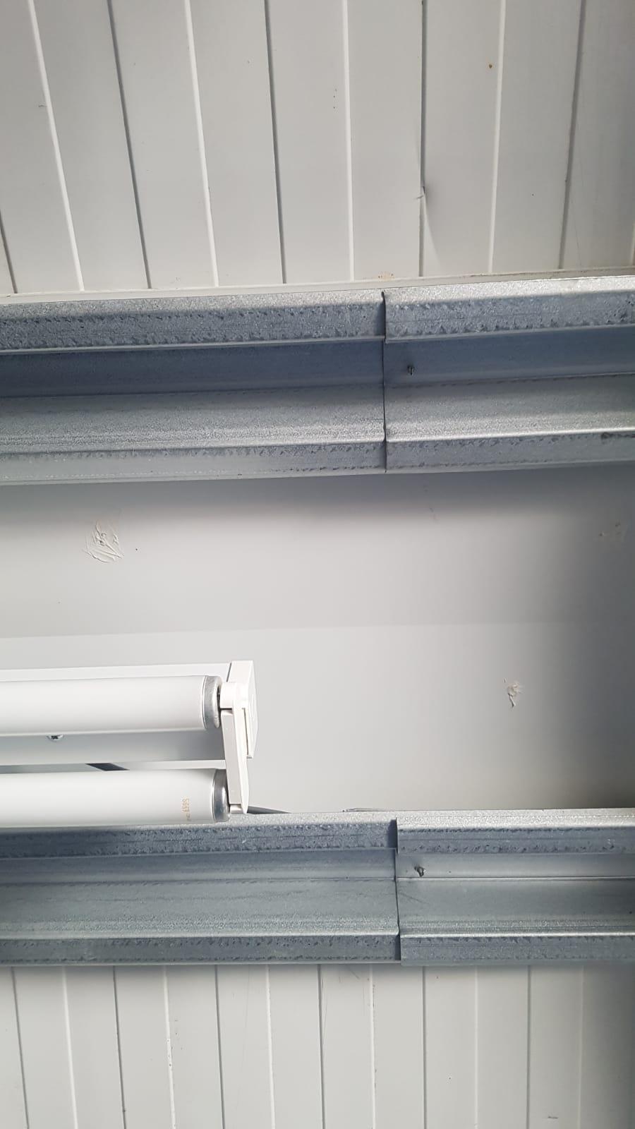

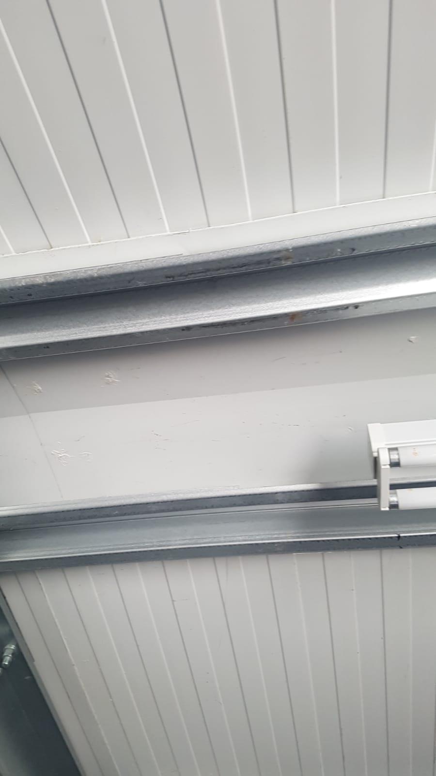

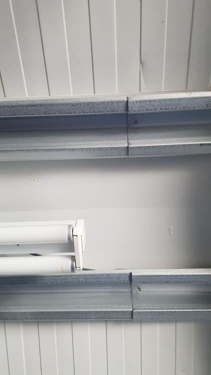

kommando Posted July 20, 2022 Share Posted July 20, 2022 You want the 40mm insulated panels for a garage, no condensation provided its airtight except at the car door. The ridge is the area to be 100% airtight as the roof panels meet there leaving a gap, there is an internal ridge that is used but behind it and under the outer ridge you need a tight packing of insulation. There are foam fillers that match the sheet profile under the top ridge plate but do not rely on these for airtightness as the top ridge plate is 1mm steel with little strength to resist being picked up slightly by high winds, really only good for keeping birds out. Pics are of the internal ridge plate that sits on the top purlins and under the panels. Link to comment Share on other sites More sharing options...

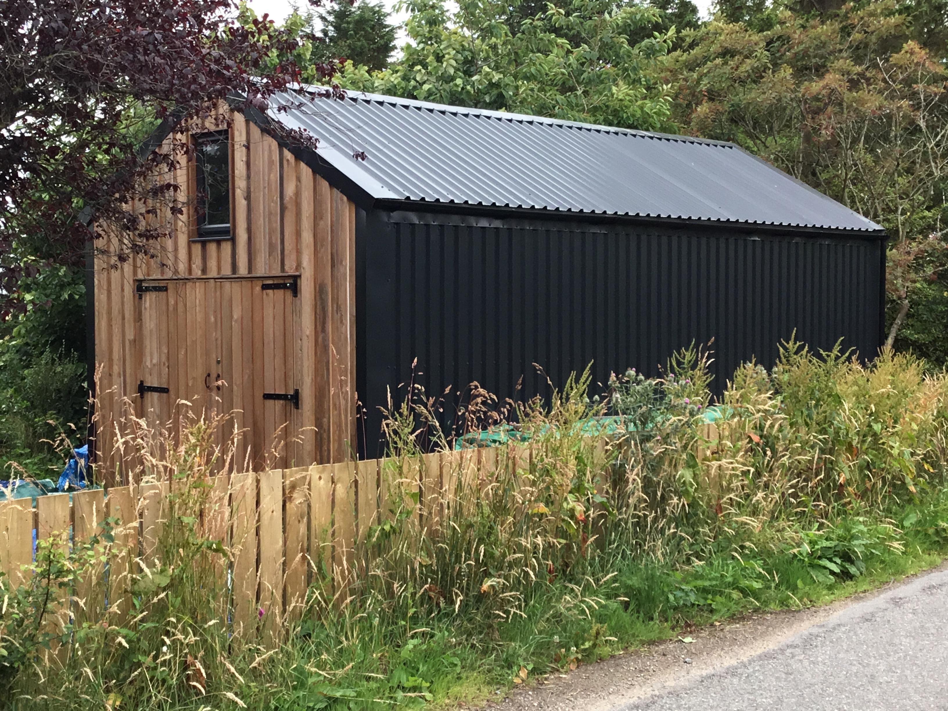

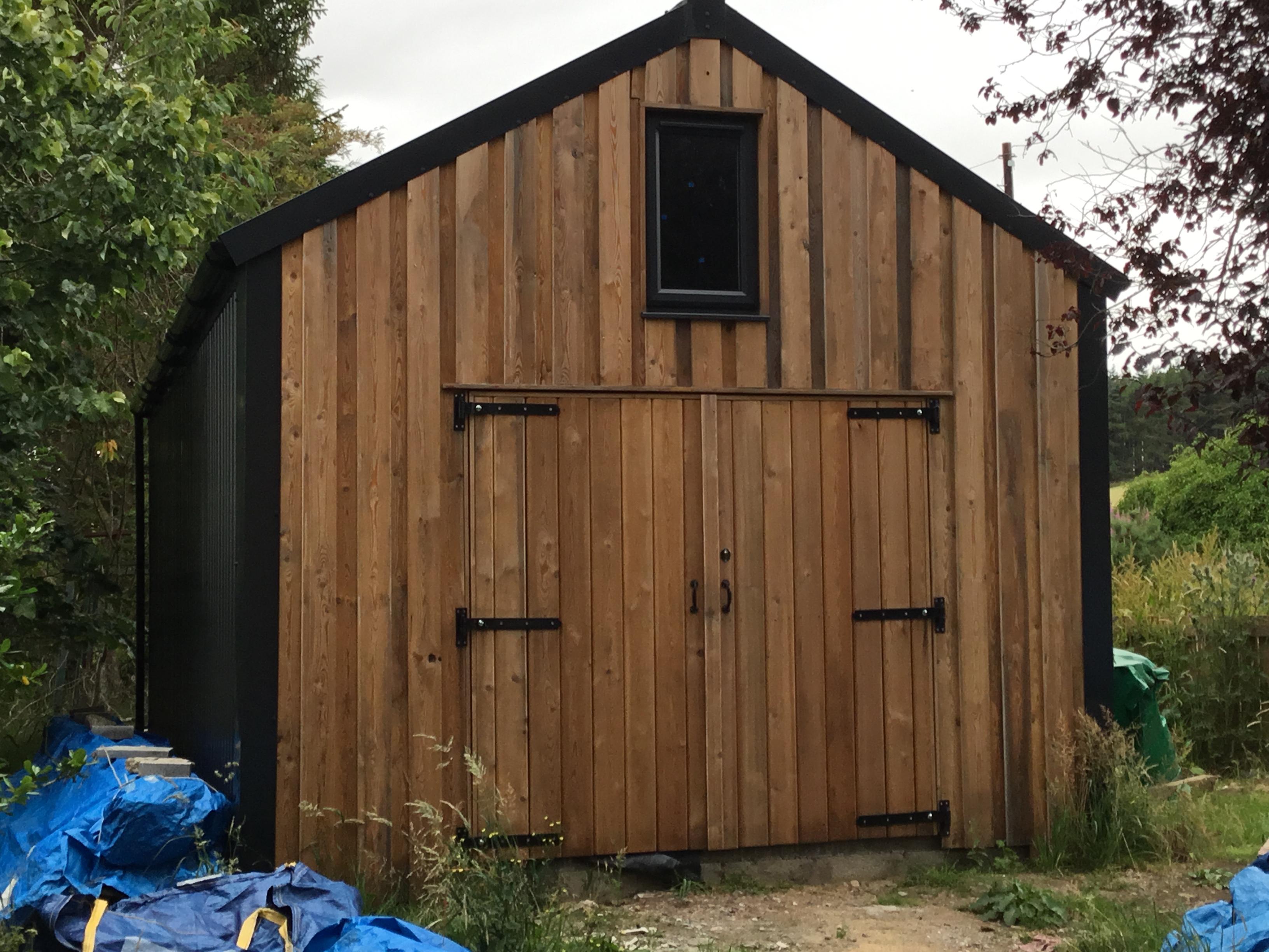

Bozza Posted July 20, 2022 Share Posted July 20, 2022 I built (not yet finished) this thing. It’s timber framed and clad in steel and leftover larch. Has a concrete floor. Due to budget restrictions I hand built it myself, and I’m not a tradesman but ok with joinery & diy. It’s 8m x 4m x 3.9m high. I had pp for garage so got the vat back on materials. Inside the rear half has a loft space - storage and the front half is a vaulted ceiling, for a workshop area. Never built a building before, so I followed building standards for a dwellinghouse and tried to copy what my proper builders did in our actual house. Idea being if I built it like a house it would take me way beyond min standards for an outbuilding. So it has DPCs, breathable membranes etc etc. it’s even plaster-boarded inside. I bought heaps of 4x2 in a builders material auction and built modular 2.4x 2.4m osb clad frame panels for the walls. Shopped around for everything to cut costs. My budget was as cheap as I could do it to the best possible standard. I didn’t keep a running total but think I’ve spent around £5-6k on it that being current lockdown/covid costs. I think I’ve ended up with a circa £15-20k building. It was hard work but good fun learning new skills etc eg building the roof. I did consider buying a metal frame to be installed but by the time I factored in everything it was obviously more expensive. We were hit hard by Storm Erwin etc but the building was unaffected. Which was reassuring. Hope this helps for ideas. 9 Link to comment Share on other sites More sharing options...
markc Posted July 20, 2022 Share Posted July 20, 2022 @Bozza that’s a damn nice garage, well done 2 Link to comment Share on other sites More sharing options...

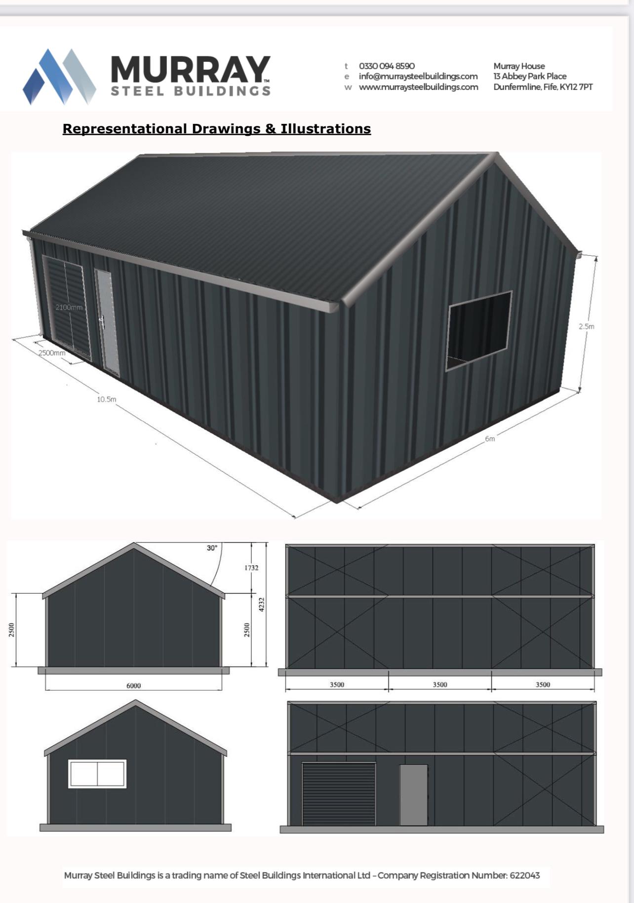

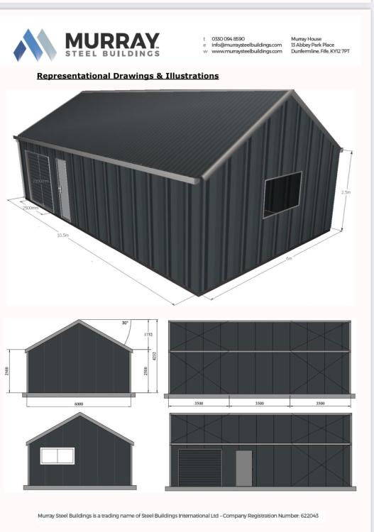

Kelvin Posted July 24, 2022 Author Share Posted July 24, 2022 I’m going to go with a Murray Steel insulated building. I’ll be able to get erected before the end of the year and then I can use it for storage etc Link to comment Share on other sites More sharing options...

Kelvin Posted July 26, 2022 Author Share Posted July 26, 2022 Got quote back. Decent price. £22k ex VAT for 40mm insulated roof and walls for 10.5mx6m with single roller door, personal door and double window. That’s supply only. Single skin is £16k. They have various insulation levels. 1 Link to comment Share on other sites More sharing options...
gaz_moose Posted July 26, 2022 Share Posted July 26, 2022 i bet you could live in an insulated one though, for reference there is a place round my way that sells the 40mm insulated panelling for £18 psm. wonder how loud it is inside the non insulated one when it rains. Link to comment Share on other sites More sharing options...
Kelvin Posted July 26, 2022 Author Share Posted July 26, 2022 24 minutes ago, gaz_moose said: i bet you could live in an insulated one though, for reference there is a place round my way that sells the 40mm insulated panelling for £18 psm. wonder how loud it is inside the non insulated one when it rains. My plan is to partition it at the window end into a more comfortable space. I’ll go with the 40mm insulation option for the whole build but do a bit more at the partitioned end eventually. My original idea was to also have a folding wall between the garage section and the workshop section so I can extend either area if I needed it. Link to comment Share on other sites More sharing options...
kommando Posted July 27, 2022 Share Posted July 27, 2022 19 hours ago, Kelvin said: My original idea was to also have a folding wall between the garage section and the workshop section so I can extend either area if I needed it. On mine I have columns separating the inside into 6 bays, I have a wall with sliding doors partitioning off the 2 bays that face North with a window that has a view. But that partitioning can be moved. If you ever need to replace a sheet then the 40mm being the most popular is held in stock, above 40mm needs ordering and in minimum quantities. There are also 0.5 mm thick sheets in plastisol for recovering the outer skin leaving the original sheet underneath. Link to comment Share on other sites More sharing options...
Kelvin Posted July 27, 2022 Author Share Posted July 27, 2022 2 hours ago, kommando said: On mine I have columns separating the inside into 6 bays, I have a wall with sliding doors partitioning off the 2 bays that face North with a window that has a view. But that partitioning can be moved. If you ever need to replace a sheet then the 40mm being the most popular is held in stock, above 40mm needs ordering and in minimum quantities. There are also 0.5 mm thick sheets in plastisol for recovering the outer skin leaving the original sheet underneath. Thanks for the info. Is it warm enough in the winter? Would it be possible to partition one end and add more insulation to that to use it more like an office? Link to comment Share on other sites More sharing options...
kommando Posted July 27, 2022 Share Posted July 27, 2022 1 minute ago, Kelvin said: Thanks for the info. Is it warm enough in the winter? Would it be possible to partition one end and add more insulation to that to use it more like an office? Its only been finished since spring but even without the partition it was warm enough to work in but not to sit. I will be adding extra insulation based on how it feels over winter. As the head height is good there is room for a suspended floor with insulation below that so that will be part of the extra insulation. The windows are double glazed and all the joints between the panels are filled with expanding foam or a bead of silicone so its very airtight. Link to comment Share on other sites More sharing options...
DevonKim Posted October 15, 2022 Share Posted October 15, 2022 @Bozza What a nice looking garage! I'd really like to build something similar - any chance of some photos of the inside? Link to comment Share on other sites More sharing options...
Bozza Posted October 15, 2022 Share Posted October 15, 2022 2 hours ago, DevonKim said: @Bozza What a nice looking garage! I'd really like to build something similar - any chance of some photos of the inside? Cheers. Unfinished inside I’m afraid - have spent the summer on landscaping - will post pics once finished possible circa 2026 Link to comment Share on other sites More sharing options...
