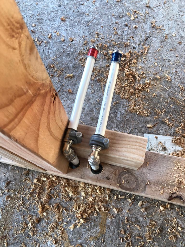

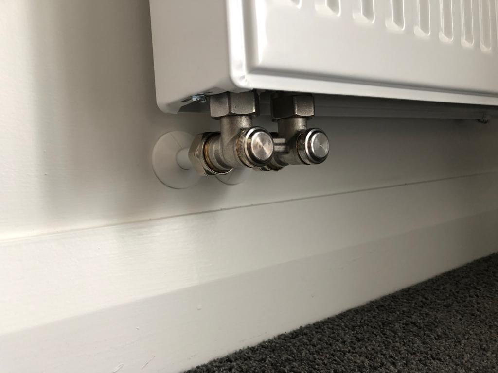

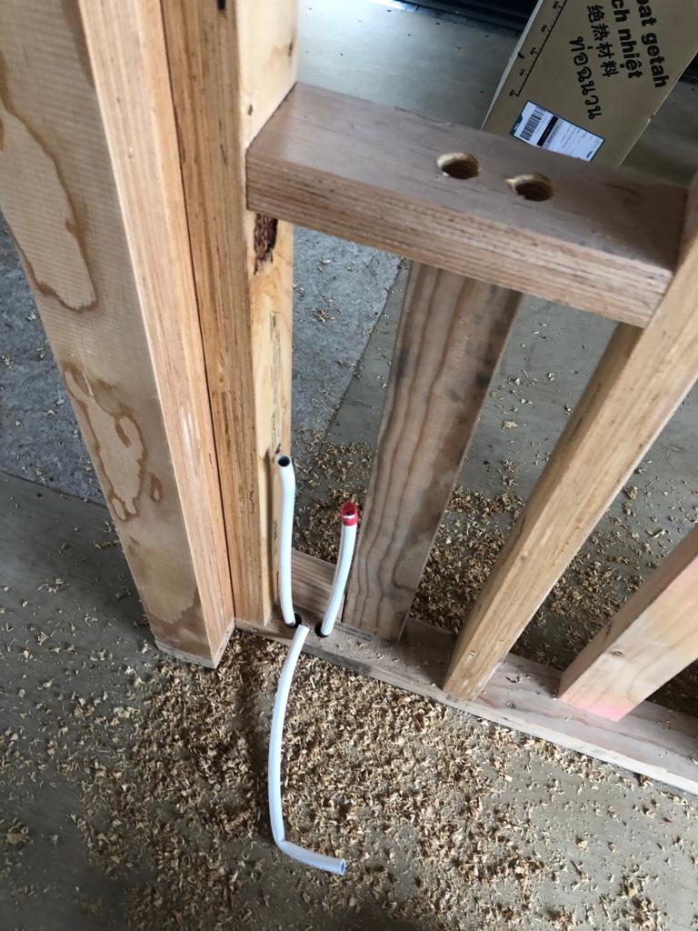

Tommytipee Posted July 9, 2022 Author Share Posted July 9, 2022 (edited) I’m not using any of this for dhw this is solely for heating. I was thinking it’s more cost effective to use the ashp to heat in the day when it’s 7 degrees plus temp rather than when I need it and the temps are -4 to 3 degrees. I was going to heat the thermal store to say 55 via heatpump and top up the rest via immersion. The other issue is installing the rads it’s all done by getting in the loft drilling down through the timber frame with 2m long drill bits and feeding the pipes down cutting a small hole behind the rad and feeding the pipes out. Other issue with larger rads for lower temps is amount of wall space there’s a lot more windows in kiwi houses and can only fit smaller rads not always 1800+ ones. I don’t like the MLCP pipe here either with crimp fittings so I wanted to use underfloor manifolds so I could run straight from manifold to each rad in one length with no fittings in the wall, this is also not going to fit well with running lower flow temps direct to rads I’m guessing or will it be if I ran the pipe in 20mm rather than 16mm to each rad?. (The furthest run from manifold to rad will be 25m in length shortest would be a 10m run. Edited July 9, 2022 by Tommytipee Link to comment Share on other sites More sharing options...
Tommytipee Posted July 9, 2022 Author Share Posted July 9, 2022 (edited) Edited July 9, 2022 by Tommytipee Link to comment Share on other sites More sharing options...
MikeSharp01 Posted July 9, 2022 Share Posted July 9, 2022 9 minutes ago, Tommytipee said: down through the timber frame with 2m long drill bits Respect - getting that bang on over 2m! Link to comment Share on other sites More sharing options...
Tommytipee Posted July 9, 2022 Author Share Posted July 9, 2022 3 minutes ago, MikeSharp01 said: Respect - getting that bang on over 2m! Haha it’s not too bad. The pics above show it on a new build done at first fix phase but for retrofit it’s clambering in the loft drilling down through the top plate of the wall and any dwangs you encounter. Normally 2 but sometimes 3!. This further limits where to put rads as can’t normally get onto outside walls as the slope of the roof where it meets the external walls mean that you can’t get a drill into the space let alone a 1m long drill extension. Just remove the plasterboard I hear you all cry, there’s a 6-9 month wait on sheets of plasterboard at the moment it’s causing carnage in the building industry. 🤣 Link to comment Share on other sites More sharing options...

HughF Posted July 10, 2022 Share Posted July 10, 2022 Surface mount the mlcp and box in, no need to mess about with long drill bits. I know it looks a bit council house, but it looks fine in my council house 😂 Ditch the idea of the TS, the losses will be crazy as they’re never insulated well enough. Upsize the rads for a 50 deg flow, job done. Add the odd fan coil unit if you want cooling in the summer time. Link to comment Share on other sites More sharing options...
