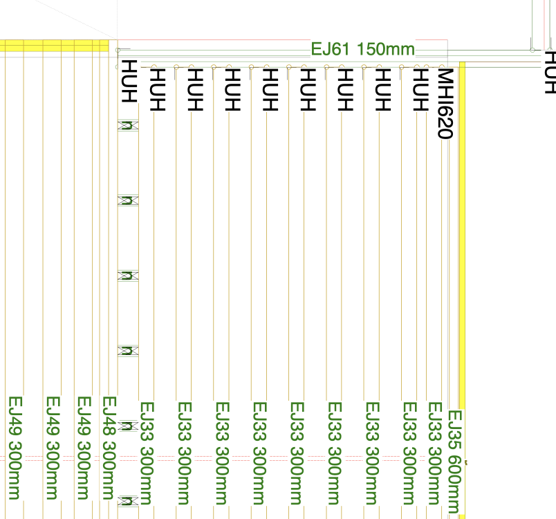

so I've watched some videos on the Schluter system using Kerdi board and shower tray and curb etc and it all looks pretty cool. but, I'm not sure that's exactly what I'm after. I don't really want a curb to step in to our shower rather I'd like a wet room type affair albeit I might need to step up in to the wet room area. so I was thinking of building a false floor about 100mm up from the existing floor and then putting some form of waterproofing system and preformed wet room shower tray on top of that which should give me space underneath to be able to route the waste pipe to between a joist!

so I 'should' be able to but we had our joists designed to a max deflection of 8mm and they have 300mm centres with the posis being 122mm wide. so they are very close together. the problem is that, with the fixed shower trays, trying to find one where the waste outlet fits directly above a space between the posi-joists. it's about 170mm gaps.
but, reading up on the Schluter system it seems that I could get a preformed sloping tray and position the waste over a space between posi-joists and then fill in any gaps around the preformed tray with more kerdi board. I believe this will work but I need to do more research on the whole system and it's depths and sizes etc. I will also speak to the plumber about it all and get his take on it.
The Impey wet room shower former that I used has the waste offset in a central circular section that could be rotated, so as you rotated it, the off centre waste position changed.  You would be very unlucky indeed if you could not find a position with that where the waste did not line up with one of your gaps.  And if it was only slightly off, move the whole tray over slightly and fill in the gap.

Instead of fitting a pre formed tray and filling in the edges, why not buy a tray former that is too big and trim it down to get the waste where you need it.
