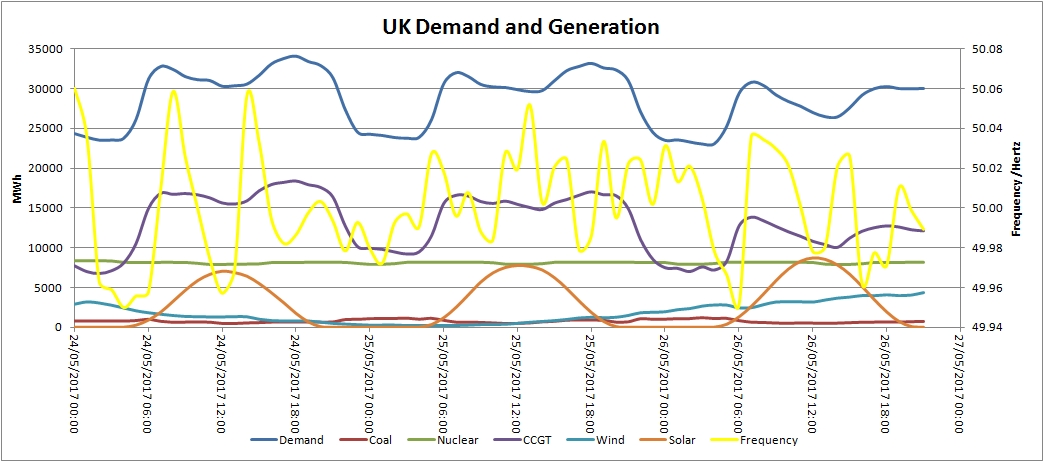

SteamyTea Posted May 26, 2017 Share Posted May 26, 2017 I just heard the Beeb report. The thing that struck me about it was that they mentioned that around Noon it was producing more than our 8 nuclear installations. Hopefully that should being the message home. It is much easier to get few large consumers to use power than 30 million domestic consumers. I don't have a problem with that. A quick chart I have just knocked up. 1 Link to comment Share on other sites More sharing options...
Jeremy Harris Posted May 26, 2017 Share Posted May 26, 2017 Interesting to see that coal is generating practically nothing and that CCGT is doing the load balancing, ramping up and down pretty rapidly to meet the changing demand as solar and wind kicks in. Looks like three near-perfect solar days, too. Link to comment Share on other sites More sharing options...

jack Posted May 27, 2017 Share Posted May 27, 2017 10 hours ago, JSHarris said: Interesting to see that coal is generating practically nothing I knew we'd moved away from coal but that's a startling graph. Link to comment Share on other sites More sharing options...

SteamyTea Posted May 27, 2017 Share Posted May 27, 2017 What I find interesting about the graph is that frequency does not correlate well with demand very well on the 25th. I am not sure if that was just a 'bad day' for the grid, or there is something much more fundamental going on. One of the problems is that the power auction for each half hour block to help balance the grid closes about an hour and a half before it is delivered. Then something unexpected can happen. Link to comment Share on other sites More sharing options...
Jeremy Harris Posted May 27, 2017 Share Posted May 27, 2017 I have a feeling that distributed generation can cause the grid frequency to do some odd things, as most grid tie inverters use frequency as an indicator of load, I believe. I would hazard a guess that having significant power inputs, from generators that have virtually no "flywheel effect" might cause the grid frequency to do some unusual things, as might the impact of HVDC distribution, with local AC conversion. Not sure about any of this, but I recall reading an article some time ago that suggested that grid frequency stability might be impacted by lots of small scale generators. Link to comment Share on other sites More sharing options...
Stones Posted May 27, 2017 Author Share Posted May 27, 2017 5 hours ago, JSHarris said: I recall reading an article some time ago that suggested that grid frequency stability might be impacted by lots of small scale generators. I recall something similar. I was of the understanding that we needed constant baseload to iron out the peaks and troughs associated with renewable generation, which by its very nature is variable. I seem to recall significant concern about this when Longannet Coal Power Station was closed and the impact it would have on the Scottish grid stability. Is the difference in frequency shown in the graph +/- 0.05 significant in how the grid operates and the effect it has on us as end user? Link to comment Share on other sites More sharing options...
