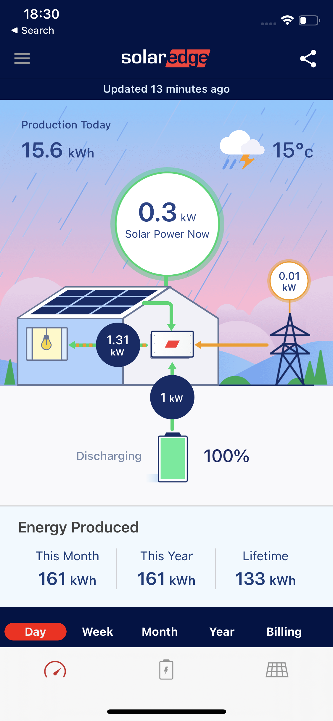

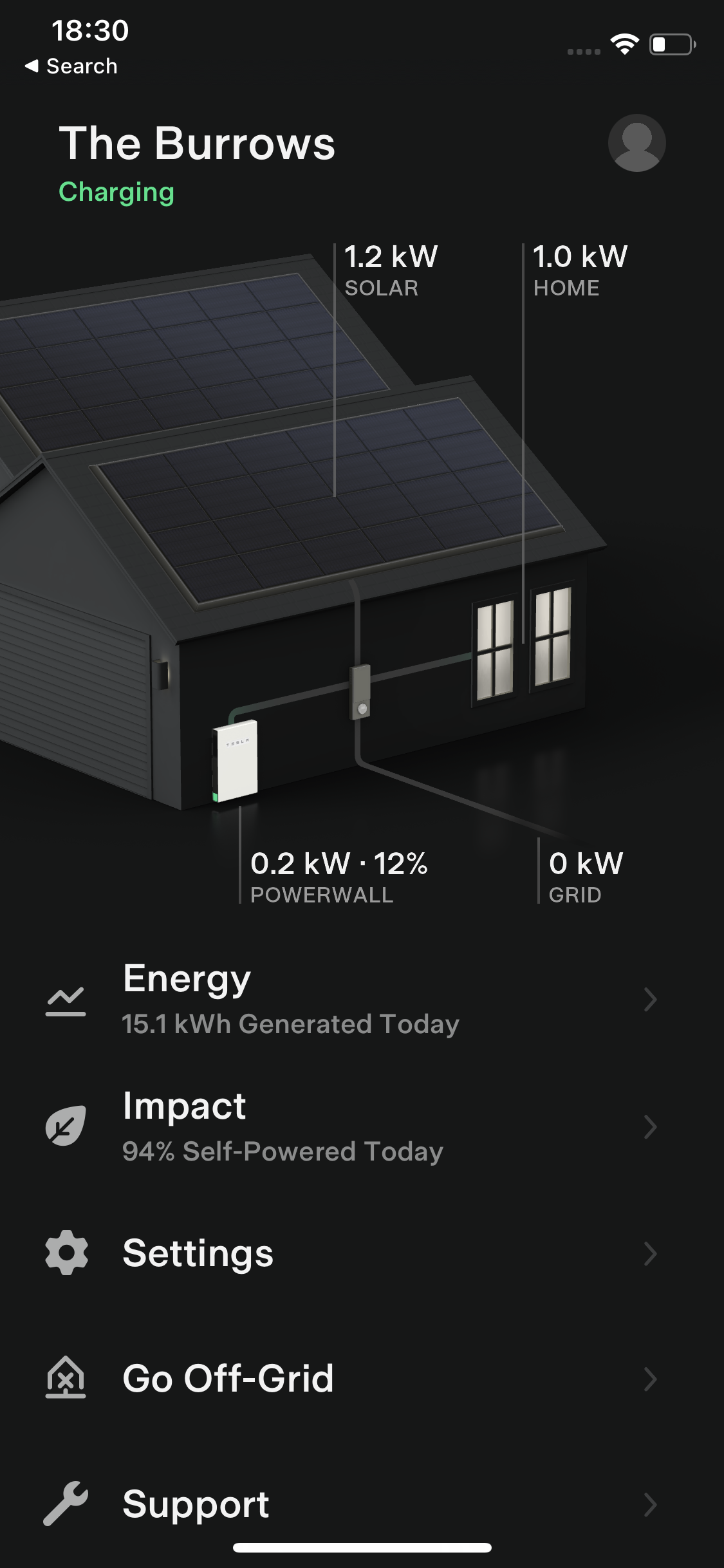

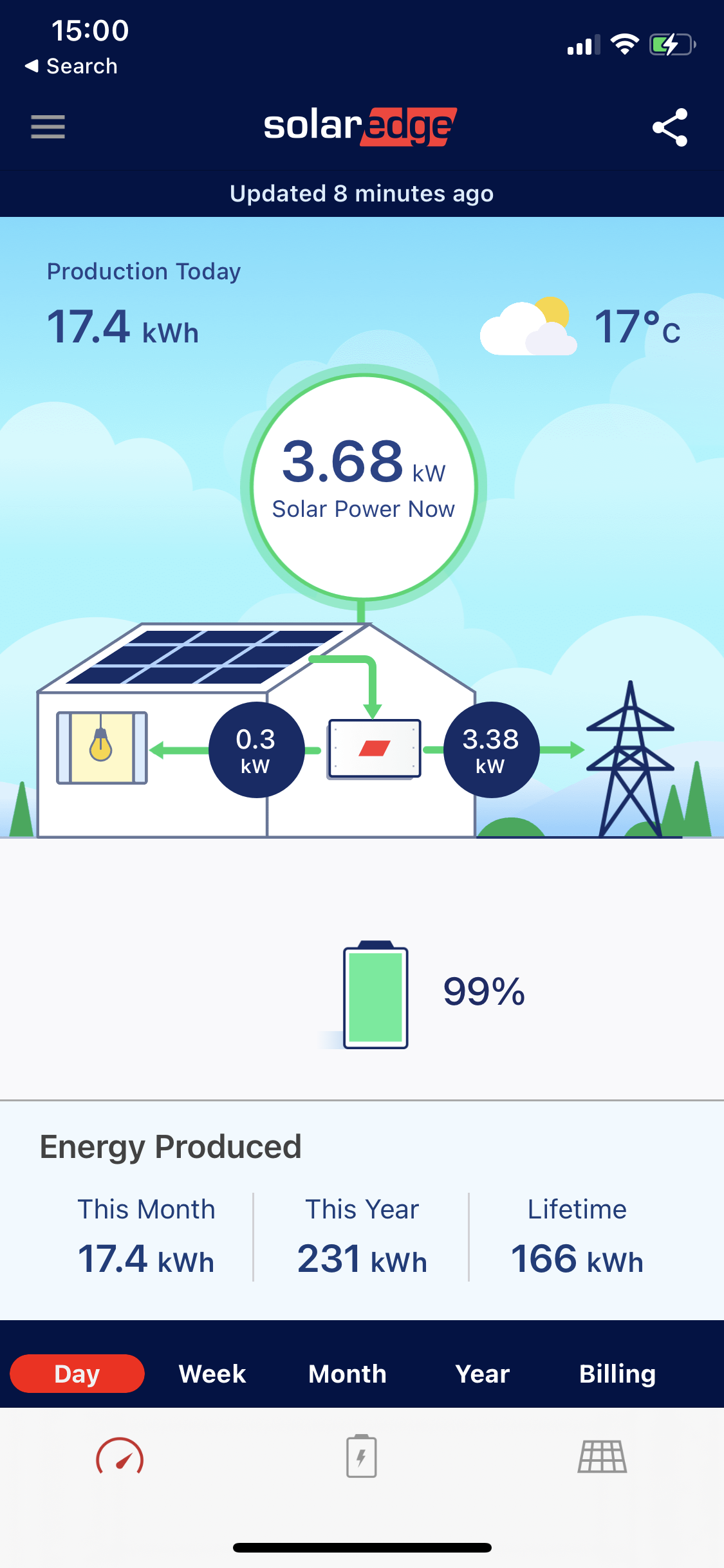

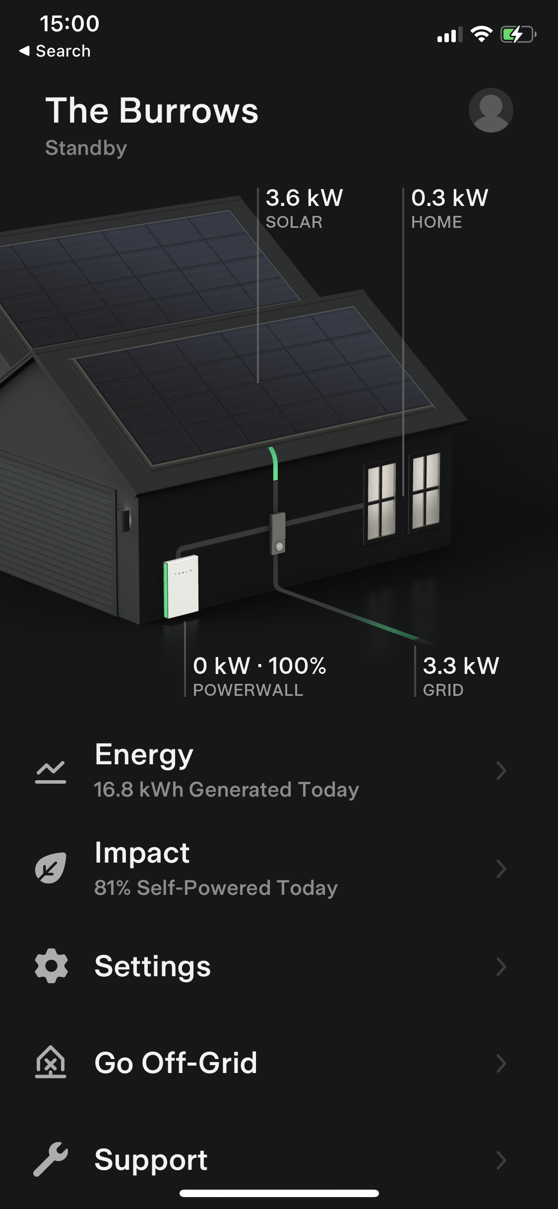

Pocster Posted June 29, 2022 Author Share Posted June 29, 2022 (edited) On 28/06/2022 at 10:17, pocster said: Yes one thing that confuses me ; I’ve gone from a 4K pv array to 8k . Yet my pv generation is clipped at 3.66k ( due to inverter I assume ) . So what’s the real benefit of 4K over 8k in this situation? . Naturally my understanding is probably the flaw 😁🙄 I shall answer my own question! My new array can generate more than 3.68kw . So in a Tesla world any generation greater than that would be clipped . As the SE is DC it can take generation above that . So clipping will only occur when SE is full and generation is greater than 3.68kw . If I wait patiently someone will be along to spoil my understanding. Edited June 29, 2022 by pocster Link to comment Share on other sites More sharing options...

joth Posted June 29, 2022 Share Posted June 29, 2022 33 minutes ago, pocster said: I shall answer my own question! My new array can generate more than 3.68kw . So in a Tesla world any generation greater than that would be clipped . As the SE is DC it can take generation above that . So clipping will only occur when SE is full and generation is greater than 3.68kw . If I wait patiently someone will be along to spoil my understanding. Correct. So you should try to limit the rate of charging the SE battery until PW is full, otherwise you risk filling the SE first and then wasting energy due to the inverter limit. Did you try and get a G99 approval and denied? I'm really surprised that buying a replacement inverter and going for two batteries you'd stick with the default DNO limit. Link to comment Share on other sites More sharing options...

Pocster Posted June 29, 2022 Author Share Posted June 29, 2022 13 minutes ago, joth said: Correct. So you should try to limit the rate of charging the SE battery until PW is full, otherwise you risk filling the SE first and then wasting energy due to the inverter limit. Did you try and get a G99 approval and denied? I'm really surprised that buying a replacement inverter and going for two batteries you'd stick with the default DNO limit. I think that is exactly what happens . SE fills first ( but it would / it’s on the PV side of the inverter ) . I *think* PW will only get PV when SE is full . DNO wouldn’t give me anymore . 3.68 on inverter AND a PW ( effectively an inverter also ?!????! ) . In my locality you wouldn’t get that now . Tbh - export I don’t care about . Link to comment Share on other sites More sharing options...
Pocster Posted June 29, 2022 Author Share Posted June 29, 2022 This is what throws me ! SE full - very little Pv Pw thinks it’s all solar …. So Tesla app ‘solar ‘ is only real solar when SE full , otherwise it’s ‘solar ‘ is solar + SE discharge . Real PV is what SE app shows . Both apps show grid import ( though measure it differently ! ) regardless of who imports . Link to comment Share on other sites More sharing options...
