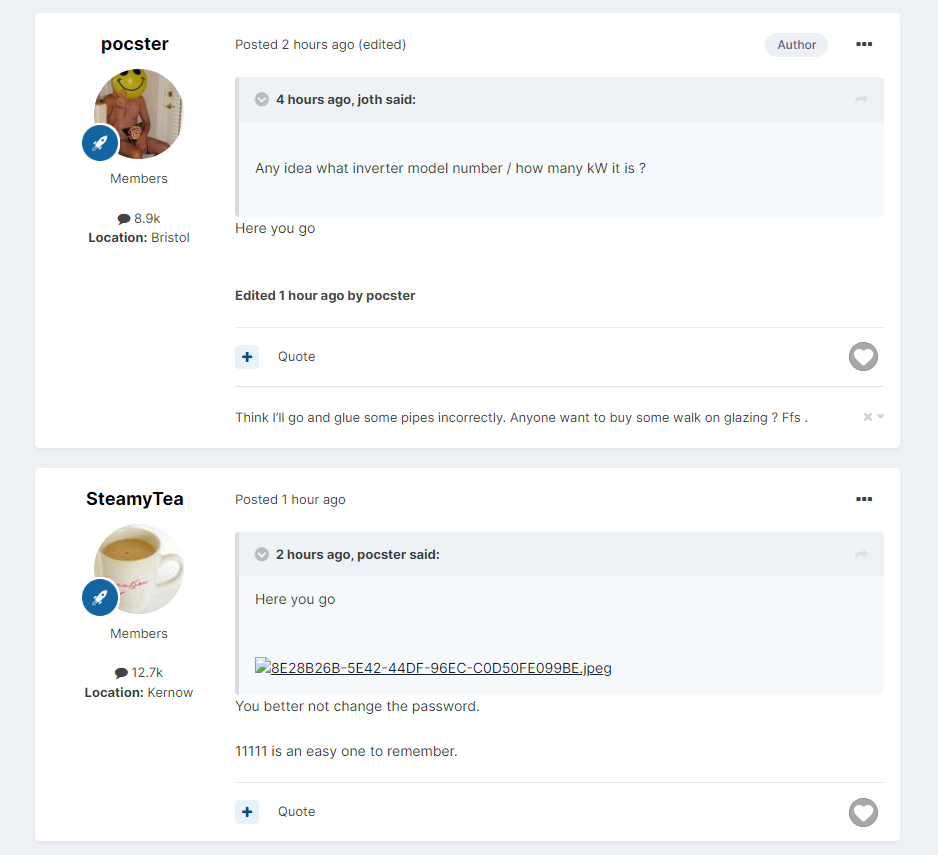

Posted (edited)
2 hours ago, joth said:
Any idea what inverter model number / how many kW it is ?
Here you go
Edited by pocster
Posted
3 minutes ago, pocster said:
Se3680h
Is that similar to 420 friendly and likes O.

9 hours ago, Radian said:
2023722165_Screenshot2022-06-2721_54_52.thumb.png.56095b6010f391cd3690b4557db75505.png
Did the type of .jpeg @pocster deleted rhyme with Corn? Or is my PC playing up?
It was to graphic for your little eyes
