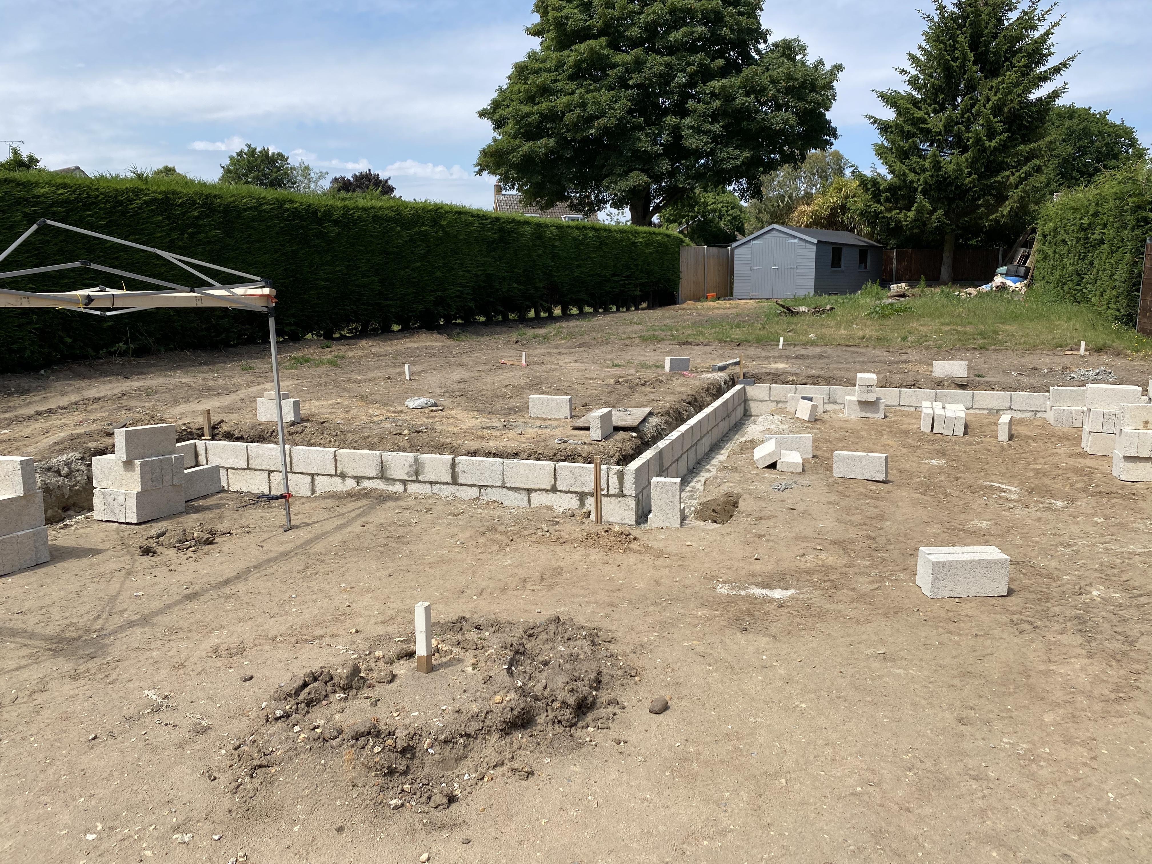

What would a qualified bricky need to be laying a day? I know it depends on the type of work but, ball park what would a bricky need to be laying on day rate?

At £22 m2 A 100 would give a brickie
£220
150-200 would be normal
If they’re building that 330mm substructure wall on your other thread then they’d be mad to not want it on price!!

It will all depend on how good you are. If your constantly reaching for the level and checking and tap tap tapping on the wall your not going to earn much. Will also depend if you have help to stack the blocks and mix the mortar.
Walls with loads of openings, doors and windows, will be a lot slower.
There will be days where it will look like you haven't done a thing other than build corners and set out inside walls and other days the walls fly up.

I’m having a go at doing it myself
it’s hard work in this heat so only doing half days
