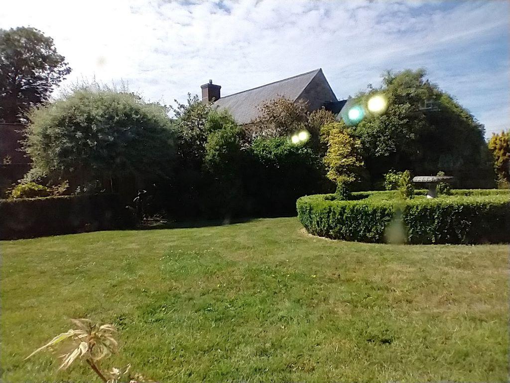

Radian Posted June 15, 2022 Posted June 15, 2022 Do you know the trick to see if the glass is coated? You shine a light (smartphone LED good for this) and look at the colour of reflections from each glass surface (four for double glazing, 6 for triple). The coated one will look a slightly different colour... This shows the coating is on the outer surface of the inner pane of my coated double glazing. 4 1
MikeSharp01 Posted June 15, 2022 Posted June 15, 2022 2 hours ago, Radian said: This shows the coating is on the outer surface of the inner pane of my coated double glazing. Great topiary!
Radian Posted June 15, 2022 Posted June 15, 2022 7 minutes ago, MikeSharp01 said: Great topiary! Why thanks! So earlier I was scratching my head over this coating thing... I know the coated surface reflects a different spectrum to the uncoated (hence the blue tint to the second reflection) BUT how come the next two out (uncoated) return the same untainted spectrum as the first? Actually the answer is right there in the word 'untainted'. It's not that the coating acts as a filter (like a toffee wrapper) but returns (i.e. reflects) a different spectrum. Obvious when you think about in terms of Quantum Electrodynamics 😁 Aw, if only Feynman was still with us 😔
