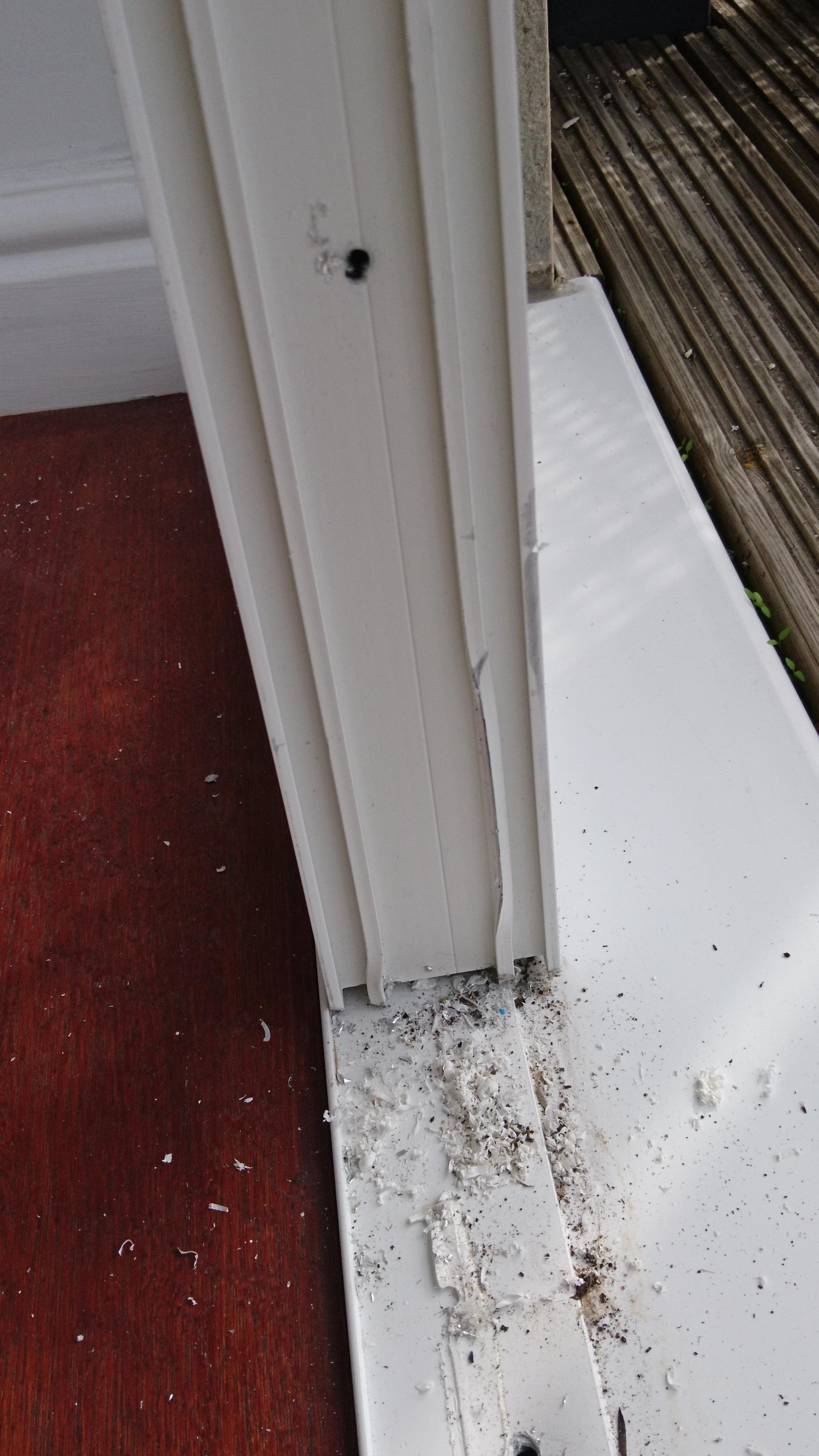

New home Posted September 22, 2022 Author Share Posted September 22, 2022 (edited) Unfortunately, this story is still going on… the fitters received the new doors (to replace the other “new” doors which had so many faults and were installed several weeks earlier), we set up a date and they came to fit them. On the day they removed the old ones. While doing so they damaged the side panels (only one photo is attached but the other side panel is damaged in the similar was as well). Next, they took the old doors away. After some time, they came back with the info that the new doors they had in the car were damaged and could not use it– as they said there was some plastic wrap and as they removed it now, it appeared the new doors were not good to be fitted. They brought the old ones back and installed them again on the damaged panels. They said they would order the new doors. I can not understand… The previous windows, doors were also damaged, at that time they also said “this is how we got it”… How come they did not check those ones properly at once when they received them? Plus when they removed the glass from side windows, in one frame, at the bottom, there were brown stains in the corners– photo attached – as if the rain water was coming through (it was not raining properly yet otherwise I think the stains might have been bigger?). I asked them if it means that the seal was not working properly? Still have not receive any answer… I do not know how long they will have to wait for the new windows (originally, 2 months back, they said 2 weeks and it stretched to over 2 months, now we have to wait agian). Anyway I told them if they have them within next couple of weeks that is ok, later, when it gets cold I will not let them in as having all windows removed for a couple of hours will freeze the house and I do not want to bear extra electricity cost for this, it has already caused me so much stress, plus not sure how dump, colder weather might affect the installation, seals drying up etc? Edited September 22, 2022 by New home extra info and quesions Link to comment Share on other sites More sharing options...

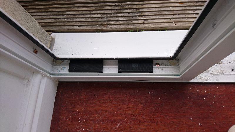

Carrerahill Posted September 23, 2022 Share Posted September 23, 2022 On 16/06/2022 at 10:25, gaz_moose said: jeeze what kind of customer are you checking the trades work with a spirit level.. the grey things are just plastic packing spacers used to stop the glass units sitting in the bottom of the frame/ for heel and toe'ing the glass unit. space around the frame. complain about the scratched handle and get them to just fit a new one. the rest is fine. What sort of attitude is that? Every customer should check trades work, the workmanship is clearly poor and the OP is right to question it. That is the sort of thing I would expect a disgruntled, careless, job price trade to come away with. So if I came to your house and put things up a bit squint you would not be upset? If the grey spacers were taken out I would want to know why, and investigate it further as it may have been the installer bodging them in and creating some wriggle room by letting the frame flex to get something to fit. Scratched fittings and fixtures and squint installs are not OK. 1 Link to comment Share on other sites More sharing options...

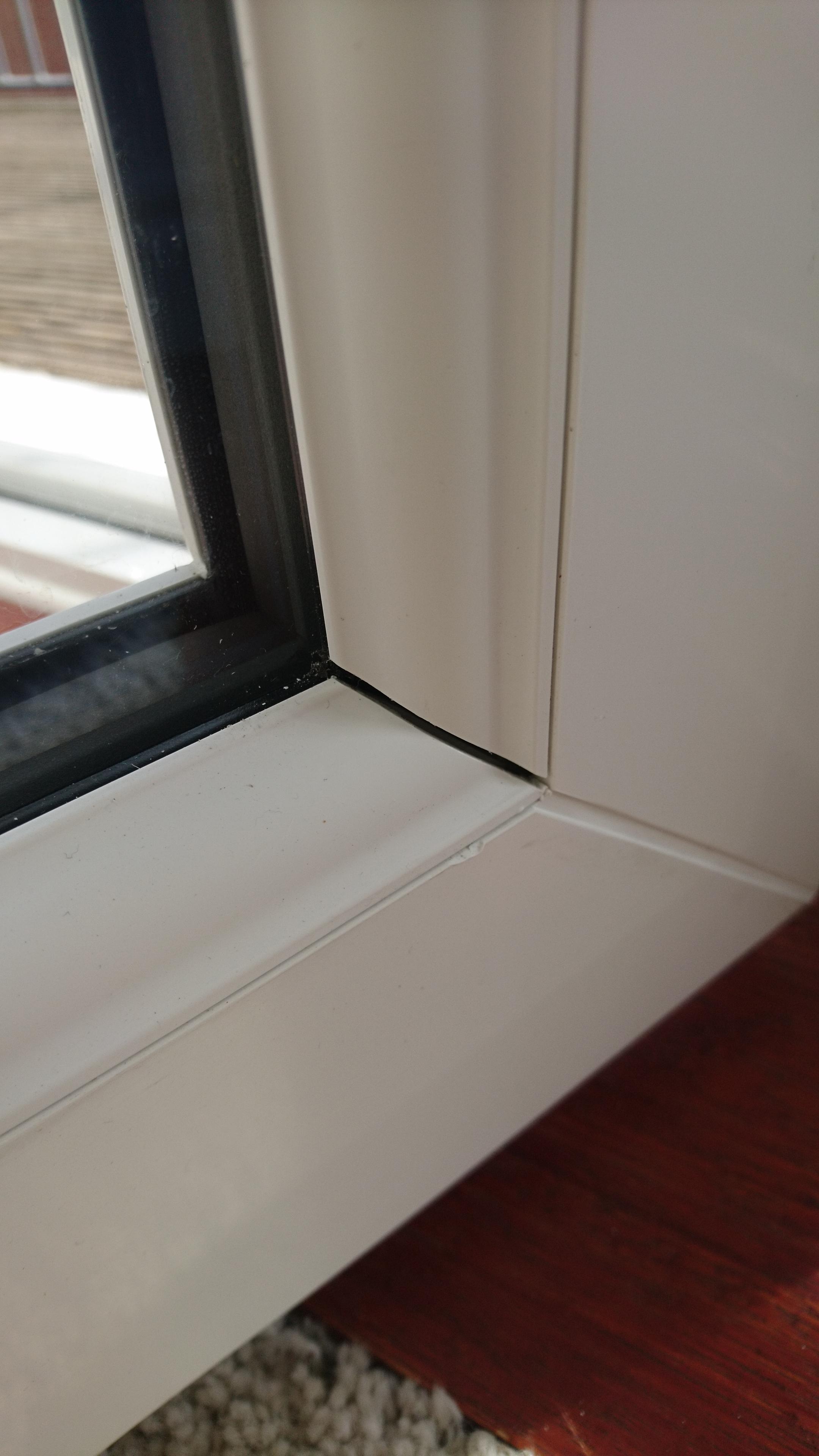

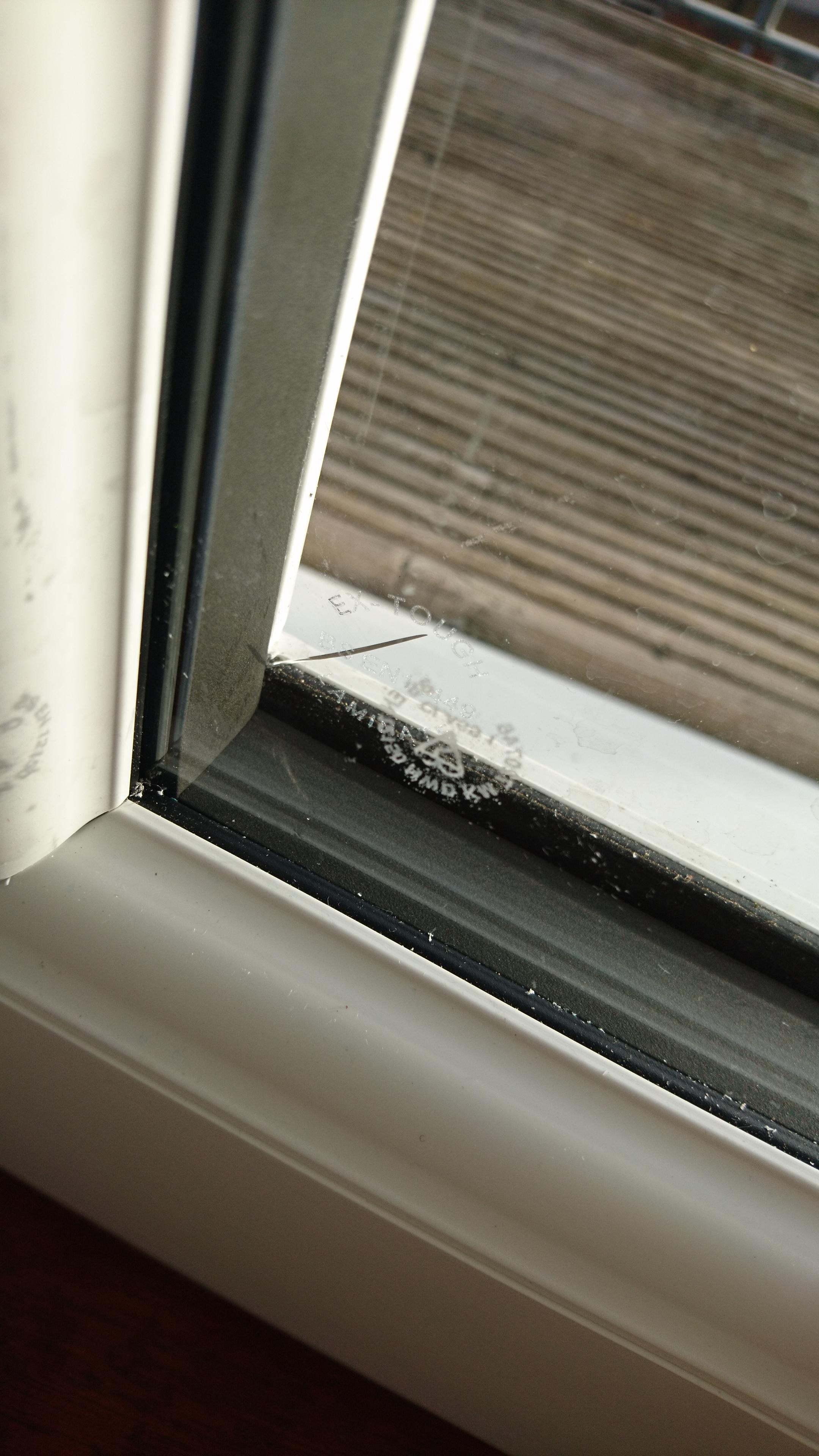

New home Posted October 6, 2022 Author Share Posted October 6, 2022 The fitters came and fix the new doors on Tuesday, it seems almost ok. Two questions: 1st: there are "breaks"/space/cracks in between the white thing ( I will call it tape) around the glass in the corners, in a couple of places (as per the photo number 1), this is only on the inside (= so inside the house). The outside corners have been sealed. Are those "breaks" ok on the inside part of the window, or should they be sealed as well or can they be left like this? The 2nd: only today I have notices a scratch on the glass, it is very small - about 2.5cm, this is double glazed window so it is on the outer glass, but somehow inside, so you can not feel it, you can only see it. Is it ok? Link to comment Share on other sites More sharing options...
craig Posted October 6, 2022 Share Posted October 6, 2022 It’s a glazing bead just poorly measured. More of a visual inconvenience than anything else. If need be, fill with white silicone and you’ll take the visual annoyance away (if they won’t fix). Glass, it’s a case of looking through the glass not at the glass. Is it visible from 3 metres away? If yes, ask for it to be replaced. If no, then ask but the answer is likely to be no. Link to comment Share on other sites More sharing options...
