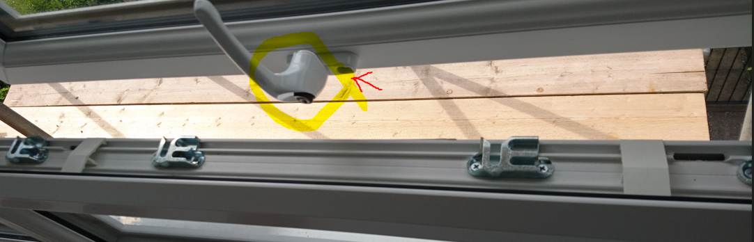

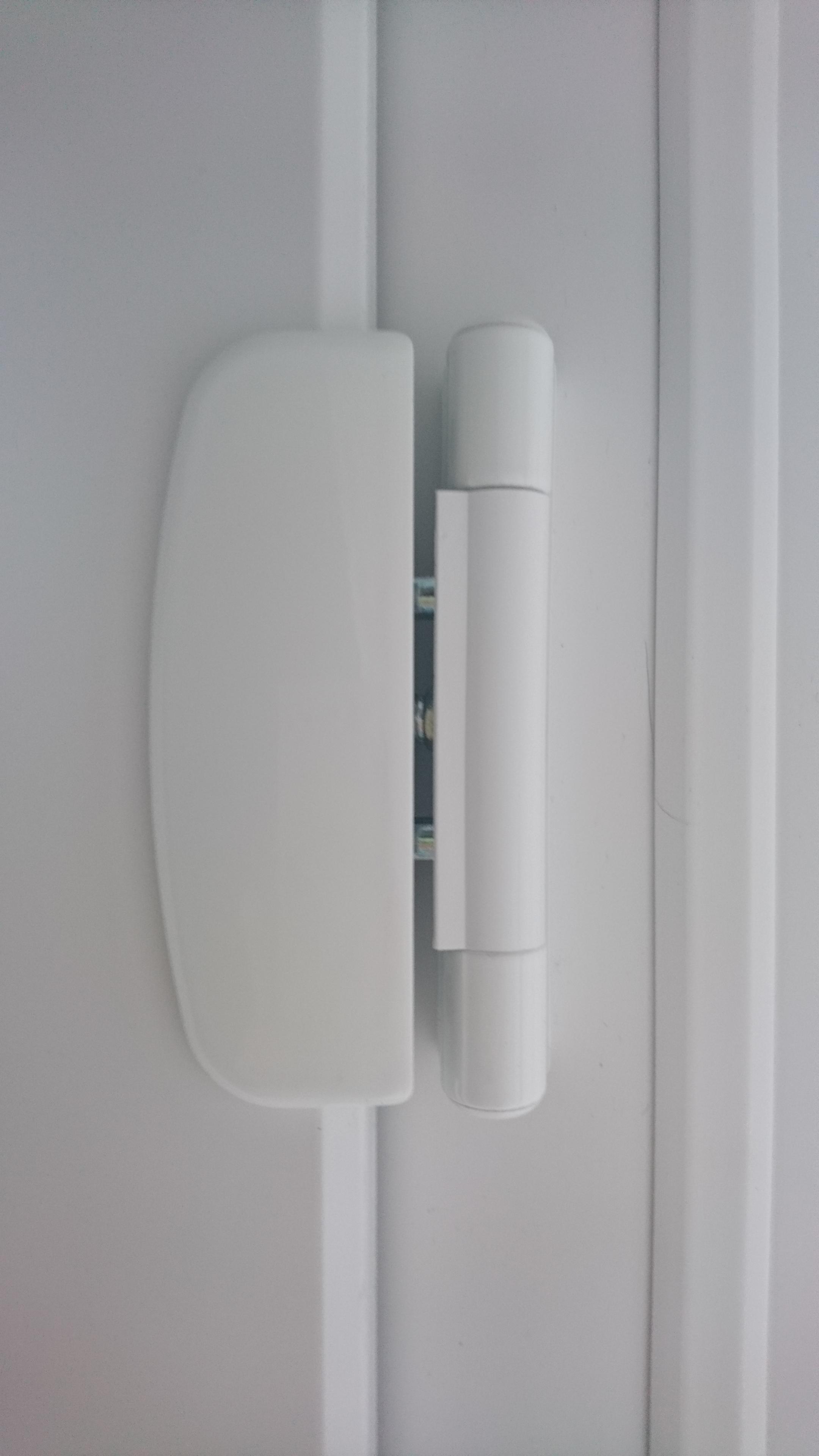

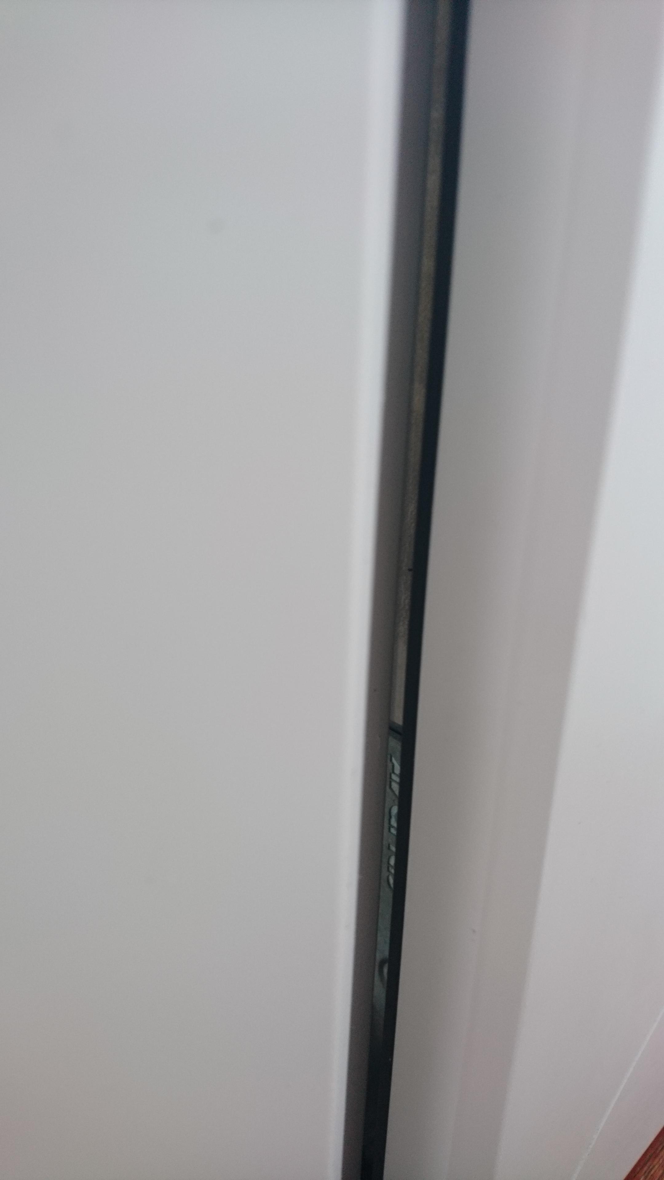

New home Posted June 15, 2022 Share Posted June 15, 2022 Hello, we had new windows installed also the frames were removed - everything was replaced. Questions: 1. is it ok if the new window is scratched (from somewhere beginning in/behind the frame, the scratch is about 12cm long across and goes up a bit, the window is about 32cm wide. The scratch faces the room, so when I am in the room I can feel it when I "run my nail through it. 2. The door handles are also scratched, is it normal? 3. On the first photo there are the hinges from the garden doors on the right side (you can see the screws/connections - they had to be stretched as the fitter said "the doors have to fit". Is this kind of "stretch" normal? On the left part of the garden doors the screws are not visible at all. 4. Plus this right side of the garden doors seems a bit hard to close - you have to push it a bit more. The other side is ok. To close either side of those garden doors you can "just ordinary close them" with the handle or the other option is to lift the handle up to close them properly. When I just "ordinary" close the right part (where those hinges are so visible and extended, plus this is the part which in general is stiff to close) there is a space at the bottom or they do not close tightly at the bottom (and you can feel the air coming through there). You can see in the photo below that there is a space. The upper part of those right garden doors is tight and there is no such a space. I do not think this is ok, is it? Are all of those things I have listed normal or should they all be replaced or corrected? Apologies I have never had windows fitted before so not sure what the standards are and what is normal, acceptable and what is not. Trying to gather as much feedback as possible as the fitters are coming tomorrow to have a look at those windows. Link to comment Share on other sites More sharing options...
Marvin Posted June 15, 2022 Share Posted June 15, 2022 Hi @New home Trying to reply as reasonably as possible.... If the glass has a scratch on it that you can feel with your finger nail then it is damaged and need replacing. The same really with the door handles. The screws can show but it sounds as if the doors have not been adjusted correctly. All in all it sounds like not enough care with the materials and the installation. It may be that the frame is not in the right position or the wrong size. It may not. if there is a gap at the bottom of the door then the rain will come in - so no, no good at all. I would not accept these problems. Best M Link to comment Share on other sites More sharing options...
New home Posted June 15, 2022 Author Share Posted June 15, 2022 Thank you for your feedback. Link to comment Share on other sites More sharing options...
PeterW Posted June 15, 2022 Share Posted June 15, 2022 Doors haven’t been adjusted correctly. If this is a pair of French doors then you adjust equally to bring them together, not from one side. The gap you are seeing is because the cams in the opening door are not engaging in the frame at the bottom - it means the door isn’t parallel to the frame, and/or the door isn’t parallel to the other door. All of the above is a 15 min fix for a decent fitter who should re-adjust the doors and they will be fine. You do sometimes find they will bind when warm but that’s because the doors expand in the heat. A scratched unit (especially one beyond a seal) needs replacing. Link to comment Share on other sites More sharing options...

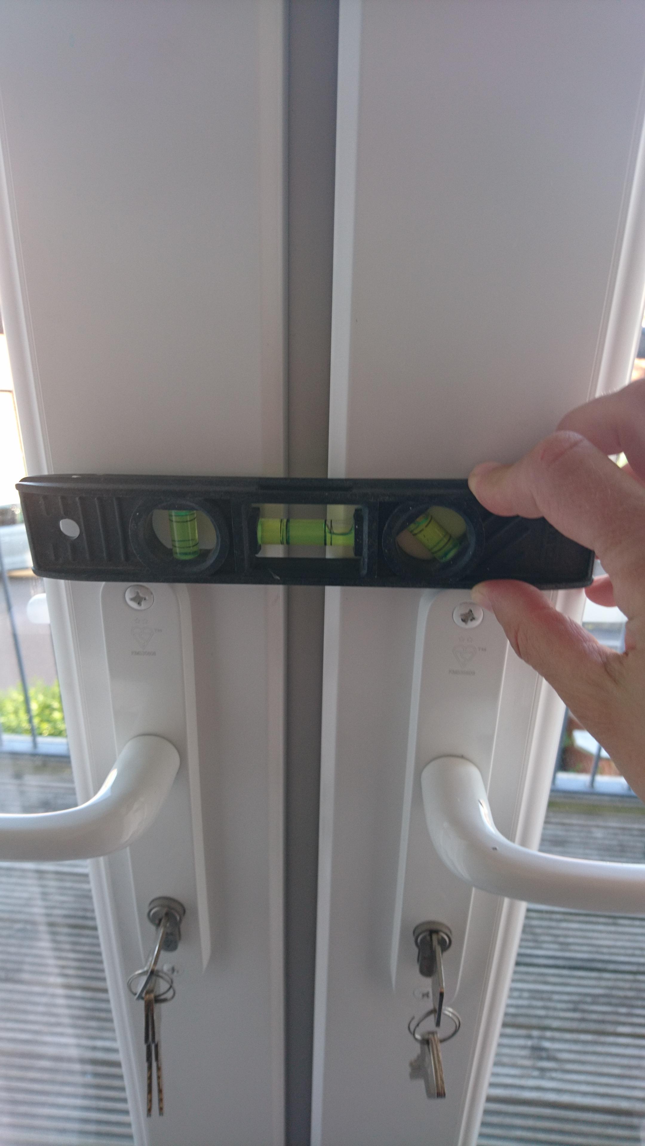

New home Posted June 15, 2022 Author Share Posted June 15, 2022 One more photo: when I use level it shows as the fittings for the door handles are not even, is it ok/normal? Link to comment Share on other sites More sharing options...

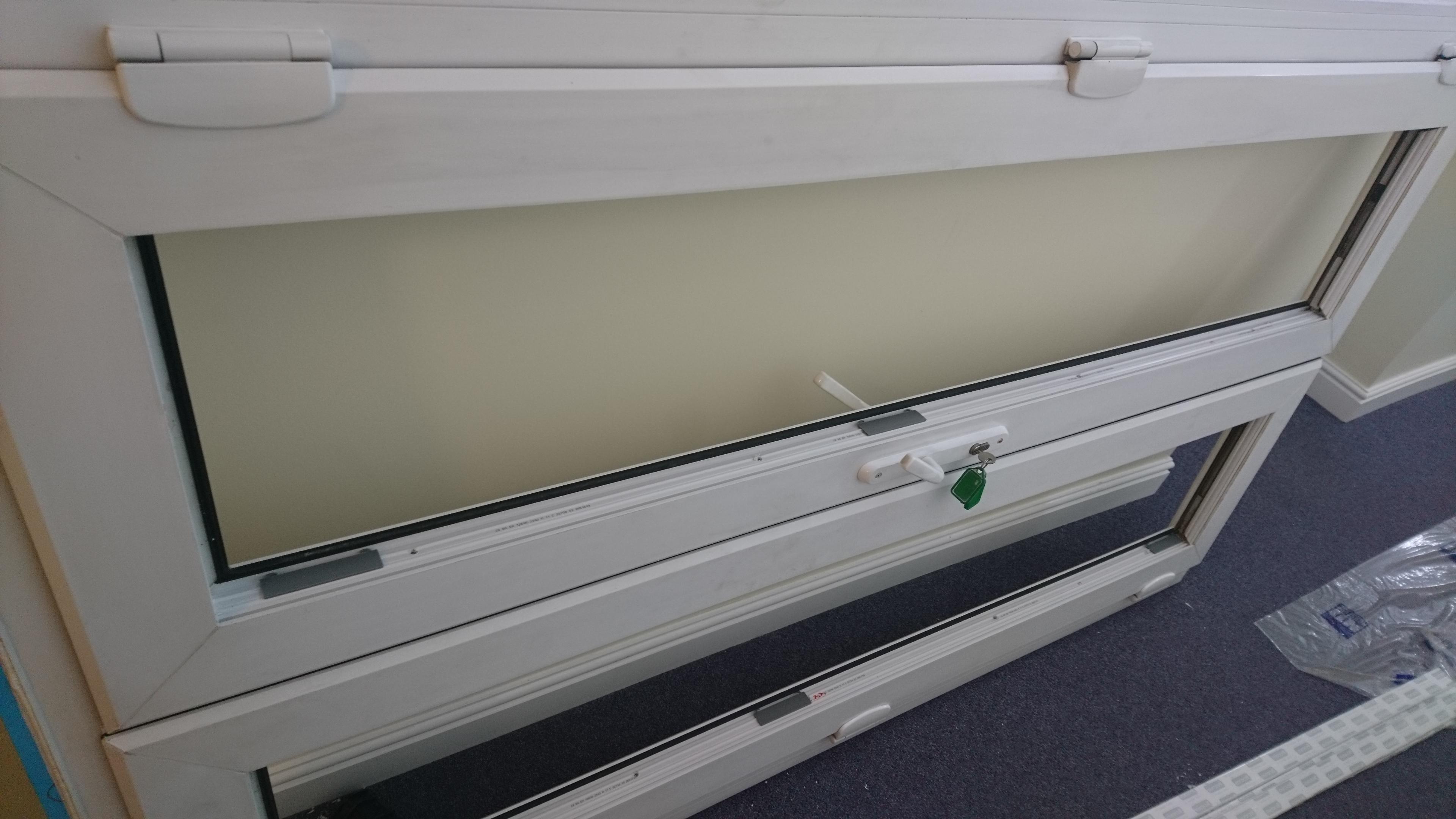

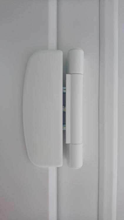

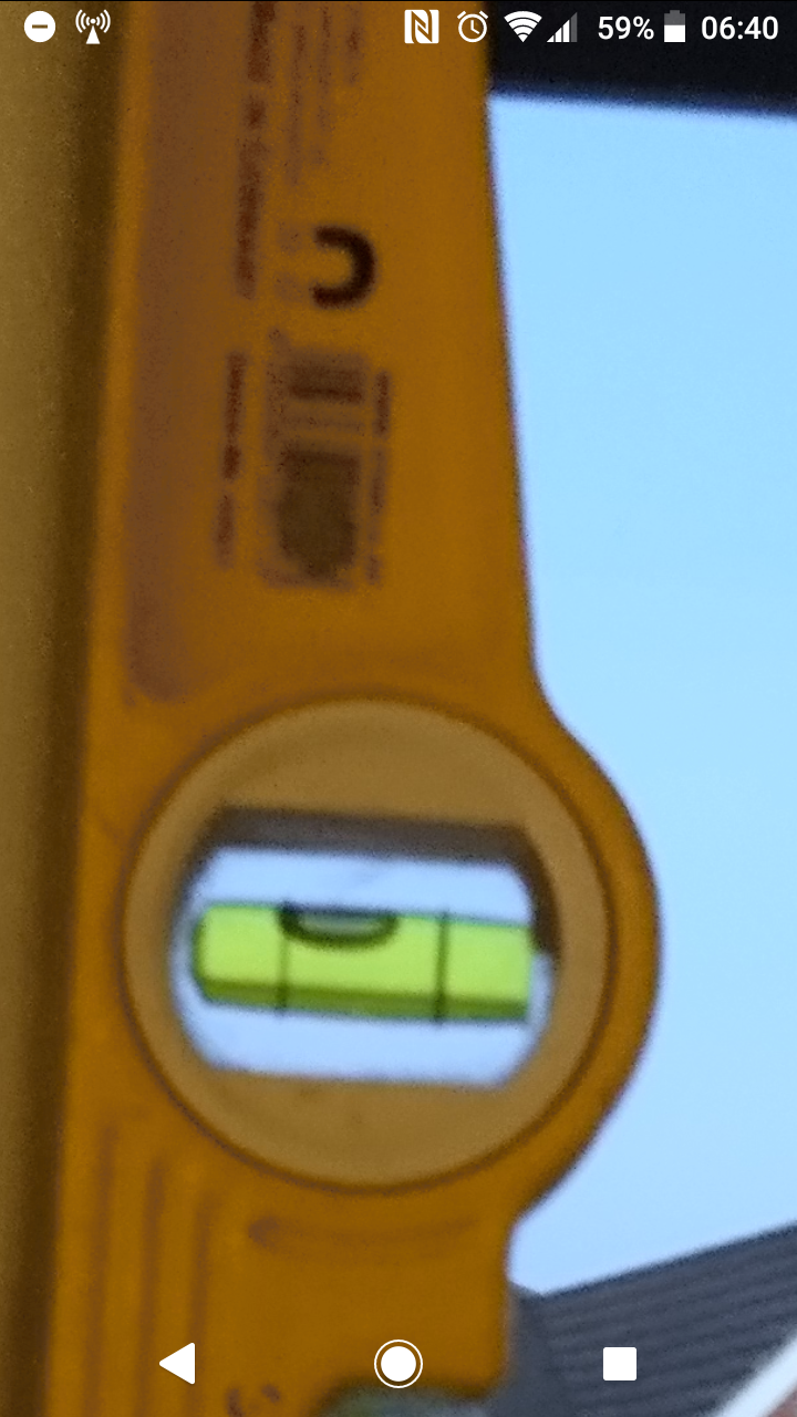

New home Posted June 16, 2022 Author Share Posted June 16, 2022 Two more questions, if two dark/grey pads (like on the photo 1 here in the old frame) are removed from one side of the side window panel (which is not ever going to be opened, like on the photo 2) to the balcony doors is it ok or not? And if the level looks like on photo 3 in one place is it ok? Should the level be used when fitting windows? Link to comment Share on other sites More sharing options...
dpmiller Posted June 16, 2022 Share Posted June 16, 2022 (edited) if it's not a stoopid question, why were these windows and doors replaced? Edited June 16, 2022 by dpmiller Link to comment Share on other sites More sharing options...
New home Posted June 16, 2022 Author Share Posted June 16, 2022 Because some other people living here in those apartments, houses complained about the windows which they had (they about 12 years old). Mine were fine, but the Housing Association has decided to replace all the windows for everybody at once. Link to comment Share on other sites More sharing options...
gaz_moose Posted June 16, 2022 Share Posted June 16, 2022 jeeze what kind of customer are you checking the trades work with a spirit level.. the grey things are just plastic packing spacers used to stop the glass units sitting in the bottom of the frame/ for heel and toe'ing the glass unit. space around the frame. complain about the scratched handle and get them to just fit a new one. the rest is fine. Link to comment Share on other sites More sharing options...
craig Posted June 16, 2022 Share Posted June 16, 2022 (edited) Simple adjustments will resolve all of these issues. 5 hours ago, gaz_moose said: jeeze what kind of customer are you checking the trades work with a spirit level.. One that can see the difference in handle heights and that it doesn't look right, without having the knowledge or understanding of how things should be but looking for help. So they are not making themselves look stupid when they ask the question upon their return. 8 hours ago, New home said: two dark/grey pads (like on the photo 1 here in the old frame) are removed from one side of the side window panel Glazing packers should be used to around the glass unit to toe and heel as has been mentioned then spaced out around the glass unit. Not doing so, causes potential issues further down the line. As for your door sitting proud, this is simply adjustment and the door is not sitting correct, the cams are not engaging into the keeps, which forces the door out as you see. Once this is fixed (easy fix), the issue will be gone. Edited June 16, 2022 by craig 1 Link to comment Share on other sites More sharing options...
