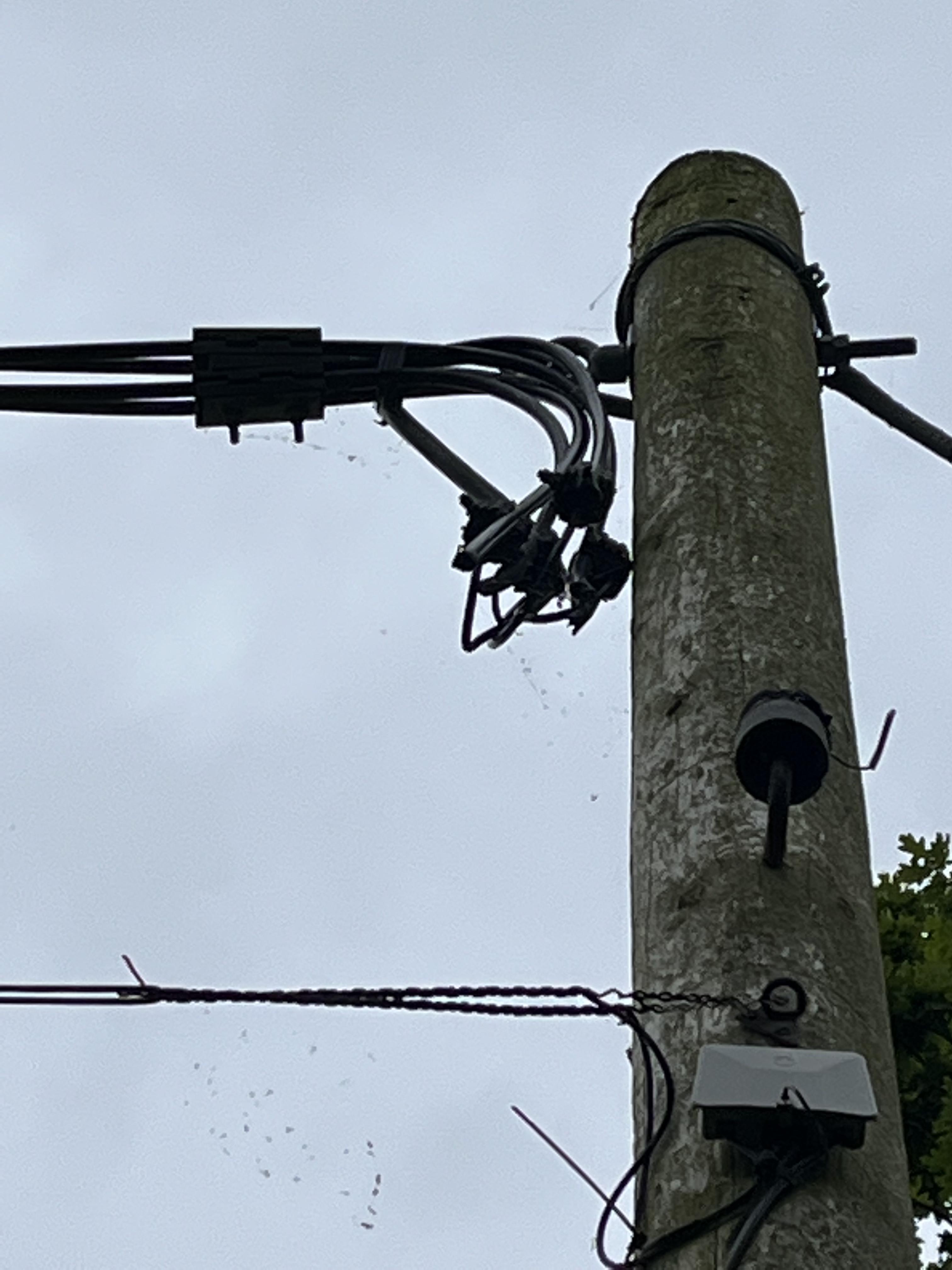

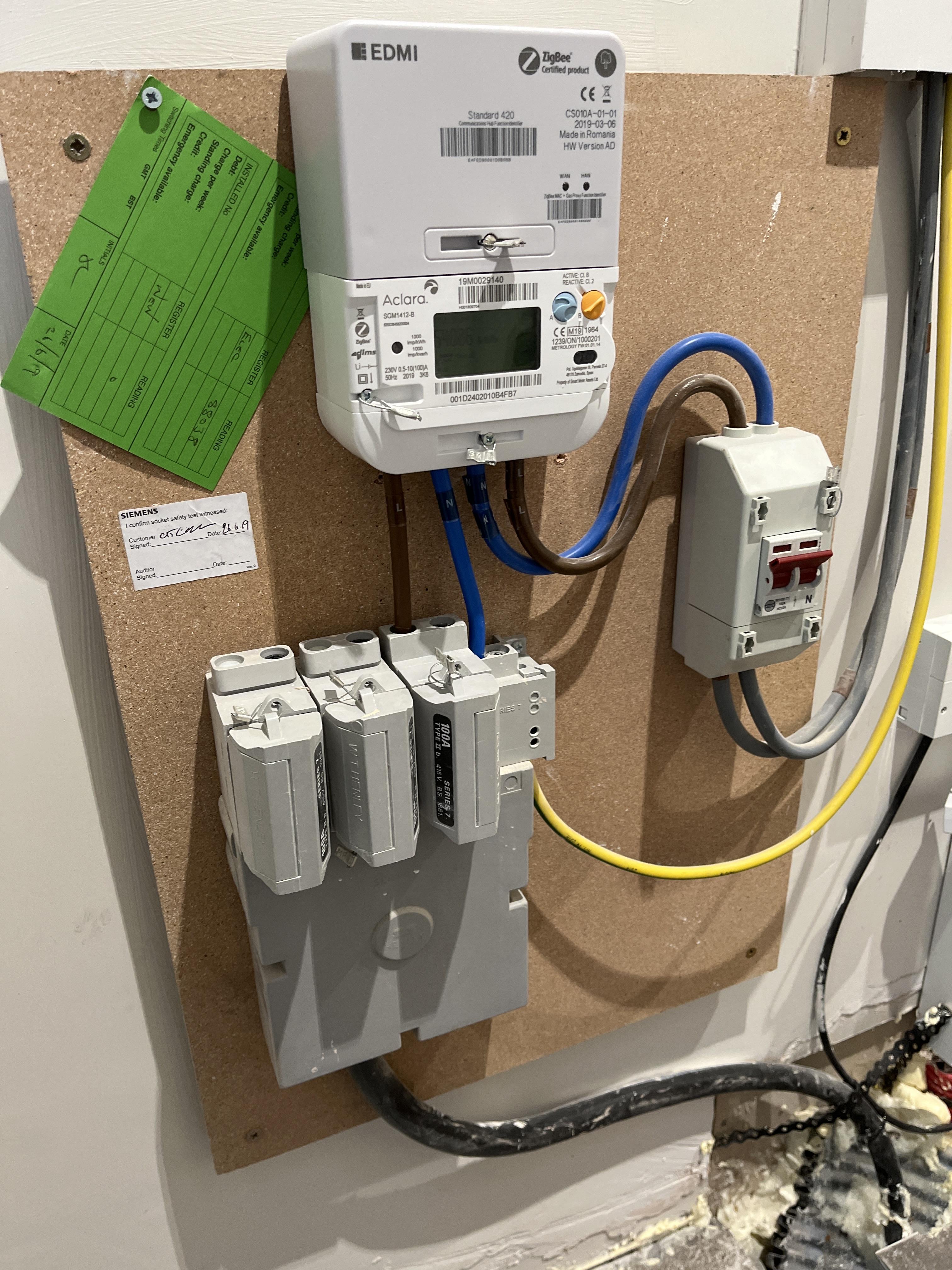

8Coops8 Posted June 13, 2022 Share Posted June 13, 2022 Looking for some advice. I currently have single phase electricity supplying my refurbished home but am now looking to install a GSHP to replace my old oil boiler and also a car charging point. My electricity supply is already pretty much maxed out and I require more power. It appears that I already have 2 single phase cables entering my home but only 1 live cable enters 1 of 3 100Amp fuses and then goes into my electricity meter, so presume 2nd single phase supply was never connected. The electricity pole supplying my house has 2 pairs of black cables (4 cables total). I contacted Northern power and received the following "A load of 35.00 kVA may be connected providing the load is split and balanced over the two phases available and your connected load does not exceed 80A per phase at any time. The connection is a low voltage 230/460V alternating current 50Hz supply. The present earthing arrangements will be maintained. If your metering requires upgrading or you require additional meters fitting, your supplier is responsible for carrying out this work." I then contacted EON and they don't know don't seen to understand my meter requirement and keep asking if I want a single phase meter or a 3 phase meter as there is no such thing as a 2 phase meter...? Anyone any idea what I would require? Thanks Link to comment Share on other sites More sharing options...

8Coops8 Posted June 13, 2022 Author Share Posted June 13, 2022 I think the 2nd single phase powered an outdoor swimming pool until it was removed about 40 years ago. The 3 fuses were installed about 7 years ago when i relocated the incoming power supply. Would like to put both single phases into a 3 phase meter ideally to save the additional standing charge, but can you do this..? Link to comment Share on other sites More sharing options...
ProDave Posted June 13, 2022 Share Posted June 13, 2022 Split phase is uncommon now, it is essentially a single phase supply, but derived from a centre tapped 460V transformer. You have a 3 phase supply head with 3 fuses as that is standard equipment, one will be unused. How do you know if the second feed is not live? You would have to break the seal on the fuse to determine that? Or is it connected to something? A picture of what you have might be interesting. As far as your supplier is concerned, get a 3 phase meter. The may or not connect the "3rd phase" but they might? It won't do anything. A 3 phase meter will ensure you only have one MPAN and only pay one standing charge. Because it is so unusual, all I can suggest is you ask your supplier for a 3 phase meter and see what the meter man says when he turns up. Have a second single phase CU raeady to connect it to. Link to comment Share on other sites More sharing options...
8Coops8 Posted June 13, 2022 Author Share Posted June 13, 2022 Link to comment Share on other sites More sharing options...

Wil Posted June 14, 2022 Share Posted June 14, 2022 Aren’t the 4 cables on the pole L1,2,3 and N? Can’t you just ask your DNO for a 3phase upgrade unless the other phases are used for something else. If two of those black wires enter your property, Shirley this is L and N? Have DNO confirmed only 2 phases available? You only have L&N on your internal photo unless other phases are terminated in the fuse box chamber? Link to comment Share on other sites More sharing options...
8Coops8 Posted June 14, 2022 Author Share Posted June 14, 2022 DNO say 2 phases available inside my property and i can see 4 wires combine at pole and go underground and into my house, but currently only 1L and 1N is connected to the fuses and meter. So assuming 2L and 2N. I wonder if historically there were 2 meters fed from the 2 single phases. Link to comment Share on other sites More sharing options...
