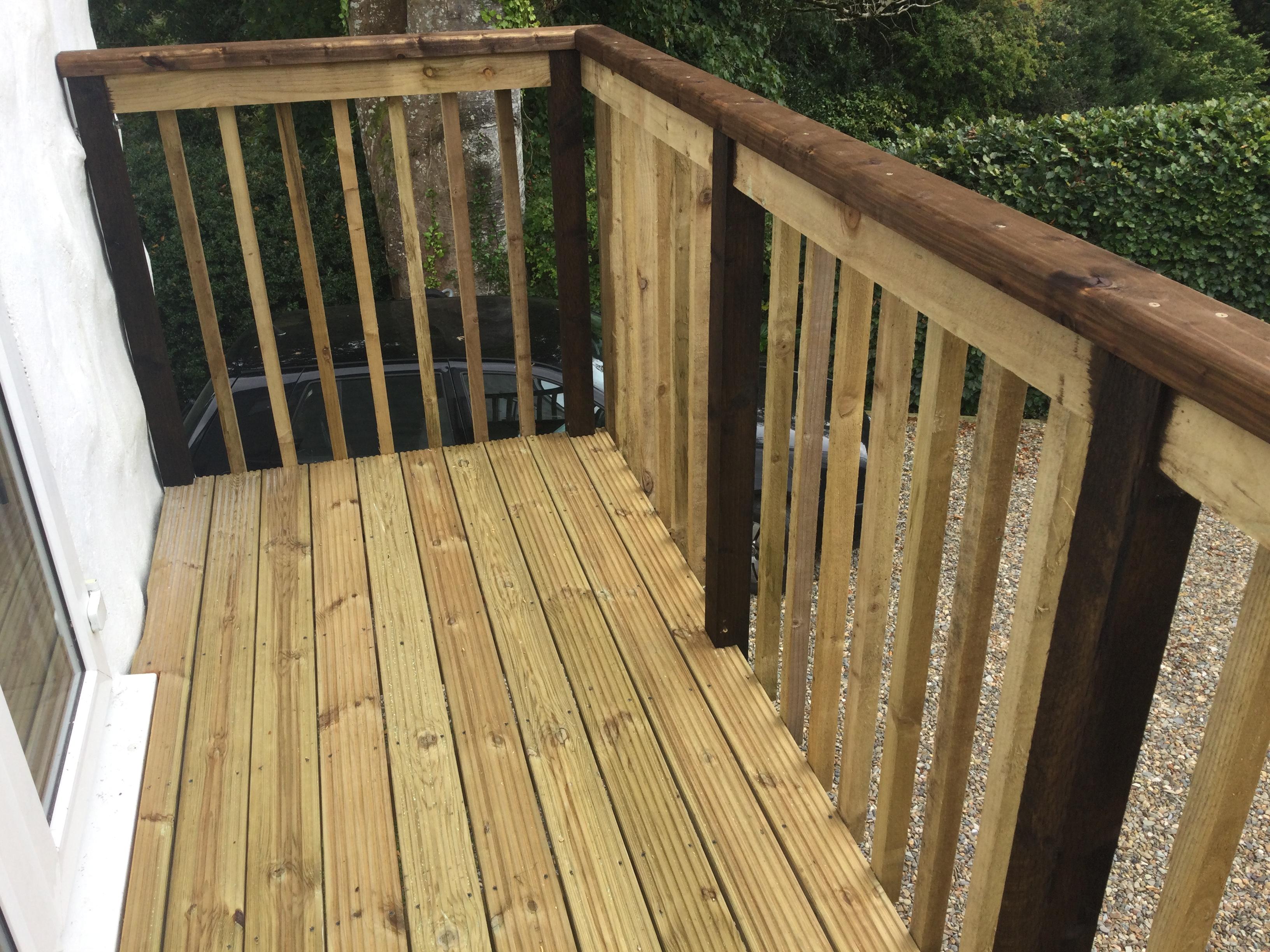

zoothorn Posted September 20, 2022 Author Share Posted September 20, 2022 11 hours ago, PeterW said: Why..?? Assuming it’s planed..? Round over bit on the edges and it will look fine . Ah ok. Yes it's planed.. right then can do. But does that expose the timber by nipping off the tannalise ? Is the chamfer of r'over idea go with treating it all again? ( only got bartoline dark brown). Link to comment Share on other sites More sharing options...
PeterW Posted September 20, 2022 Share Posted September 20, 2022 1 hour ago, zoothorn said: Ah ok. Yes it's planed.. right then can do. But does that expose the timber by nipping off the tannalise ? Is the chamfer of r'over idea go with treating it all again? ( only got bartoline dark brown). Should be pressure treated so will have penetrated to a point but using the Bartoline will mean it’s properly treated Link to comment Share on other sites More sharing options...

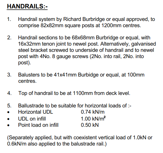

JohnMo Posted September 20, 2022 Share Posted September 20, 2022 Our balastrade designed for similar fall to your balcony, the structural engineer said I had to comply with this. Link to comment Share on other sites More sharing options...
zoothorn Posted September 20, 2022 Author Share Posted September 20, 2022 2 hours ago, JohnMo said: Our balastrade designed for similar fall to your balcony, the structural engineer said I had to comply with this. My BCO just said to me, when visited here in june 'do 95mm between spindles, & 1100mm to handrail'. zh 1 Link to comment Share on other sites More sharing options...

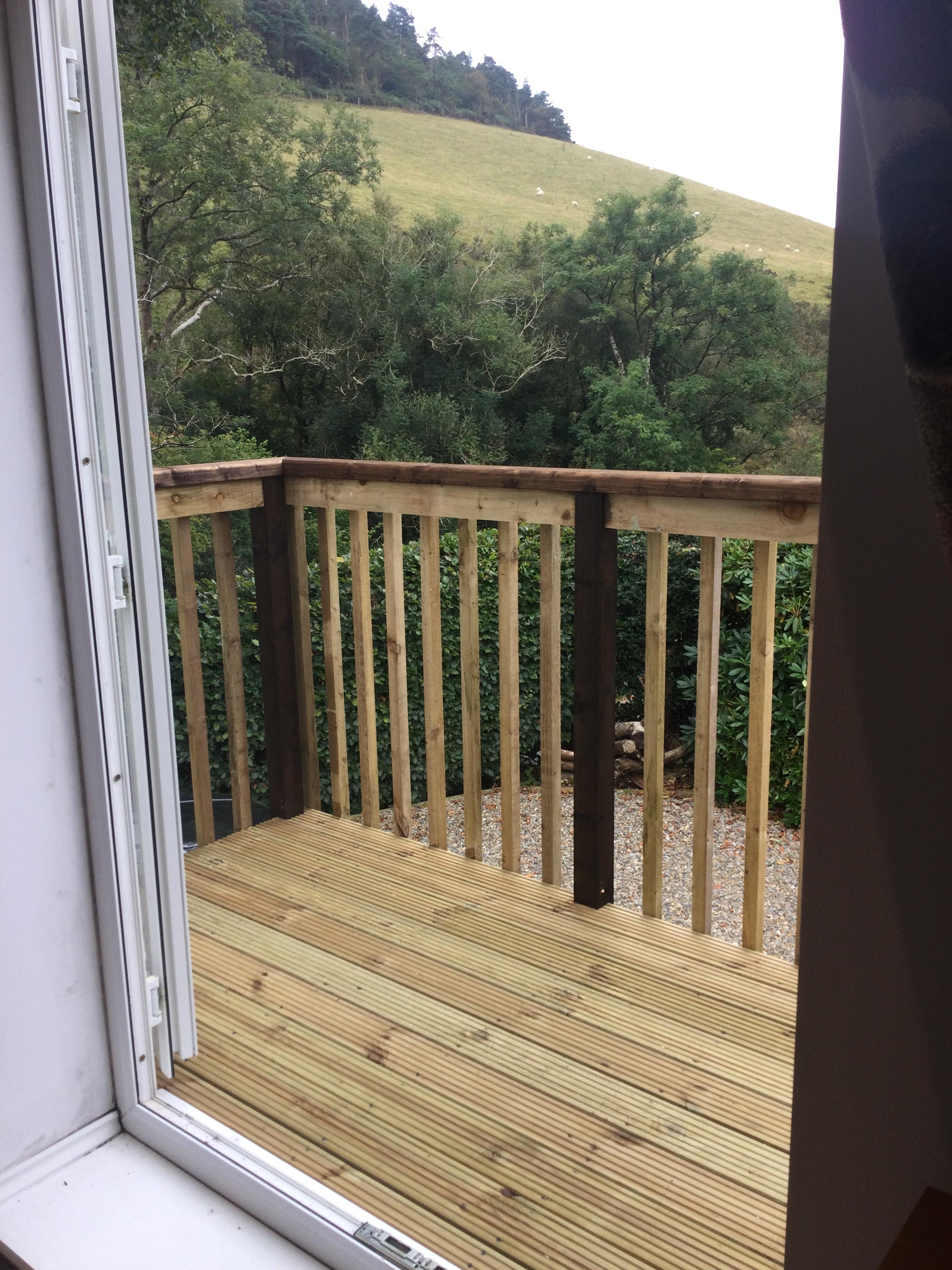

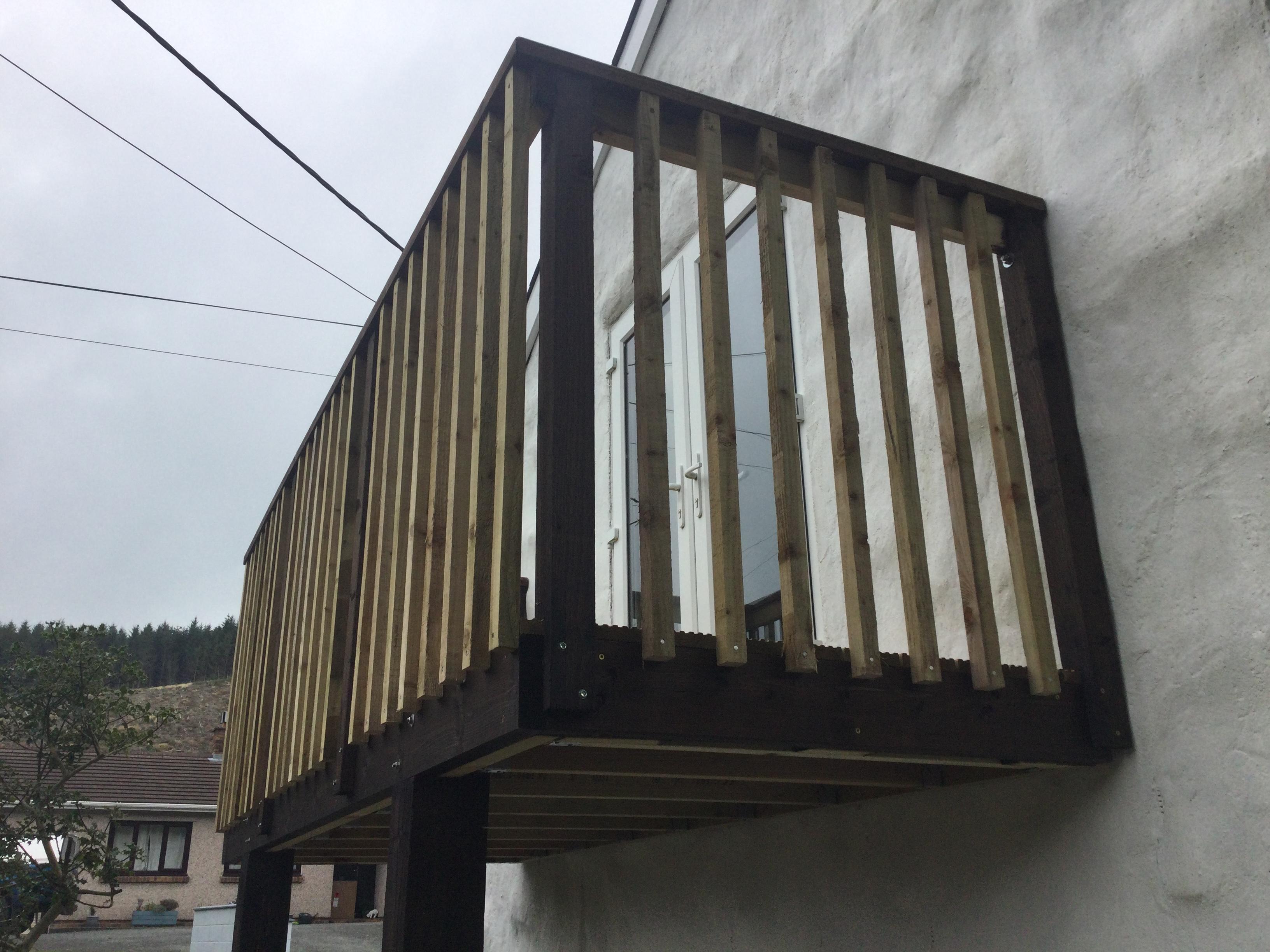

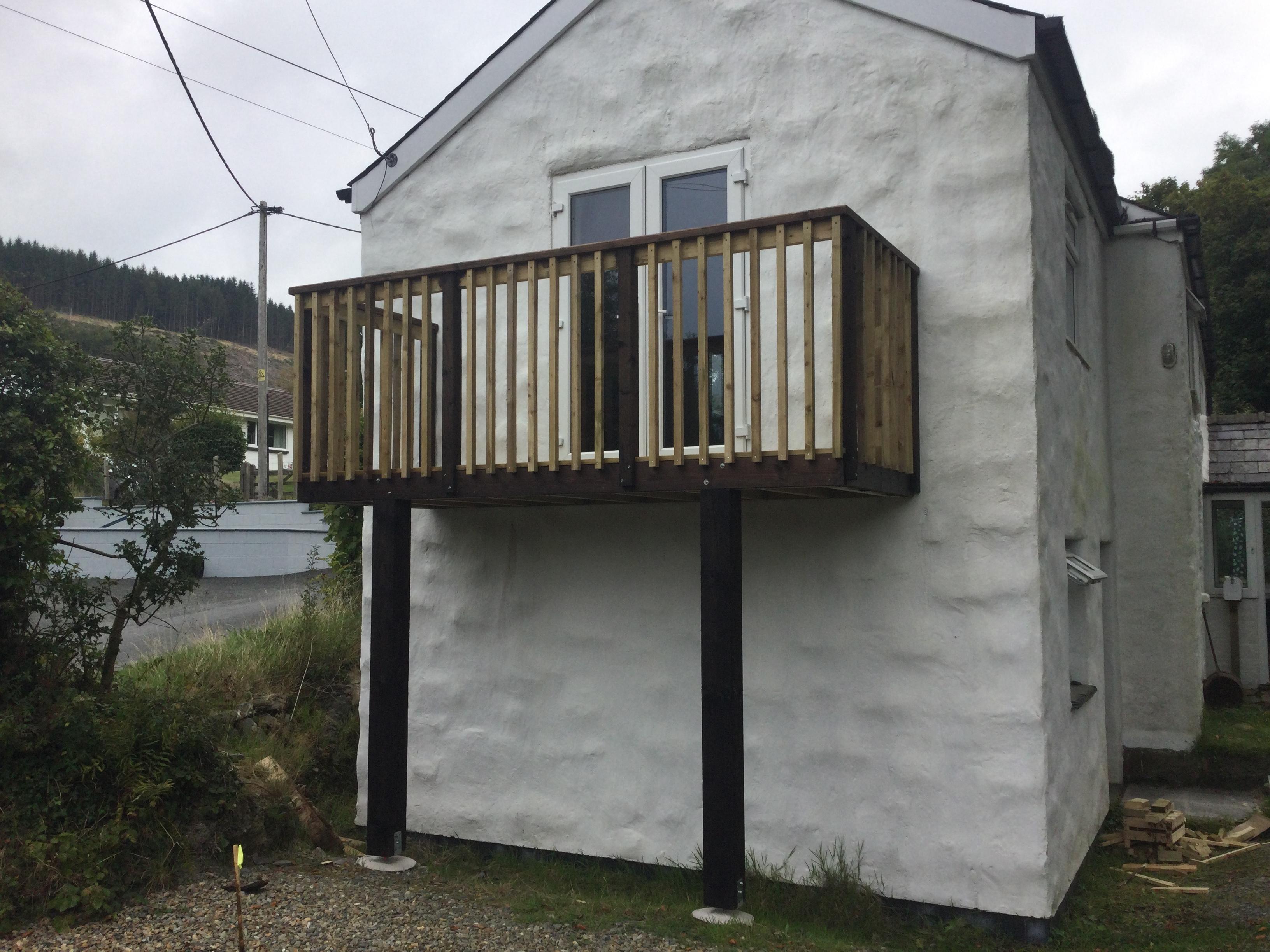

zoothorn Posted September 22, 2022 Author Share Posted September 22, 2022 Finished! Will do 2nd coat on the ( roundover edged) handrail in next dry spell.. just got 1 on & mostly dry before rain coming midday. Huge thanks y'all especially Onoff for the metal bits & help with the design, & nozzles from GW. Very kind indeed chaps. Now to get the build signed off. Woohoo! Zoot. 3 Link to comment Share on other sites More sharing options...
