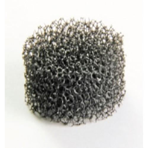

Temp Posted May 31, 2022 Posted May 31, 2022 How do people stop fine filters getting blocked quickly? We live in a rural area but half a mile from a busy dual carriage way. Our MVHR system has a very coarse filter that really only stops insects - but even that gets blocked in 2-3 months. By coarse I mean something like this..
markocosic Posted June 1, 2022 Posted June 1, 2022 Use a separate filter box on the inlet then pick your own filters https://www.ductstore.co.uk/acatalog/Panel-Filters.html 1
