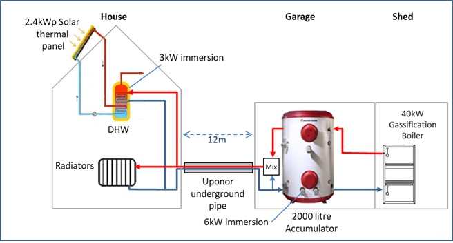

Nickfromwales Posted May 27, 2022 Posted May 27, 2022 2 hours ago, apesort said: In the winter we could then avoid using grid electricity for the ASHP during the morning and evening peak. I take it you mean avoiding using peak rate grid electricity for these events, AKA “load-shifting”? I’m a big fan of the idea of utilising the ‘huge’ ( 1000 - 2000L ) TS btw I fitted a 2600L TS for one client, to take the brunt of what his log gasification boiler had to offer in a very short period of time. So also ‘load-shifting’ at its best. 2 hours ago, apesort said: and possibly also during the winter PV generating hours What is the size of the ‘decent’ array you have? Solar PV drops to between 25% and 0% in winter, so a 10kWp array in the winter becomes a 0-2.5kWp array ( with the 2.5 being what you’d get on a bright winters day, which we don’t get very many of in good ol’ Blighty )

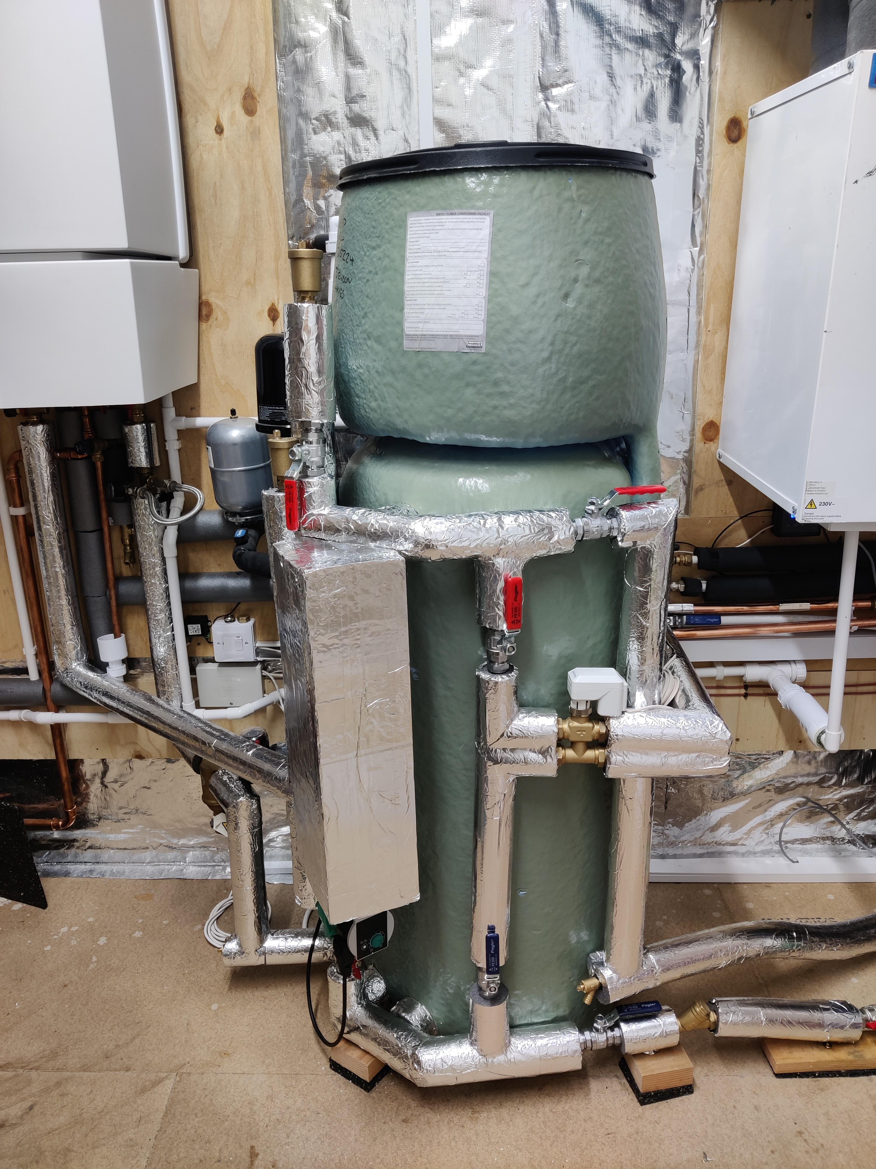

joe90 Posted May 28, 2022 Posted May 28, 2022 22 minutes ago, ProDave said: You don't want to be filling your 1000L thermal store with antifreeze so you need the break of either a heat exchanger or input coil to separate the outside ASHP circuit from the inside store / heating circuit. However you need to make sure a coil will cope, mine didn’t and had to convert it to non coil 🤔 1
JohnMo Posted May 28, 2022 Posted May 28, 2022 I using a 160l thermal store as a buffer, standard coil rubbish when using low temperature flows. I have just added a large 40 plate heat exchanger as well as the coil. 1
SteamyTea Posted May 28, 2022 Posted May 28, 2022 1 hour ago, JohnMo said: have just added a large 40 plate heat exchanger as well as the coil. What power is it at the temperatures you are using?
JohnMo Posted May 28, 2022 Posted May 28, 2022 PHE Sized for. Primary side 6kW input at 27 degrees supply 22 degrees return. There is an additional return temp drop as flow goes through primary coil on its way to the boiler of about a degree. Secondary side 25 supply and 21 return. So an approach temp of 2 degrees. Using PHE (Hexonic LA34) with a size of 471x81mm plates x40.
joth Posted May 28, 2022 Posted May 28, 2022 6 hours ago, JohnMo said: PHE Sized for. Primary side 6kW input at 27 degrees supply 22 degrees return. There is an additional return temp drop as flow goes through primary coil on its way to the boiler of about a degree. Secondary side 25 supply and 21 return. So an approach temp of 2 degrees. Using PHE (Hexonic LA34) with a size of 471x81mm plates x40. Interesting. I'm about to add 150L buffer tank to my system which will need about £150 of additional glycol. Alternatively I could get a PHE and a pump for about the same amount. But then it's an additional 40W running an extra pump whenever I need to charge or discharge the buffer. Unless I make some more major (and unusual) schematic changes. Hmmmm. Where does one buy Hedonic gear? I see lots of Nordic Tec PHE (along with made to measure insulation boxes) on the eBay
JohnMo Posted May 28, 2022 Posted May 28, 2022 I bought this from eBay. Which is the same as mentioned above, even comes with insulation. Item number 304182801695. This is it installed but used PIR insulation.

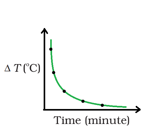

SteamyTea Posted May 29, 2022 Posted May 29, 2022 32 minutes ago, apesort said: Rather than say let the store run down to close to 21°C or whatever room temperature is ? As the temperatures reach parity, power is reduced in a non linear manner. So you need a temperature difference to reduce the time it takes to heat. Look up Newton's Law of Cooling (it works for heating as well).
