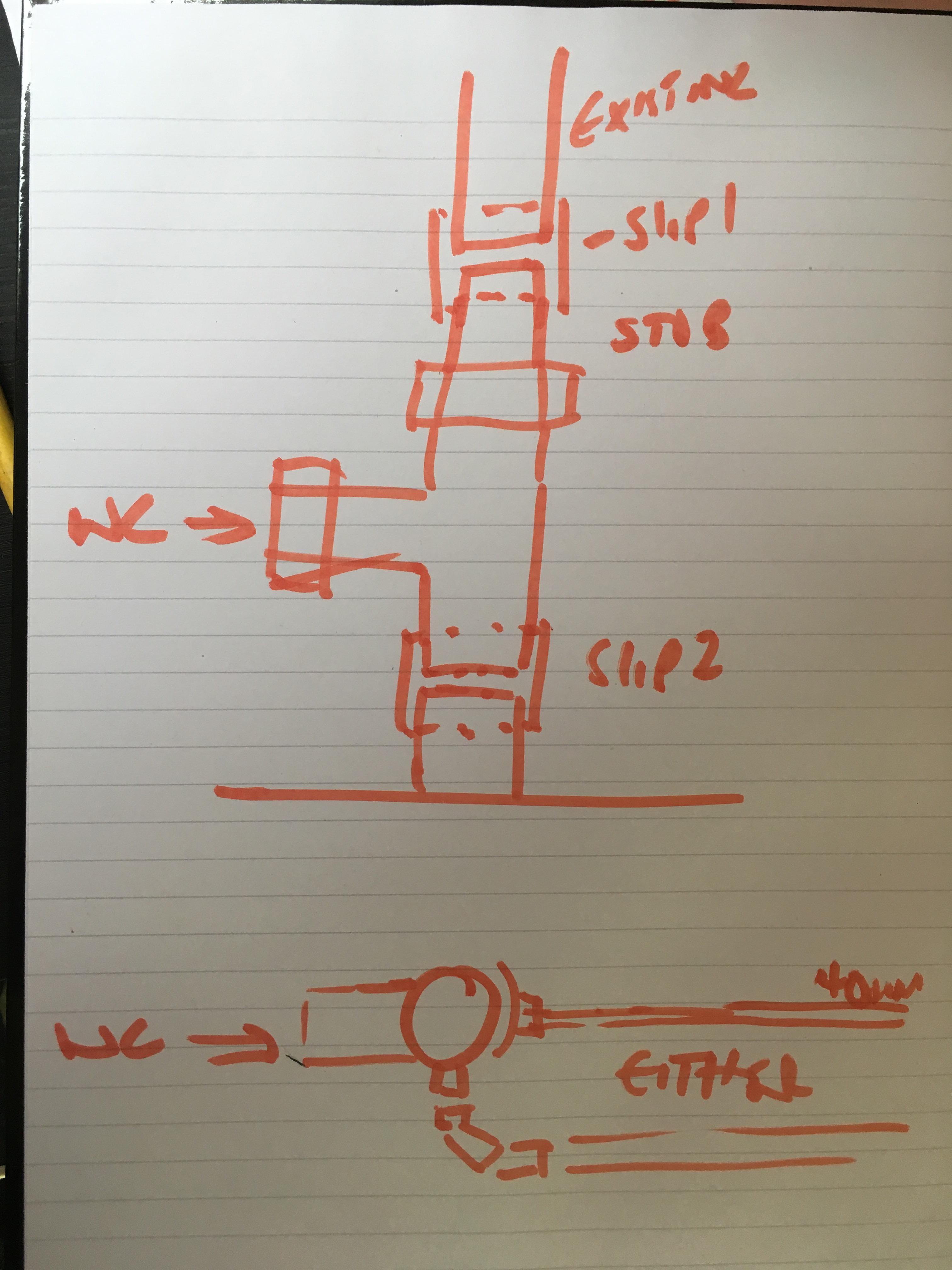

PeterW Posted May 23, 2017 Share Posted May 23, 2017 As @ProDave says, it's one you need space for to work so make it easy for yourself. Two slip couplings will make it easier, either use a strap boss above the branch to get the wastes in or go into the side boss but make the turn with two 45 degree bends Link to comment Share on other sites More sharing options...
8ball Posted May 24, 2017 Author Share Posted May 24, 2017 On 23/05/2017 at 09:51, PeterW said: As @ProDave says, it's one you need space for to work so make it easy for yourself. Two slip couplings will make it easier, either use a strap boss above the branch to get the wastes in or go into the side boss but make the turn with two 45 degree bends Thanks for the info Peter, the toilet I am buying/chosen has a 180mm height exit as in pic below, I think the new branch will be to high if I use 2 slip couplings as in your drawing. Hmmm Link to comment Share on other sites More sharing options...
Barney12 Posted May 24, 2017 Share Posted May 24, 2017 I wouldn't use two personally. Just give yourself enough clearance at the top to drop the triple over the existing pipe. That's exactly what I did. Link to comment Share on other sites More sharing options...

Nickfromwales Posted May 24, 2017 Share Posted May 24, 2017 180mm / 7" outlet centre is standard Id go for the 3 socket branch TBH. Link ? Link to comment Share on other sites More sharing options...
