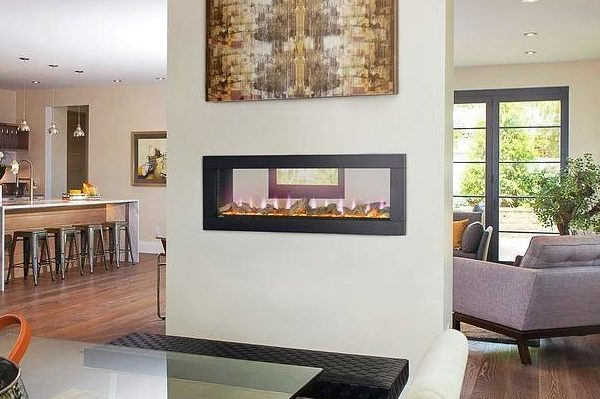

joth Posted May 26, 2022 Share Posted May 26, 2022 35 minutes ago, Andehh said: If it's an consolation we have spent so much extra on insulation it will likely be rarely used, but it is am ambiance we want to ensure we have the option of. Have you considered bioethanol fireplace in a wood-burner style cabinet? They're pretty good for creating the ambiance, and If you have very high levels of insulation you might find the real wood burner to hot to ever use. bioethanol is much easier to temper the heat output of so you might actually use it more. And has many additional benefits (minimal particulate pollution, no penetrations in the airtight envelope, potentially easier to source and store the fuel, depending on situation) Link to comment Share on other sites More sharing options...
Andehh Posted May 29, 2022 Author Share Posted May 29, 2022 Never heard of bioethanol , as we want a two sided stove so can be experienced in both rooms, it does limit our market quite significantly! Also needs to be in-wall and again there was only a few wood ones on the market for what we were after! Link to comment Share on other sites More sharing options...

joth Posted May 29, 2022 Share Posted May 29, 2022 1 hour ago, Andehh said: Never heard of bioethanol , as we want a two sided stove so can be experienced in both rooms, it does limit our market quite significantly! Also needs to be in-wall and again there was only a few wood ones on the market for what we were after! This sort of thing? (Seems to me that's far easier to do with bioethanol than wood burner as there's less heat to deal with https://www.bio-ethanol-fireplace.co.uk/two-sided-bioethanol-fireplace-designs/ https://www.google.com/search?q=hole+in+wall+bioethanol+fires+two+way Link to comment Share on other sites More sharing options...
