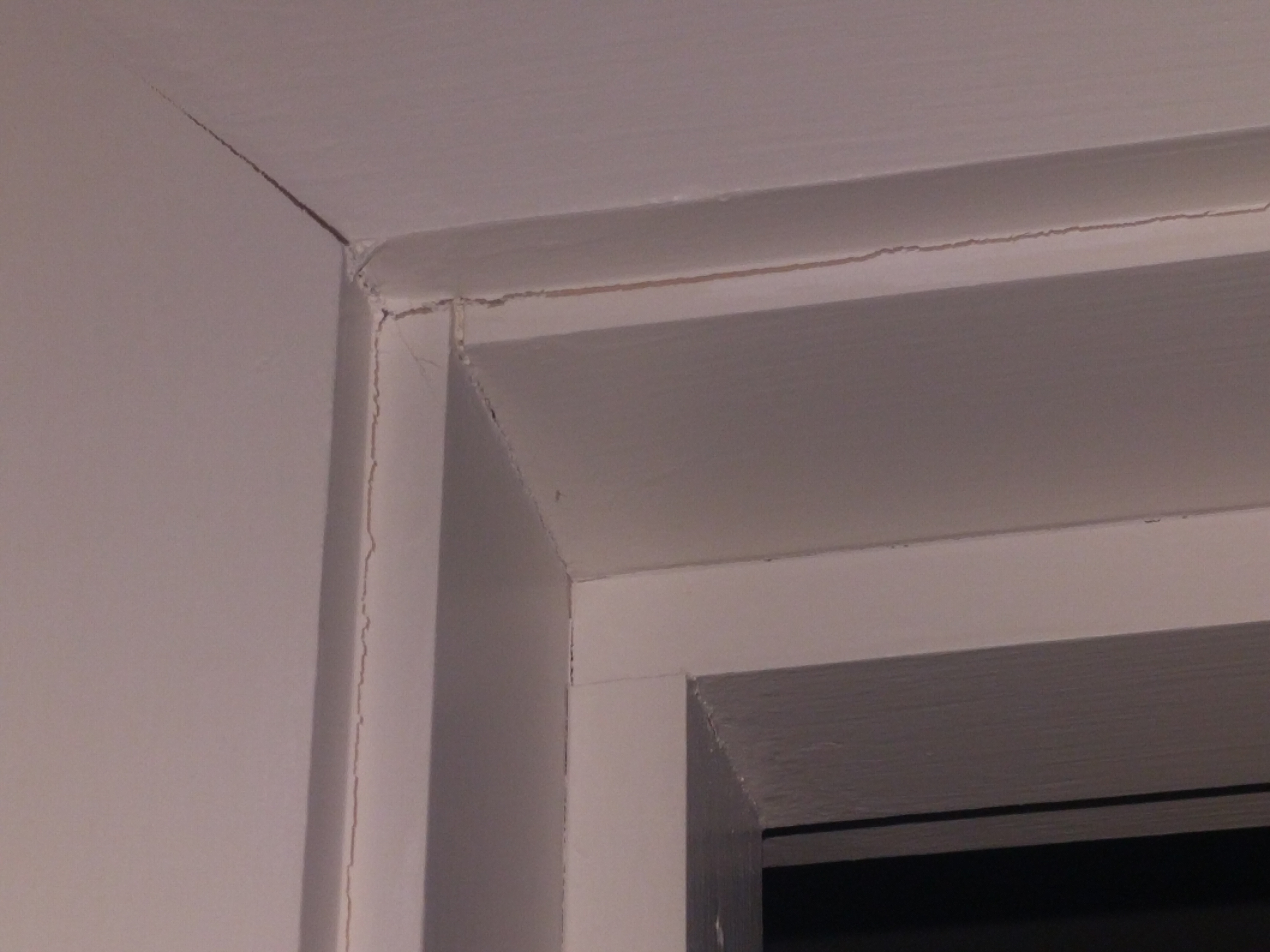

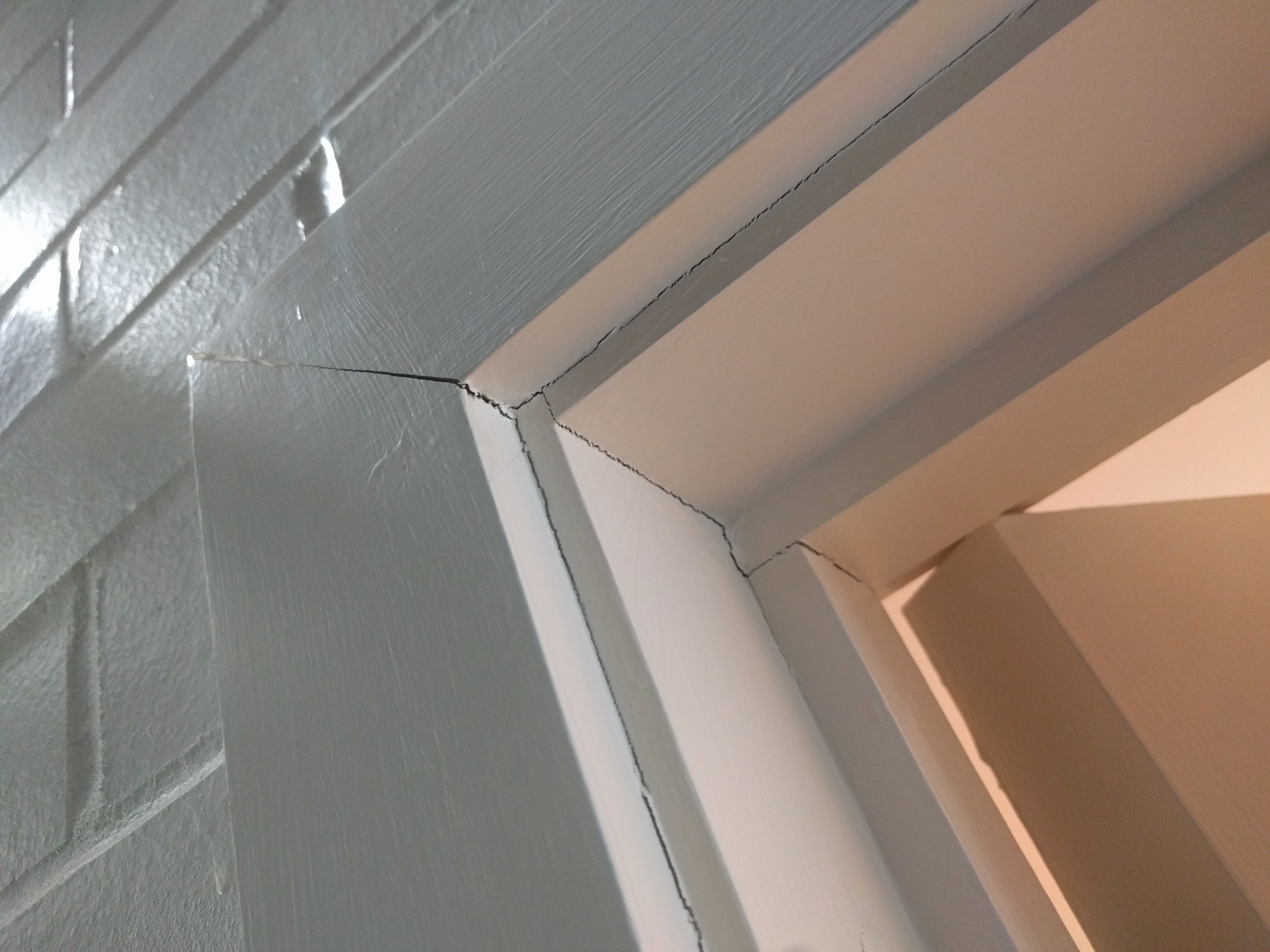

jack Posted May 22, 2017 Posted May 22, 2017 One data point about softwood: We used high-quality softwood linings. It was some of the nicest softwood I've seen, with few knots and a very fine planed finish. After 18 months, they've all seriously shrunk, leaving cracks at pretty-well every joint, several popped screw-heads, and a couple of places where knots have pushed the paint into a bubble. I'm now going to have fill, sand and paint every single frame in the house. I did expect some movement, but I've been a little surprised at how extensive it is. The MDF skirting boards we used have all weathered very well. If I were doing this again, I'd consider using MDF for the door frames/lining. Not sure whether there are other disadvantages of MDF in this scenario that I'm not aware of.

jack Posted May 22, 2017 Posted May 22, 2017 I could see the engineered version making a difference. Here're a couple of door frames in our house, taken today:
