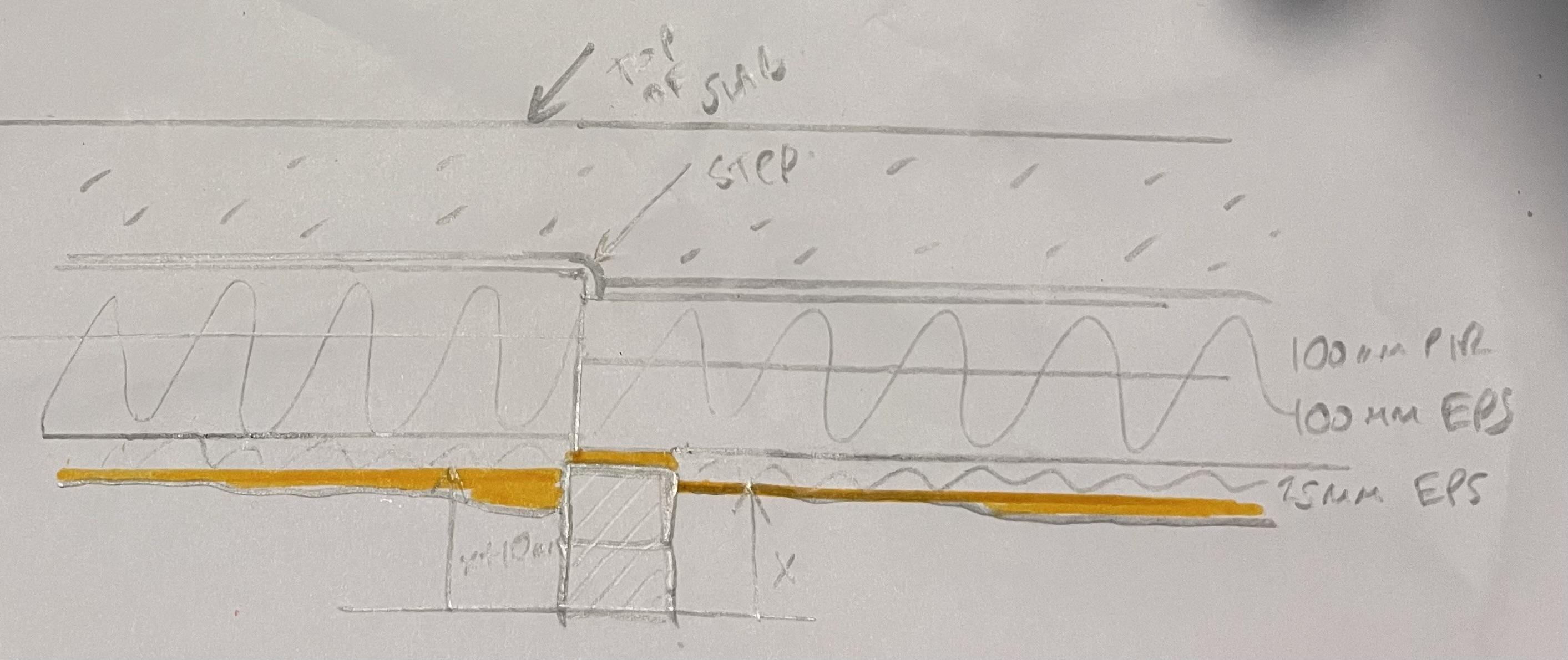

Rather than start a new thread, I thought I'd post back here as it's still relevant to the same install
So I've now taken up all the timber floors down to the original concrete oversite. I will through down some sand for a very thin layer of blinding, just to even out any bumps etc. but my question is:
Is it OK to have steps due to a small variation of depth between different areas (e.g. 15mm or less)?
Some rooms' oversite (where the dividing wall has also been removed) are at slightly different levels to each other (they clearly originally built the footings up to DPC and then filled the oversite to "approx" a consistent level throughout). I really can't be arsed blinding more sand unnecessarily to lift a 3rd of the footprint up just because one ex-closet area has a slightly higher oversite.  (it's a faff barrowing it due to the site layout/restrictions)
So in essence the insulation would be the same throughout, but my concrete slab on top would be 5-15mm deeper in some areas than others. I'll most likely be clipping the pipes to the mesh so the step shouldn't affect any UFH laying etc, and even if I was stapling to the celotex, I can't see how 10mm or so would make any real difference...
Thoughts?
if the higher level is in a particular part of the property you could use a slightly thinner layer over this to mask the base difference, if its all over then beware as thicker PIR sheets are quite rigid and like to rock over undulations .  I think others may get round this by using thinner PIR in multiple layers.
Sorry I might not have been clear - individual rooms will be levelled - no undulations etc.
It's where one large room meets another large room, the oversite levels are slightly off, is it OK to have a step in the insulation (the sheets will be cut at that point so will be solid on their respective bases)?
Where there are a very localised protrusions (a few concrete remains), I will just channel/reduce thickness of the PIR or leave off the 25mm.
Build up is 25mm EPS, 100mm EPS, 100mm PIR
