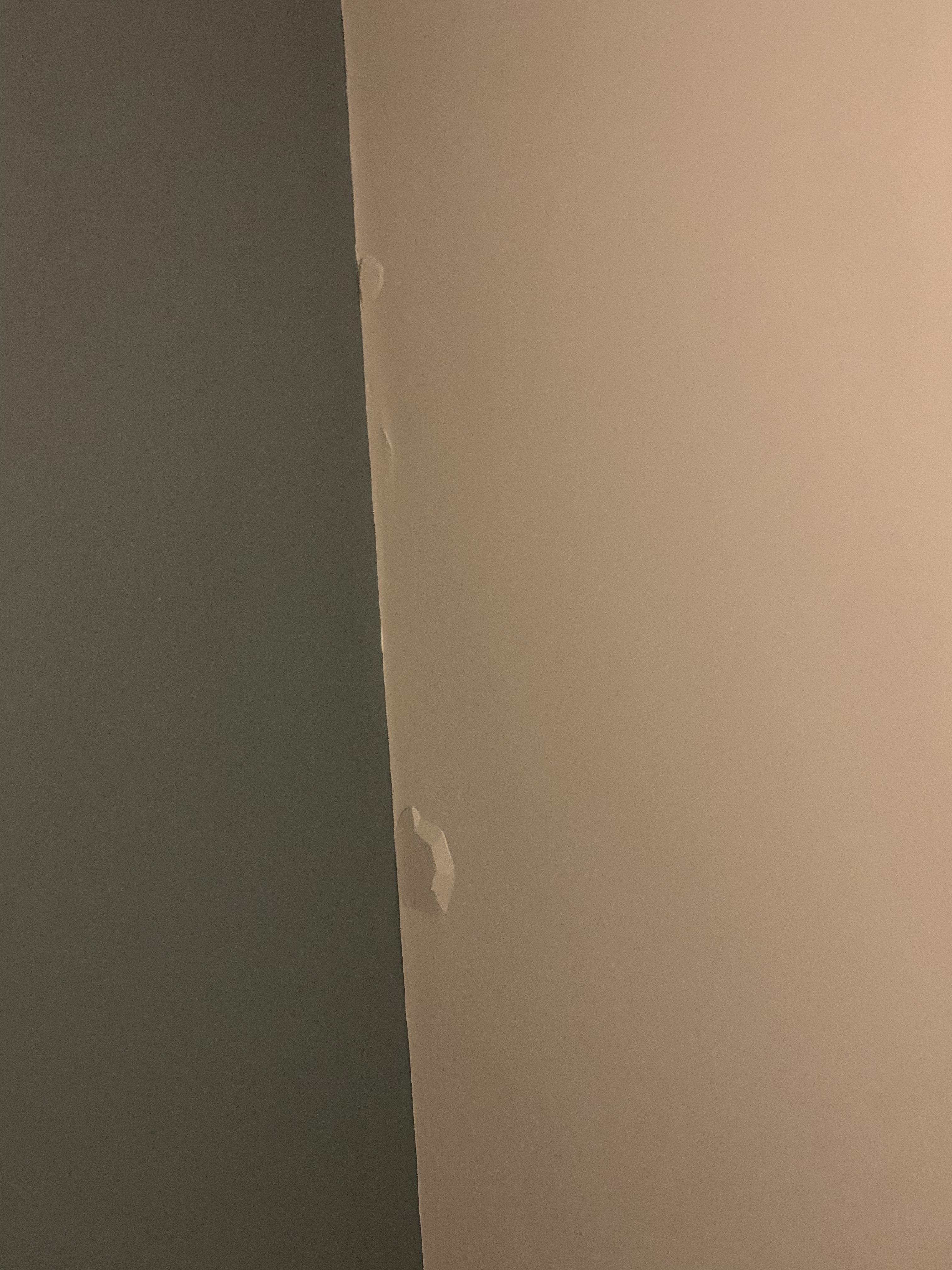

Adsibob Posted May 19, 2022 Share Posted May 19, 2022 (edited) Moved in about 10 days ago. Was putting in one of the final light fittings in my loft conversion this evening, and noticed that the plaster/paintwork had cracked in a very regular pattern at the ceiling, just by the join with the wall. I haven’t got a ladder to measure, but it definitely looks like the broken patch is exactly every 400mm which I presume matches the spacing of the timbers supporting the roof. Most of the patches are about 3.5cm in diameter, but one is almost 6cm in diameter. It’s very weird. I attach some photos. Anybody think I should be worried about this, or is it normal settlement? I only noticed it today, and I couldn’t say when in the last couple of months it happened. This was finished plastered at around January, and painted around mid March, so I guess it could have happened in the last couple of months. Only other possible cause is we had our MVHR commissioned 6 days ago, so maybe it has dried out the walls and ceiling? But we haven’t had this issue anywhere else. Edited May 19, 2022 by Adsibob Link to comment Share on other sites More sharing options...

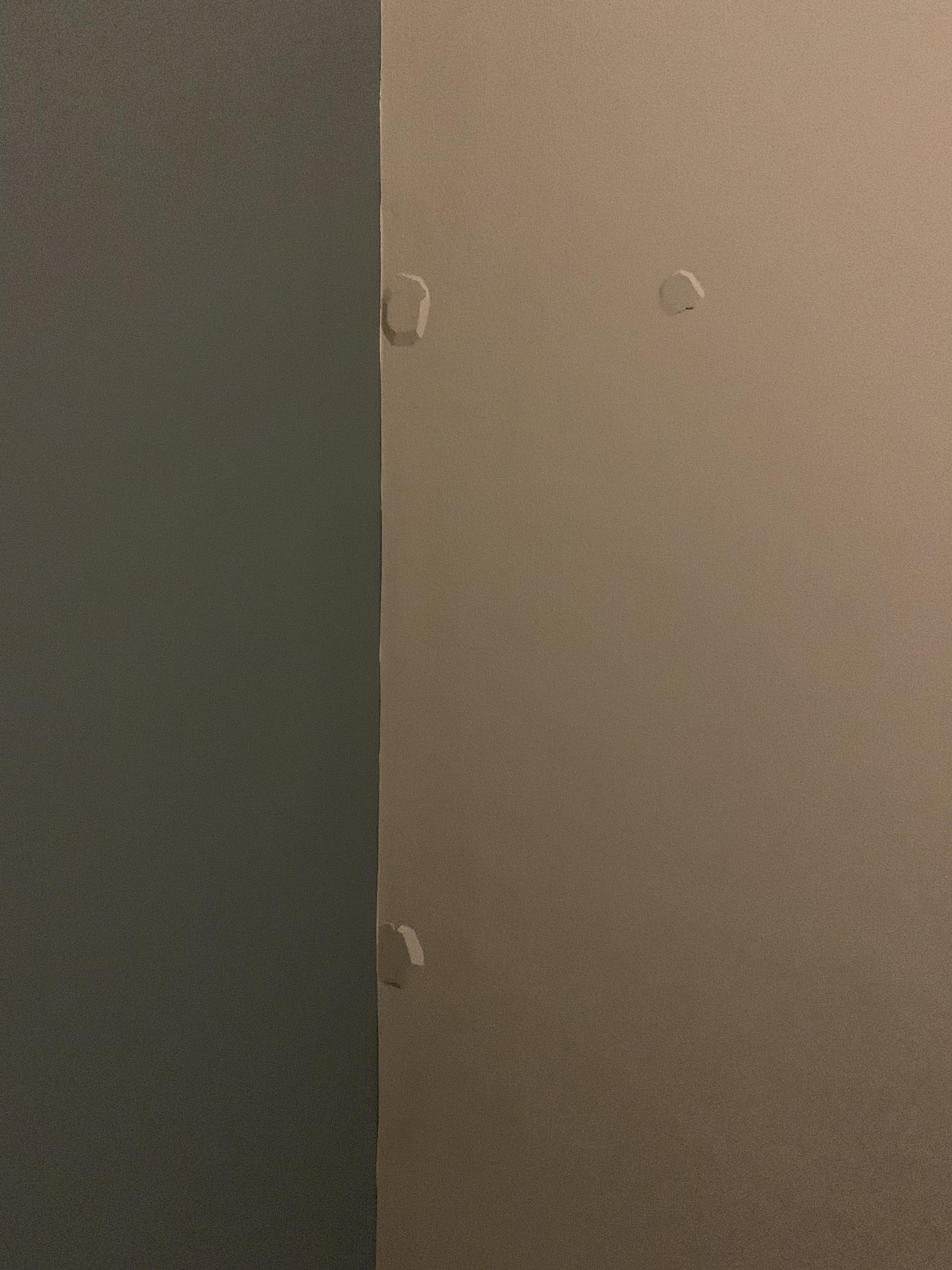

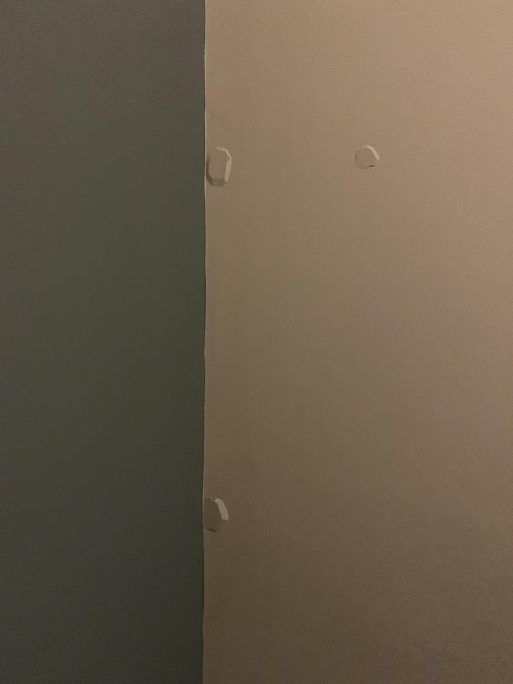

Adsibob Posted May 19, 2022 Author Share Posted May 19, 2022 Another photo Link to comment Share on other sites More sharing options...
PeterW Posted May 20, 2022 Share Posted May 20, 2022 Nail pops - has the board been hit..? 1 Link to comment Share on other sites More sharing options...
ProDave Posted May 20, 2022 Share Posted May 20, 2022 Yes nail or screw heads popped. That usually happens if the screws were not tight so the board was not pulled tight to the timber, then it can move and pop the plaster off the screw heads. If there are only a few, remove the loose plaster, tighten the screw and skim over it again. Link to comment Share on other sites More sharing options...
Adsibob Posted May 20, 2022 Author Share Posted May 20, 2022 Okay, well that is somewhat reassuring that it is not weather related. It doesn't seem to have happened anywhere else in the loft conversion, although we have cornicing that would probably cover it up in the room next door. But what would have caused the board to move? Link to comment Share on other sites More sharing options...
SteamyTea Posted May 20, 2022 Share Posted May 20, 2022 Is it plasterboard with insulation attached to it. Nearly every place I have seen that used, seen the screw heads pop. Link to comment Share on other sites More sharing options...
Adsibob Posted May 20, 2022 Author Share Posted May 20, 2022 20 minutes ago, SteamyTea said: Is it plasterboard with insulation attached to it. Nearly every place I have seen that used, seen the screw heads pop. Yep, Kingspan Kooltherm K118 insulated Plasterboard! Why does it cause that? Link to comment Share on other sites More sharing options...
SteamyTea Posted May 20, 2022 Share Posted May 20, 2022 13 minutes ago, Adsibob said: does it cause that In my limited experience, yes. Trouble is, it can move too much. Link to comment Share on other sites More sharing options...
Radian Posted May 20, 2022 Share Posted May 20, 2022 I often wonder if pops might happen because of drying-out. Our houses internal timbers went through a very wet winter with no roof. The pops only started appearing some months after we moved in. If the surface of the timbers shrank back towards the centre then plasterboard fixings (nails in our case) might be anchored in dry wood while a small gap opens up between PB and timber as the surface layers of the wood dries out. The chipboard flooring was even worse as it started creaking and groaning against the nails (ring shanked, no glue). Ah the good old days before expanding glue products. Further evidence might be that the floor got so creaky that the builders came back, lifted all the upstairs carpets and threw hundreds of screws in. It fixed it perfectly - for a year or so. Since then it's gone back to walking on a comedy floor. Link to comment Share on other sites More sharing options...
Faz Posted May 20, 2022 Share Posted May 20, 2022 It is the MVHR regulating humidity. I had the same - moved in 17th Feb. Heating just gone on and didn't have much time to slowly ramp it up and MVHR commissioned pretty much at the same time. What would take a 'normal' house to dry out happened at least 10x faster. Only had 1 board pop with a couple of drywall screws so that isn't much of an issue. The cills and architrave and the like shrunk real quick. I stocked up on some caulk and will probably hit it late summer if I can be arsed. So maybe in a year to 2 then..... Link to comment Share on other sites More sharing options...
