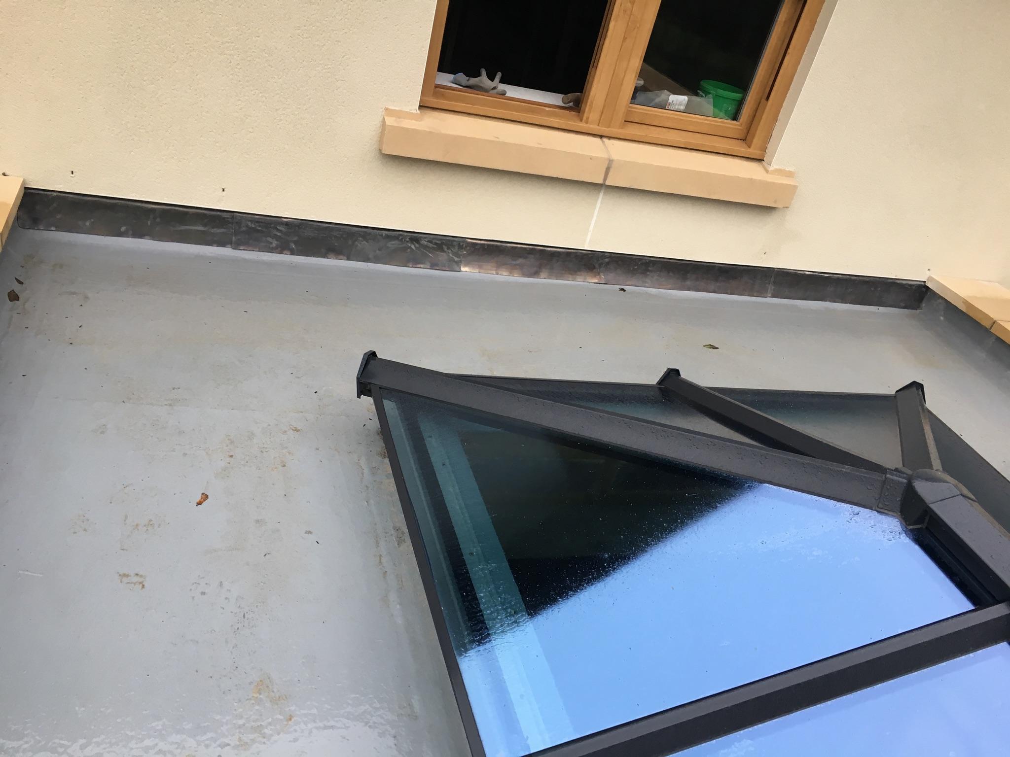

Makeitstop Posted May 19, 2022 Share Posted May 19, 2022 Hi all. As above, what would you use if you had to finish a flatroof project. GRP EPDM PVC single ply Traditional felt Other What and why? Link to comment Share on other sites More sharing options...

Makeitstop Posted May 19, 2022 Author Share Posted May 19, 2022 13 minutes ago, Thorfun said: We had single-ply membrane on our flat roofs which are green roofs. Was recommended it over GRP as we’ve got a timber frame and it survives the movement of the TF better. Had 3 different roofers say the same thing. Do you recall the product name Thorfun? I have been told that siltec is a good product, but know nothing of it. I have a significant issue in buying into anything I'm told is a great product, if I'm being told it by someone that stands to profit from me believing it. Cynical maybe but for me, trust has to be earnt. I'm unsure of what product to use on a job. Approx 6.5 m x 3.5 m flatroof with large rooflight. Link to comment Share on other sites More sharing options...

Makeitstop Posted May 20, 2022 Author Share Posted May 20, 2022 Thanks for the replies. I'll look into the Alwitra product above. On the epdm, I like the idea of that but am less confident about the detailing around rooflight. On roof with no penetration, I'm sure it's a good choice and has less potential for issues with seams. Link to comment Share on other sites More sharing options...
JohnMo Posted May 20, 2022 Share Posted May 20, 2022 Our roof is at a 12 degree angle, we used EPDM (Sarnafil) which has all seams hot air welded. Link to comment Share on other sites More sharing options...
Makeitstop Posted May 20, 2022 Author Share Posted May 20, 2022 6 hours ago, JohnMo said: Our roof is at a 12 degree angle, we used EPDM (Sarnafil) which has all seams hot air welded. Thanks. Does it have any penetrations for rooflight etc.? If it weren't for rooflight, I think I'd feel more confident with epdm or pvc Link to comment Share on other sites More sharing options...

Makeitstop Posted May 20, 2022 Author Share Posted May 20, 2022 Its interesting to see the varying opinions on this, which somewhat mirrors what can be found online. As you've experienced Jack, its maybe the installer more than the product itself that is the critical element. For me, I can't help thinking grp might be the better choice if there are penetrations to the deck, although I'm open to being convinced otherwise if the argument is compelling enough. Link to comment Share on other sites More sharing options...
