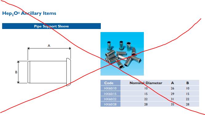

MortarThePoint Posted May 12, 2022 Author Share Posted May 12, 2022 The stated diameter is the OD of the pipe, so if you come across the image below ignore it. I double checked with Wavin technical. Some IDs are: OD ID Area or volume/metre 10mm 6.7mm 0.35cm2 or l/m 15mm 11.3mm 1.00cm2 of l/m 22mm 17.7mm 2.46cm2 or l/m Link to comment Share on other sites More sharing options...

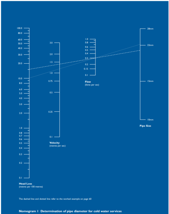

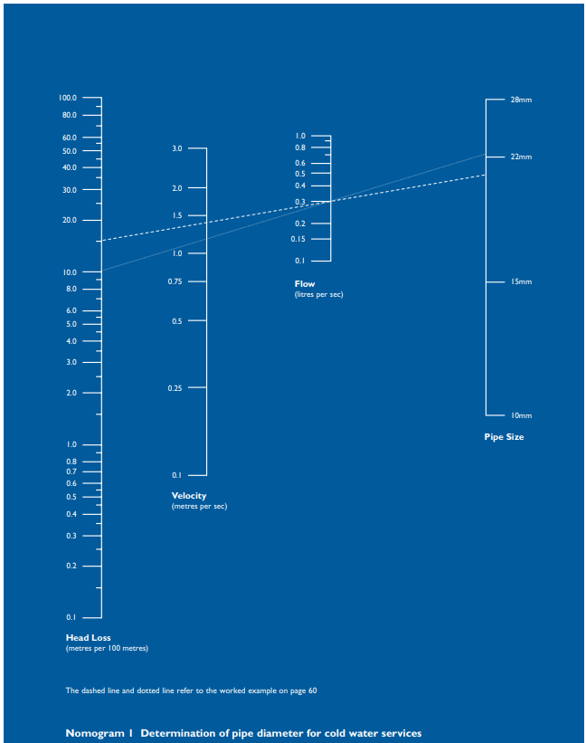

MortarThePoint Posted June 14, 2022 Author Share Posted June 14, 2022 How to size Hep2o pipe (check out pages 60-62 of https://www.hep2o.com.au/downloads/Hep2o_Parts_Users_Guide_Australia_2018.pdf) Image below if for COLD supply. As I understand it, you work out you acceptable pressure loss in metres per 100 metres (which is the same as mbar/m) and then draw a straight line through the required flow rate and that hits the pipe size scale and so you pick the next number up. The dashed line is an example of 14.9m / 100m head loss with required flow of 0.3l/s giving 22mm pipe needed. 0.3l/s would provide 90l of bath water 5 minutes, but of pure cold. My most extreme situation will be around 0.3l/s over 15m, but I'll round that up to 20m to cover elbows / isolators. They (page 60) assume 0.8m head loss across the tap, I'll round that up to 1m (so 0.1bar). If I'm happy with 1bar pressure loss then: Head Loss = 0.9bar / 20m = 45mbar/m = 45m / 100m Using the cold water nomogram shows 22mm is needed for that. 15mm would be OK up to around 0.17l/s. There is a domestic hot water nomogram as well, but I suspect that just assumes something like the flow is 67% hot and 33% cold. With 65C hot water and 12C cold water that would make for an average of 30C. To use that and use 15mm pipe I would have to accept a head loss of 80m / 100m which equates to 1.6bar over 20m. Round that up to 2bar. My mains is 5.5bar at no flow, but I don't know what that would drop to at 0.3l/s. Cold: Hot: Link to comment Share on other sites More sharing options...

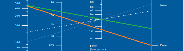

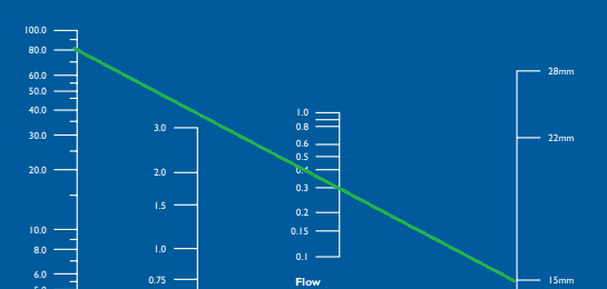

MortarThePoint Posted June 14, 2022 Author Share Posted June 14, 2022 (edited) Based on the Domestic nomograph, a shower at 20m equivalent run, 1bar pressure and assuming 1m head loss across the shower taps/head with a flow rate up to about 0.2l/s or 12l/min. That's along the orange line of the first Hot image above. Edited June 14, 2022 by MortarThePoint Link to comment Share on other sites More sharing options...

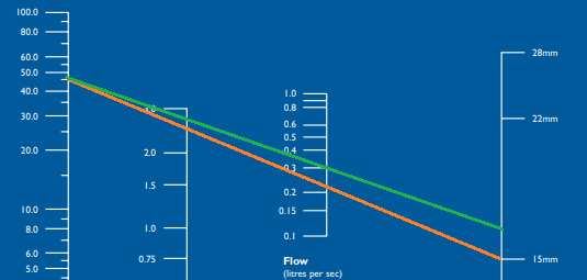

MortarThePoint Posted June 14, 2022 Author Share Posted June 14, 2022 For shaving, so assuming pure hot water, it would be good to fill the basin in under 1 minute. Assuming the water in the basin basin is 300mm x 300mm x 100mm that equates to 9l, so the desired flow rate is 9l/60s = 0.15l/s. That's OK for 15mm pipe up to around 20m with 1bar loss. 10mm pipe and 1bar@20m yields a flow of something like 0.06l/s (or 2.5min to fill basin). Using their head loss tables, gives a pressure drop of 5.4bar over 20m at 0.15l/s for 10mm pipe. For shaving, a 10mm pipe run is probably limited to 10m if a dynamic pressure of 3bar is available. If only 1bar, you'd fill a square foot basin to 2 inches (shallow but can start shaving, 4.5l) in 1 minute at 10m (it's very non-linear remember). For hand washing a flow of 3l/min = 0.05l/s is probably acceptable and it's not pure hot. If it was all through one pipe for 20m I estimate a pressure drop of 0.8bar which is fine to be under 1bar including the tap loss. If you have an en-suite, a family bathroom basin would be ok at 20m with 10mm hot feed until a son started shaving. Link to comment Share on other sites More sharing options...

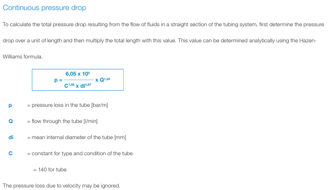

MortarThePoint Posted June 14, 2022 Author Share Posted June 14, 2022 (edited) He's a rough table using the Pegler equation but Hep2o ID dimensions: [Note: 1bar across 20m is 0.5bar across 10m] So at 10m and using 15mm pipe it would take about 2 minutes to put 100 litres of 2:1 water in a bath if 3bar dynamic pressure was available. It would take 4minutes if the dynamic pressure was only 1bar. Edited June 14, 2022 by MortarThePoint Link to comment Share on other sites More sharing options...
MortarThePoint Posted June 14, 2022 Author Share Posted June 14, 2022 Clearer units: Link to comment Share on other sites More sharing options...

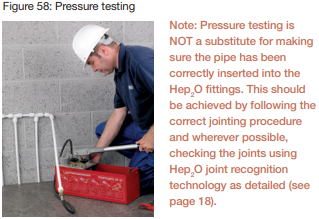

MortarThePoint Posted June 16, 2022 Author Share Posted June 16, 2022 10 hours ago, Nickfromwales said: Don't worry, we'll learn you good, Jethro I hope so, thanks 🙂 I'm going to need to invest in a pressure testing pump as I need to high pressure test at something like 10bar. 1 Link to comment Share on other sites More sharing options...
Nickfromwales Posted June 17, 2022 Share Posted June 17, 2022 On 16/06/2022 at 09:19, MortarThePoint said: I hope so, thanks 🙂 I'm going to need to invest in a pressure testing pump as I need to high pressure test at something like 10bar. Why test at 10bar? 1-3 is average, over 5-6 you’ll need a PRedV to drop it to 4. Just hook up to the cold mains and use that? Link to comment Share on other sites More sharing options...
markocosic Posted June 18, 2022 Share Posted June 18, 2022 If you're ever passing Cambridge you're welcome to borrow my pressure tester. 10 bar will find any fittings that you forgot to nip up. You'd be surprised what will hold at 1 bar then potentially pop off later! I bought it for testing / prestressing some underground district heating mains - take to something like 20 bar, wait for it to stretch, then take back to 20 bar and hold overnight / verify that the drop is as specified. Only then do you trim to length and make the final connections. (it stretches it bucketload and it you don't do this then when it's warm and at normal operating temperature you'll find it creeping into the houses...) 1 Link to comment Share on other sites More sharing options...

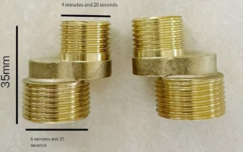

MortarThePoint Posted June 21, 2022 Author Share Posted June 21, 2022 On 15/06/2022 at 22:29, Nickfromwales said: Don't worry, we'll learn you good, Jethro Another hopefully simple question for you. Do you just use pipe and a couple of elbows (all Hep2O) to prepare for a 150mm pipe spacing shower bar mounted on a plasterboard wall (with OSB layer behind the plasterboard)? I've got my OSB and plasterboard wall up and want to poke the pipes through and seal up the wall. I as planning to just use a couple of Hep2O elbows and pipe to do this. Is that how you do it? I'd then use the Easy-Fix style of connector with its included olive to attach to the Hep2O pipe. Link to comment Share on other sites More sharing options...
Nickfromwales Posted June 21, 2022 Share Posted June 21, 2022 7 hours ago, MortarThePoint said: Another hopefully simple question for you. Do you just use pipe and a couple of elbows (all Hep2O) to prepare for a 150mm pipe spacing shower bar mounted on a plasterboard wall (with OSB layer behind the plasterboard)? I've got my OSB and plasterboard wall up and want to poke the pipes through and seal up the wall. I as planning to just use a couple of Hep2O elbows and pipe to do this. Is that how you do it? I'd then use the Easy-Fix style of connector with its included olive to attach to the Hep2O pipe. Normally a couple of bends and then copper tails projecting out at 150mm c’s is fine. For a bar mixer you’ll need a fast / easy fit kit to mount the shower with, as with this approach h you’ll be binning the supplied cranked 1/2”x3/4” fittings. LINK 1 Link to comment Share on other sites More sharing options...
MortarThePoint Posted June 21, 2022 Author Share Posted June 21, 2022 58 minutes ago, Nickfromwales said: Normally a couple of bends and then copper tails projecting out at 150mm c’s is fine. For a bar mixer you’ll need a fast / easy fit kit to mount the shower with, as with this approach h you’ll be binning the supplied cranked 1/2”x3/4” fittings. LINK Why the transition to copper? Thanks for the link, exactly what I'm after. Link to comment Share on other sites More sharing options...
markocosic Posted June 21, 2022 Share Posted June 21, 2022 What are the thoughts on this style? https://www.screwfix.com/p/contemporary-bar-valve-fixing-kit-chrome/76919 (bombproof mechanically as far as the physical strength of the bar mixer mount is concerned) I guess that's more off a pita to get the depths set vs sticking copper tails out and trimming to suit after tiling? Link to comment Share on other sites More sharing options...
MortarThePoint Posted June 21, 2022 Author Share Posted June 21, 2022 30 minutes ago, markocosic said: What are the thoughts on this style? https://www.screwfix.com/p/contemporary-bar-valve-fixing-kit-chrome/76919 (bombproof mechanically as far as the physical strength of the bar mixer mount is concerned) I guess that's more off a pita to get the depths set vs sticking copper tails out and trimming to suit after tiling? Looks sturdy, but won't that need to be installed prior to the plasterboard that it goes through? Or do you attach it to a pattress and then mount the pattress on the studs. Link to comment Share on other sites More sharing options...
markocosic Posted June 22, 2022 Share Posted June 22, 2022 Before plasterboard - onto underlying blockwork or noggin Link to comment Share on other sites More sharing options...

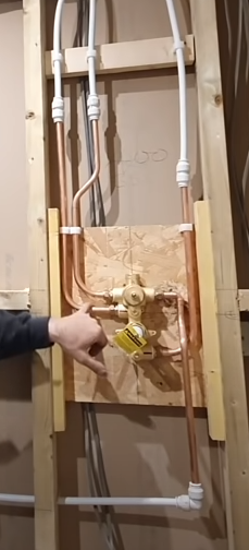

MortarThePoint Posted June 22, 2022 Author Share Posted June 22, 2022 I still don't know why the transition to copper. It seems to be common practice (see below) but I'm in the dark ( @Nickfromwales )? Link to comment Share on other sites More sharing options...
