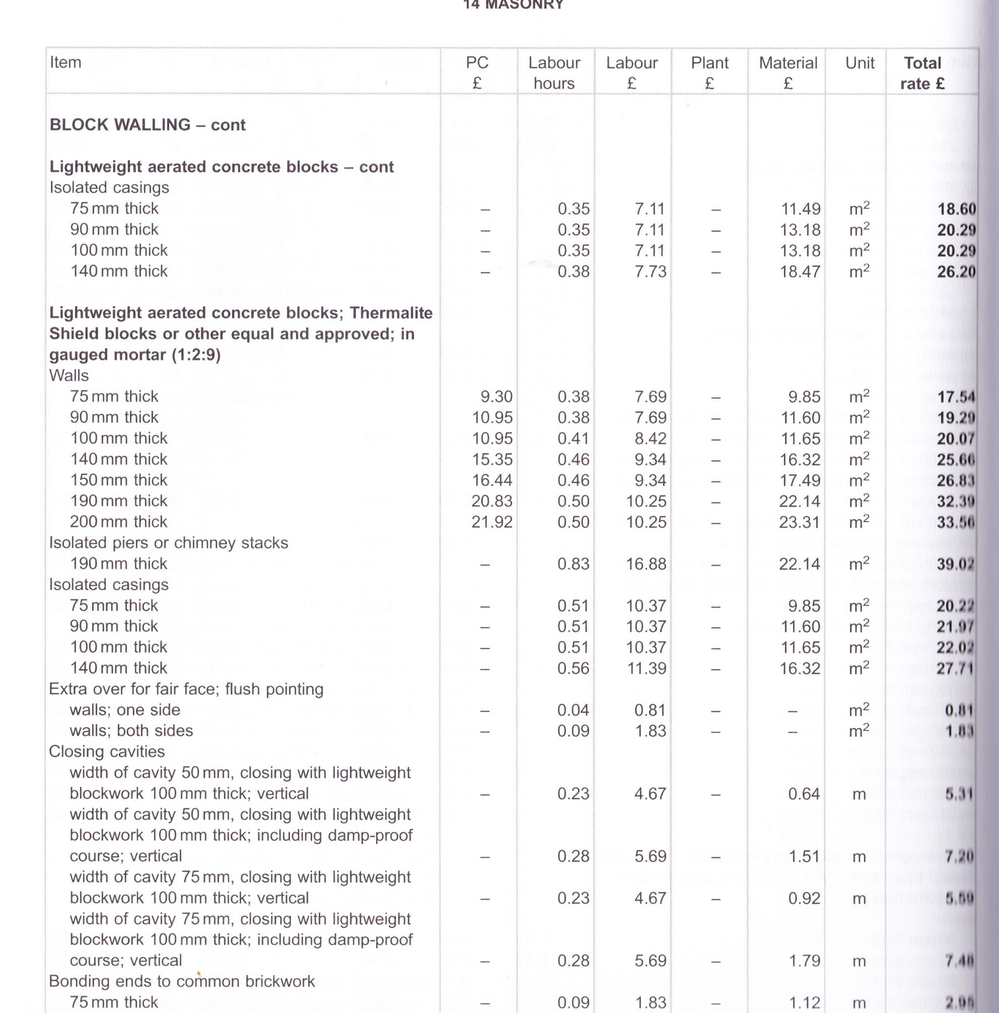

ToughButterCup Posted May 18, 2017 Share Posted May 18, 2017 SPONS sorts out that problem by citing a price per square meter. Link to comment Share on other sites More sharing options...
Construction Channel Posted May 18, 2017 Share Posted May 18, 2017 how many sq meters can they lay a day? Link to comment Share on other sites More sharing options...
ToughButterCup Posted May 18, 2017 Share Posted May 18, 2017 It doesn't matter: you have a known area to build; multiply that by the price per meter. SPONS itemises both labour and material costs, and makes an allowance based on Outer London being the base price; Lancashire's price will be about 0.96 of that price. Your neck of the woods , Ed is about half Outer London cost.... Too easy, too open to inspection. Link to comment Share on other sites More sharing options...

ToughButterCup Posted May 18, 2017 Share Posted May 18, 2017 1 hour ago, Construction Channel said: it matters if they are offering day rate But the task is of a known size. That - in conjunction with SPONS - makes it possible to make a judgement on whether the day rate is reasonable. SPONS has saved me about as much money as buildhub. Link to comment Share on other sites More sharing options...

ToughButterCup Posted May 19, 2017 Share Posted May 19, 2017 Hi folks, This is what I mean; I have no interest in SPONS Architects' and Builders' Price Book. Expensive, but -for what we are doing - worth it. There are four pages of the book about block work prices. Ian 1 Link to comment Share on other sites More sharing options...
