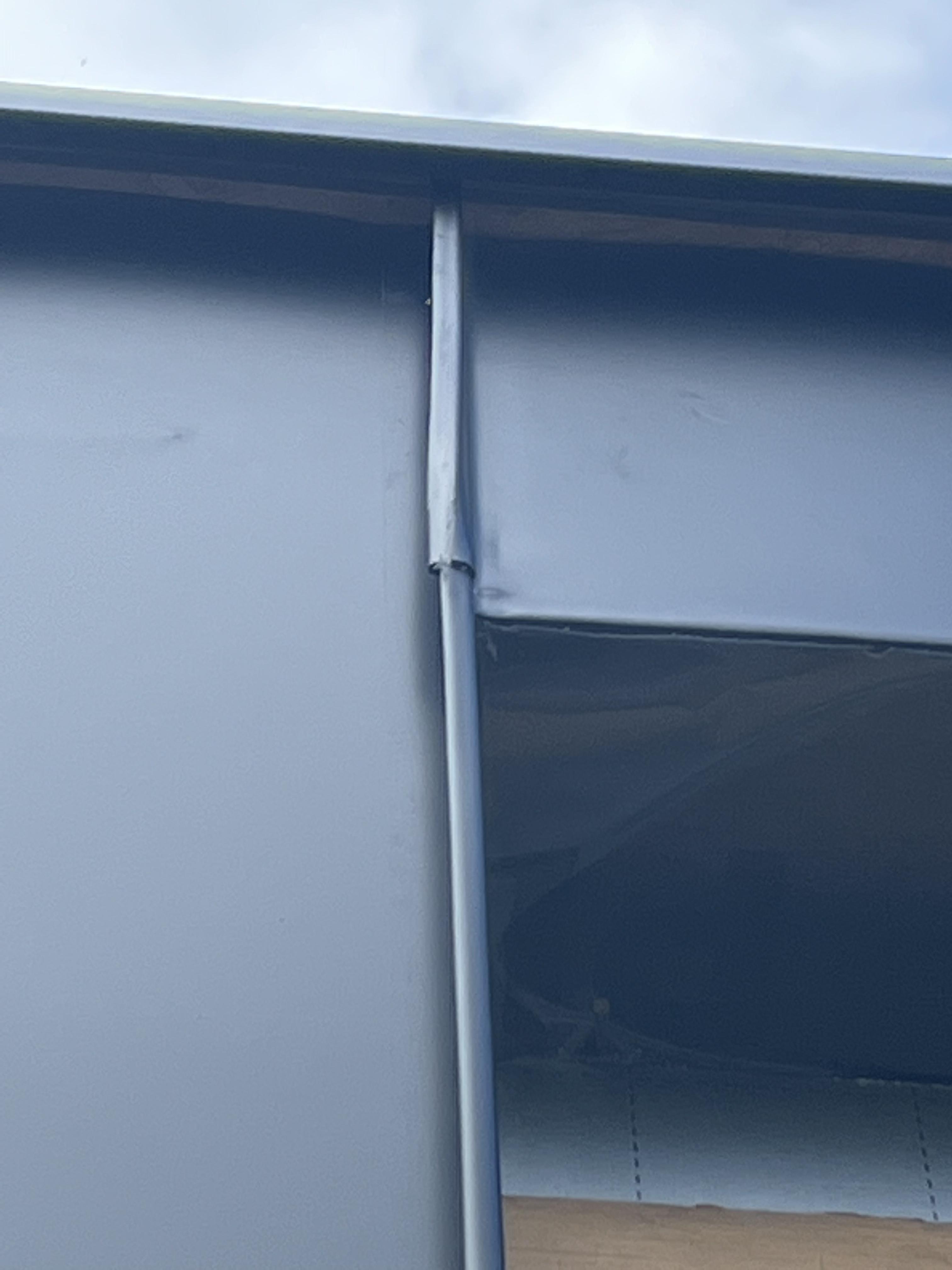

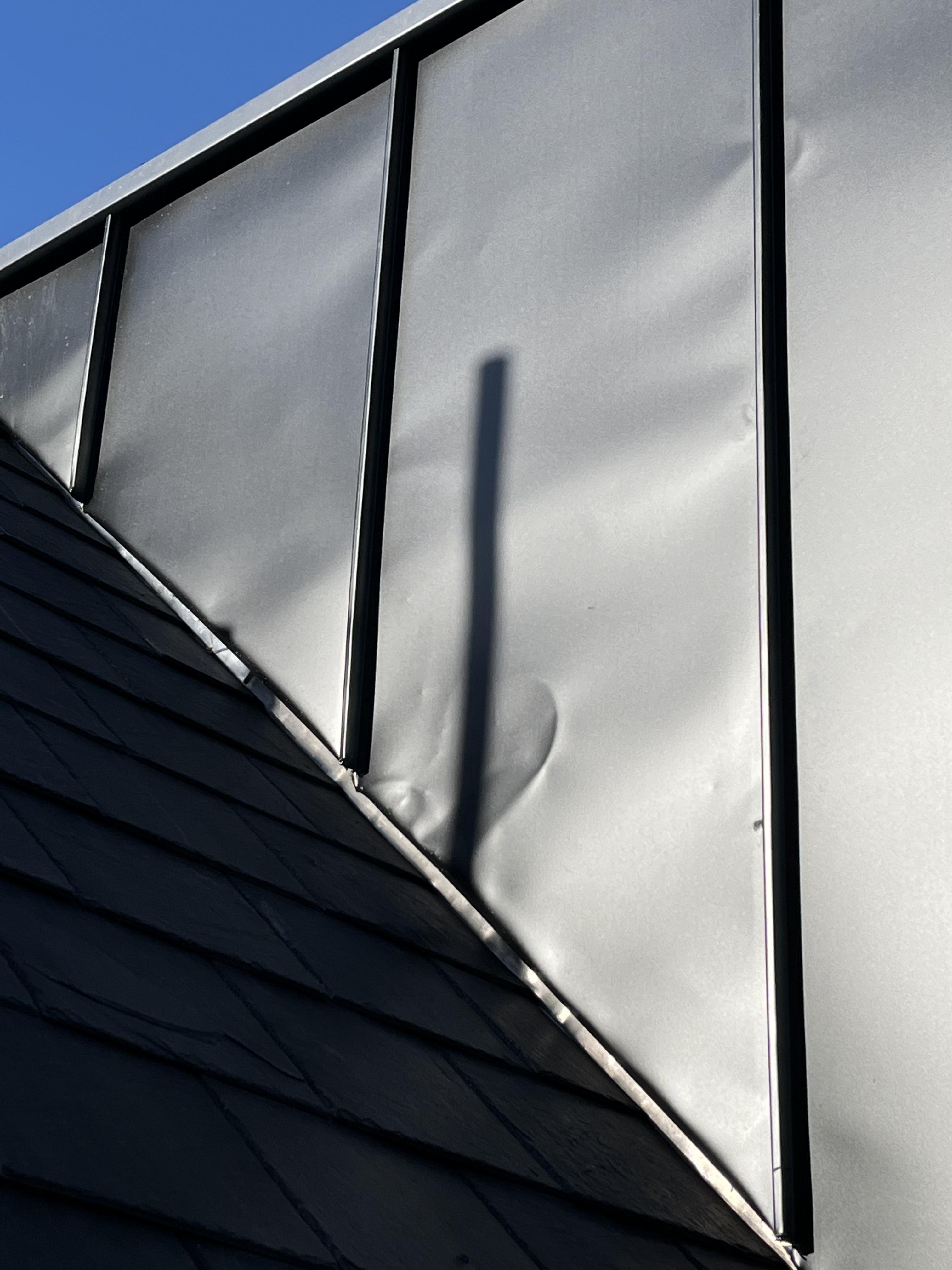

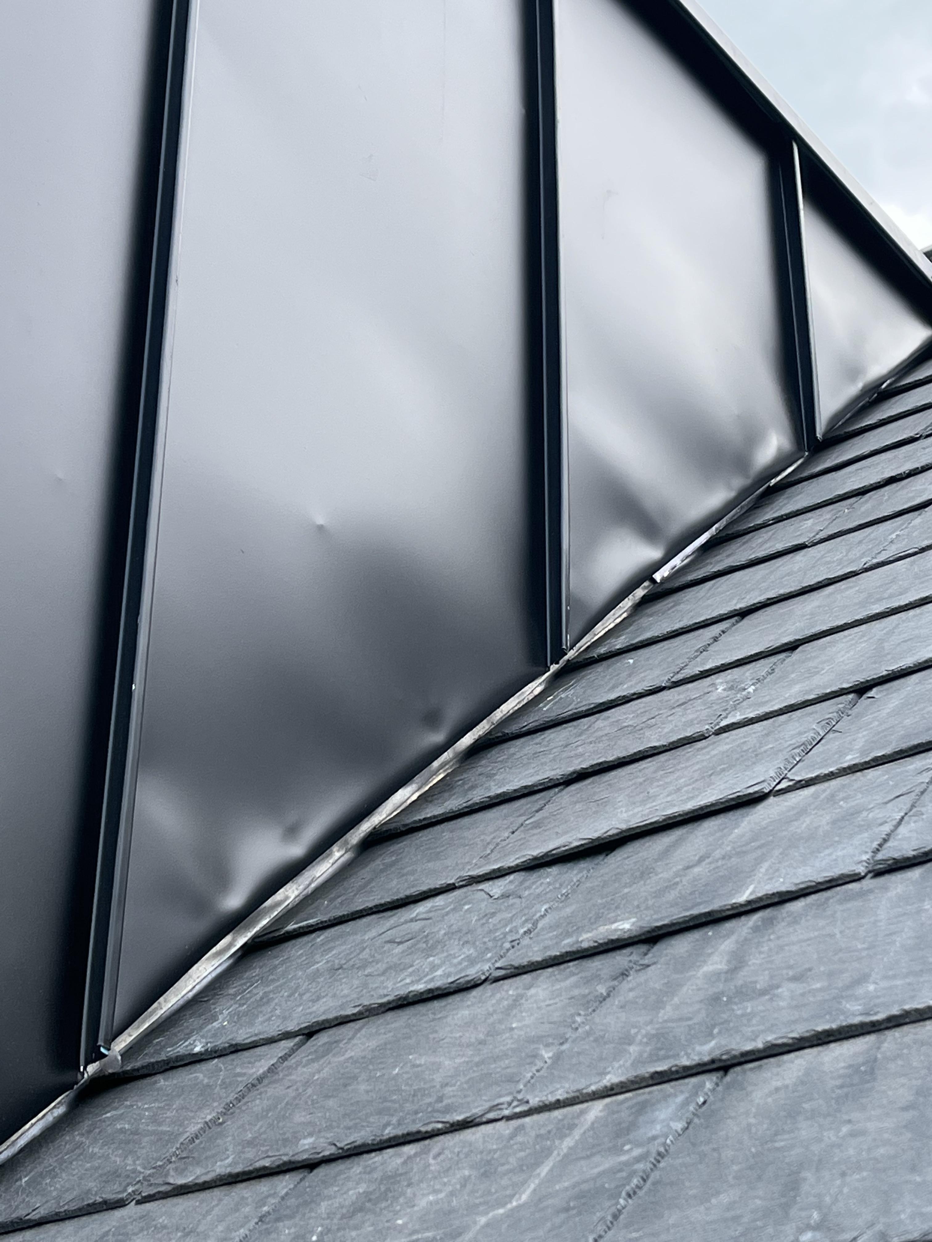

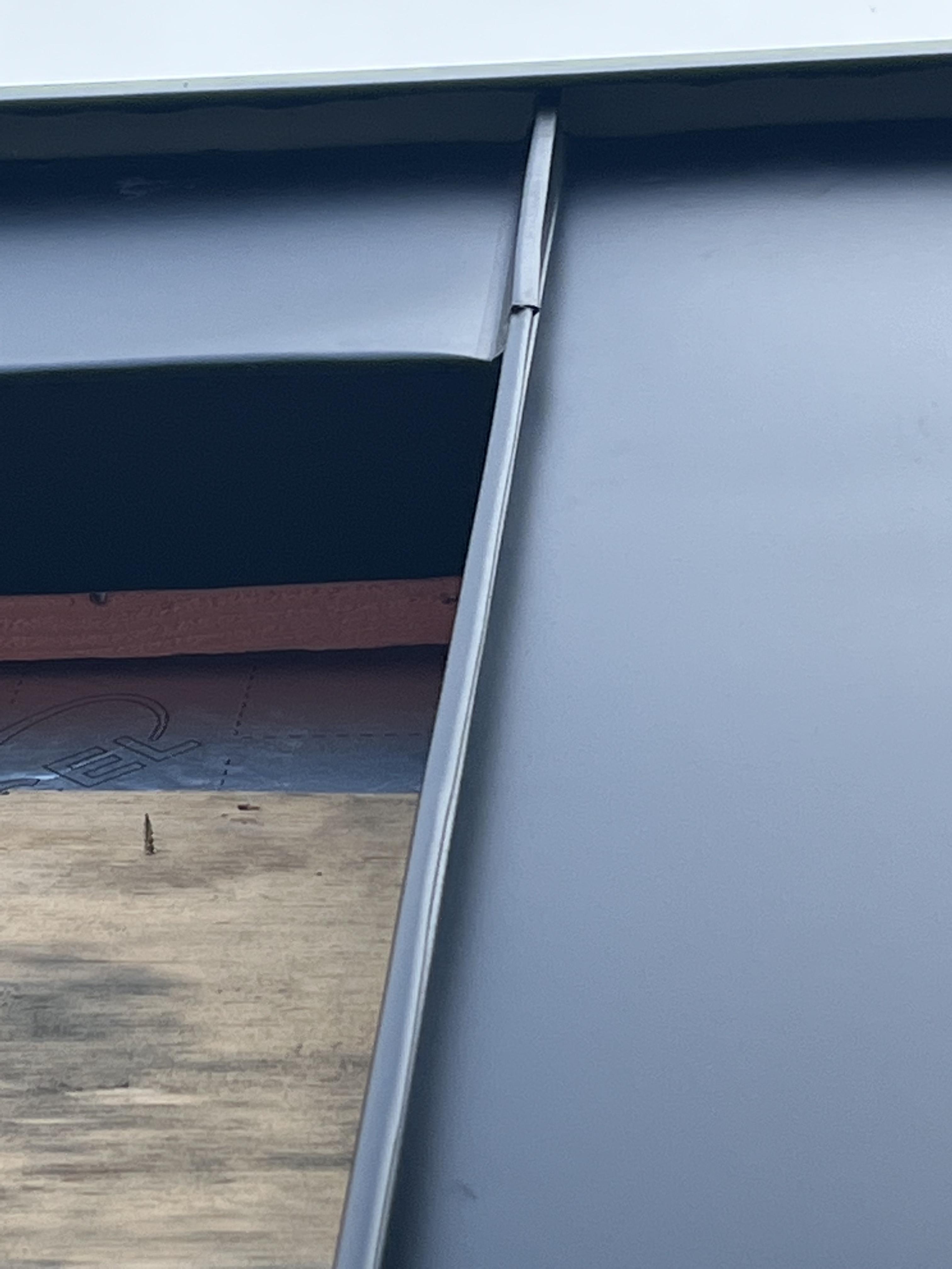

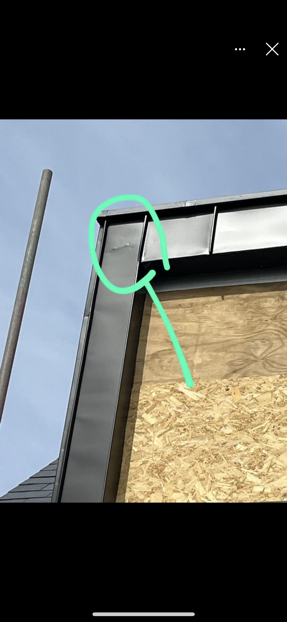

DragsterDriver Posted May 8, 2022 Posted May 8, 2022 Morning, I wasn’t sure where to post this but the zinc/metal roofer has messed my dormers up beyond repair. He was paid in full before the film was removed (yes I know!). I invited both directors to site and view the defects and put them right, they turned up and said it was an A1 job so it looks like small claims (daunting). I’ve had the independent expert out to do a report and take pictures before it’s removed (he’s condemned it all). have I done everything correctly? been polite. offered a chance to correct it. got an independent expert in. I need to move on with a new contractor so I can get windows in etc. big PITA.

Mr Punter Posted May 8, 2022 Posted May 8, 2022 It certainly isn't pretty and some is decidedly rough. Was the substrate all good? I looks like some cables etc are showing through but the damage may have happened elsewhere. The court will take an age. How annoying! Is there an amount of money you would settle for? 2
DragsterDriver Posted May 8, 2022 Author Posted May 8, 2022 16 minutes ago, Mr Punter said: It certainly isn't pretty and some is decidedly rough. Was the substrate all good? I looks like some cables etc are showing through but the damage may have happened elsewhere. The court will take an age. How annoying! Is there an amount of money you would settle for? the substrate is brand new dormers, 18mm ply on 25mm battens for ventilation- which they’ve blocked at the top. the ‘bobbly’ bits are where they rolled out the metal on an mot/gravel drive- so the wife tells me. I want/need all of the money I paid back because the whole lot needs to be removed and skipped, to be redone by somebody else. If it drags on it’ll mean they also incur scaffold costs etc…but they I’m sure know I need it resolved asap hence getting the independent witness to do a report and take lots of pictures. very annoying indeed- if it wasn’t my number one dream item on the want list I’d replace it with some black vertical cladding or something. it actually looks worse in the flesh which takes some believing.

markc Posted May 8, 2022 Posted May 8, 2022 (edited) Either that would be visible with the film on or they purposely pulled the film and re applied stretching over the dents. obviously not bird damage or scaffold stripping so you should have no problem claiming poor workmanship Edited May 8, 2022 by markc 1

DragsterDriver Posted May 8, 2022 Author Posted May 8, 2022 7 minutes ago, markc said: Either that would be visible with the film on or they purposely pulled the film and re applied stretching over the dents. pits obviously not bird damage or scaffold stripping so you should have no problem claiming poor workmanship there’s no scaffold above, but it’s not just the cosmetics, the way it’s flashed etc is wrong and allows water ingress, no abutments, no top ventilation etc.
