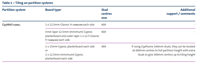

I was hoping for some tips on using OSB under plasterboard in bathroom walls. How far off the screed should the bottom of the OSB sit? Particularly next to the shower tray should I raise it clear of where the top of the shower tray will be and use either smaller OSB offcuts on the studs as packers or perhaps use 11mm thick timber there? Is it worth treating the bottom of the OSB with anything?
How far off the screed is it normal to raise moisture resistant plasterboard? Note both of these are distance off screed not off top of tile.
I plan to tank the plasterboard when done. Is that considered a good approach or will it create difficulties for tiling or plastering?

OSB to about 15mm off the screed. Same for PB. Tanking should be done after plastering, not before.
The tray gets fitted ( bonded ) back to the surrounding walls with a decent amount of clear CT1, and then no water can ever get to either the PB or the OSB. Cementitious tile adhesive gets used too fill the 15mm gap whilst tiling the floor, which is pretty impervious to moisture.
The aim is to keep the water where it’s supposed to be, so the quality / integrity of the tiling / wall covering is key to success.

Thanks this is all really helpful. So sounds like the winning recipe is:
  1. Studs at 400mm c/c (70mm C-studs in my case)
  2. OSB (in my case 11mm) onto studs, held 15mm off the floor screed
  3. 12.5mm moisture resistant plasterboard onto OSB, held 15mm off the floor screed
  4. Plaster skim (Thistle Multifinish or is there a better choice for bathrooms?)
  5. Tanking solution (any recommendations?)
  6. CT1 shower tray against the plastered wall and tile above as needed
  7. Elsewhere, use cementitious tile adhesive to fill the 15mm gap when tiling the floor

Before tanking you need to make sure you use the tanking tape to the corners and around the tray.  I have recessed shower valves so taped around them too.
I used the Everbuild system and it seemed pretty good.
