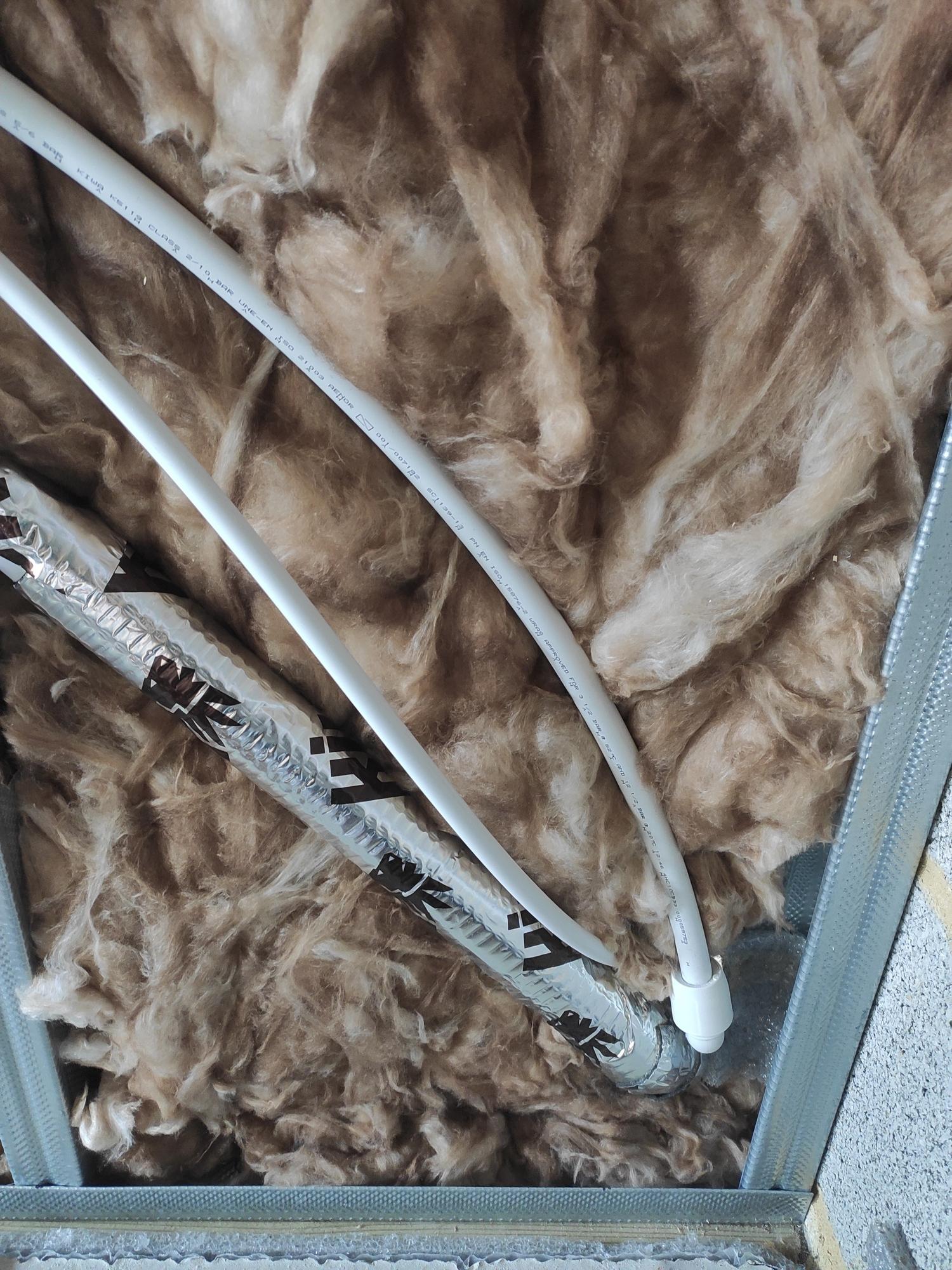

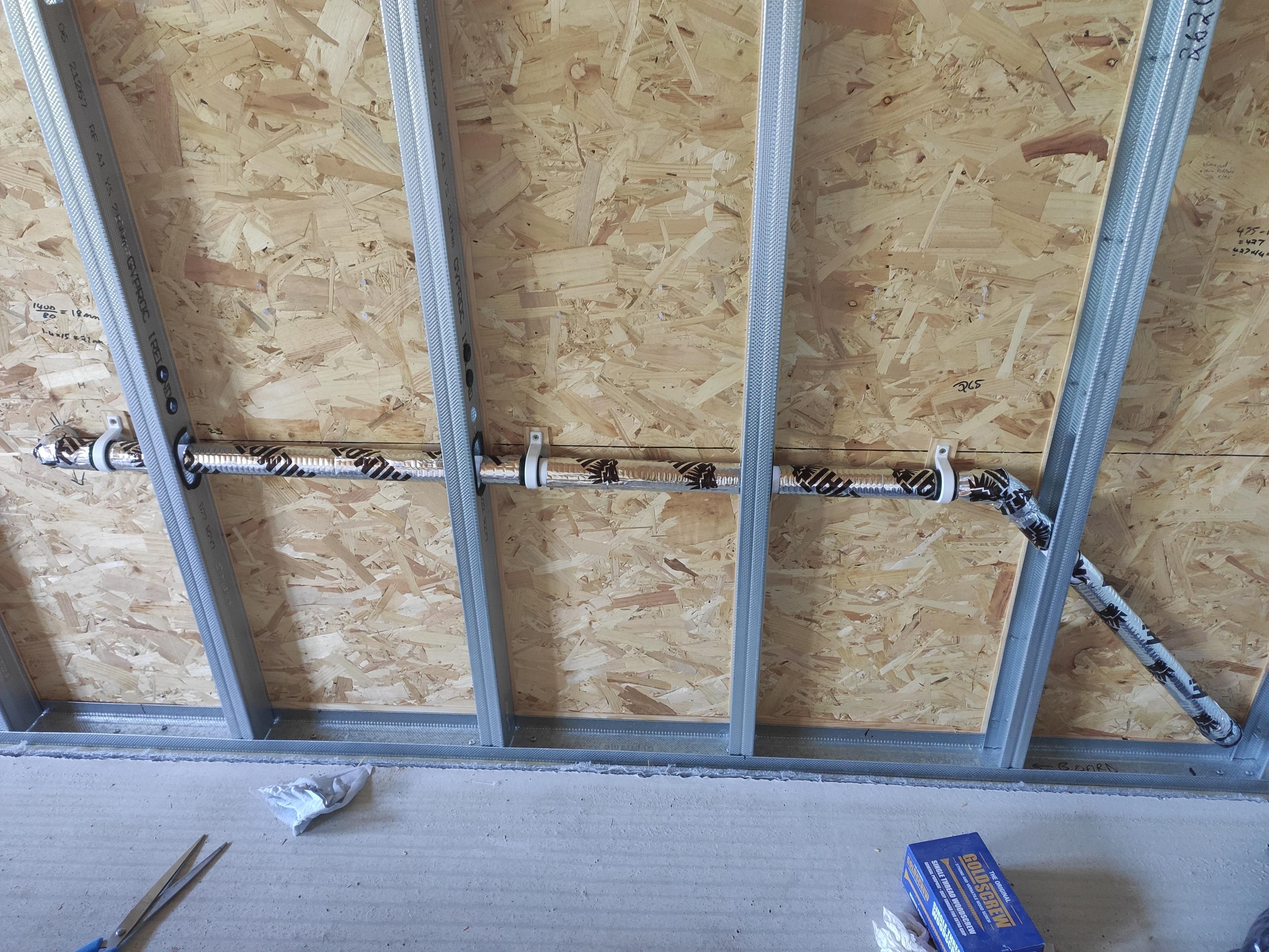

Almost ready to cover up with APR and plasterboard. I used Kilmat as @Nickfromwales suggested to help with any noise. The clips are 40mm clips used on 32mm pipe with foam tape wrapped around to reduce noise transfer. The pipe exits the wall within a 100mm square from the floor and the wall. At the other end you can see the pipe exit at around 500mm from the floor and with H and C written just above where I am going to send the water feeds through. I think those holes are 60mm higher than the waste hole and 80mm apart. The plan is for the feeds to then split inside the room to feed the two basins as that puts fewer fittings in the wall. I'll need to use elbows on the feed pipes as the wall cavity is only 70mm and the bend radius is 120mm/80mm for 15mm/10mm pipe. I could exit the wall at an angle but I think that could look bad.
Don't panic about the fittings as Hep2o stuff is simply bombproof.
Defo avoid doing that ;)

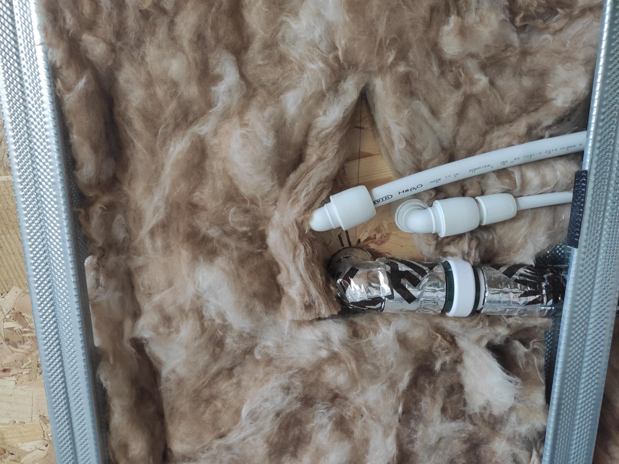

Placing the pipes between two layers of 25mm APR. I wanted 15mm pipe sticking out of the wall to attach the basin flexis to so used a 15mm/10mm reducer and 15mm elbow. Where I'm going to box out near the floor I was able to send the 10mm pipe through at a slight angle to allow it to fit in the 70mm cavity.
I pushed the Hep2O fittings together really hard, but the In4Sure rumble was very hard to feel except for the reducer. I couldn't rotate the last elbows either as they had to be assembled once already through the wall. I don't want to disassemble it and reassemble in a different order that allows turning. How important is that?
