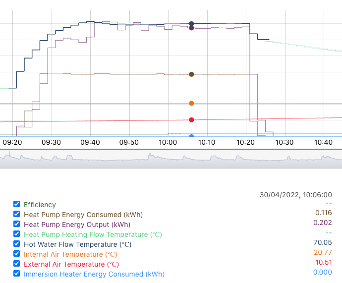

Dan F Posted April 30, 2022 Share Posted April 30, 2022 (edited) Our 7kw aroTHERM is working great, but I have one issue I can't resolve; no matter how low I configure the DHW flow temperature and DHW flow temperature offset, the ASHP ignores what is configured and uses 70C I currently have the following configured: - DHW Temperature: 55C - Cylinder charging offset: 0C - DHW Mode: Normal - Max cyl charger time: 120min The ASHP Hydraulic Unit and sensoComfort controller both show a target temperature of 55C, but the actual flow temperature ignores this. I do have an abnormal setup, but I'd hoped I could still constrain the flow temperature - UVC is Mixergy and I'm using primary coil and not the external PHE. - Mixergy controls DHW demand via a resister switch that simulates demand by faking the DHW temperature sensor. Initially it was using 26C(on)/60C(off), but I've now adjusted to 50C(on)/60C(off) and see no real difference in behaviour, not in "normal" mode anyway. Using DHW Mode "Eco" seems to help somewhat and it sticks around 62C for the first 50min and then climbs to 67C, but it's still ignoring the target of 55C. COP I'm getting at 70C is around 1.9 wheras a flow temperature of 55C should give me around 3 if it's 7C+ outside. @J1mbo@Bruno What do you see with yours? Any ideas? Edited April 30, 2022 by Dan F Link to comment Share on other sites More sharing options...

Dan F Posted May 1, 2022 Author Share Posted May 1, 2022 For reference the way Mixergy works in my setup (using indiect coil) is this: 1) Mixergy signals DHW demand using it's own controls. It does this using a "resistor switch" which simulates UVC geing below target temperature. 2) The ASHP flow heats the top of the tank using the indirect coil to 50C. 3) Once the top of tank has reached 50C demand is not satisified, but rather a pump turns on which sprays cold water (from the bottom of the tank) into the top of the tank. 4) The ASHP flow continues to maintain the top of the UVC at 50C and pushes the termocline. 5) When the Mixergy is at a desired %, the resistor switch is flipped to simulate the UVC being at 60C and ASHP DHW turns off. I don't expect ASHP to behave in the same way as with a standard HP coil, where flow temperature gradually increases over time (with higher efficiencies to start with) and only hits 55C at the end of this period. But, I do expect a fairly constant 55C flow (once top of the tank is at 50C), rather than 70C. Link to comment Share on other sites More sharing options...
markocosic Posted May 4, 2022 Share Posted May 4, 2022 Interesting pairing of equipment. I think these two issues: (1) The (shorter) Indirect coil at top of the tank means return temperatures are higher than with a standard HP coil lower down in the UVC. The higher return temperature pushes up flow temperature (which is not constrained) as the ASHP attempts to maintain a [flow temperature that tracks the gradually increasing cylinder temperature] (2) The ASHP doesn't see the UVC temperature increase over time (it's fixed due to resistor switch), so the ASHP [ratchets up the flow temperature to try heat this cylinder that is apparently being drained so fast that it cannot be reheated] You will achieve the highest COP by heating the entire cylinder from cold to hot "in one go" at as low an average temperature as possible, vs incrementally heating a cylinder from full cold to full hot "a bit at a time" at the maximum temperature. In a "standard" cylinder for heat pumps (with a ruddy great coil from top to bottom) the heat pump sees cool water that warms up as the cylinder warms. If it is DUMB them it runs at a fixed temperature. If it is a little smarter the heat pump can set flow temp = 10C above return temp (or some other number that achieves a reasonable power input / reheat time) and up the temperature gradient it runs until the cylinder is satisfied. If the heat pump is bit smarter again it can, if tsenses that he cylinder is already part heated, always run at a minimum of say 50C output in order to avoid cooling the top part (that's ready to use) whilst it's heating the bottom part. If it is REALLY clever it will have a desuperheater on it to top up the cylinder whilst providing space heating. The "mixergy" coil is configured for heating a cylinder "a bit at a time" from a heat source that doesn't much care about temperature. It's the total opposite of what you want for a heat pump. If you do everything that you can to minimise this stratification and heating in parts - i.e. defeat most of the purpose of the mixergy tank except for the inlet diffuser - then you will maximise heat pump performance. I don't think these are remotely appropriate for use with heat pumps myself. Your heat pump is going to do "whatever it wants to" in order to achieve a tank at the target setpoint - in your case 55C. It has two ways to see what the temperature is. (1) flow and return temps from cylinder primary (2) temperature probe on cylinder I would guess that is is kinda smart. If given a totally cold tank it would ramp the temperature up at return + X degC until setpoint achieved to maximise efficiency. If given a part warm tank it would ramp up at return + X degC, subject to a minimum of say 50 degC so that it doesn't discharge what's already at the top of the cylinder. It will use (2) to decide when to stop and (1) to decide what temperature to use. If the heat pump were DUMB then you can set it to X and rely on an external contact. X is 50C for slow reheat to 45 or 65C for faster reheat to 55C etc. The Arotherm is probably too smart for this application. Try heating a stone cold tank in ECO mode and watching the flow tempeatures? If that works then you know the issue. The Mixergy tank, unless the smarts are defeated, is going to cause problems. You're trying heat the cylinder from full cold to full hot "a bit at a time" as it were. This will result in fairly high return temperatures to the heat pump and the heat pump thinking that the cylinder is almost fully heated. It is logical for it to increase the setpoint in this scenario. You don't have any way to recreate the effect of a "top to bottom" coil. Running a destratification pump to try mimic the effect of a "top top bottom" coil will blend the tank temperature; improving heat pump performance; but killing the "hot top" that you get with a heat pump tank. Running the water through a plate is more flexible but ultimately has the same drawback. Low flow through the plate means "heating a bit of the tank from cold to hot in one go" whilst high flow through the plate mixes up the entire cylinder and loses your "hot top" again. Perhaps set to space heating mode to make the setpoint dumber and allow mixergy to control it? Swap the mixergy tank for one that's more suitable? 2 Link to comment Share on other sites More sharing options...
JohnMo Posted May 4, 2022 Share Posted May 4, 2022 I have a gas boiler and I am using the indirect coil at very low temperature 30 degs. I see exactly the same as you. My flow temp increases well past the set point and eventually trips at 55 degC. So what is happening. In my case and most possibly yours, is the coil surface area is not large enough to transfer the heat to the cylinder contents. The lower the heating medium temperature the larger the coil required, to transfer the heat to the cylinder. Two ways to fix, can you heat the cylinder directly instead of indirectly (this will increase volume of glycol required). If not, a pumped circuit could be used through a large plate exchanger. So HP is used on hot side of the plate exchanger, the cold side connected to you cylinder. In my case my boiler should be generating 7kW, with boiler output of 30 degC, and return of 25degC. Have sized for a 2 deg approach temp, so that 28 degC is coming out on the cold side to the cylinder. PHE is a 40 plate and sized at 430x81mm. So quite big. Handy calc tool https://www.heat-exchangers.uk/online-calculator/ 1 Link to comment Share on other sites More sharing options...
JohnMo Posted May 4, 2022 Share Posted May 4, 2022 What I forgot to mention, is the temperature ramps up, because the control system is trying to maintain a delta T between supply and return, not enough heat is being extracted, so it sees higher than expected return temperatures so ramps up supply temperature. 2 Link to comment Share on other sites More sharing options...
Dan F Posted May 4, 2022 Author Share Posted May 4, 2022 5 hours ago, JohnMo said: I see exactly the same as you. My flow temp increases well past the set point and eventually trips at 55 degC. Are you using Mixergy + Vaillant? So, even with with a gas boiler same can happen to a lesser extent.. interesting. 5 hours ago, JohnMo said: What I forgot to mention, is the temperature ramps up, because the control system is trying to maintain a delta T between supply and return, not enough heat is being extracted, so it sees higher than expected return temperatures so ramps up supply temperature. Yes, this is what I was starting to conclude. I had wronly assumed (when Mixergy is configured for 55C) I would get flow=60C, return=55C and top of UVC=55C. But, the actual observed steady state (now I've renabled eco mode) I observe is flow=67C, return=62C, top of UVC=55C. This must be because there isn't enough heat-transfer at just a 5C teperature differential with the top tank and 12C is needed. I don't understand the mechanism, but the ASHP is clearly choosing to increase the flow temp, beyond it's own target temperature, rather that do anything else (reduce flow rate?) to deal with this situation. A PHE is the solution if I want to heat the tank more efiiciently at a lower flow temperature, and Mixergy sell one which can be retrofitted. The advantage of using the primary coil (which I knew was a bit of a risk) was the battery-like "top up" functionality, which works suprisingly well and means you aren't always heating the whole tank, Link to comment Share on other sites More sharing options...
Dan F Posted May 4, 2022 Author Share Posted May 4, 2022 6 hours ago, markocosic said: Interesting pairing of equipment. Yes, I know this was unconvential but I also knew that it would work with the aroTHERM plus (Mixergy have tested this setup) and it would come down to efficiencies, so decided to give it a go. 6 hours ago, markocosic said: You will achieve the highest COP by heating the entire cylinder from cold to hot "in one go" at as low an average temperature as possible, vs incrementally heating a cylinder from full cold to full hot "a bit at a time" at the maximum temperature. Yes, but you have to heat the full cyclinder, so while the COP is better, you're using more electricity to heat the tank and have increased losses, so it's not quite so simple. 6 hours ago, markocosic said: I would guess that is is kinda smart. If given a totally cold tank it would ramp the temperature up at return + X degC until setpoint achieved to maximise efficiency. If given a part warm tank it would ramp up at return + X degC, subject to a minimum of say 50 degC so that it doesn't discharge what's already at the top of the cylinder. It will use (2) to decide when to stop and (1) to decide what temperature to use. The Vailant controls have three modes: eco, normal and balanced. I'm not exactly sure that the different is, but these use different strategies that trade-off efficiency with reheat time. 6 hours ago, markocosic said: The Arotherm is probably too smart for this application. Try heating a stone cold tank in ECO mode and watching the flow tempeatures? If that works then you know the issue. I haven't done this, but I'm pretty sure I know what will happen. The controller use a flow temperature of around 8C above the the UVC temperature, but once the top of the tank is already hot this delta will increase to around 13C in an attempt to maintain delta-t of 5k. 6 hours ago, markocosic said: (2) temperature probe on cylinder I've played around with the UVC temperatue that the Mixergy "resistor switch" simulates and tried initial 26C that installer configured and also 45C. This was in case the controller had some smarts that increase flow temperatue further when it through the tank was expecially cold, but this doesn't alter the ASHP behaviour in this scenario. 6 hours ago, markocosic said: The Mixergy tank, unless the smarts are defeated, is going to cause problems. You're trying heat the cylinder from full cold to full hot "a bit at a time" as it were. This will result in fairly high return temperatures to the heat pump and the heat pump thinking that the cylinder is almost fully heated. It is logical for it to increase the setpoint in this scenario. You don't have any way to recreate the effect of a "top to bottom" coil. Running a destratification pump to try mimic the effect of a "top top bottom" coil will blend the tank temperature; improving heat pump performance; but killing the "hot top" that you get with a heat pump tank. Running the water through a plate is more flexible but ultimately has the same drawback. Low flow through the plate means "heating a bit of the tank from cold to hot in one go" whilst high flow through the plate mixes up the entire cylinder and loses your "hot top" again. It's not the Mixergy smarts that's the issue I don't think, but rather than small top coil. Even if I turned off the smarts I'd have the same issue I thnk. The solution if I want lower flow-temps and higher COP I think is the PHE, and yes the disadvantages us loosing the hot-top and partial charging. 6 hours ago, markocosic said: Perhaps set to space heating mode to make the setpoint dumber and allow mixergy to control it? Agreed, a heating circuit might modulate differently and do a better job at respecting configured flow temperatures, but if it does this then reheat time would probably be impacted. I'd give this a go if it was easy, but it would need some replumbing.. 6 hours ago, markocosic said: Swap the mixergy tank for one that's more suitable? No need to swap the tank. They come "heat pump" ready and allow a PHE assembly to be fitted externally. This was always the backup plan. I think I'll reduce Mixergy setpoint to 50C and see what efficiency I get at 63C flow temperature first though. Link to comment Share on other sites More sharing options...

JohnMo Posted May 4, 2022 Share Posted May 4, 2022 1 hour ago, Dan F said: Are you using Mixergy + Vaillant? So, even with with a gas boiler same can happen to a lesser extent.. interesting. Yes, this is what I was starting to conclude. I had wronly assumed (when Mixergy is configured for 55C) I would get flow=60C, return=55C and top of UVC=55C. But, the actual observed steady state (now I've renabled eco mode) I observe is flow=67C, return=62C, top of UVC=55C. This must be because there isn't enough heat-transfer at just a 5C teperature differential with the top tank and 12C is needed. I don't understand the mechanism, but the ASHP is clearly choosing to increase the flow temp, beyond it's own target temperature, rather that do anything else (reduce flow rate?) to deal with this situation. A PHE is the solution if I want to heat the tank more efiiciently at a lower flow temperature, and Mixergy sell one which can be retrofitted. The advantage of using the primary coil (which I knew was a bit of a risk) was the battery-like "top up" functionality, which works suprisingly well and means you aren't always heating the whole tank, Not using mixergy or Vaillant, but same thermodynamics apply. You will have a max temperature settings within the control scheme, the system is slowly working upwards that limit, hole trying to maintain the correct deltaT. Link to comment Share on other sites More sharing options...
Dan F Posted May 4, 2022 Author Share Posted May 4, 2022 59 minutes ago, JohnMo said: You will have a max temperature settings within the control scheme, the system is slowly working upwards that limit, hole trying to maintain the correct deltaT. Yes, just that it goes 20C beyond the max temperature configured in this case. Link to comment Share on other sites More sharing options...
