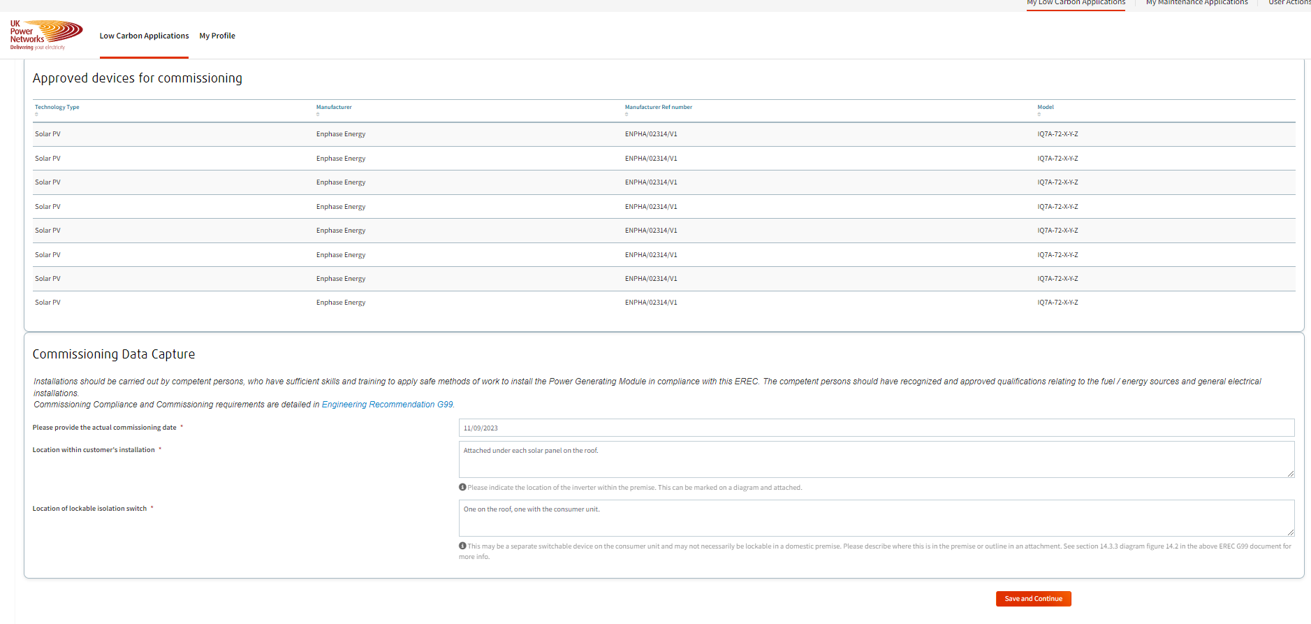

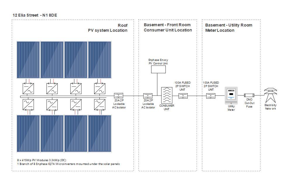

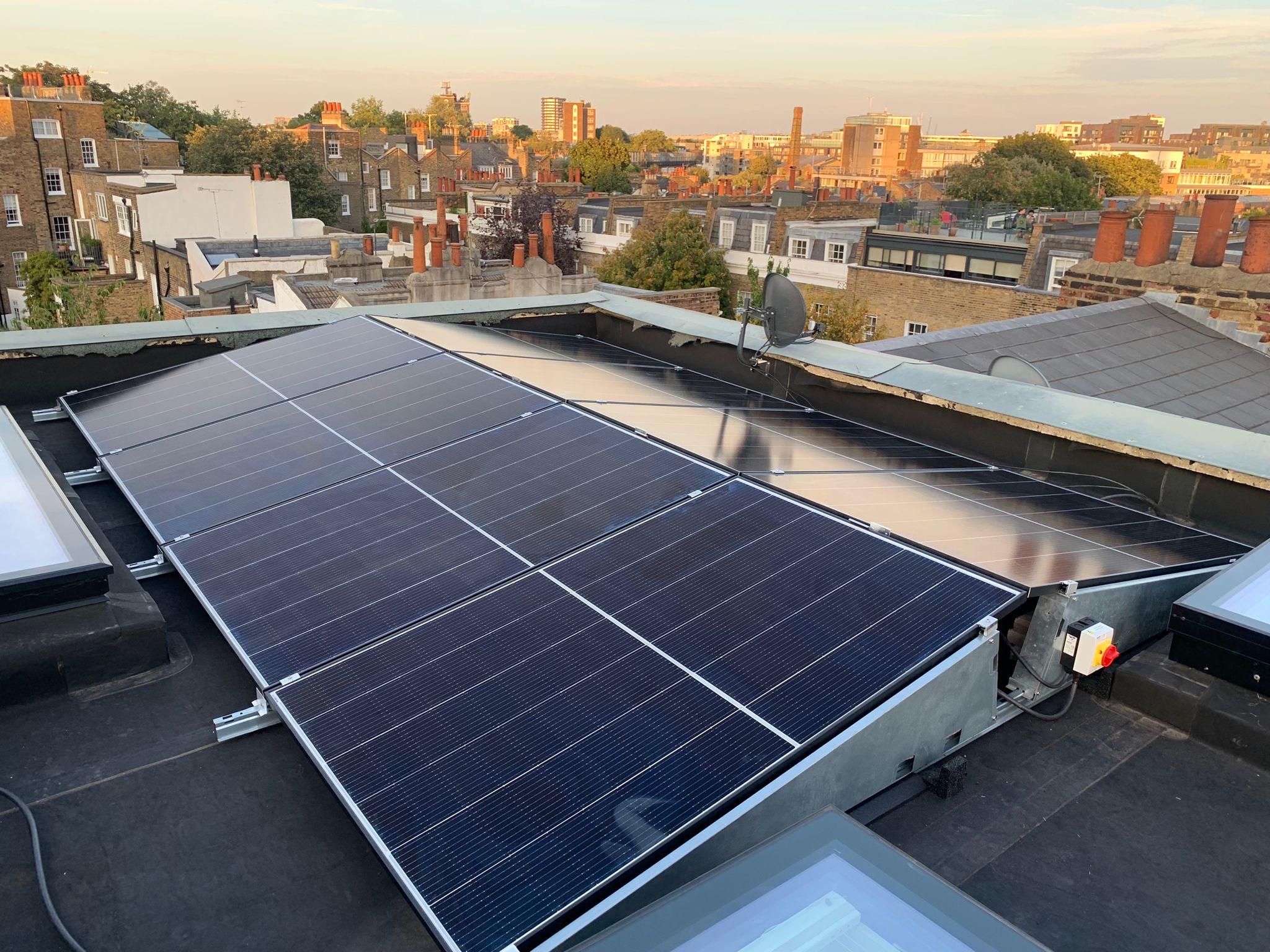

  5. I have now managed to DIY my solar installation on the roof. In the end I managed to squeeze 8 panels on my flat roof in an East West configuration, 3.3kWp, using Enphase microinverters. The shading isn't as bad as it looks on the picture although I could have done without the satellite dish being right there. The Enphase install was very simple as both the DC cables from the panels and the AC cable they provide simply click into the microinverters. I might need to add some pigeon protection before they start nesting under the panels. Everything is working very nicely and I have had my G98 application approved by UK power Networks but they are now asking for commissioning documentation. My understanding is there is a G98 commissioning form to fill in and I need to provide them with an electrical diagram. Will this diagram suffice, I've seen examples and this seems ok? Also has anyone actually done this application with UK Power Networks specifically? They have an online portal for the application and I think you don't need to fill in a commissioning form as it's been replaced by their website. They haven't been clear in their communications exactly what they are asking for. Finally anything else I might have missed? Thanks
